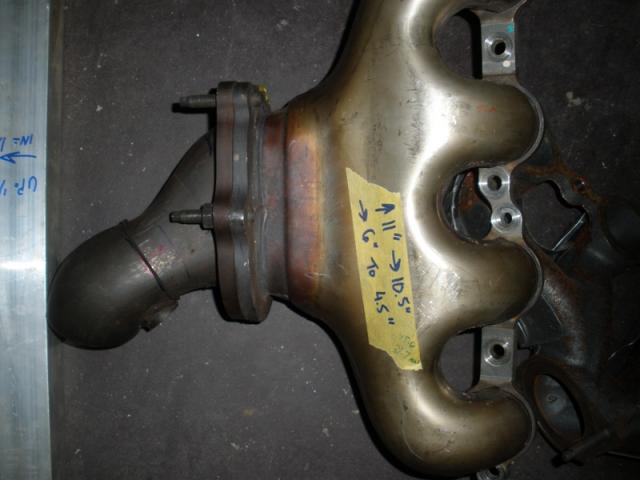

The LS7 manifolds are of stainless construction, and are 309 for the tubes, surrounded by a shell of 304.
The C6 Z06 has an exhaust that is made from Titanium. Are you planning to incorporate part of that in your system?
Here is a pic, I've cut the down tube out of a z06 exhaustr and am trying to splice in a small 10" piece of 304 SS elbow to turn it up to the cat. Everything fit nicey nice on the passenger side. On the drivers side, the down tube just hits the frame, so i've got to cut and reweld. I'm just trying to figure out what the LS7 exhaust steel consists of. Sounds 309/304? Thanks guys!
