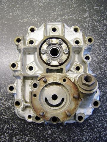

Now that would make me wonder if that is the end cover from a 'Fendt Roller' or some other industrial application that perhaps drove an auxiliary oil pump or whatever.
:):)I look forward to being able to ask 'clone' car owners in the future........''''' Hey mate, is that a Fendt gearbox in your car """" :):)
Jac,
There is no mention of the Fendt equipment in the ZF-1 manual.
But this box did have an optional auxilliary rear pump drive to an oil cooler with a return line to the top of the casing.
In Mike's photo, the Mangusta box appears to have a blanking plate in-situ.
I am now re-making this rear piece in alloy.

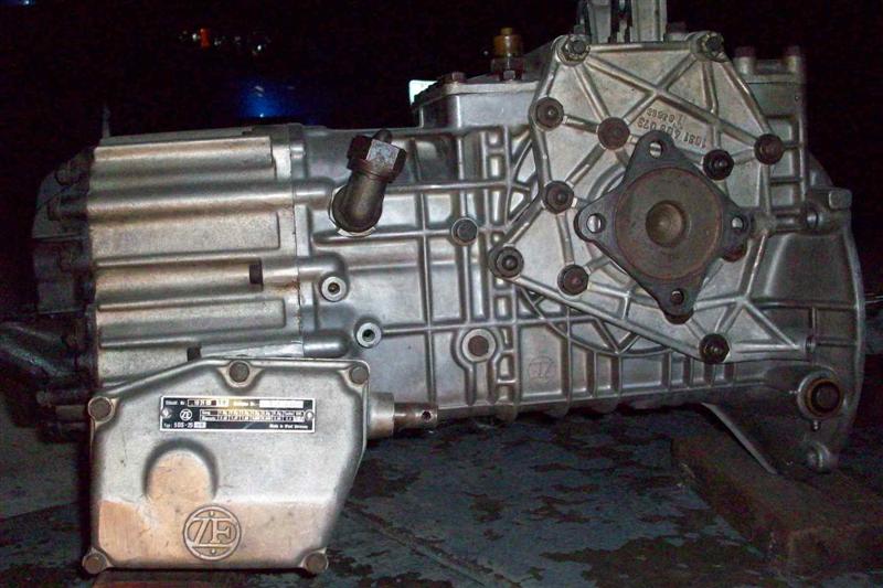

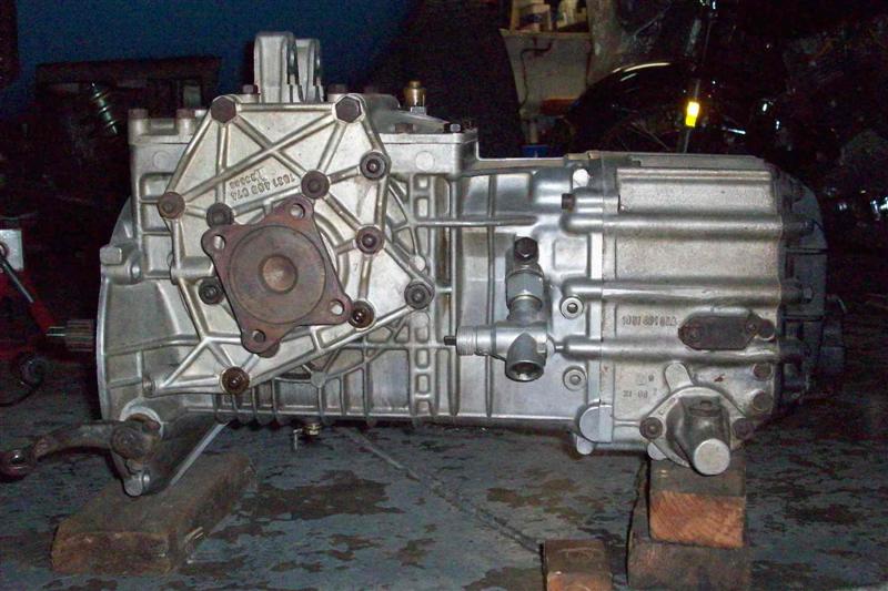

The fill hole on the side of the case is also the oil level hole, when the gearbox is in its inverted (Pantera) configuration, and is only about 20% of the way up the side of the case. It its original (GT40/Mangusta/M1) configuration, it is much higher, i.e. about 80% of the way up the side of the case. If you're filling your gearbox to that point, it's probably significantly overfilled, perhaps desperately so.
Jimmy Mac's cover appears to be the same piece. And to reiterate, my photo above shows a BMW M1 gearbox, not a Mangusta...but I believe the cast iron rear plate/filler are substantially the same. The Mangusta doesn't have the big oil pump drive gizmo sticking out the back. Jimmy's is probably either an original GT40 part, or an M1 part?

Here is an exploded view of the Dash-1 gearbox case, as used in the Mangusta (which is presumably the same, more or less, as the original GT40 case). If you click on it to enlarge it, it will appear full screen. If you click it again, it will blow up to full size, which is considerably larger than full screen, giving a good detailed look. The fill plug is part #105, and the overflow is #140.

In actual fact the shot of the rear casing is most useful to me, I have a dimensioned drawing of the pump but nothing beats this jpg

....except MORE jpgs, these from Steve Liebenow, who conveniently is building a new engine for his Mangusta so his ZF is sitting on the ground.
main.php
main.php
main.php
main.php
main.php
Incidentally, some previous owner fitted a Pantera Dash-1 dipstick to the side of the case, in place of the normal plug, which you can see on the right side in the first photo above. When the gearbox is inverted, this dipstick is effective, but in the Mangusta/GT40 orientation, it would result in a grossly overfilled gearbox.
These images are each double-resisized. When you click on the bar above each photo, it enlarges to full-screen. If you then click on that image, it enlarges again so you can get a really detailed close-up view.
These photos together should provide definitive guidance as to the proper oil level.
