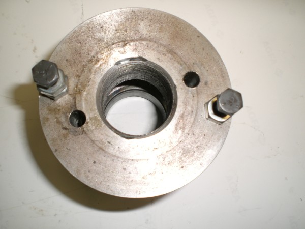

About to embark on the flipping of my ZF-2 and need the tool to pull the diff side bearings. Does anyone know where to purchase this gizmo?

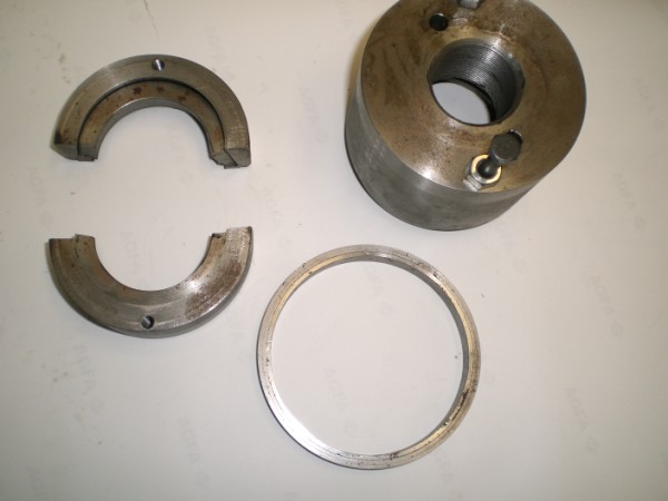

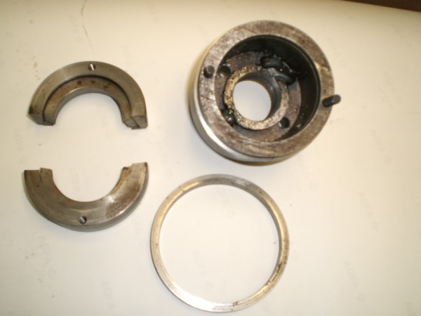

We made one, I can take pics of it if you like. You cut the old bearing cage and remove rollers first. Then use the puller with a porta power pump.

Yes, please...some pics would be appreciated. I was pondering making the tool, but was hung up at the strength consideration. Fearfull I would spend half a day making a tool that would end up braking due to how thin it would need to be to fit under the bearing. Also gave consideration to disassembling the bearing, so interesting you mentioned this is the solution you came up with.

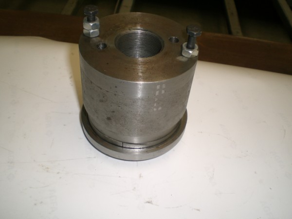

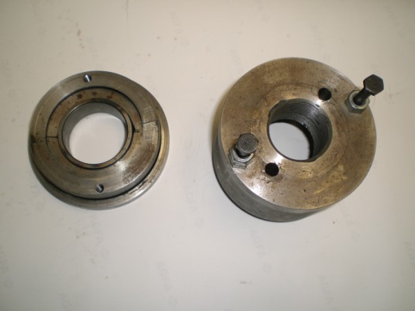

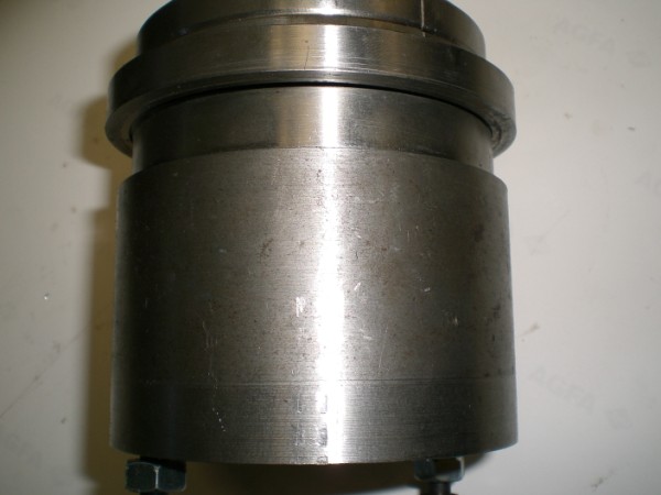

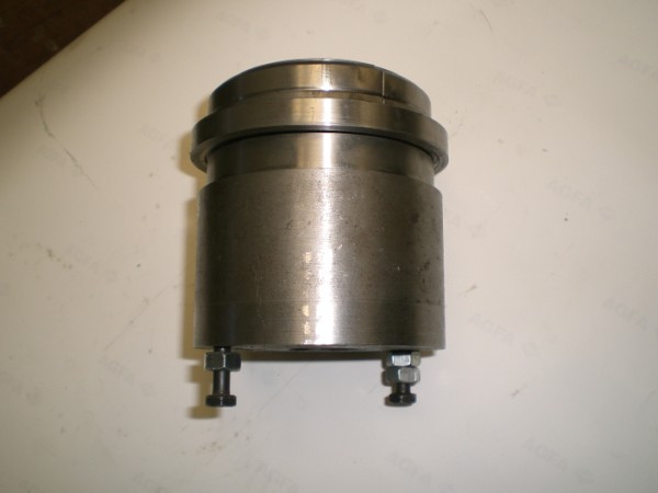

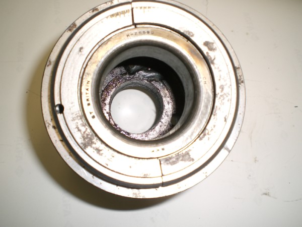

Here are pics of my tool. The one from underneath shows the bearing without cage and rollers in the tool.
Ross

Rob
Impressive tool you have Ross....;-)
Very nice! So you must have a threaded rod that you screw in the end for the pull force?
Thanks for sharing. I appreciate the time taken to post the pics.

I use the porta power hydraulic pump. It threads into the hole and pushes against the shaft. Good to hear you've gone ahead with Rons' way. There's always more than one way to skin a cat. I really enjoy learning of different ways to do things. Incidentally those side bearings are a lot cheaper than the one behind the pinion bearing. After spending a lot of time and money
replacing bearings and gear ratios in my old ZF, I have to say I'm very happy with the new one.
