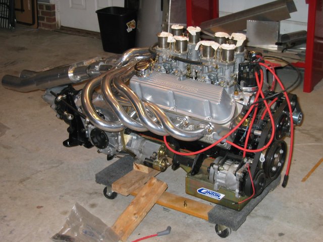

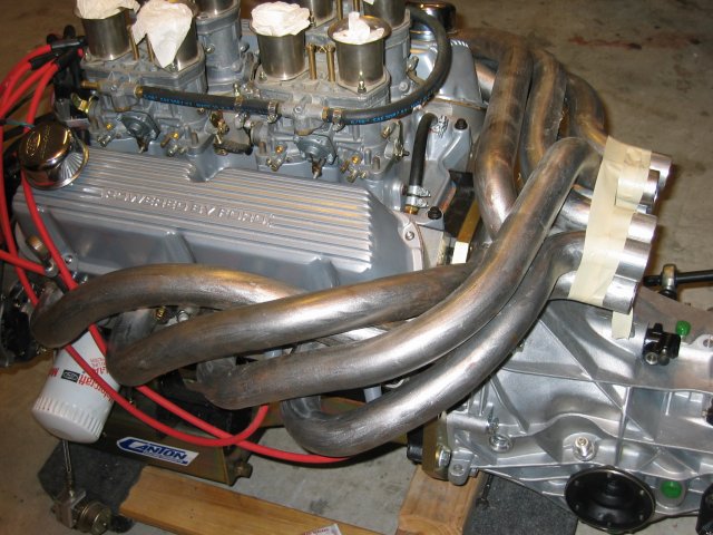

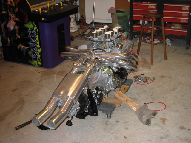

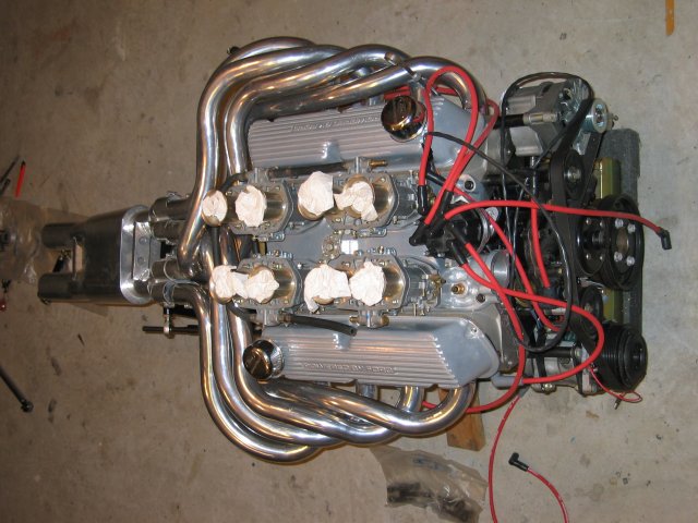

Here are a few pics of the motor and tranny all hooked up. There are still a lot of loose ends with wires, linkages, etc. but that is basically it. Engine is a 342, all forged internals, AFR 185s, etc.
I've got two exhaust systems and will be putting them both on and shooting pictures. They both fit on the engine without trouble, but I think one might fit my setup slightly better than the other so I'll be selling one of them. Let you know which one tomorrow.
My engine is old school - Weber setup and not much flash. I subscribe to the "Chrome don't get ya home" axiom so my shiny bits are actually powder coated a semi-gloss metal color.
Best,
Ron
Re: Roaring Forties #44 - Ron Earp\'s GT40
Hey Ron,
That system in the photos will fit just fine with one exception, the muffler is on upside down. Turn it over to where the tips are pointing downward or the rear clip won't close over them.. I also noticed that the #7 pipe is not bent up as high as mine is so I think your set of pipes will be OK.

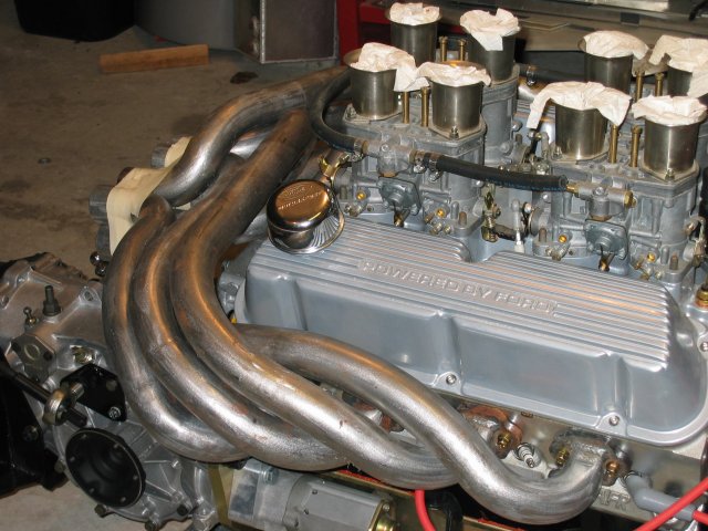

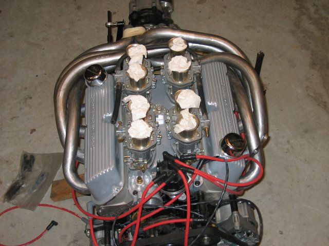

Here aer some pics of the other set, I didn't bother with the mufflers. They fit a little tighter but are a hell of a lot harder to get on the motor.
[ QUOTE ]
Hey Ron,
[/ QUOTE ]
No, no, no Hershal...
The engine is upside down. Geez Ron, we thought you knew what you were doing! /ubbthreads/images/graemlins/grin.gif
Ron,
Both sets look great. The first set of pictures is clearly the George Cochran set, and as Hersh said, your #7 pipe looks lower than his (and mine). Who made the second set? They are very nicely done, but I'd get them ceramic coated.
Geroge made both. I'm going to sell the first set since Hershal talked me into using the second set. The second set is much harder to fit but I think I can do it. Nothing wrong with the first set although I'd probably re-coat them again. I'll post them in the for sale section.
