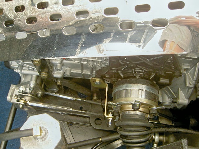

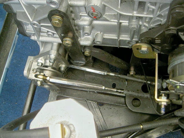

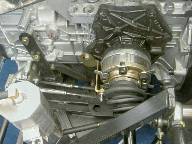

I saw a CAV at VIR last weekend that had this set-up on it. The owner was VERY happy with the way it worked.
Here's a picture.
