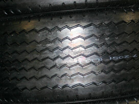

I now have my tyres in my garage and they look good!
