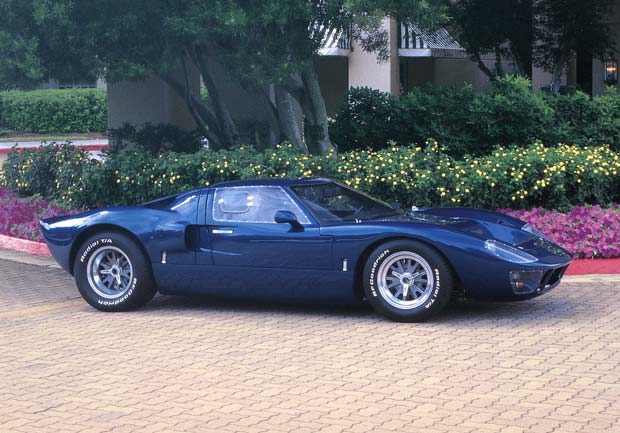

Are the SPF s/s monococ like the CAV's? Wait until you drive it at night on the street. All the cars head lights are pointed right in your eyes. Ask me how I know. HEE HEE. When my CAV was delivered from So. Africa the engine & trans were already built. It took 3 days to install the drivetrain and set it up for the road and on the 4 th. day I brought it home. The most fun thing I ever owned.
JOSEPH
PS: Good luck with yours.
SPF same monococ as the Gt40's from the 60s, actualy the stiffer MK2 verison on all spf cars. Possibly less modern or durable and more complex than CAV, but probably stiffer.

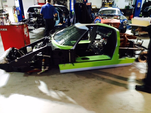

Wish it took only a few days to put together. More like 6 weeks, and we only finalised gearbox ratios yesterday, so the box is still 4 weeks out. Some stuff can be done before then, like roll bar, fuel system, race seat, shocks springs track stuff etc.
Fuel bladders are in, and removing he regular tanks and doing the install requires dismantling most of the front suspension.
My guess is delivery mid to late Aug. Which is ok as I can get into my summer track groove till then on my lotus and have sept through Nov to get into the 40. Given the speeds to be obtained in a Gt40 its probably just as well.
Some progress, custon gearsets done and gearbox built.
The build is back on track, should be done feb mar.
Motor came out at 574 hp 7100 rpms and 465 ftlbs at 4900, gearbox was then built to match motor.
Nice, I actually see my MKII the gulf color car sitting in the background, Dennis is doing some upgrades for me as well
