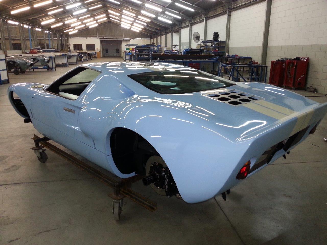

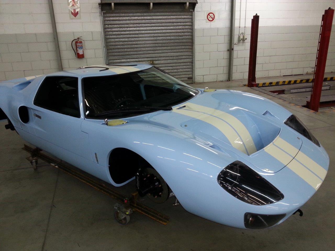

Thanks, its all starting to feel real, which is incredible after 20 or so years of Gt40 contemplation and dreaming.
Still have to figure out side stripe which we will do in vinyl here. Open to all suggestions on that one..

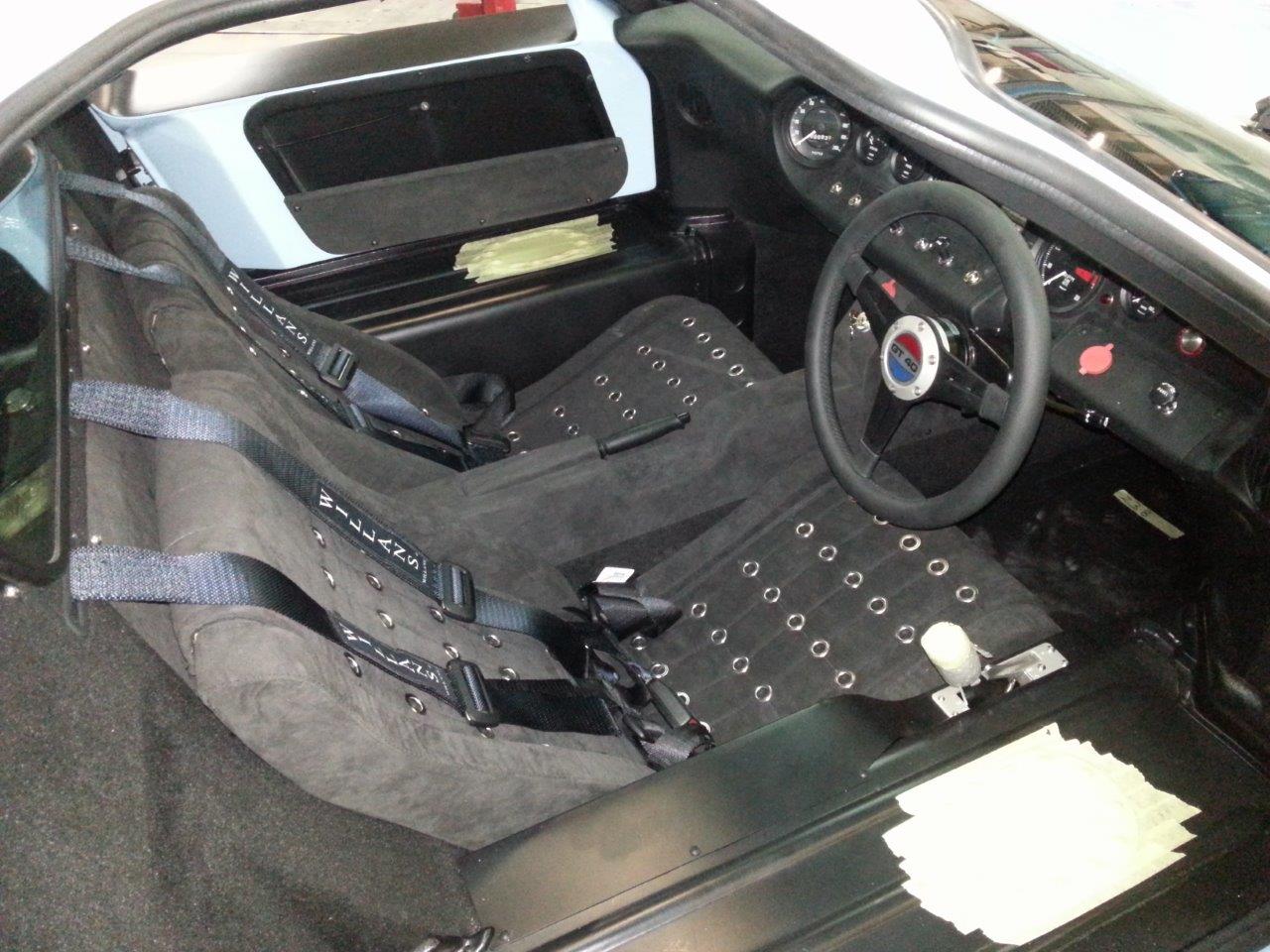

Where are you located? Just some thoughts for the items you might consider for Dennis as he sets up the car:
- A decent five point harness with cam lock system. Really important if you'll be on the track with your car.
- Replace the Superformance speedo with an electronic one. Dennis has one from Smiths that matches perfectly.
- Upgraded latches for the window hatches installed by Superformance.
- Install the round vents in both windows as well. They let in a ton of air.
- 3M clear bra on front nose, where the filler caps will hit the front clip, and also in the area near the wiper assembly that sometimes gets dinged when you remove the front clip.
- Interior door latches
Dennis also has a number of upgrades for a track car, and it sounds like you've been discussing those with him already. Others will probably have other ideas for you.

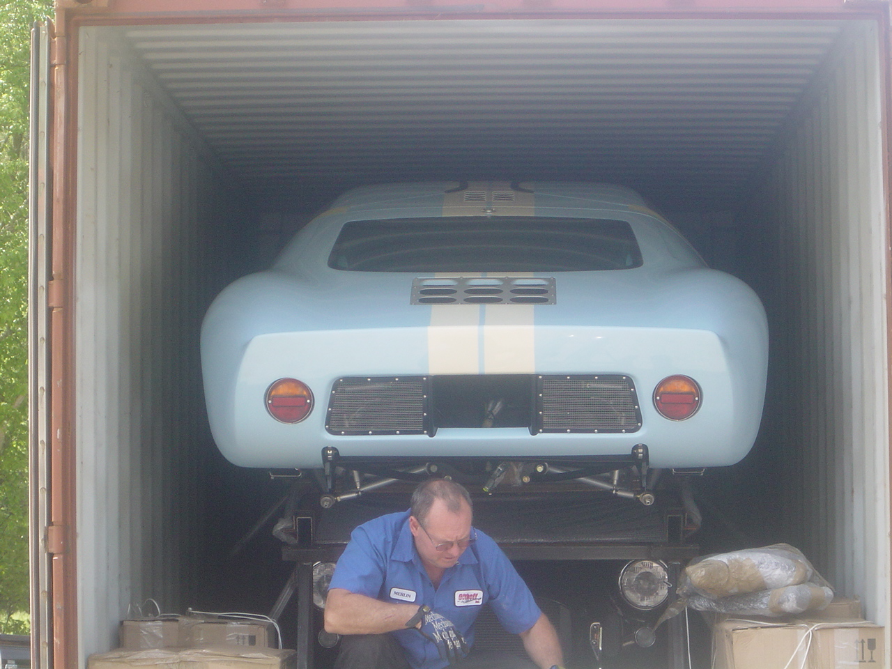

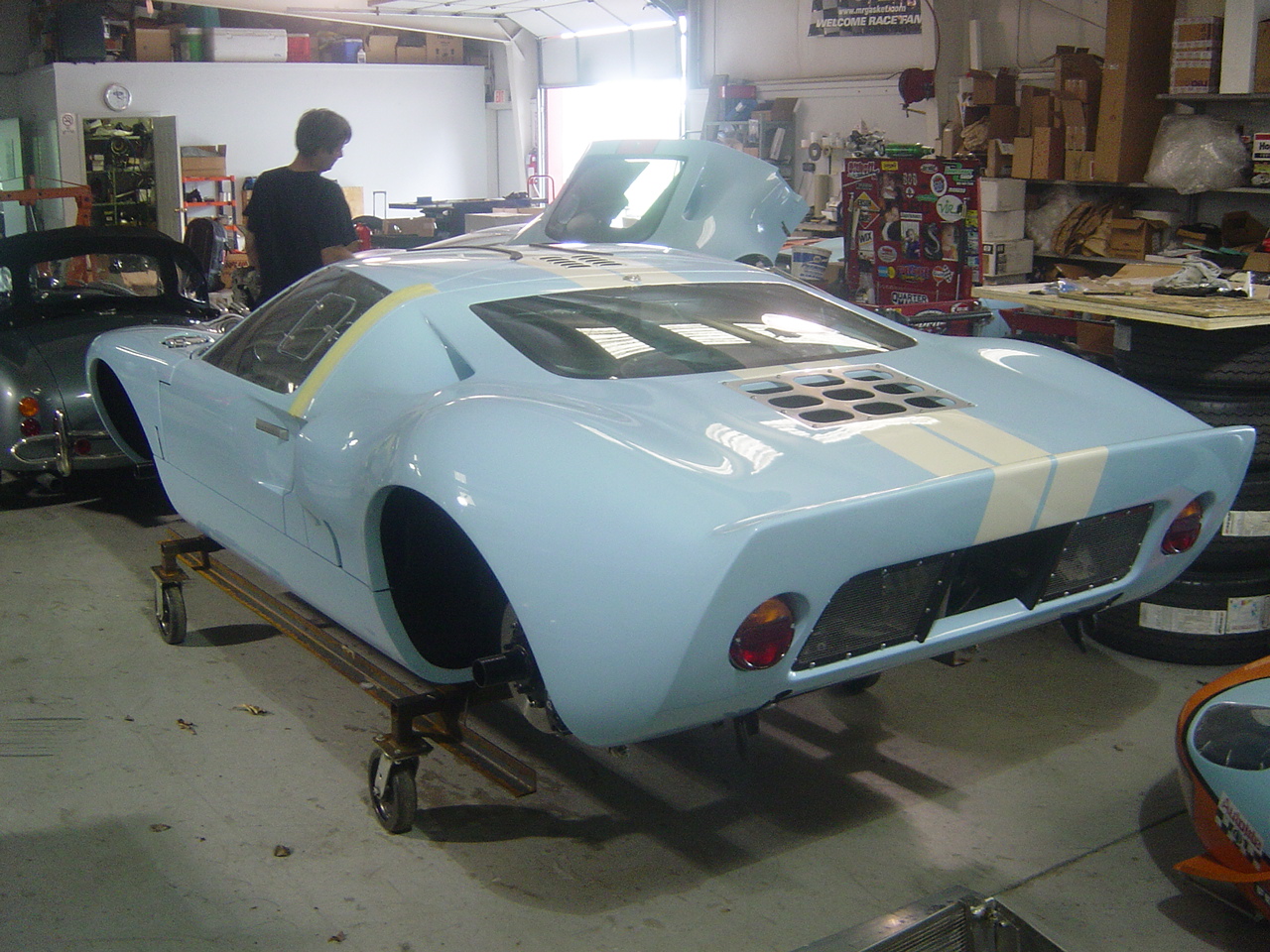

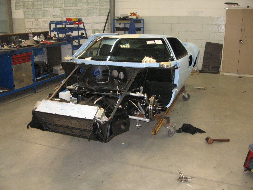

Car arrived at Dennis in NC last week.
Rick Muck- Mark IV
GT40s Sponsor
Magic Merlin unloading another 40!!!!
Congrats!!! After selling numerous SPF 40s, I finally have one to drive! Of course the weather has prevents such but in my dreams........
You will not do better than Dennis, Merlin and company to build out your car.
That shop looks familiar! Hope everything is going well with the build at Olthoff's. I can't speak highly enough about their qualifications. 3000 miles later, including 4 track days, and my only maintenance has been adjust the valves, more for the fun of it since they were all spot on, and change the oil a few times. Dennis, Paul and Merlin were great to work with. Can't wait to see how your first drive goes, keep us posted.
From the man at the top Dennis on down to Paul and Merlin... all of them are always willing to answer questions and provide advice. Its only my opinion but if you have an SPF car, GT40 or Cobra headed to the states, these are the guys you want setting it up.
Sean, I love the colors you have chosen. I came close a few times to going with that same livery. I do notice your taillights are either different or the rear clam is molded differently as the tail lights are recessed where mine are not. Interesting.
