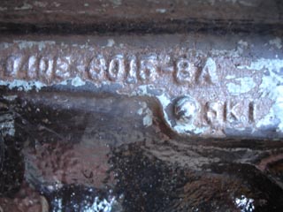

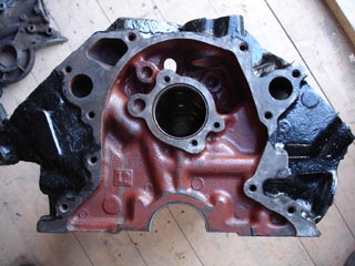

Pictures of the oldest block # C4OE-BA

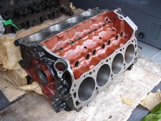

The block is definitely a 1964 HP289. Having looked at it for a while now I reckon it's good for use. If blocks like this do crack where am I likely to find the damage?

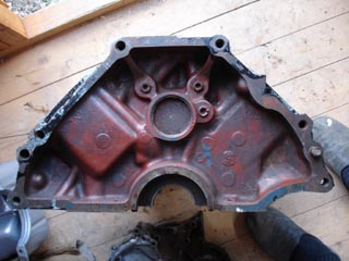

More Phot's:

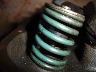

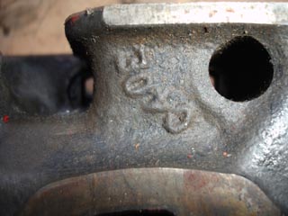

Here are some details about the heads that came off the motor:
C4OE (4A13)
There are no pushrod support guides 'tween exhaust ports. There is also a ring of numerals: 19753.

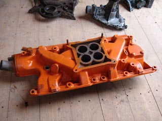

Does any one recognise the intake manifold? I can't find a number on it any where.

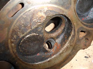

On the other motor (C5AE-E) the heads look quite a lot different. It has pushrod guides 'tween the exhaust ports, the valve springs are quite a bit smaller in diameter and has weird tubes that protrude into the exhaust port from a tapped insert adjacent the port. The casting mark says: C6O4 - 5J17 with 66-289 on the opposite part of the casting. The cast circle of numbers on this head reads: 1397.
the heads marked C6 are from 1966 - if they have ports as described (threaded) that was for the "Thermactor" (sp?) pump emissions connections.
on the block that you state is a 1964 block, from the back it looks like it has 6 bell housing bolts - if it does, something is screwy as the 1964 to early 65 blocks were all 5-bolt bell housing patterns (at least I don't think the HP engines had 6-bolt patterns - - - - ).

I think you may find that the "1964" block is actually a '1974 Mex 302' ( D4--) that has been used to replace old block. Two things point to this. 1. The Triangular water holes slightly to the right & above each cyl bore ( 289's of 64 vintage did not have these). 2. Early 289's had the oil filler tube in the alloy timing cover which lined up with the 5 sided cavity above the water pump transfer port which opened into the lifter valley. On this block that cavity does not appear to be opened up to allow this.
Knew there was something else, has the lug @ front RH by #1 got a threaded 3/8"unc hole parallel to crank, if so its after 1969.

I think you guys are correct in your anallegies! I shall stick with the D4__ block as it has been rebored already. Checked the crank throw last night - 2.87", good. I think I shall contact a V8 builder in the south as one of the heads requires some work where a valve has dropped before. This part of the build/information gathering has been very interesting, it's great having such experience at hand from all round the globe, many thanks.

Lucky you....this is one of the better 2-bolt vintage Ford blocks, they have a higher nickel content and are tougher than non-Mexico blocks. According to the books I have, somewhere on the block it should say "Hecho en Mexico". They have thicker main caps as well. Good for you.

By the way, I have located a Ford V8 guru via Mick Sollis. Hopefully the head with the dropped valve damage is repairable as these are good heads to use. I am debating whether to use the existing rocker support stems or upgrade to a tapped type???? Is there a maximum lift datum for the convertion i.e. what is the maximum lift the standard rocker stud will put up with? I am using the Edelbrock 7122 cam.
