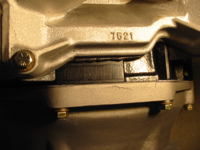

Ron , that is where they should be unless someone machined them off, but ford didn't always stamp them very deep i would try a scuff pad in that area or i can send you a picture showing where they are on my 90 5.0 motor regards Bob
Hi Bob,
If you have a picture that'd be great. That pad back there is extremely smooth but I will hit it with some light abrasives and see what I can turn up.
Ron
Ron
If you look real close you can see the first digits, the letter "GY7 *****". Thats the number you will need for your registration. It should be an eight digit number. Good luck.
Thanks much, that is good at least it is where I was thinking you guys were saying. I suspect it has just been painted over well and is extremely smooth. I'll do a bit of scraping and see what appears.
