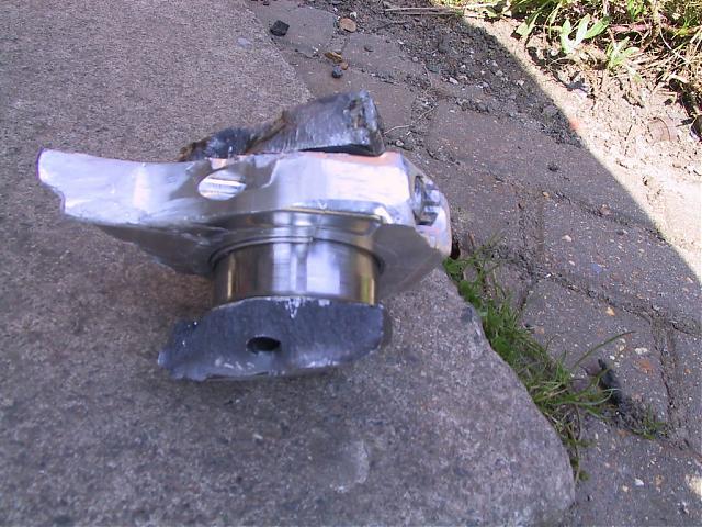

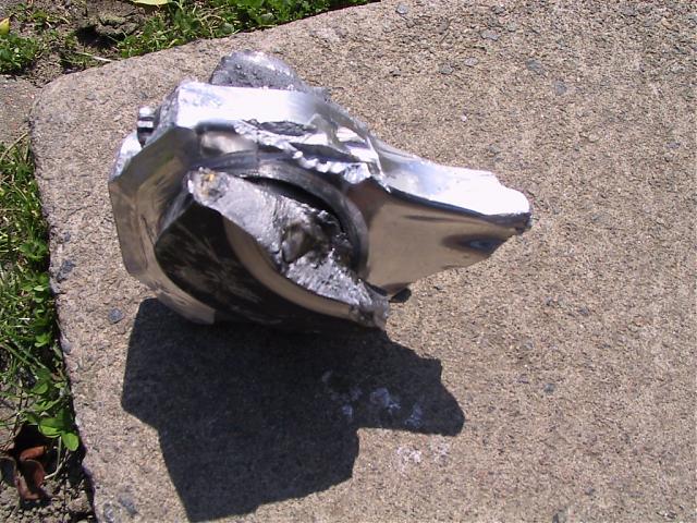

Talking of engine problems, how would you like this one ?
Russ, The way the crank it broken and the rod was pulled apart, not snapped.
It also could be from hydraulicing the engine. Both would cause a faily clean break like that.
