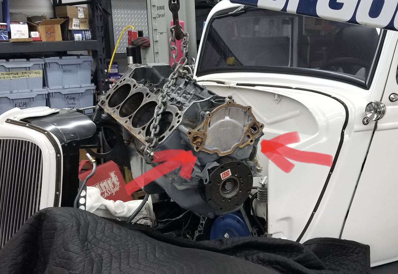

Sorry Jac, I am pretty sure there are two that go all the way through from the water pump and front cover and there is water on the other side. I’ve got two such blocks. Both of them E7 blocks (Mustang HO) that are like this. Neither block was modified other than having cylinders bored.
You are absolutely correct that there are numerous gasket combinations - one of Ford’s best kept secrets is “why”…

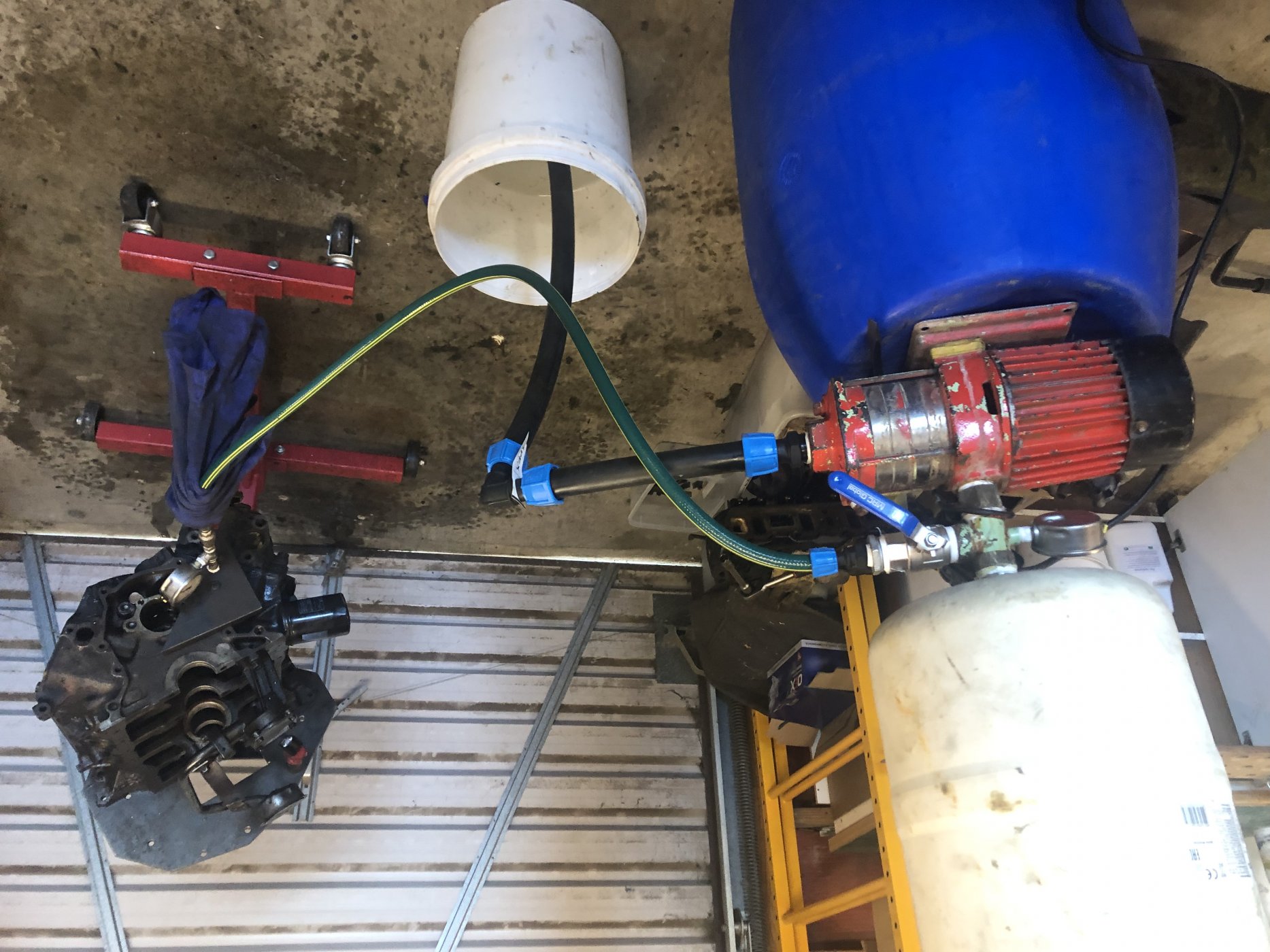

Just to confuse matters, I have a 1987 302, recently I pressure tested the block. Definitely a homemade system, however, I did not have any water coming out of where the timing cover, water pump bolts should have been. You may have to turn your computer screens upside down to view.
