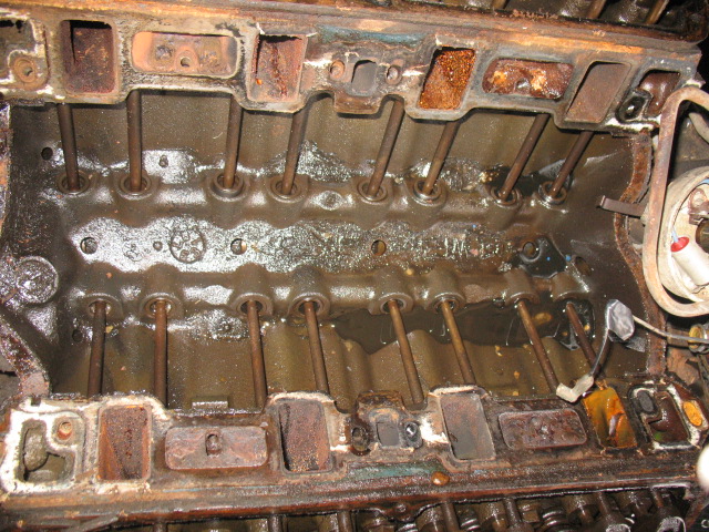

Well I poked around the engine. No tag on the distributor. But I did pull all the plugs and get a look inside. Only 1 cylinder has some very mild rust on the walls, so I hit them all with some oil. The tops of the pistons didn't look great, but I guess that's to be expected.

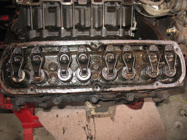

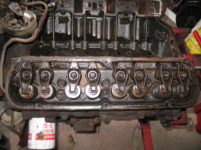

Well I cracked open this engine today to take a look at what I bought. So far so good. No big sludge buildup inside. The drain holes in the head weren't plugged. Hopefully tomorrow I'll get the heads off and see how the bores look. But with the plugs out and my cheapie bore scope things looked OK. The one intake port is pretty rusty and I think that matches up with the one bore that had some rust on the cylinder wall.
UPDATE: pulled the heads and 7 of the 8 cylinders look great. The one does have a light rust coating to it. So I sprayed it down with penetrant for now. Engine turns over very easily. So looks like I got a good foundation for a build someday.
