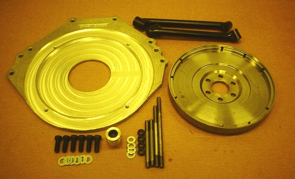

If you're going with a 930 or G50 Porsche trans --then you'll need a kit like this -- the flywheel is premachined for a 50 oz imbalance and will need to be final balanced with the engine

Thanks Chris for your super fast reply, I'm planning on using a Ford bellhousing to mate to the transaxle.. Regards Dave..
351w WILL be 28oz factor unless someone has been silly enough to have it completely done to the 50oz which would require a new damper & a lot of drilling on the crank. Only later 302w 8.2" SBF's are 50oz from factory, plus the oddball 255ci.
So, do you need to strip it down & rebalance? if its still got factory rods & pistons, probably not, but if its got aftermarket performance stuff then I would suggest you do. you only have to pull the pan to check that.
