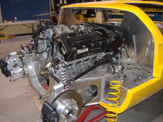

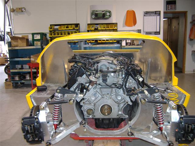

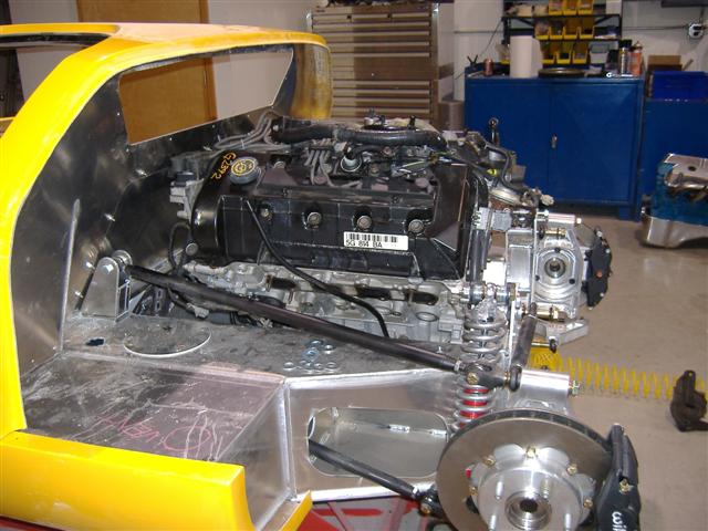

Cliff,
we installed a 4.6...its a big lump..we made it fit but the custom fab for all the support items..headers/AC etc etc will be a fairly sizable undertaking...

cliff,
re: fran's post: the big lump was in my rcr40. we ended up taking it out because of all the fit and size problems. way too big. put a 4.0L lexus in it. smaller, more powerful, more efficient, duel ovhd cams, etc. everything the mod engine has, only better. sorry, no pictures. oops, maybe i do. will look for them.
wes
Thank you gents, very helpful information and pictures. As usual, somebody here has already given it a whirl and done the heavy lifting. Hhhhmmm, re-thinking that 4.6 modular idea now.....
Doesn't sound like the right engine choice at all both in terms of size/packaging and weight (along with other complications you have helped me appreciate more fully!).

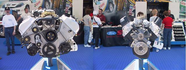

RF did (and I suppose they still do) a 4.6 modular. They now (along with DRB) do 5.4 mod engine fitting too. Here are a couple of shots of a 4.6 in an RF

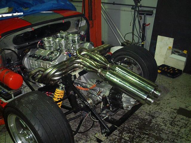

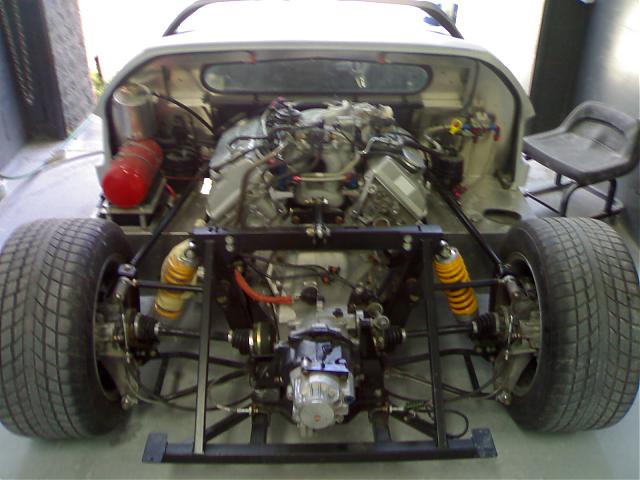

Hi Cliff,
I own a 302 with an 01E with LSD 8 barrell\cross over. I've just finished buildimg an RF for a mate with 4.6 01E with LSD eight barrell|cross over exhaust.
Compaing the two cars is interesting, the 4.6 certainly is a much heavier car but the engine is very smooth and loves to rev to 7000rpm. It does lack the low down torque of the 302 which I limit max revs to 6000. On the road it would be a tough choice to pick between the two cars, we will both be doing some track together later in the year so then the fun will start for real comparisons The 302 would have more options for tunning such as stroker cranks.heads and camshafts and other aftermarket goodies.
The chasis is considerably widened to fit the 4.6 engine and the heads look massive vs the 302 setup. The rear clip of the 4.6 is heavily cut out to enable clearance for the heads and much wider valley of the engine. Ford GT heads and cams are a tuning option for the 4.6 though there is not much room height wise to consider supercharging.(then you really start to get away from the gt40 look)
If your car is already a small block I would be moving towards a stroker motor with good heads, conversion to 4.6 after the event would be a moutain too hard to climb.

Howard, that is a favorite picture for sure!! :) Damn mod motors are too large!!
