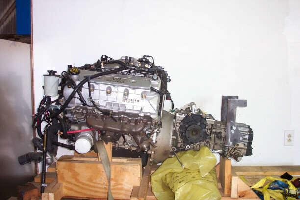

oops
Nice one Bill. It's good to see some interest in this engine. I think it's going to surprise a few people once there are a few GT40's running around with MOD power. /ubbthreads/images/graemlins/cool.gif

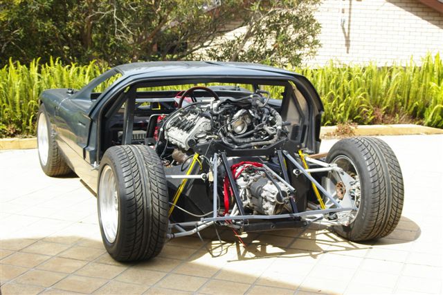

Here's something similar being done here in Sydney, Oz - an RF with an Audi V8 4.2l 40v 320+hp 410n/m.
Kind Regards,
Peter D.

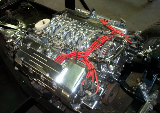

Hyland has a new 6.0 block that will be out soon. The proto type makes a brutal amount of tork. In the 700 range by a long way We are developing a trans axle to harness this beast. it is a version of the ford 4 R 70 W that will be paddle shifted. The car we are doing now has a bigger foot print. But some of the other kits that are around could accommodate this set up. Could be fun.The eingn is 30"wide but only 24"longand 29 deep
This is the mark V111 vershion this will be in my own car
