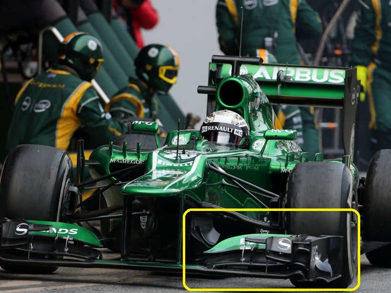

Now the issue we are having is finding the exact green I want to make it. I love the 2013 Caterham emerald green they have on the F1 car. Dupont makes the color, but does not have a code or anything for it. My painter is mixing up different colors to try to get close to it. If that comes out really good I might paint the SLC in the same color. Now that I said that no one else is allowed to copy that. haha. I see two greens in these pics and really like them both. Decisions. :shocked:

Whew -- look at that front air control, a lot things going on there - impressive.

If you like both those colors then finding something that works for you should be no problem. House of Kolor has a nice display of colors at SEMA (if you go to that) and they will tune you into what and how many layers of which colors make the desired finished look. I'm guessing its a pearl (warm lighting dependent gold glow in first shot a tale-tell), candys would be a pain to paint race cars with as it is real difficult to paint many parts in candy at different times and have all the separate parts color match in the end.

I liked the HOK kandy, but painting a car with the curves and all would make it differnt shades and colors in different areas so that would not work. My paint guy is getting me samples that he can paint on some parts to see how I like them. Pretty excited about how the Mini is coming out.

Yos- Verde Ithaca is all you. A little too much yellow in it for me and I want a slightly darker color, but it sure does look really sick and nice. That is all you. Shotgun on Catheram emerald green 2013. Dibs and no backsies ever or I am going to tell Mom and Dad. But if there is a car with a similar paint it would be cool to see it around those 6 exhaust pipes.

Quick updates. I finally got the color for the minimr2 and now the slc. I basically gave up on it as it was a proprietary color only to Caterham F1 team. I tried and tried and tried. Then I have a buddy in the UK who read my minimr2 blog as he likes minis also and sent and email to his friend who works at Caterham F1. He found out that they use a black room to make the color specifically for them and there is not a paint code or anyway to get it. He got the next best thing though. He got them to paint a sample for me and send it over. I got it and it looked great, took it to the auto body supplier and they scanned it to get the paint made up. It has a crazy amount of pearl in it with both gold and silver. I got a 4oz sample made up and sprayed some Elise side scoops I had and it came out really good. It is light green in the sunlight and then turns a goldish or silver color depending on the angle. Then out of the light is turns a darker almost British racing green with a nice metalic to it. I am super excited to have actually gotten this color. Cost for Dunpont Chrombase is like $775 a gallon due to all the pearls, but got to pay to play.
