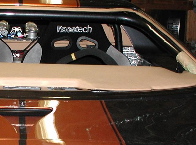

I am about to start the mounting of my 5 point harness. In the DRB chassis, the center and outside mounts are part of the chassis. The upper shoulder restraints are another matter. There is a section of the bulkhead just under the rear bulkhead window that appears to be where they should be mounted. On this part I need to know how far apart they should be?? The seats have a through slot for their passage. But I am not clear where they should actually be mounted. I am 5' 9" with most in the legs(short body syndrome).
The Racetech seats as I mentioned have the pull through. Should the straps be pulled in toward each other a bit or out from each other? Is there a formula for this sort of thing? Mounting the shoulder straps to the bulkhead, will these mounting pieces work or will they need to be replaced? The bolts for the floor mounts are 7/16"-14 thread, unless since the car is Australian it is supposed to be metric and I am just forcing it. Any of you DRB guys set me straight?

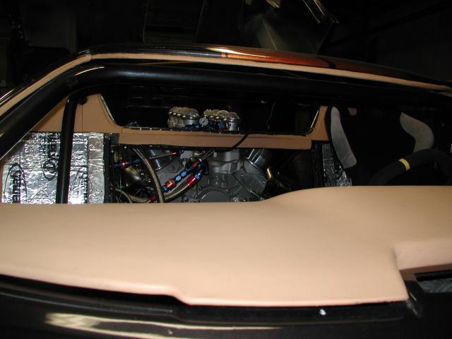

The bulkhead piece is not drilled so some tough drilling will be at hand. I can use the plasma cutter to start one or two of the holes from the engine bay side. Since the interior guy has laid down some leather there, I will have to cut plugs in the leather and use starter holes with the plasma unit. I am including some shots of the area and the seats sitting loosely in the car. They will drop down at least 1/2" since there is insulation on the floor.

Bill, I wouldn't use a plasma cutter anywhere near that cross member - its integrity is important to your car's overall structural integrity (I see you have also installed a roll cage). If eye bolts through the cross member is the way to go then use some high grade eye bolts of moderate size - stay away from the cheesy stuff at Home Depot and check out some marine stores like West Marine for quality fittings. West Marine will have close ended (welded) eye bolts designed to take significant loads. Don't use the open ended eye bolts as they can bend and straighten under load.
For drilling the cross member just use good quality new bits and start with a small bit and work your way up to the necessary ID for the eye bolt. As suggested above use a thick washer on both the engine and the interior sides to distribute the load better. Finally, if you're using metric bolts then go for the 12.9 grade - these are very strong.
Bill, the seat belt eye bolts are 7/16"-14 which is a standard size here in Aus.
The cross member where you intend to fit the shoulder straps is a hollow section. I turned up some bushes with a flange on one end, put them through from the rear and then had a friend tig weld them in position. Just use a hole saw to cut the holes from each side.

Cliff, I am carefull not to stress the crossmember. I use the cutter just to put pilot holes and then use a step drill bit to get it to the right diameter. Trying to drill stainless with a hand drill, without a starter hole is near futile. To pop a pilot hole in the tube steel, though thicker, uses a minimum of heat and only takes 2 seconds at most. The drill bit with cutting oil, can then grab hold a lot easier.
