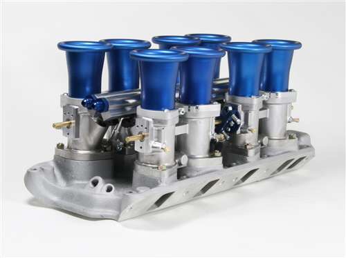

I am currently attempting to construct a Lexan cover for the TWM/Borla injectors. This will be fitted with K & N rectangular filter(s) mounted on either side or rear of the injectors. This will leave the view of the bells unobstructed. I plan also to block out as much of the heat of the engine as possible at the same time. This will involve enlarging the opening of the surround. The air temp sensor will be moved to this area to get a better reading. There will be some heat that will come from the front of the engine because the distributor, fuel lines, and regulator come in from there. I also want to add thin filters to the side upper vents to try and keep the surround area clean. All the measurements I have taken seem to be feasible. Will do a mock up first to see what will not work. Not sure which thickness of the lexan to use at this time. Probably 3/16.

I did something similar on my hilborn EFI setup. Mounted the water-jet cut bottom plate on a set of stand-off tubes that were a slide fit over the stacks, and secured it by bolting it down on each side with small diameter bolts visible in the photo.
Used a rectangular K&N filter and sandwiched a poly-carb top under a water-jet cut top peice bolted to the base plate using threaded rod and stan-offs the same height as the filter.
