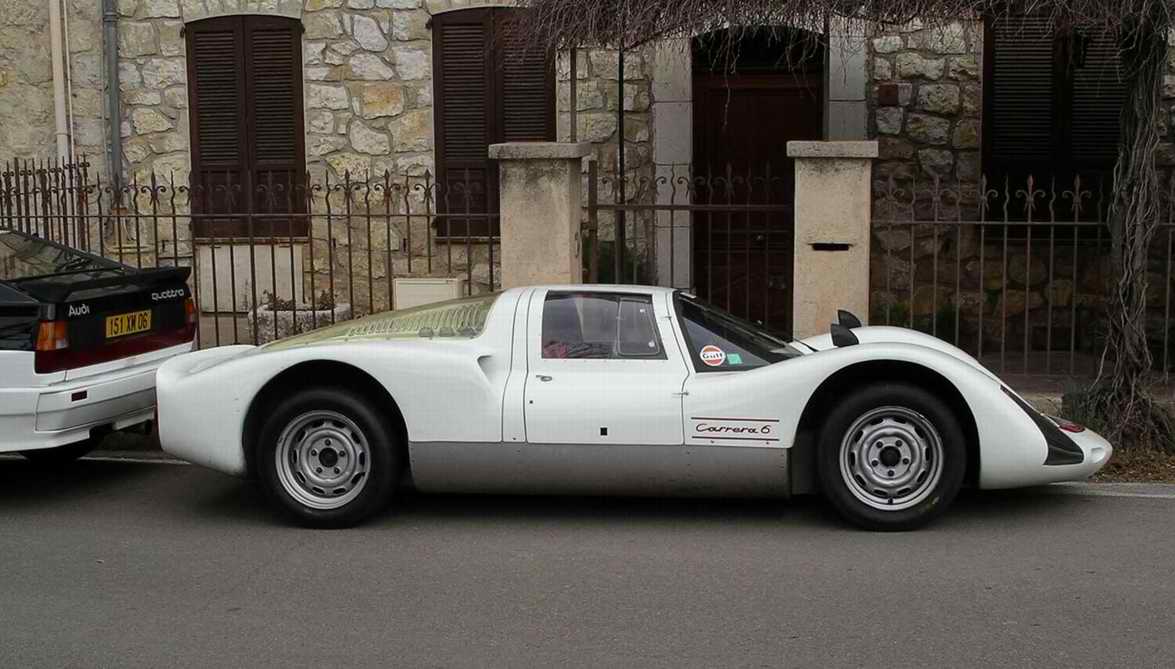

For me it's the Carrera 6 like this one I saw at a rally in France. It makes me have crazy thoughts.

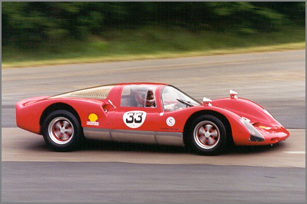

[ QUOTE ]
[/ QUOTE ]
Yup.

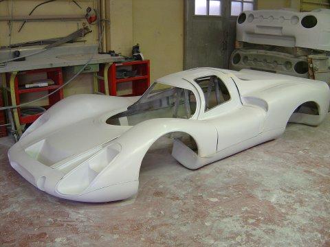

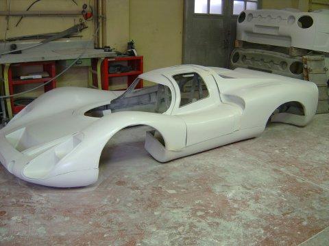

Hi
On behalf of Chris Melia, who is suffering computer gremlins uploading images at the moment, here are some bodywork images of his cool-looking Porsche 908 project.
Anyone interested in the packages available, drivetrain, suspension, etc should email Chris at [email protected]
Cheers!
Rob
hi Rob
Thanks for posting the pics, I have not yet decided to go into full production, I intend to build two or three cars for evaluation first.
I think this car was Porsches answer to the GT40 and it was a fantastic "race to the line" in 1969 and in my book the best GT race ever.
I will fit a 3 litre 911 engine and gear box use the 911 brake callipers discs and steering components.
Regards
Chris.
