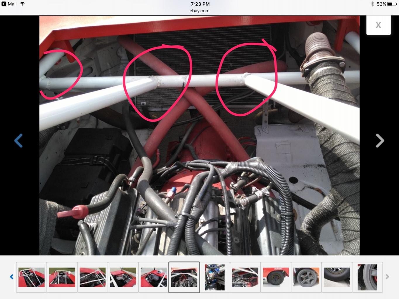

When the boss said "mid engine" the engineers, uh. sorry. the carpenters took him literally.
First time I have heard of an engine being partially unsprung weight.
YeeHaa.
The welding on this car scares me....

Chain drive steering. Either that, or some very unique power assist. Brake rocker "plate" for the master cylinder. Home-built in every sense of the word.

At last...Someone that can weld aluminum as well as I do. To have this kind of validation of my dirt-dobber welding, so early in the year, is yet another reason I love this site!

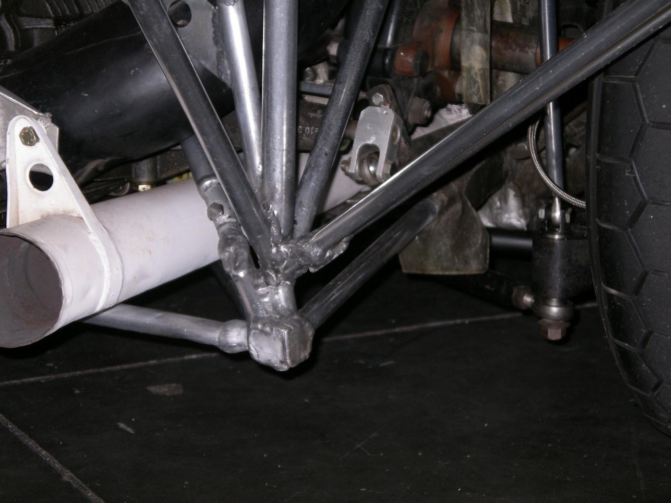

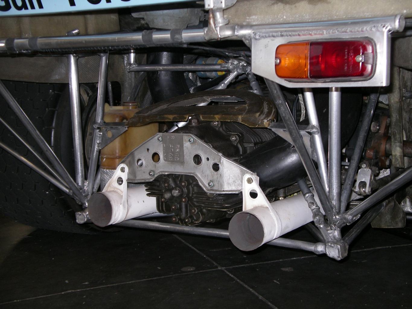

Markus those welds on the original. Look to be field repairs after a slight crash to that corner. If you look at the exhaust support bracket. It has a welded up crack in it too.
Markus
SPRF40
Mike, you might be right on the field repair – nevertheless somebody drives that car nowadays …..
Welding wise the original chassis’ from 1969 didn’t look that great at all – TIG welding then was not what it is today.

Oh Marcus, your sense of humour is just like mine. These pictures were running repair welds, but the original frames also looked like they were suffering with piles !!!!!!!!!!!!!!!!!
NO.
Would not get behind the wheel of that.
My gut feeling is it will end badly.
Jim
Do not worry Jim, the rear end frame work was basically supporting the luggage trays and rear deck and is not stress bearing, so that "welding" would hold up OK.
