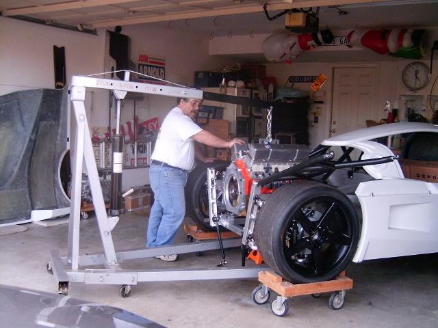

We want to see a picture like this one! Anything I can do for to help, post your question, or just PM me. You might want to make some roll rounds like these. Six inch wheels (cheap ones) came from McMaster Carr and the plywood is 1/2 inch double thick. Cheap to make and they put the car high enough to slide yourself under the car. My car has been on them, other than some short periods on the garage floor, since day one.
