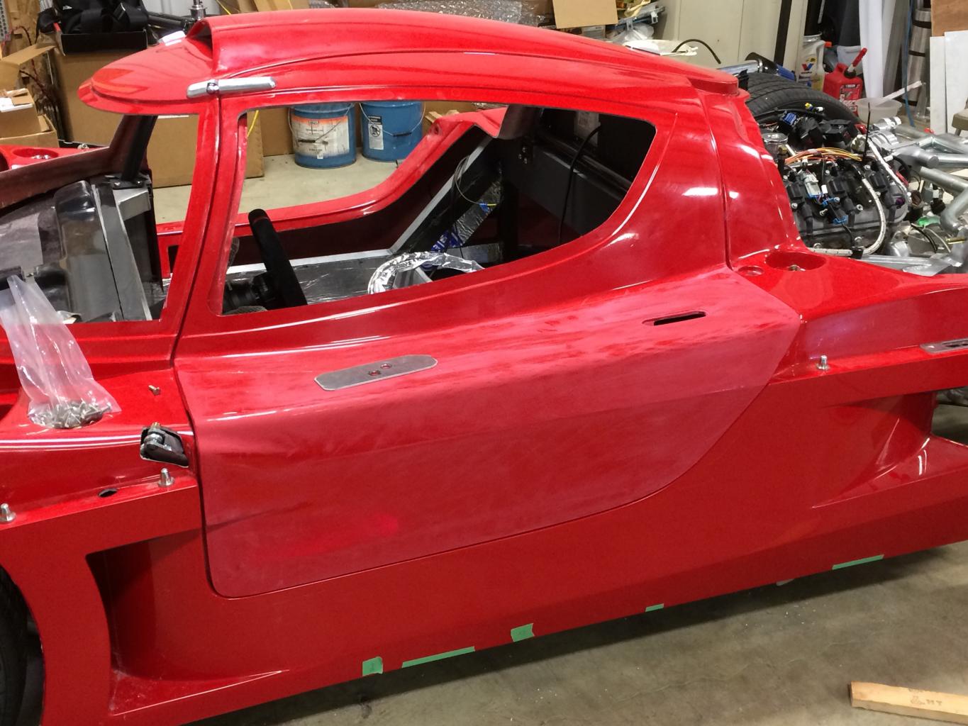

Photos of door fitting.

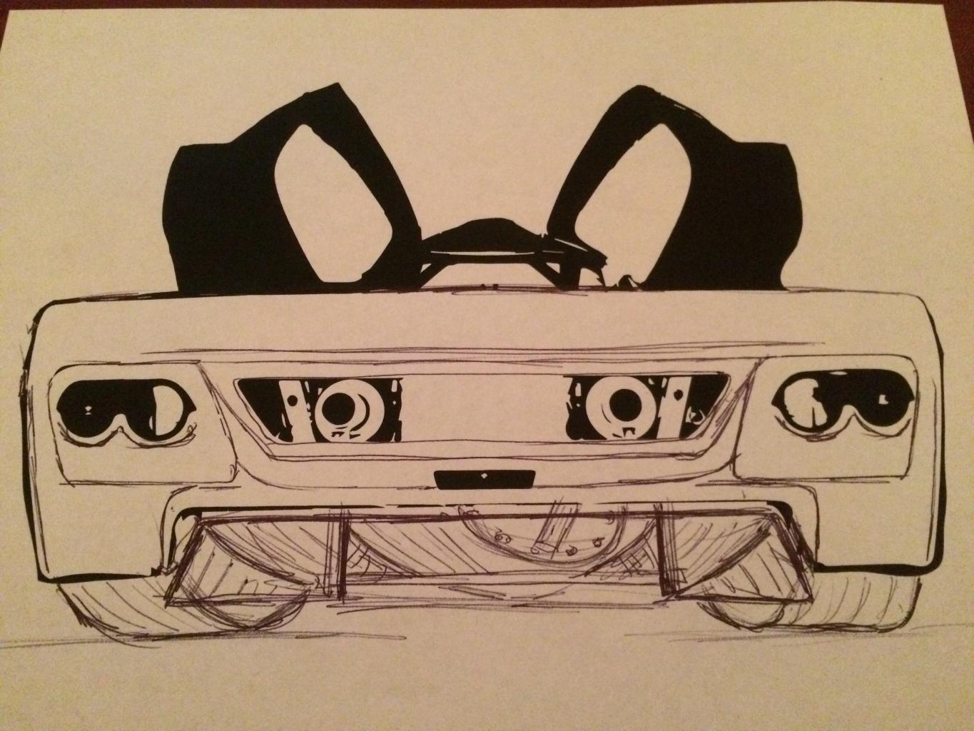

I've been fabricating away on the rear tail mount and diffuser project. Today I mocked up and welded the tail support frame. I'm building tie rods from the diffuser verticals to the spider frame this afternoon.

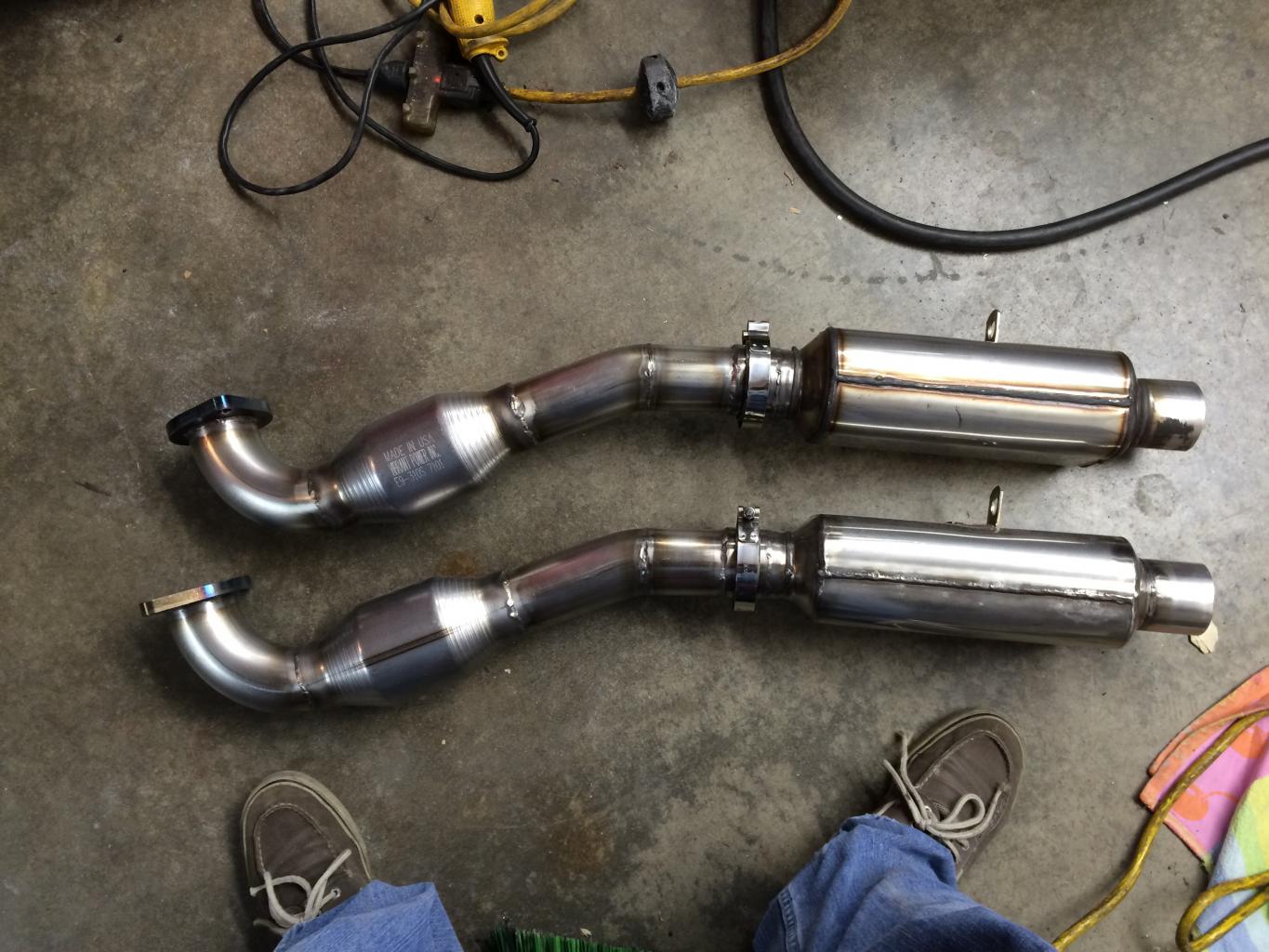

For anyone that wants to see my exhaust. Using the stock LS3 manifolds makes things a little straighter :)

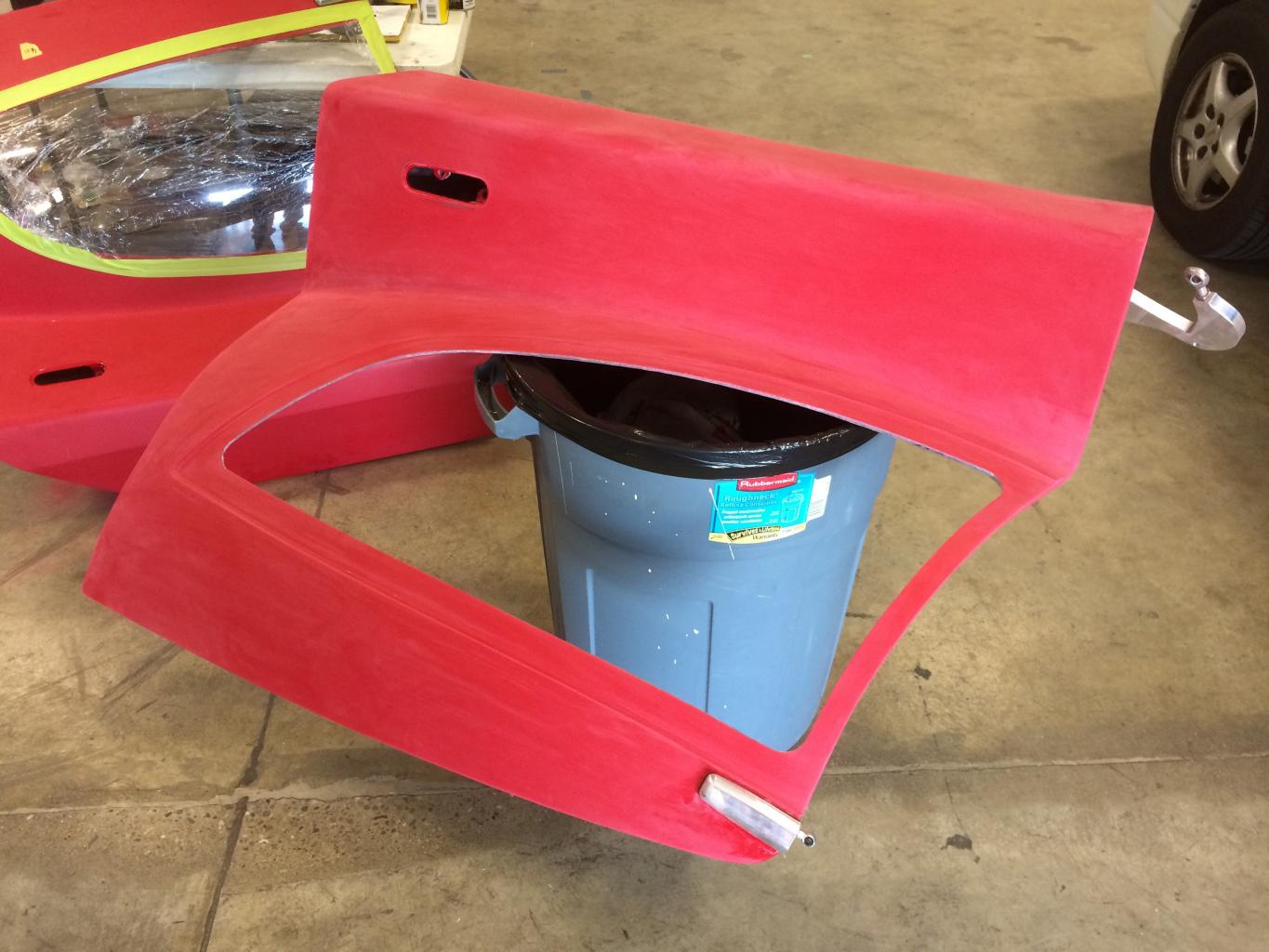

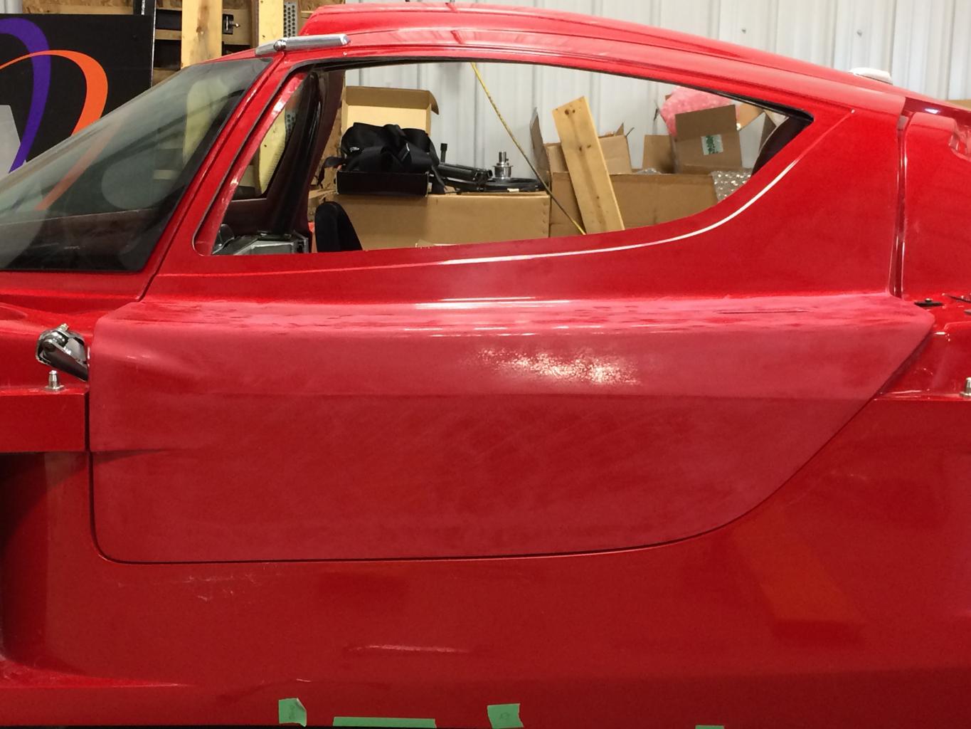

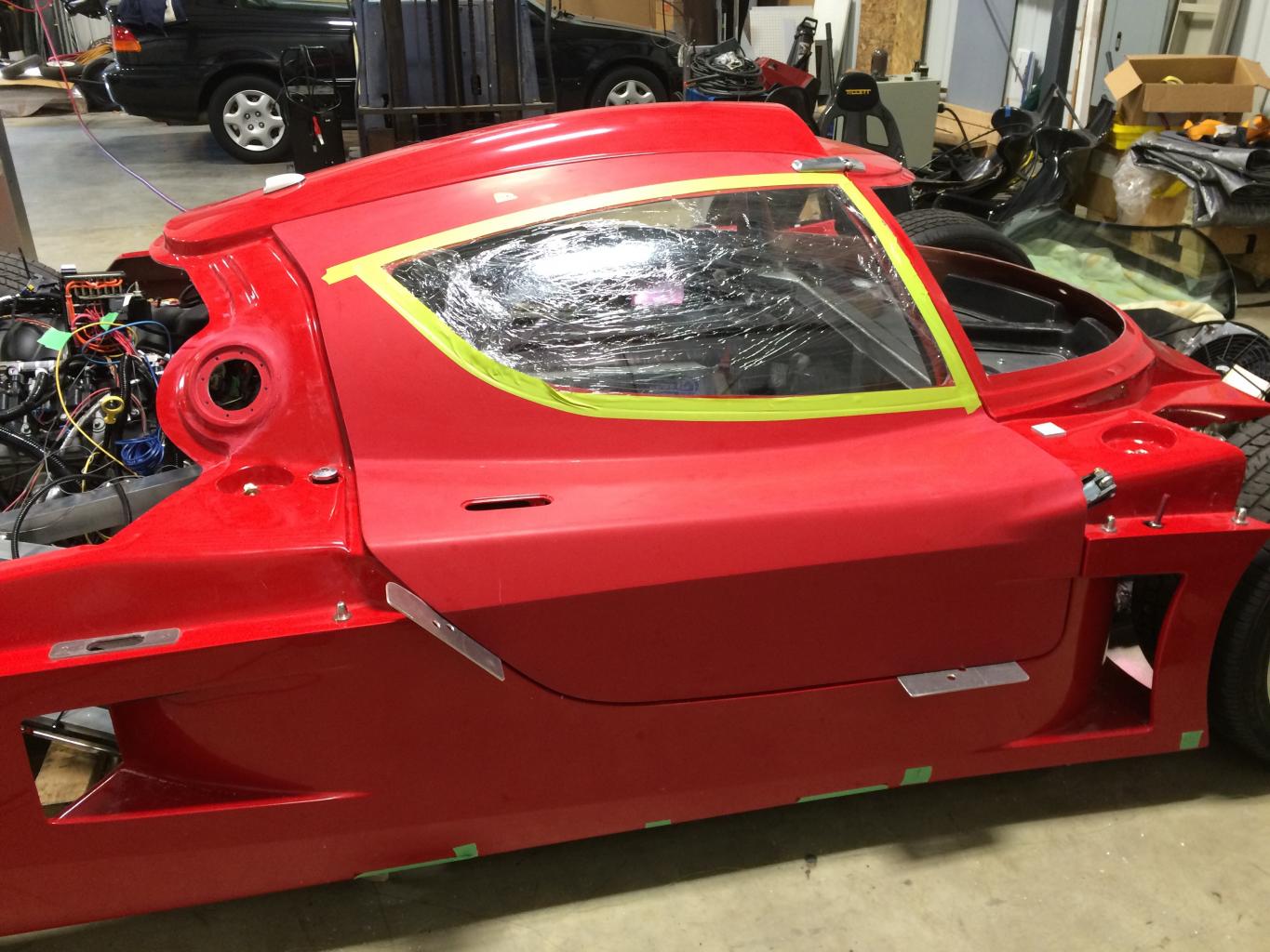

Thanks Les.. I spent a whole Saturday aligning my doors.
Several items to note:
1). I set a basic tire and wheel alignment for the chassis.
2). I stood my main body up on its end and set it at 74" width at the rear fender well openings by placing tape at that width on the floor. I then marked the bottom side of the lower main body flange to indicate the width of the belly pan of the chassis. This line can be seen easily once the body is on the chassis to confirm that the body is being pulled outward enough at the bottom.
3) Then mount set the body to the chassis and pulled the bottom flanges outward until the 74" width was met both front and back on the body.
4) I then moved the body forward and rearward to set the wheel arch opening gaps.
5) I then bolted the body to the chassis.
6) Then I test fit the doors to ensure the general fit was good.
7) I then supported the rear of the main body above the roll cage.
8) I then worked on one door at a time until the fit was correct using 1/8 inch spacers to set the gaps. I'm disappointed that RCR cuts out so much material in the front door jamb. I'm not the only one that has commented about this. There is so much material removed that I can put my whole hand in it after the door is actually fully secured to the J hinge. I'm going to fiberglass that hole back in because it just like he into the cabin.
The doors fit very well if the body is set correctly. I think most of the guys agree..
You also have to push the body out at the A-pillar to make the windshield fit correctly.
Eventually I'm going to weld tabs on the top of the roll bar in those areas. I will attach the fiberglass body at these places to prevent it from moving.

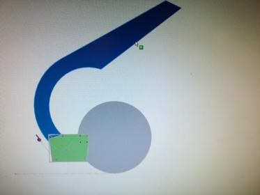

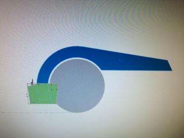

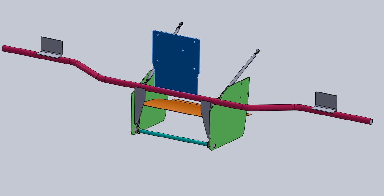

The street tail pivot assembly design is complete.

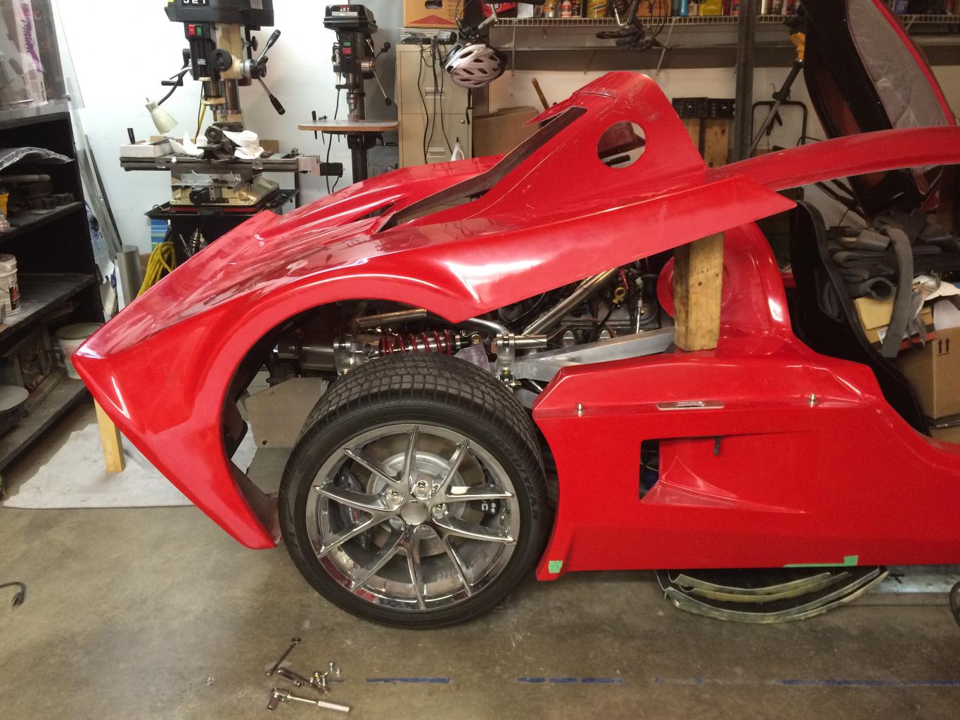

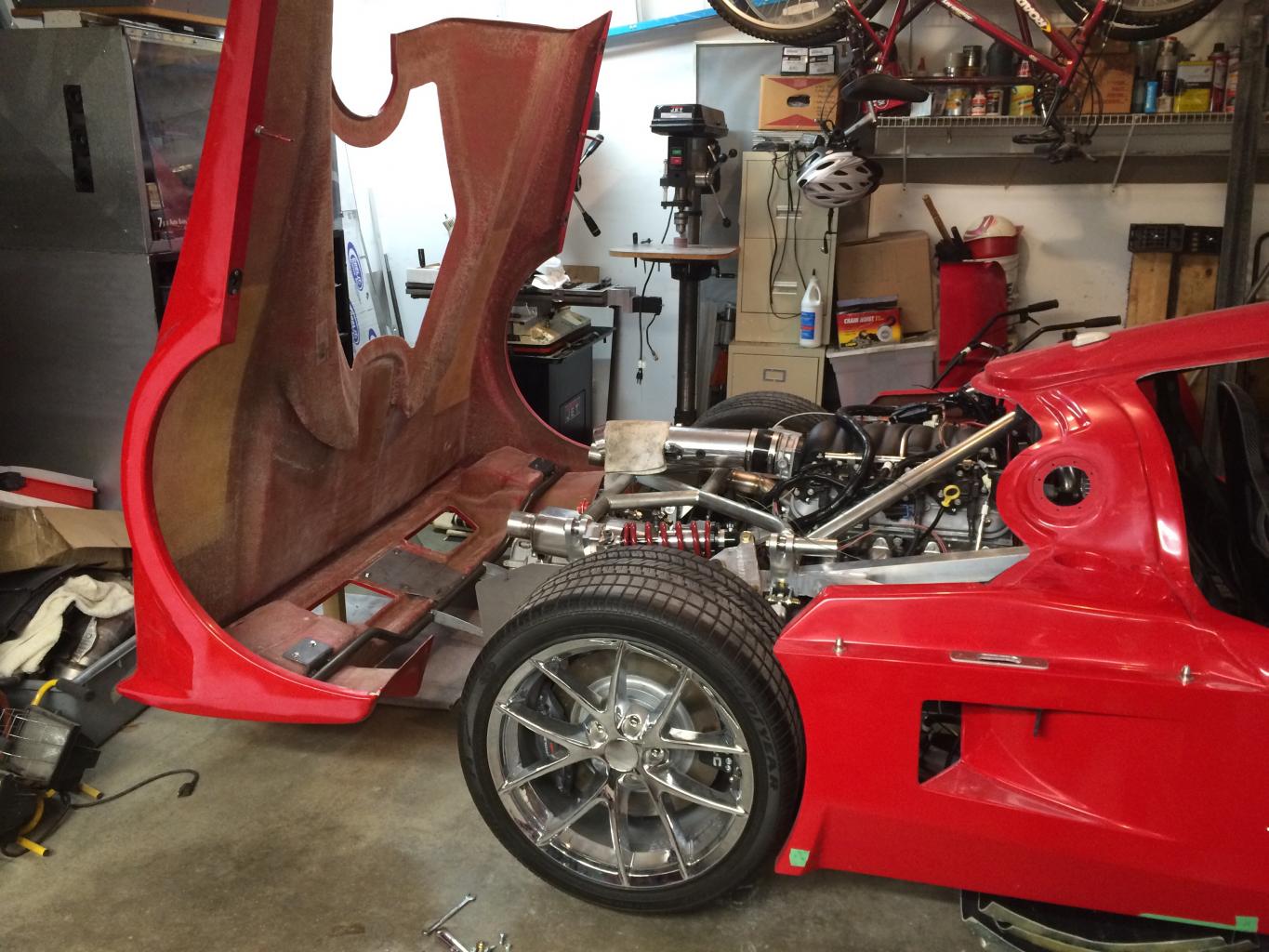

The street tail pivot lives. The fiberglass clears the rear tires and the tail pivots to a position that is past vertical. The added benefit is that I can stand behind the rear tires with the rear bonnet open and work on the engine if needed.

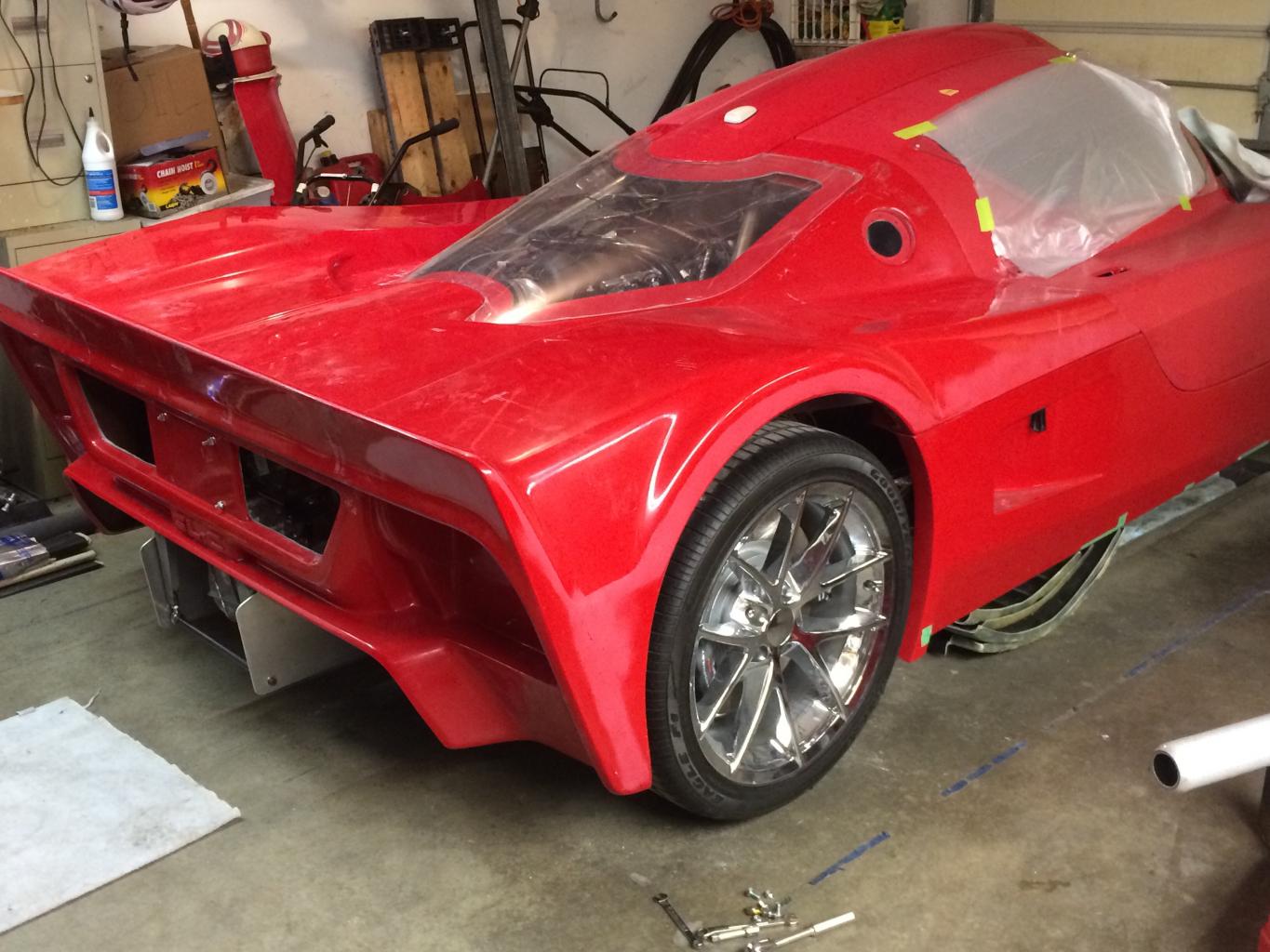

And the rear bonnet closed. The gaps look good. With a little more adjustment it will fit very nicely. The car is jacked up and that is why the rear fender arch is way above the top of the tire.

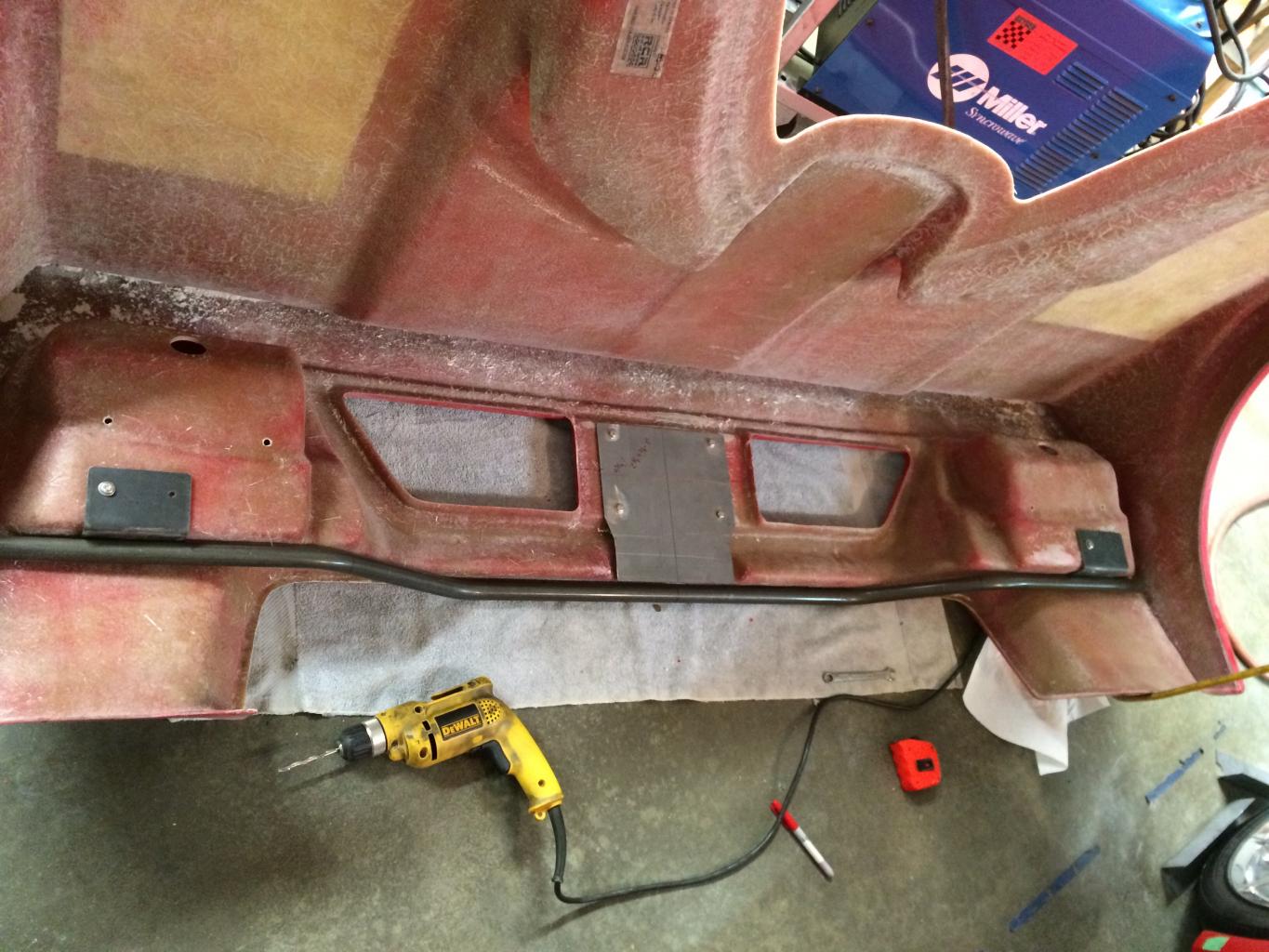

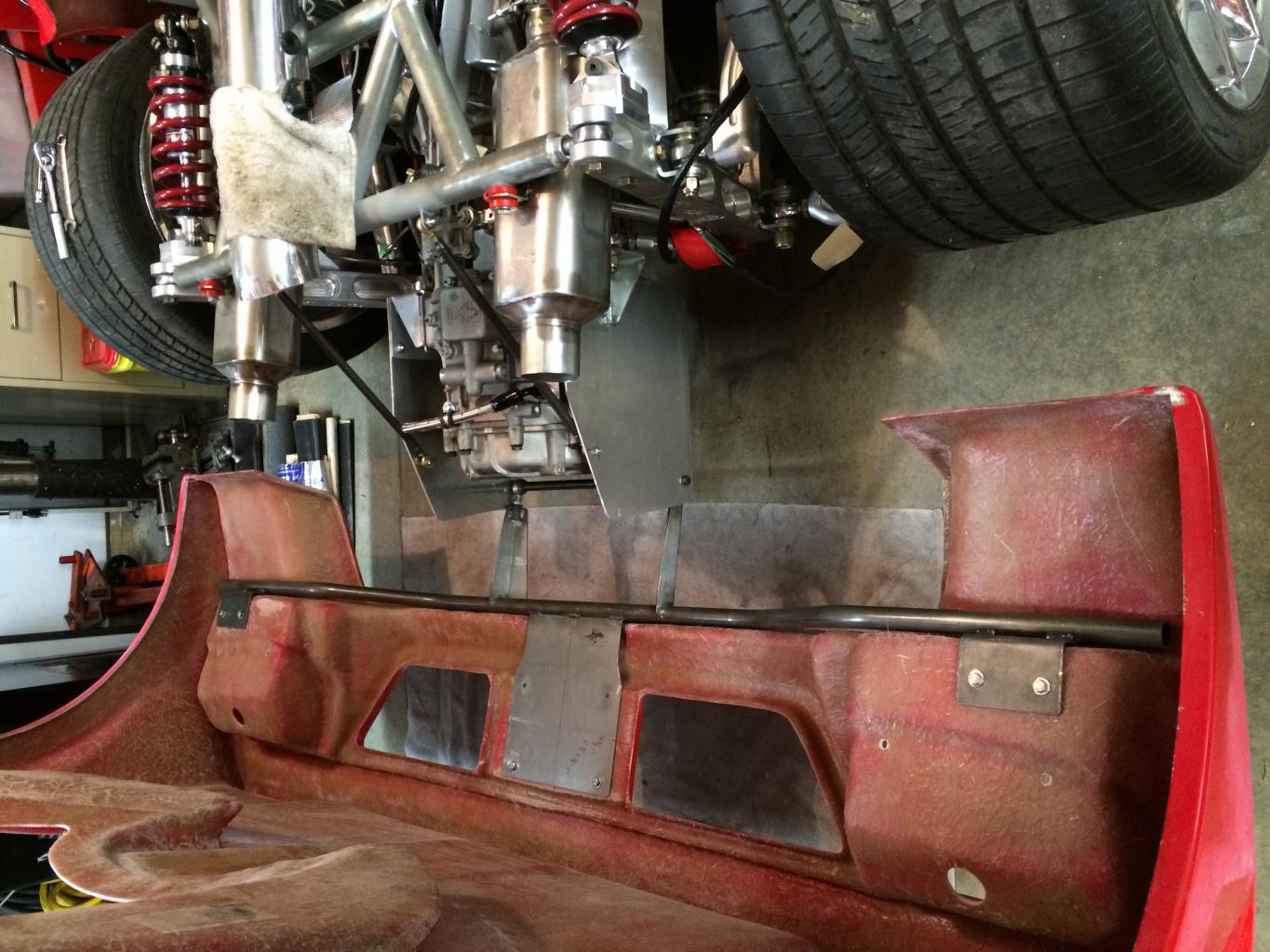

I completed the final welding on the tail support and fabricated the tie-rods this evening.

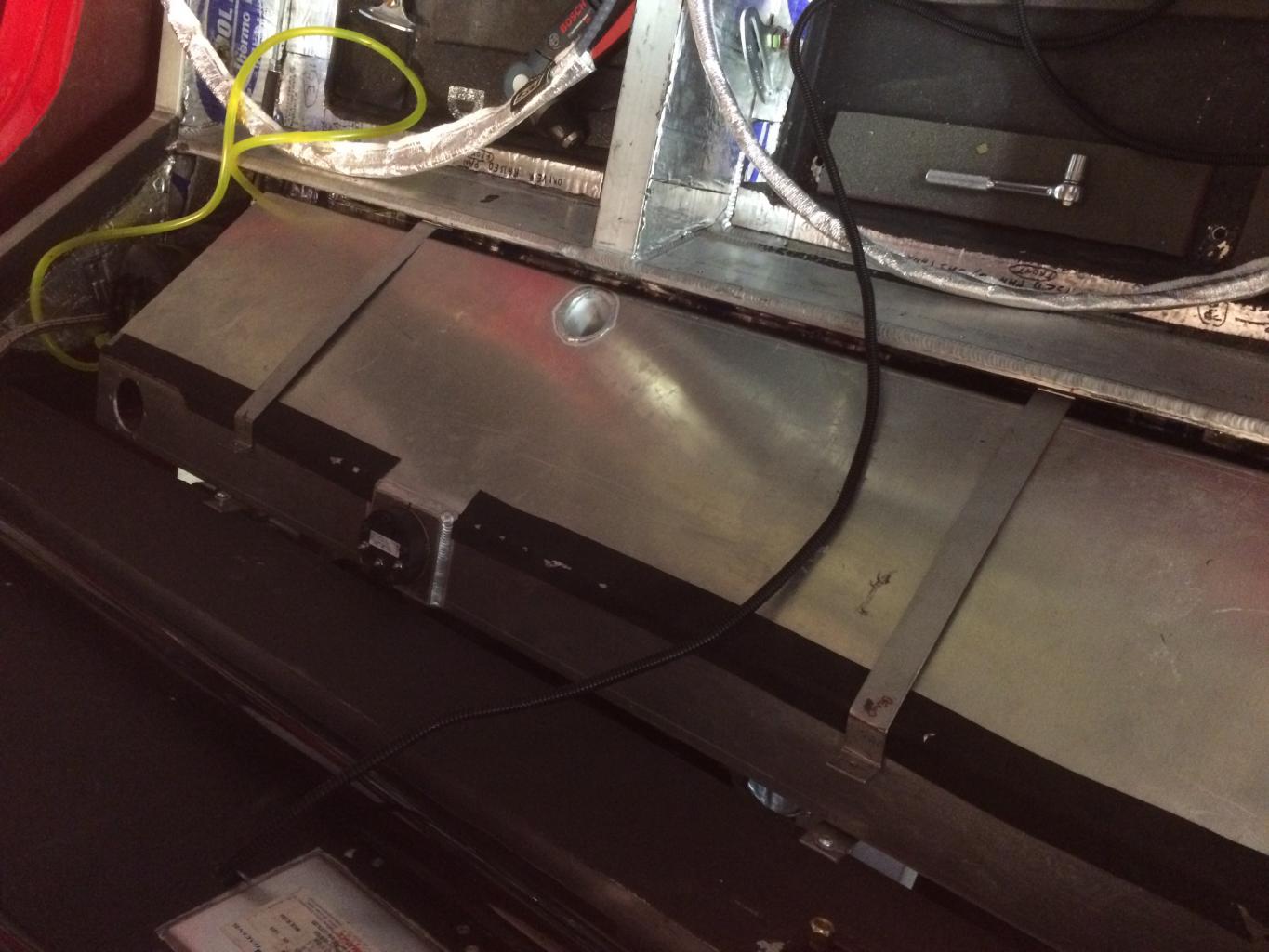

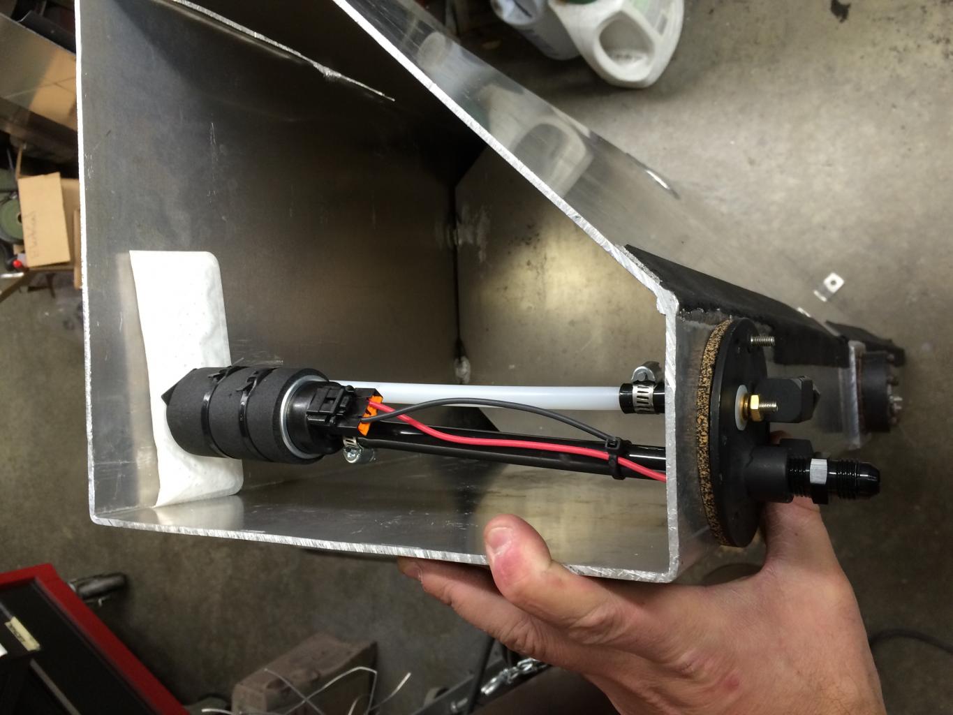

I finished assembling the fuel pump and fitting it to the tank. This afternoon I'm making the fuel tank straps.

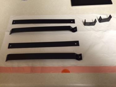

The fuel tank straps are pretty close to being complete. I just need to buy some strap insulators and some hardware...
