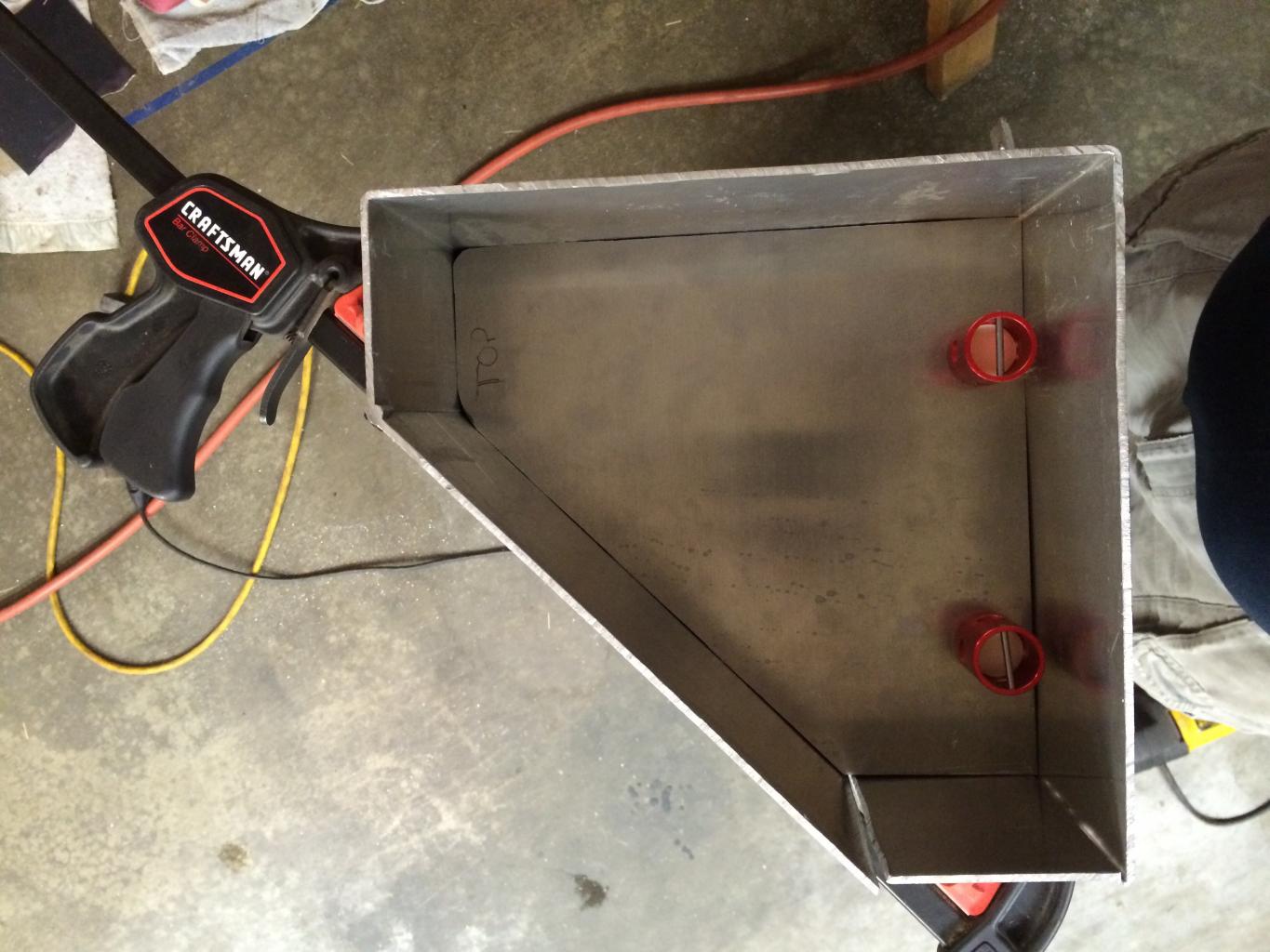

I wish I would have mounted my pump inside the tank.
Will you be fabricating a baffle around it so the pump stays submerged as the fuel sloshes from side t side?
I finished assembling the fuel pump and fitting it to the tank. This afternoon I'm making the fuel tank straps.
I am installing an additional dividing panel inside the fuel tank with fuel safe check valves.

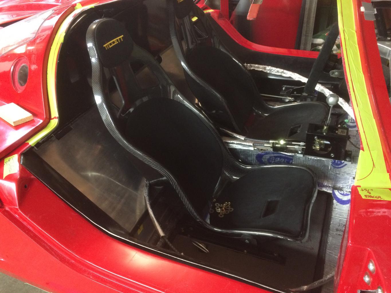

I completed the initial fitting of the inner sill panels, the headliner and the rear bulkhead panels.

Where did you get your shift knob?
Oh, and lessoned learned from my build - don't try to fit the roof panel/headliner until you get the windshield installed.
