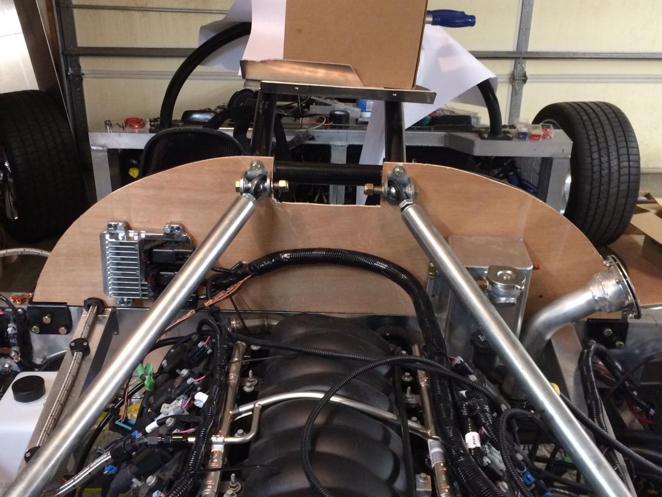

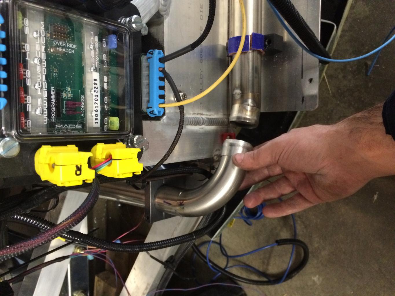

I created a new bulkhead panel layout. The new arrangement eliminates the interference to the expansion tank and opens up a good spot for the ECU. Moving the expansion tank to the passengers side allows an easy and short cut-in to the inlet heater hose. I was able to clear the fuel filler neck as well.

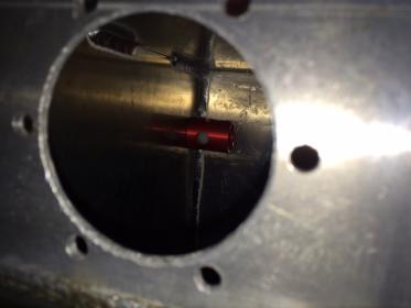

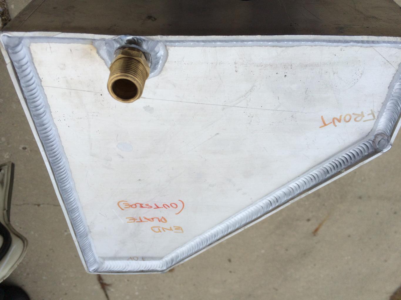

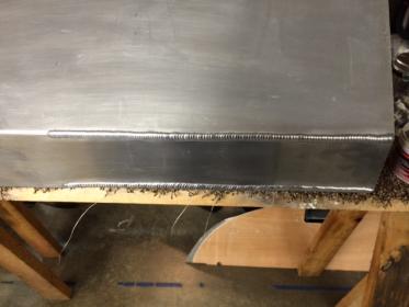

More fuel tank photos.. The next couple of weeks a lot of things are going to happen on my SL-C. I'm getting ready to open a can of whip ass on it...

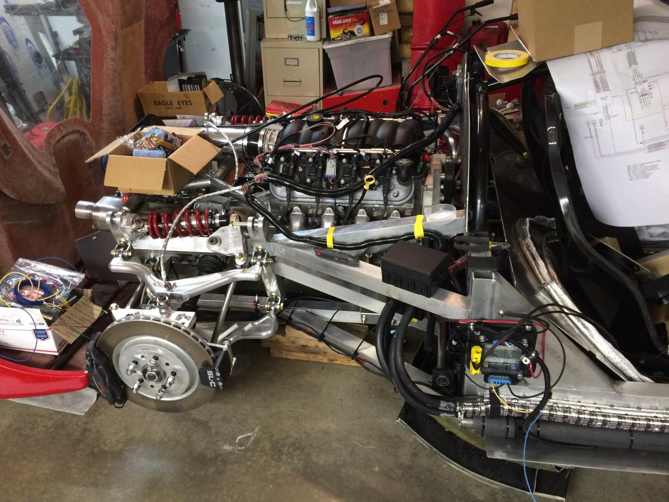

Fuel pump installed. Lower bulkhead installed. New steering rack bracket is fabricated and painted. Clutch is fully bled and actuation is tested.

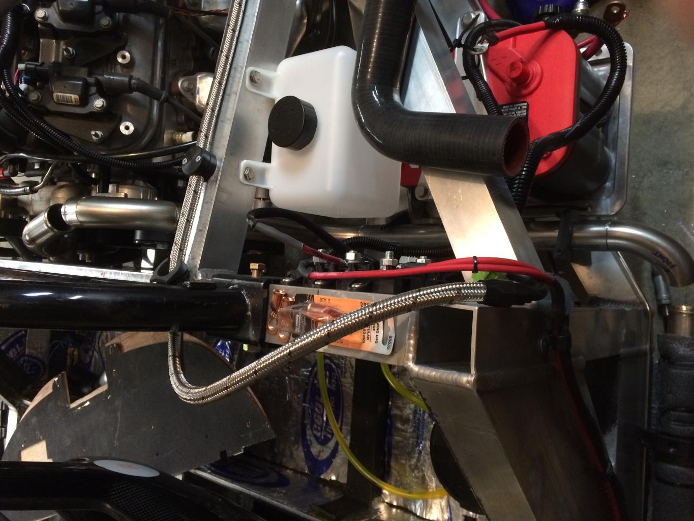

Steering rack is re-installed with the new bracket. I spent a good part of today tacking up and fabricating pipe sections for the radiator piping.
