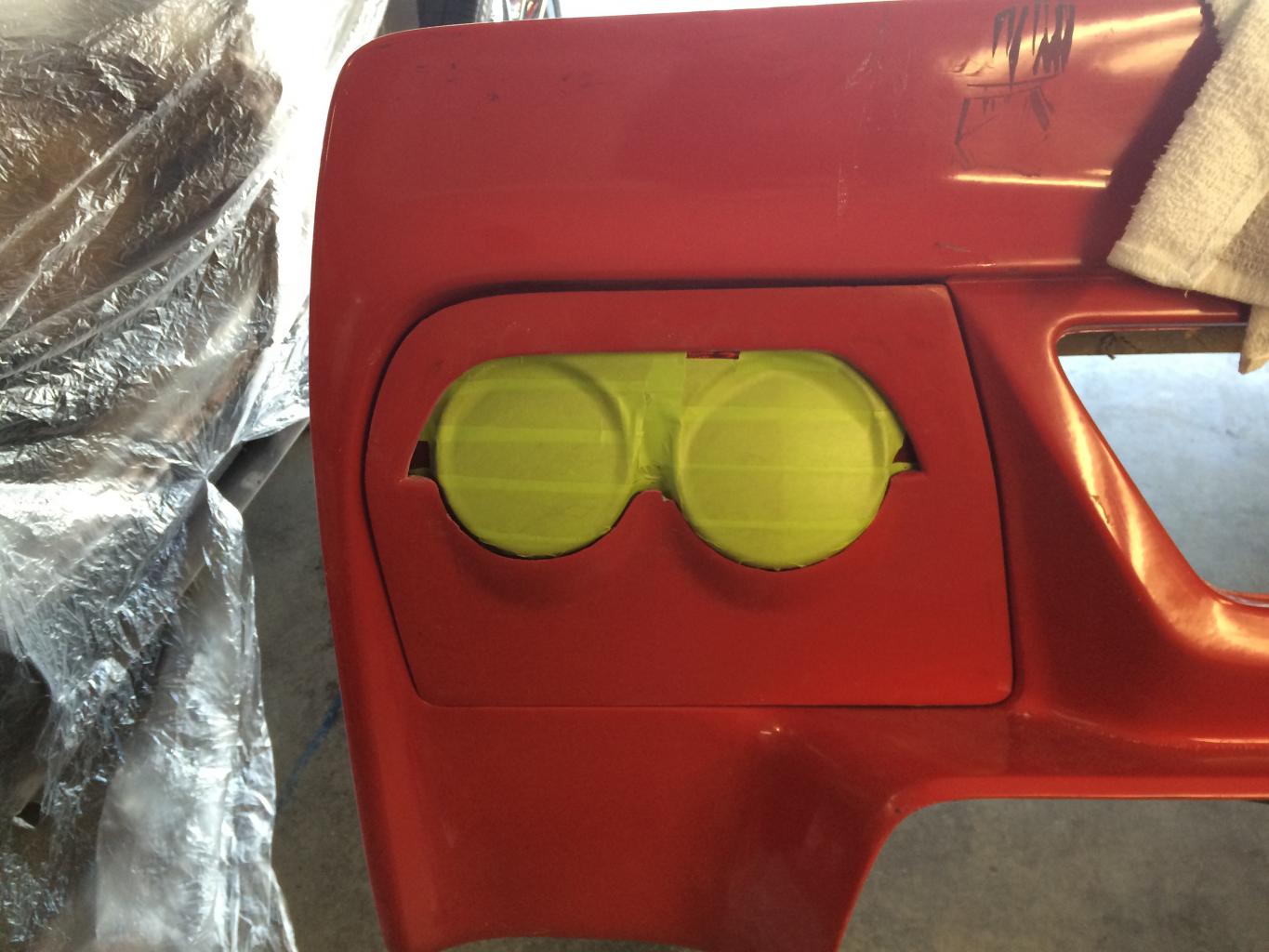

Trimmed out the door openings of the main body. Trimmed out other areas of the main body as needed. Trimmed and final fitted the tail lamp covers. Fixed my "horn button starts my car" issue by swapping wires in the master cell connector. Started to prep the anchor for fiberglass repair ( lengthening it ) so it fits correctly. Fully secured the fuel tank. Inserted 5 gallons of gasoline. Banded thermal wrap on the shifter cables. Ordered a blue-tooth receiver for my audio system. Ordered back-up camera w/ wifi. I'm planning on setting this up through an iPad initially for testing. I also ordered a GPS speedo and quad gauge setup from Speedhut.

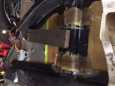

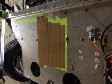

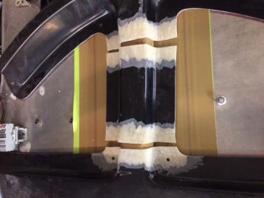

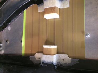

A little fiberglass work this morning.

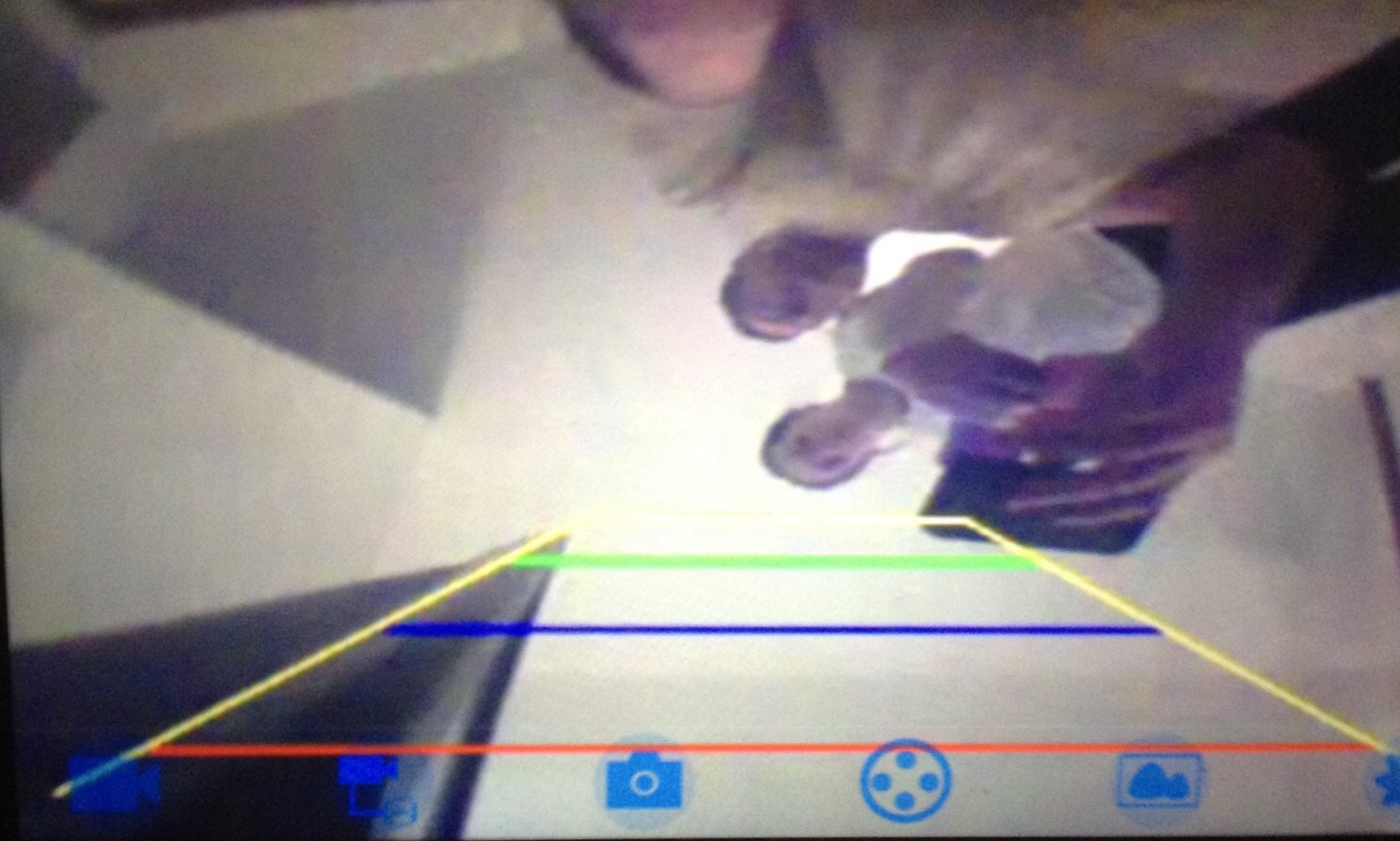

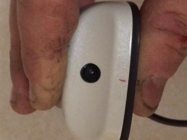

I fired up my backup camera in the living room tonight.. I had a bit of trouble initially but now it's happy. It's a bit grainy but what to expect for a$20 mini cam. I can improve it later as needed.
The body goes back on fairly soon.. It's time to sand the main body out and work on fiberglass modifications :)

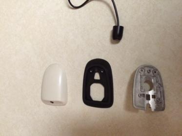

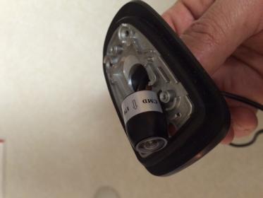

This evening I worked to fit backup camera into the roof antenna housing.
A little machining and here it is..
