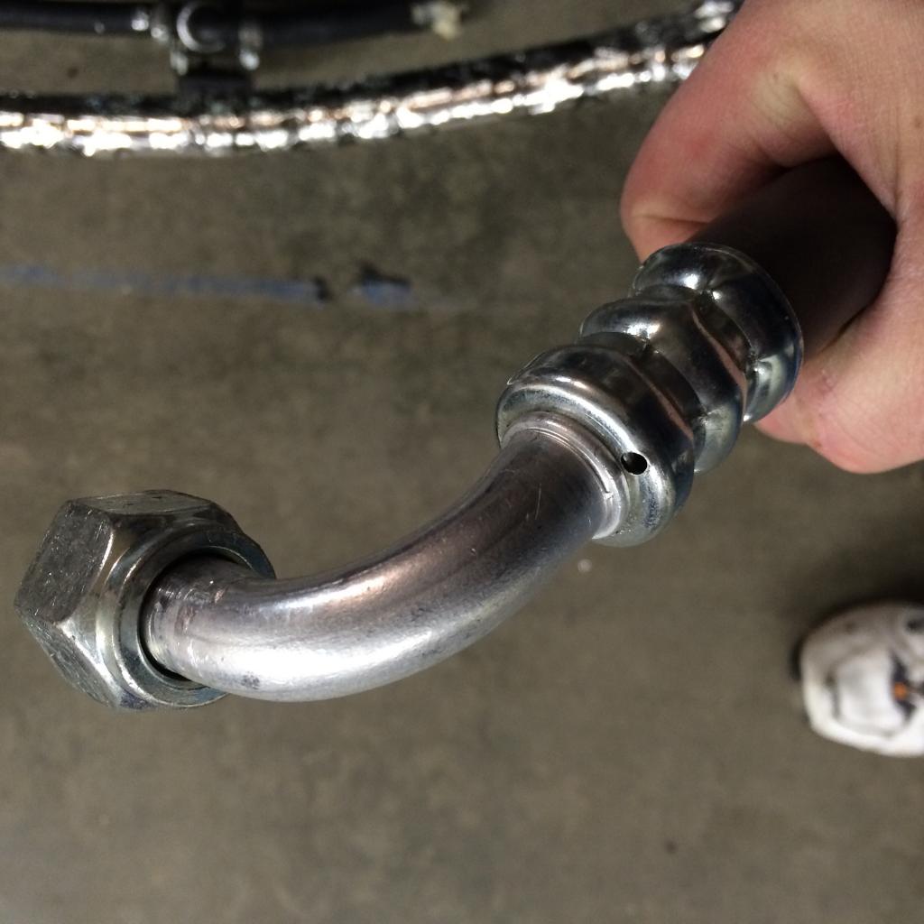

Hey dipstick..... These fittings have a viewing window drilled in them for a reason. Tell all of your friends... Glad I'm checking every detail..
A/C fittings ordered and they should be in tomorrow. A/C equipment received. I'm hoping to put this to bed and leak check the system this weekend. It should be the last item before I put the body on again.

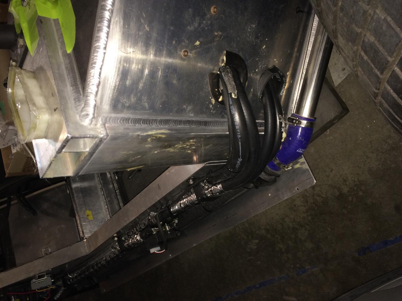

More fiberglass work today and a few other little details... I fabbed up a block off plate for the starter hole for the LS engine to Graziano transmission.
I reorganized the hoses running up the passenger side last week. I relocated the hot water valve outside of the passenger compartment.

Eric:
There are two-(2) 2 1/2" dia. Holes placed by the previous owner.
I plan to clean up what I'm using to surround the holes in a bit. I used some hose for now but planning C-channel trim.

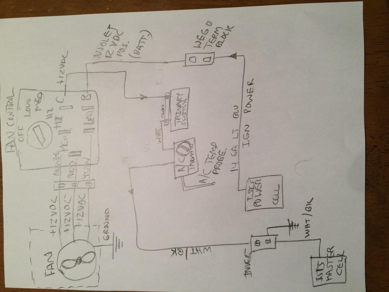

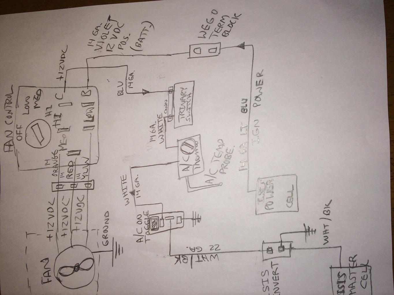

I'm hoping that this A/C wiring is correct. This allows my to run my blower fan when I need heat and also prevents A/C from running at the same time. I think :)
Comments welcome. Maybe I need an additional toggle switch in the trinary circuit to prevent that circuit from coming on totally?

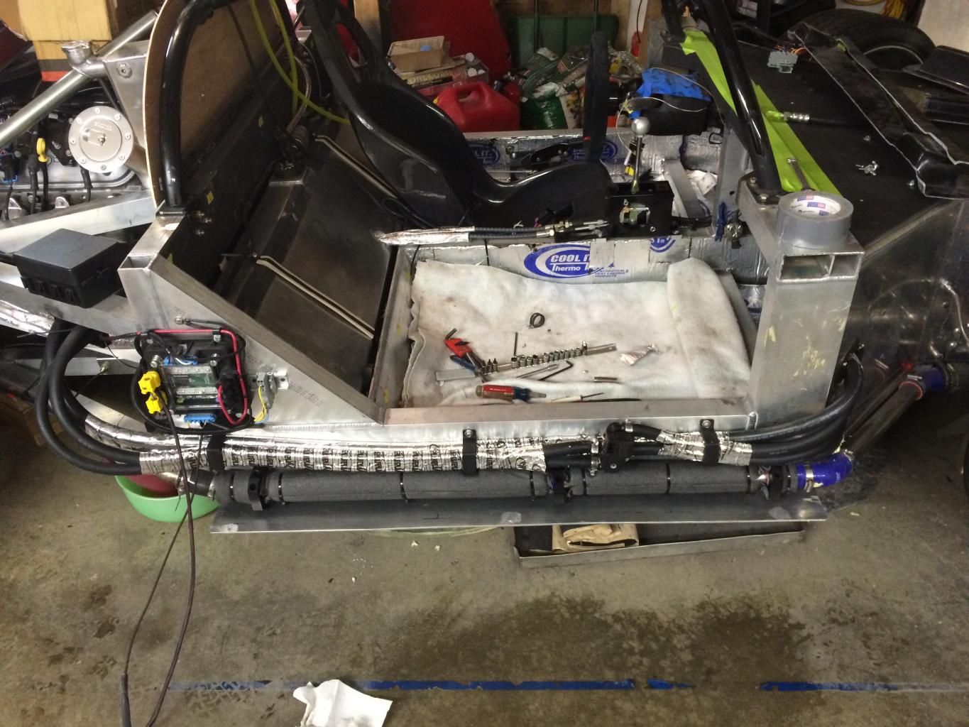

Michael Fling
Aaron,
Great job as usual. I saw your pic on post #374. Can you get to the box with the body on in the event you loose a fuse? Keep up the good work!
Mike:
I should be able to get to it fairly easily if needed. Even if I need to raise the body a bit that's not that big of a deal either. Overall I'm weighing a clean appearance slightly over serviceability. I hope that the mean time before failure outweighs the need to relocate it.
