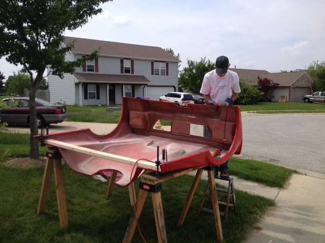

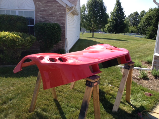

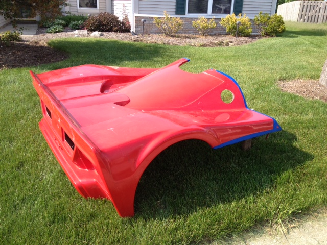

I worked on the rear bonnet all day today.
Diffuser cut out, exhaust area is cut out.
Started sanding the mold parting lines down.
Aaron, I waited till last to take out the back window, its not hard, and it makes that back part more rigid, but thats me since I have no help here to flip things over.

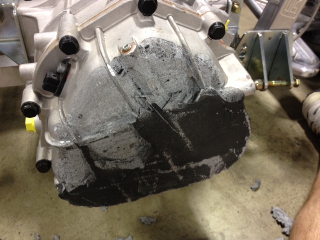

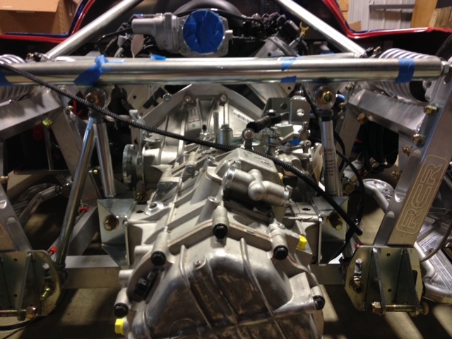

Tonight I took 2 hours to remove the sound proofing material from the rear of my Graziano.
I know... The photo shows 1/2 way complete.. I actually finished it. I'm gonna feel that in the morning.
Reason for cleaning off the sound deadening material off of the back of the transmission.
1) I've cut out the lower section of my street tail because I'm installing a diffuser :thumbsup: The rear of the transmission will be easily seen so I want it to look clean.
I used a wood chisel and a rubber hammer. The rubber hammer isn't very aggressive so less chance of shaving aluminum off the trans case. The project was successful. I plan to hit it with a wire wheel to remove the remaining material. I'll post photos tomorrow evening. I've already removed the foam material but didn't wire wheel it yet.

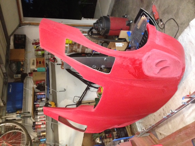

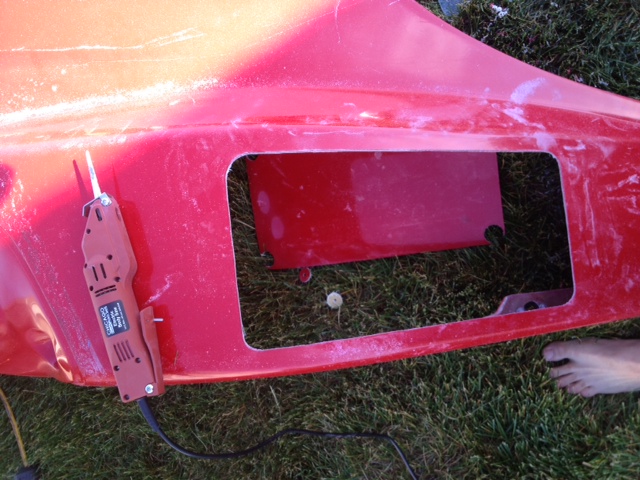

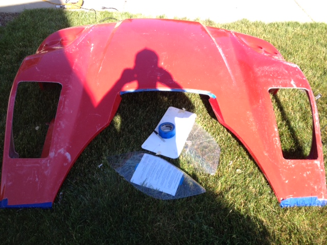

Today cut the openings for the carbon fiber louvers in the front bonnet. I've also sanded out all of the mold lines and I'm getting started on securing the headlamp covers.
Sand to bonnet... Sand sand the bonnet.. :)
The body panel cutout tool is from Harbor Freight and makes quick work of cutting out the fiberglass. I'm using air saw blades from Lenox # 424T

I love that HF electric body saw. I recently purchased my second one. The first one lasted over three years :thumbsup:.
