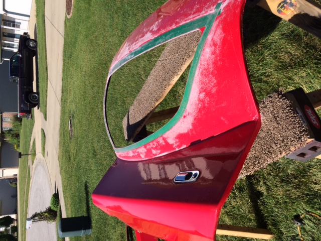

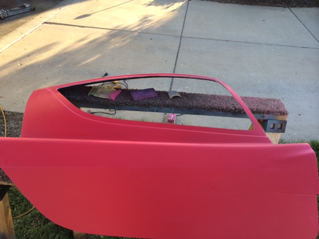

1) Cut out the door windows.
2) Removed the door hinges, latches, etc.
3) Block sanded one of the doors to 400 grit.

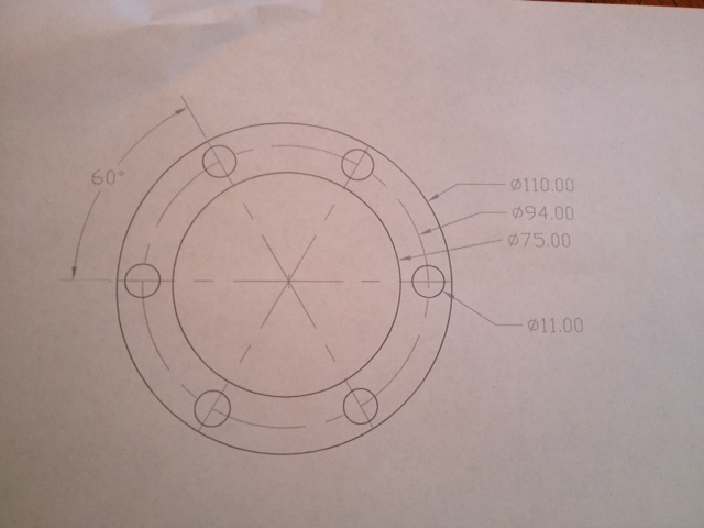

10) Confirmed that the Graziano starter bolts are indeed M12 x 1.5 by 30 ~ 40 mm long. You choose the length to your taste.

14) Made CV joint cover plates to the stub axles and to the Graziano.

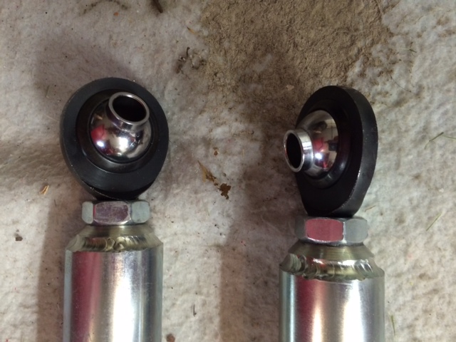

The photo of the hiem ends is to show that they were installed bottomed out (no adjustment) on my chassis.
I've also been changing many bolts on my chassis since many were just too long for my preference.
