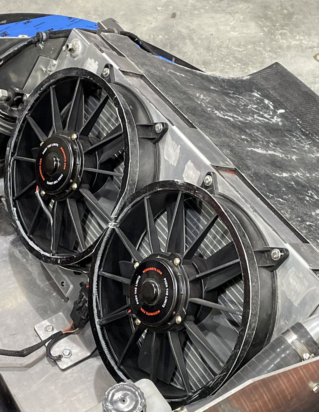

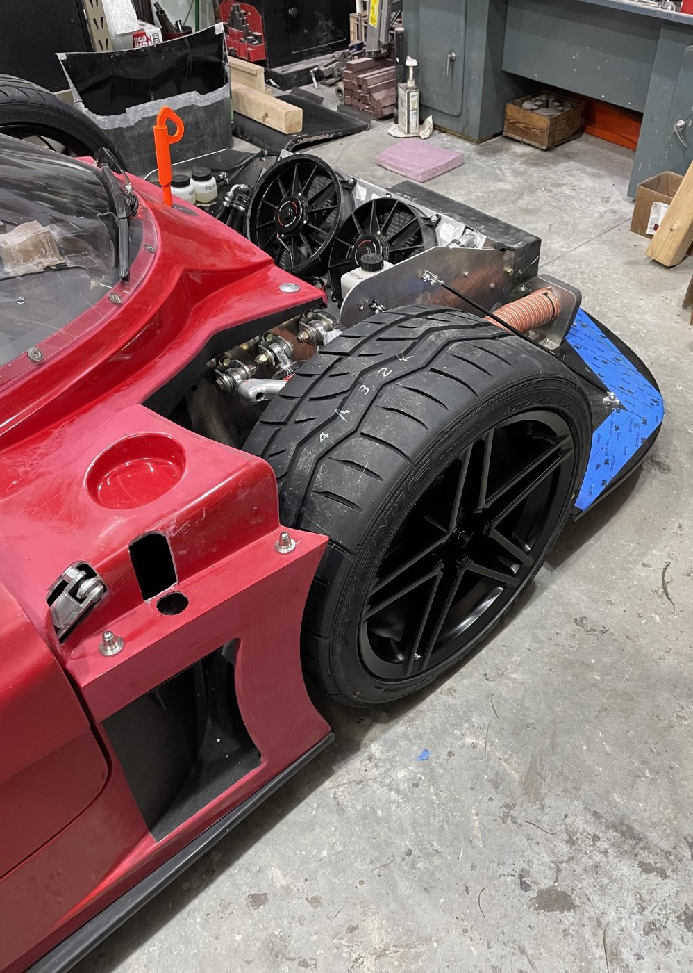

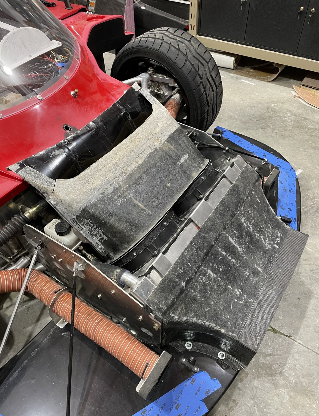

I’m installing flanged rings for the radiator fans. I’ll be mounting the outlet duct soon.

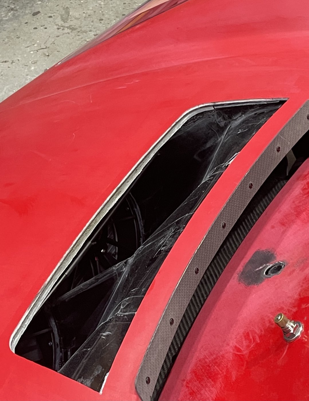

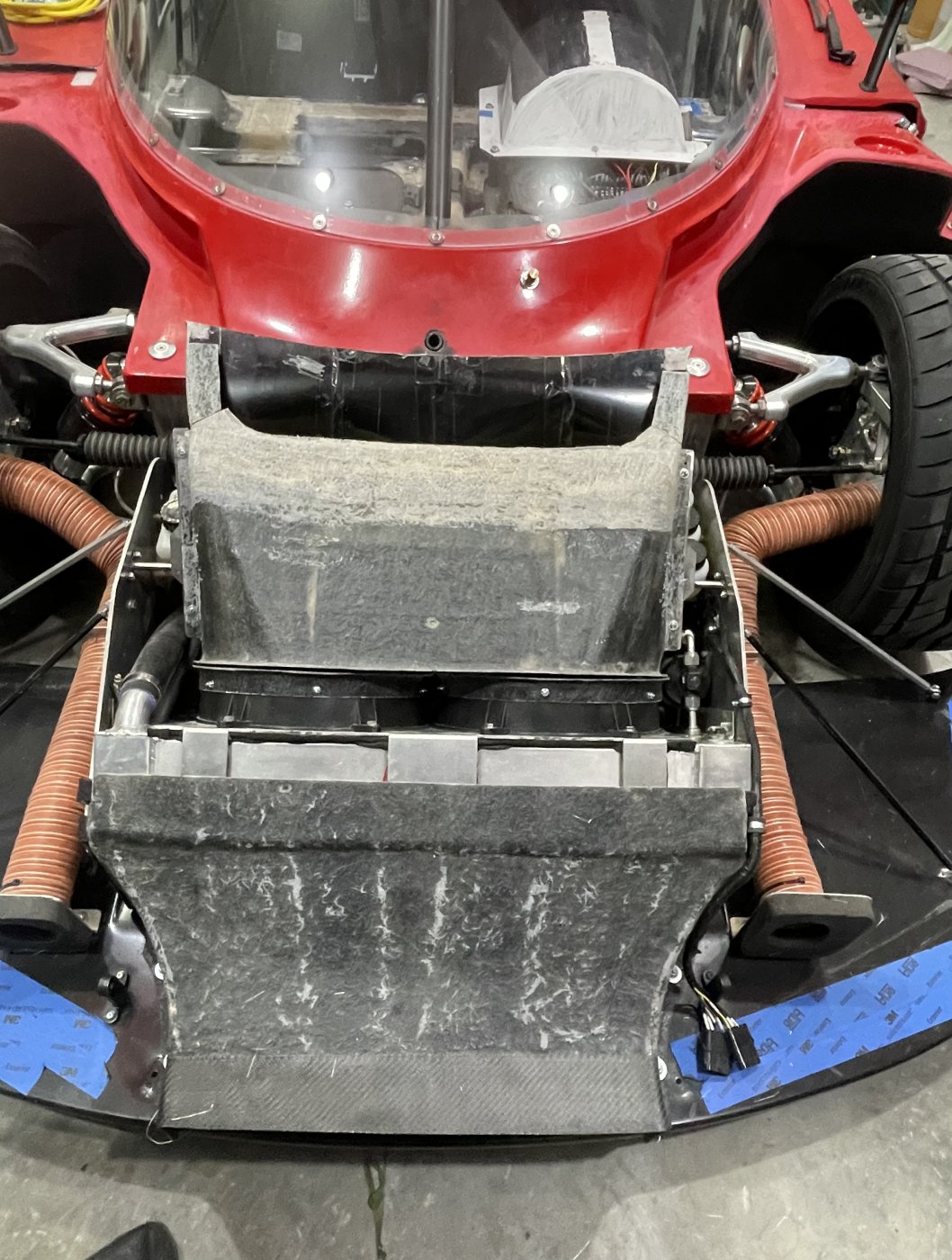

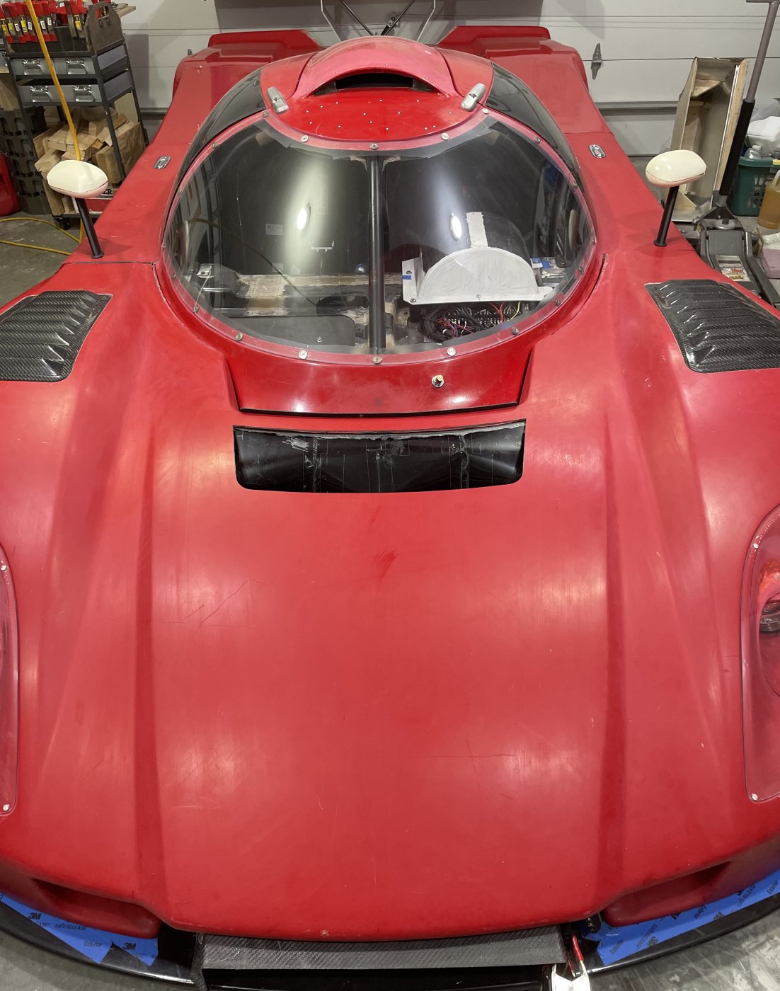

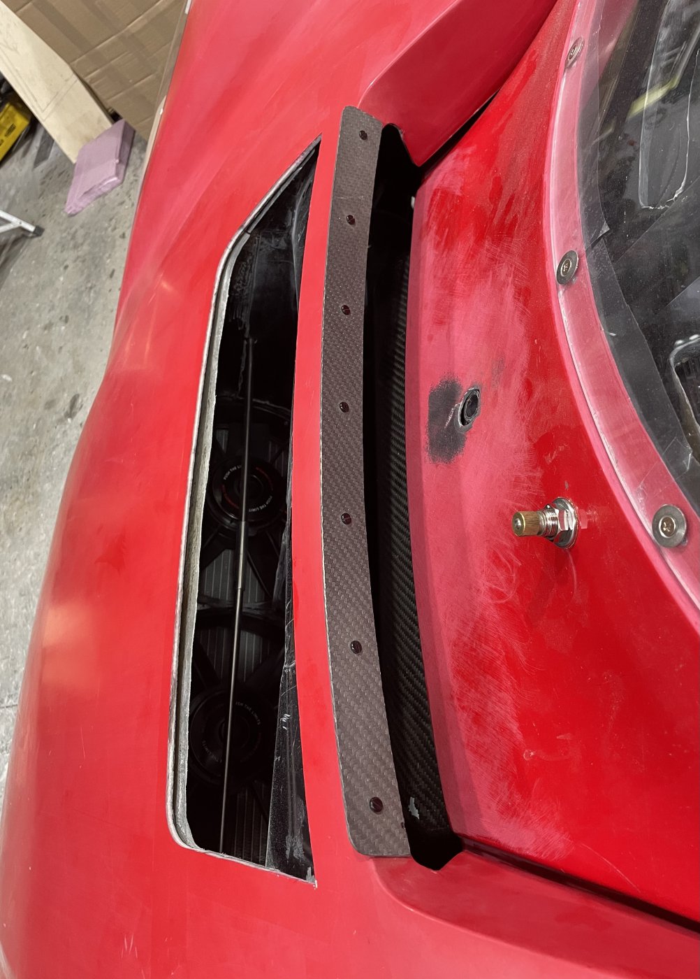

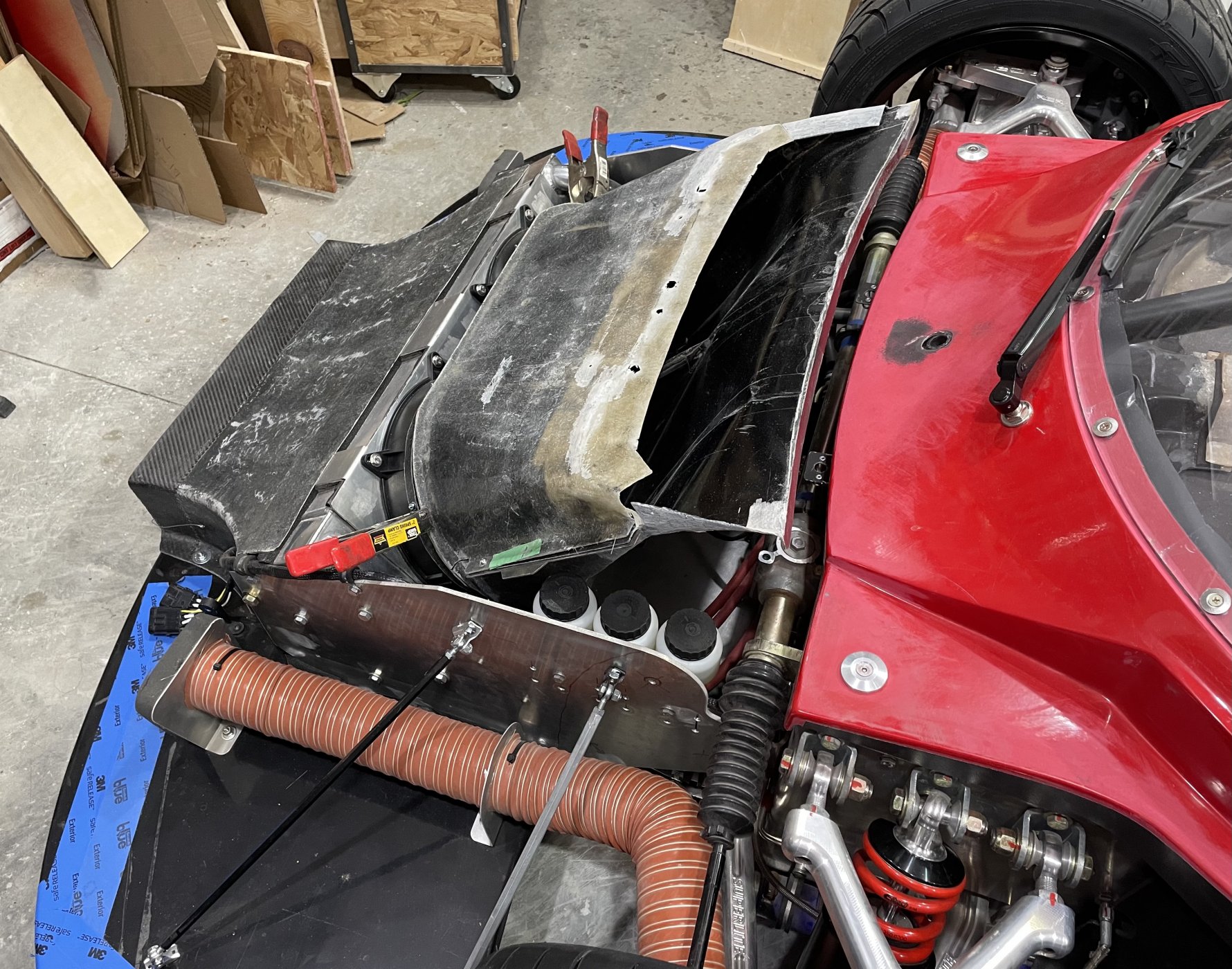

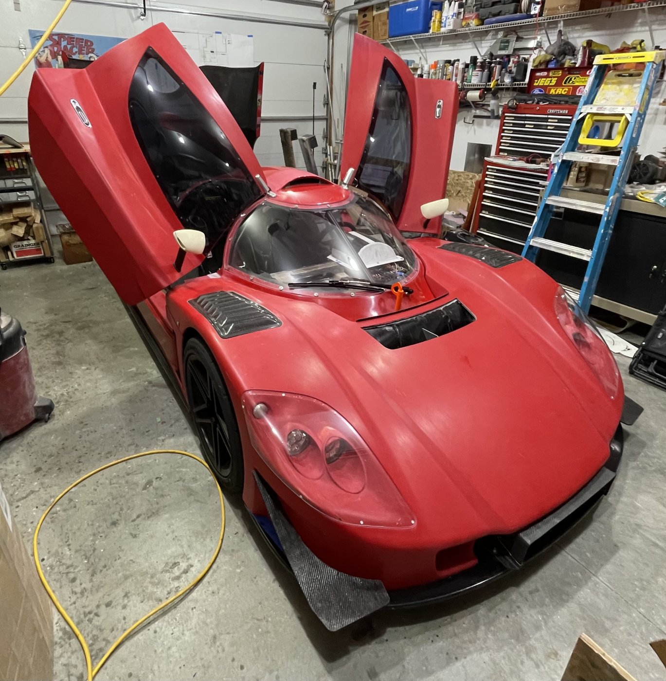

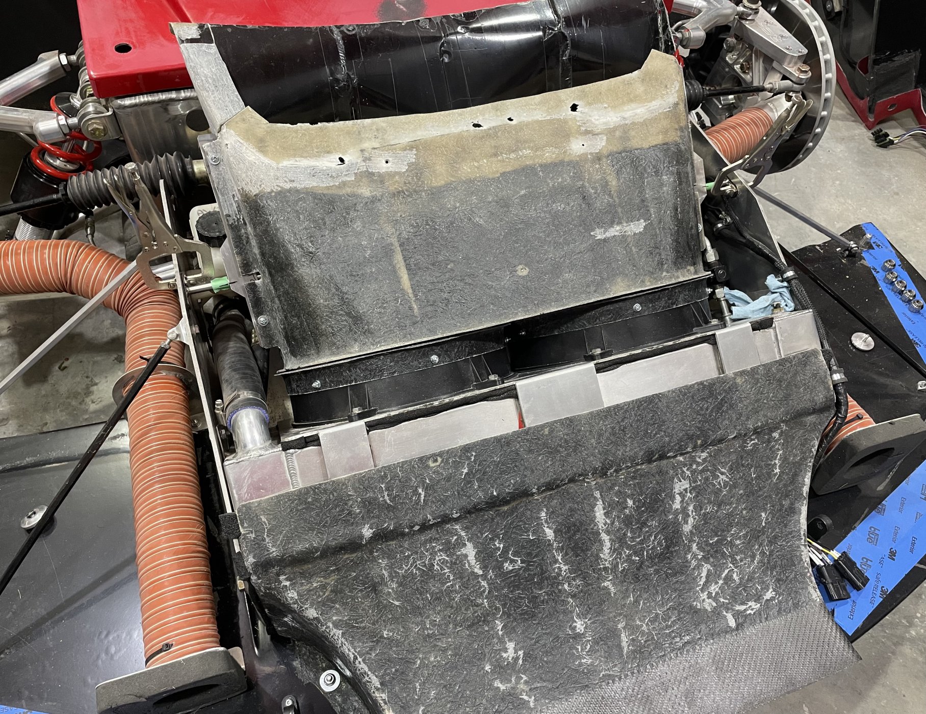

My radiator outlet duct has been a long time coming and today is the first drive with it installed. I’m anxious to see how much heat this drives away from soaking the foot box area. This modification is going to be really important to improve the capability of the A/C in the passenger area.
Make some molds and sell these. No serious build should be without this. This modification is not necessary if you are cruising at minivan speeds to car shows with a stock GM crate motor. I would also expect it to significantly decrease the amount of front end lift at higher speeds.
The radiator outlet duct is very effective at moving the radiator heat out and away from the foot box. . Next is vacuuming down my A/C and checking for leaks.

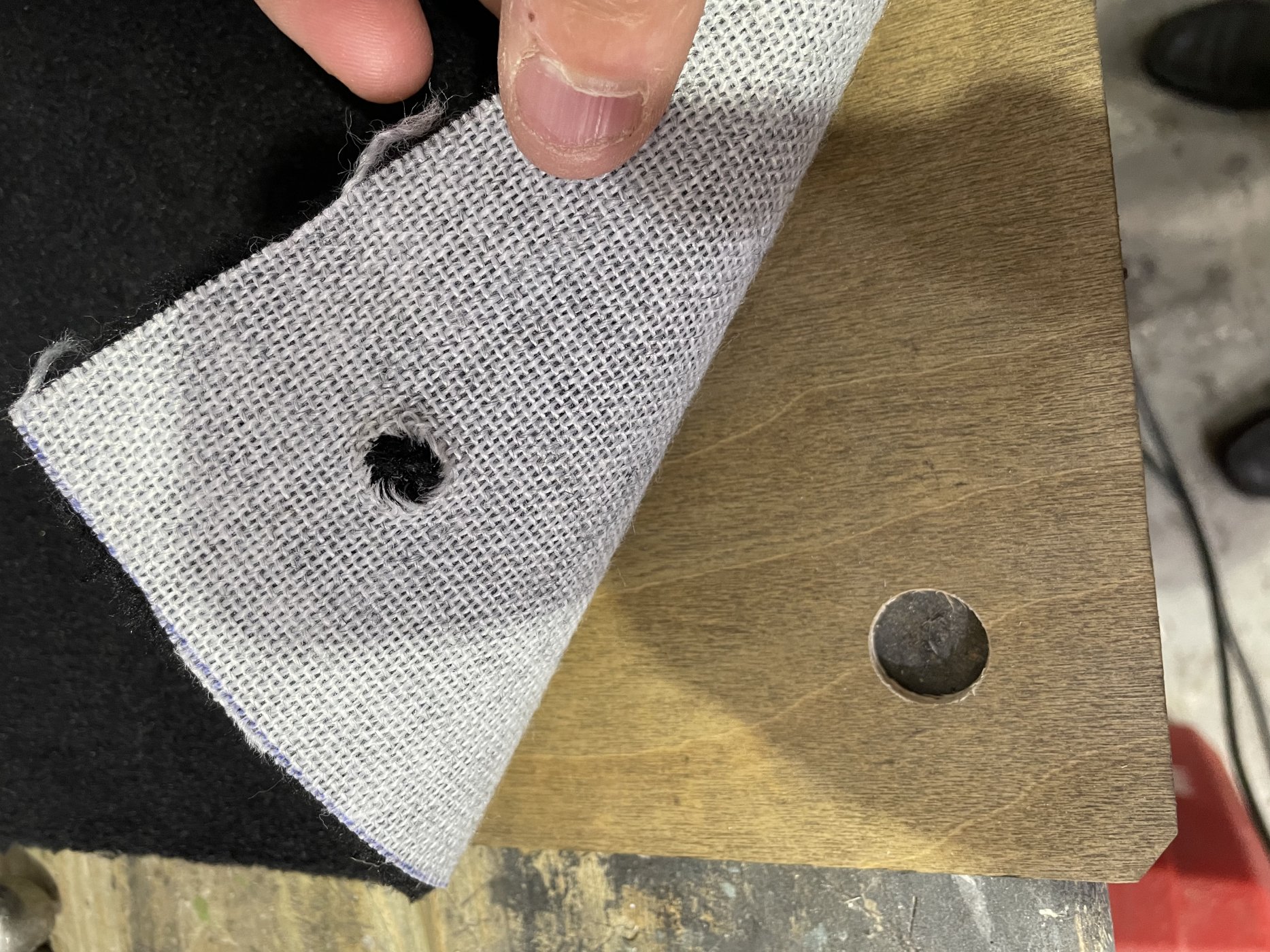

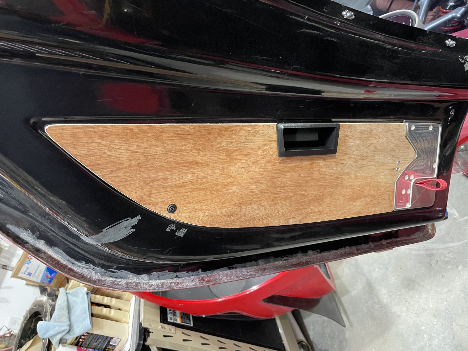

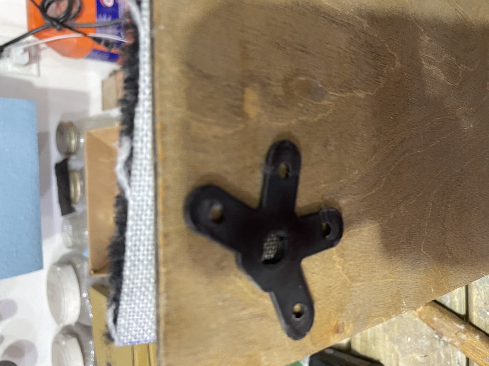

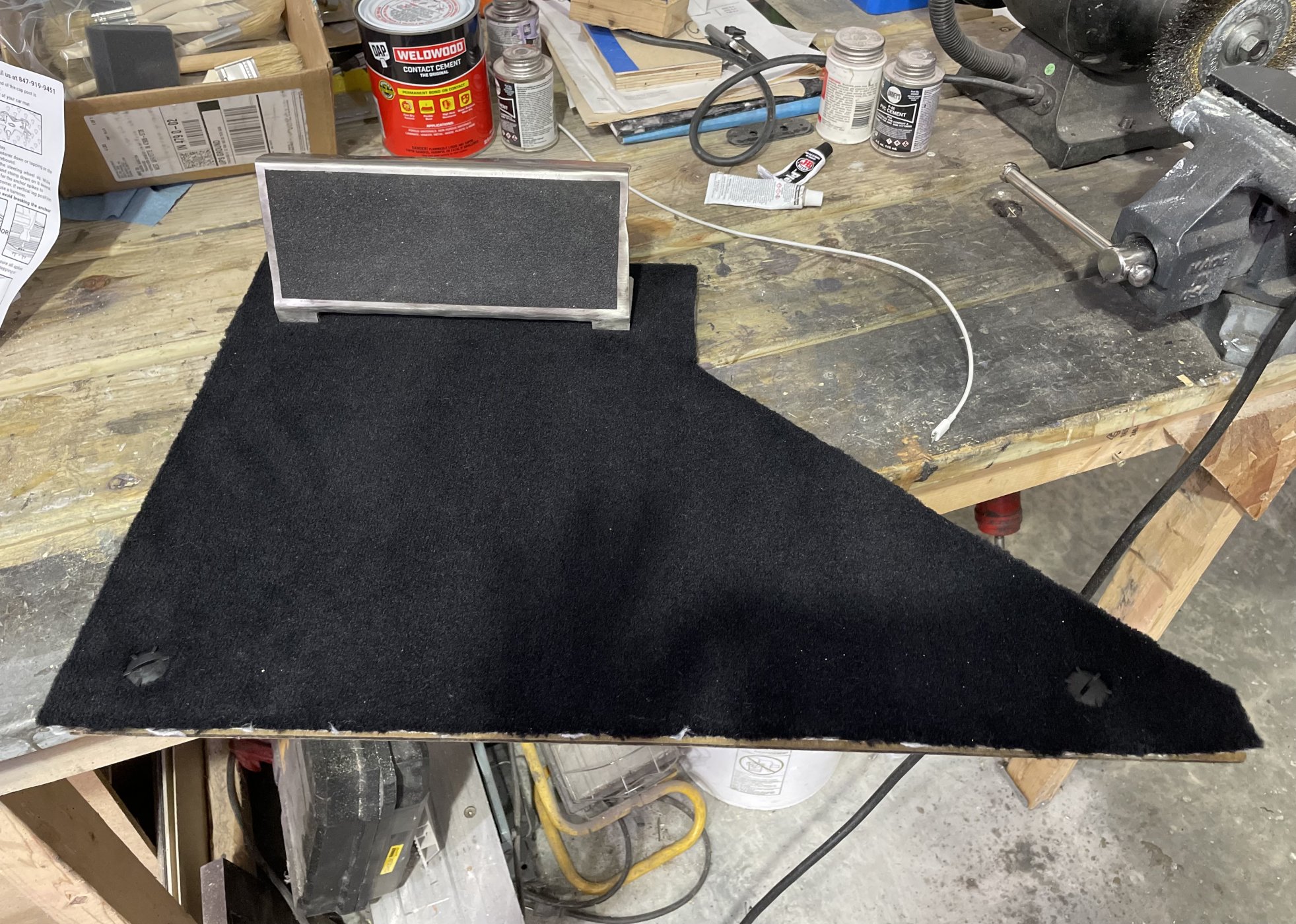

I’m dabbling in some upholstery…

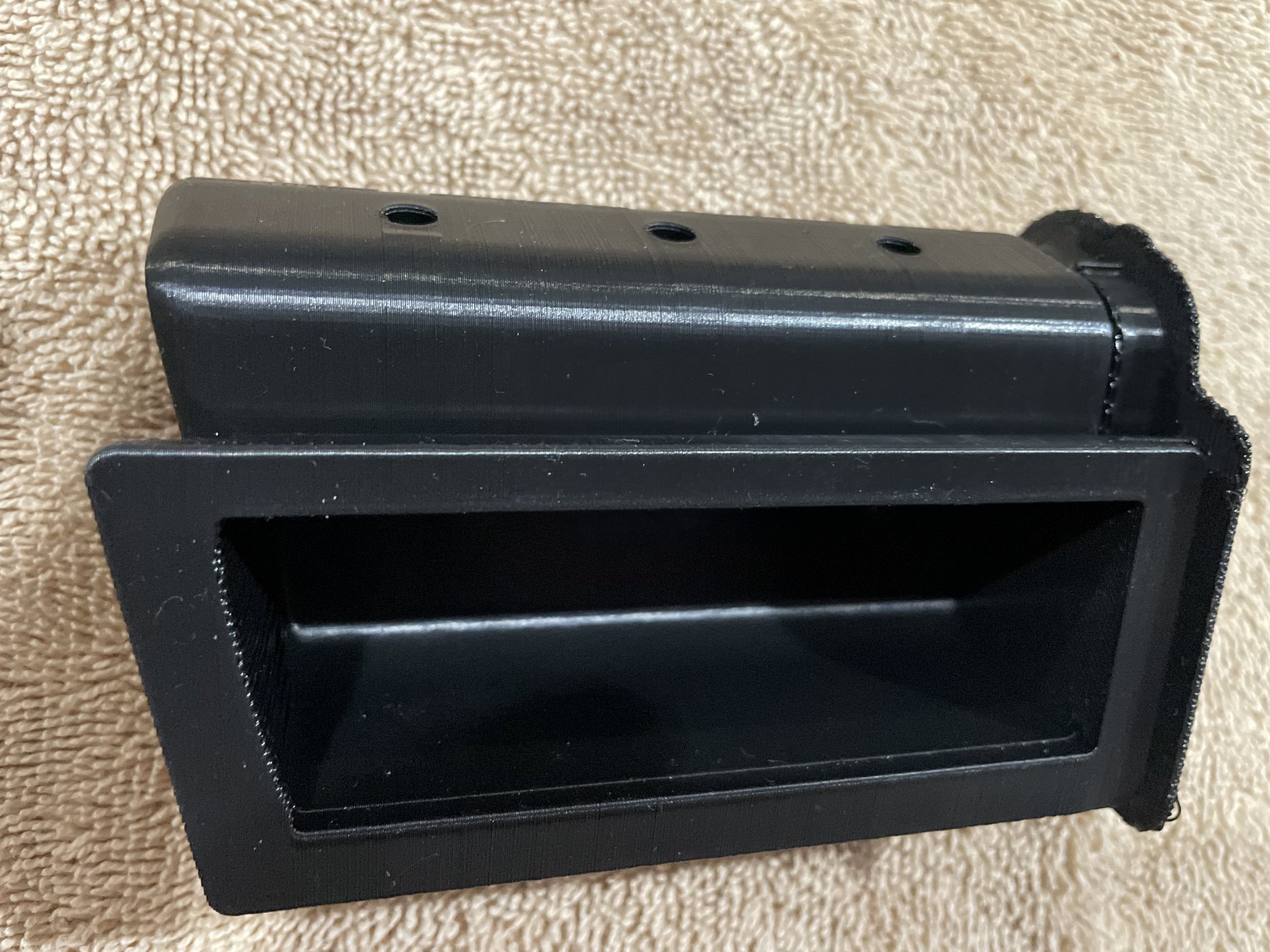

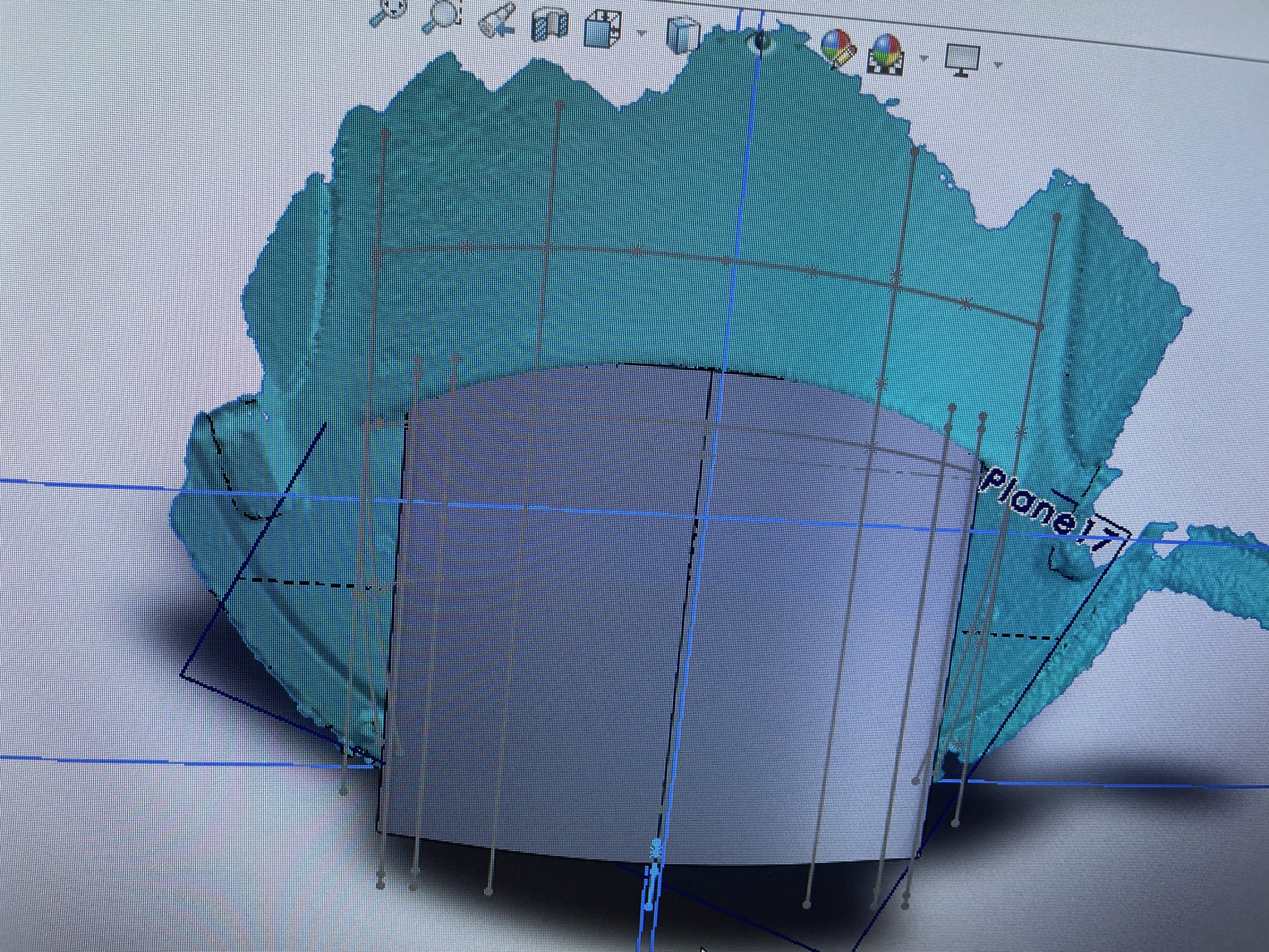

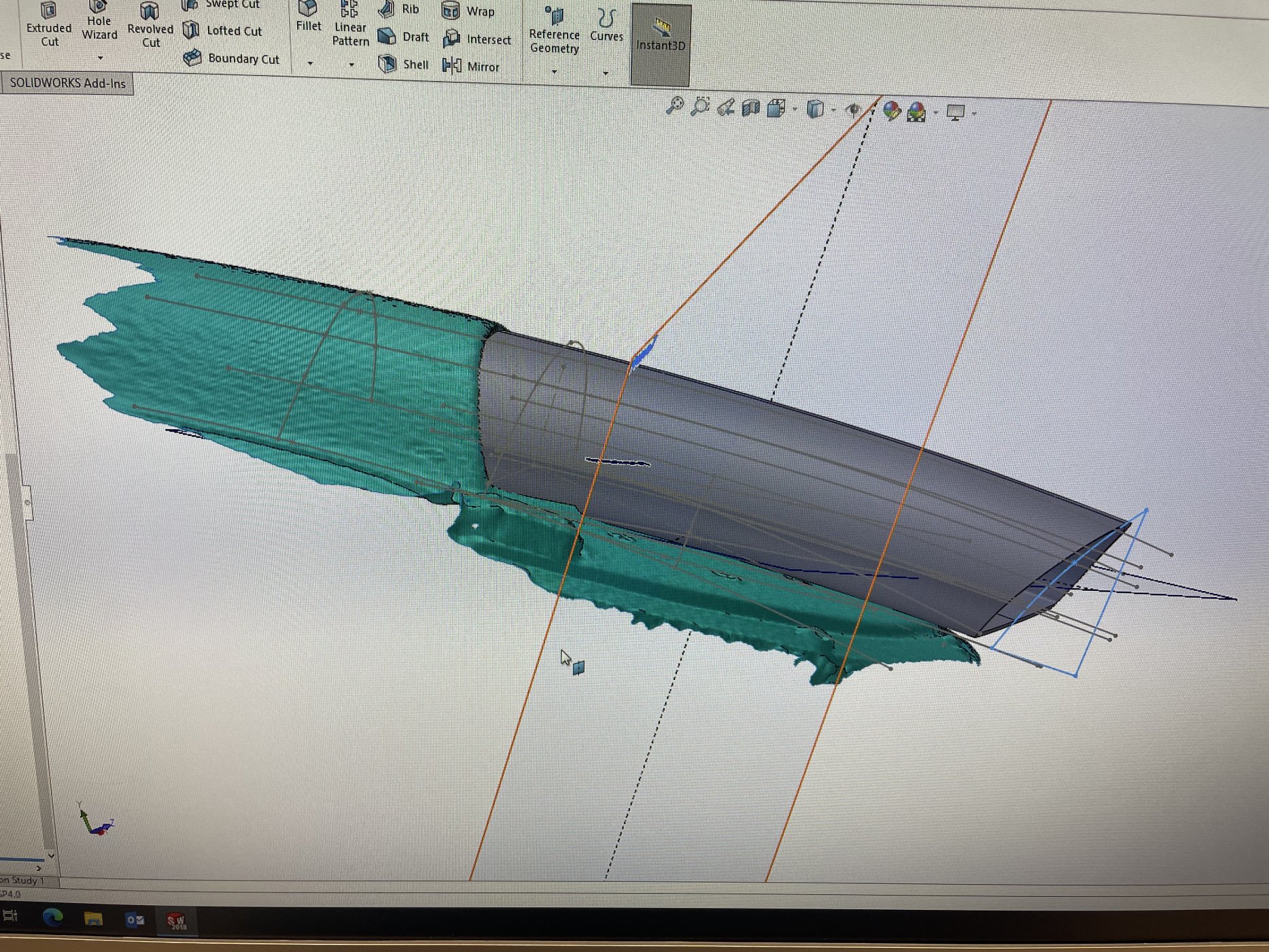

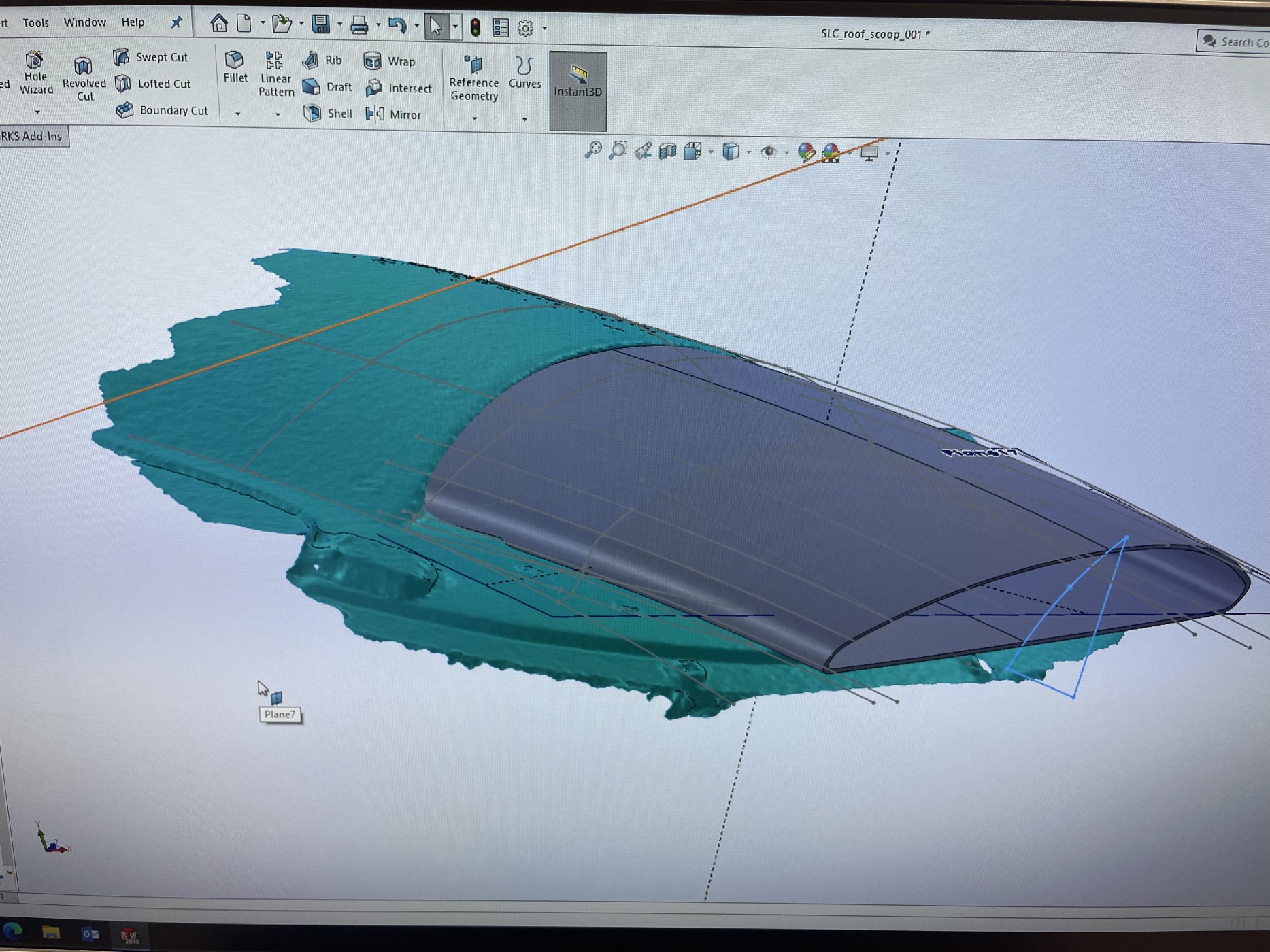

Sorry guys for the long wait... Recent updates are as follows:
1) 3D surfacing for the side mirror pods is complete and the mold is developed. I plan to have a first part later this week. I'm planning on making carbon and fiberglass mirror housings. The mirror insert is 3D printed from PLA or PETG and bonded to the housing. This newly developed side mirror assembly uses convex glass. The glass is backed and surrounded by a 3D printed base that snaps into the housing allowing for easy "fixed" tuning for up/down tilt and side/side angle. I admit though that with the rear camera that I'm using I only use the side mirrors for blind spot viewing.
