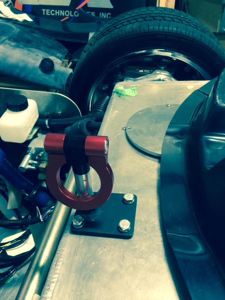

Tow eyelet installed to the front tub.
I built my own tow eye bracket. I'm planning tow loop in the rear.

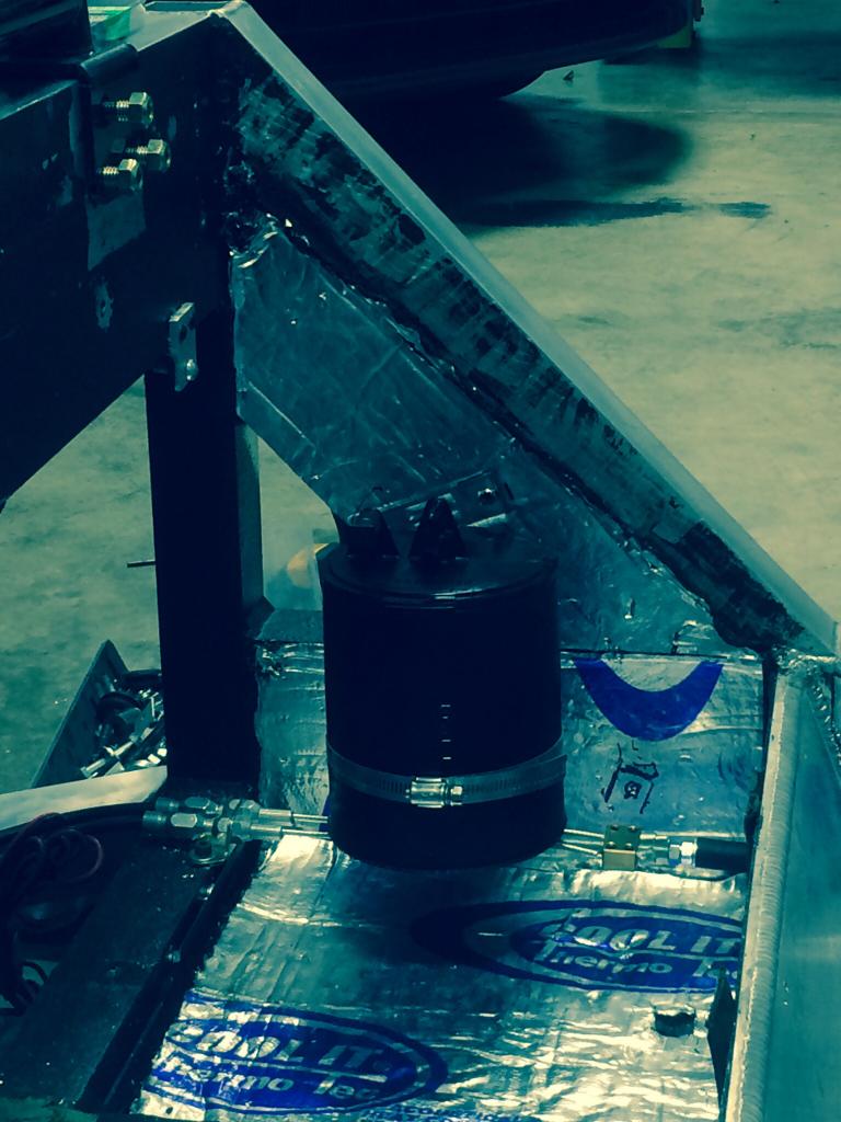

3) Carbon canister installed with aluminum bracket. I made it :)

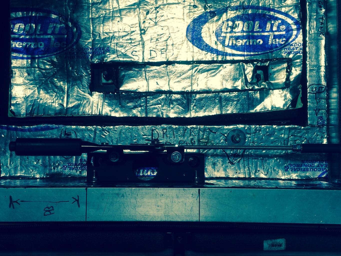

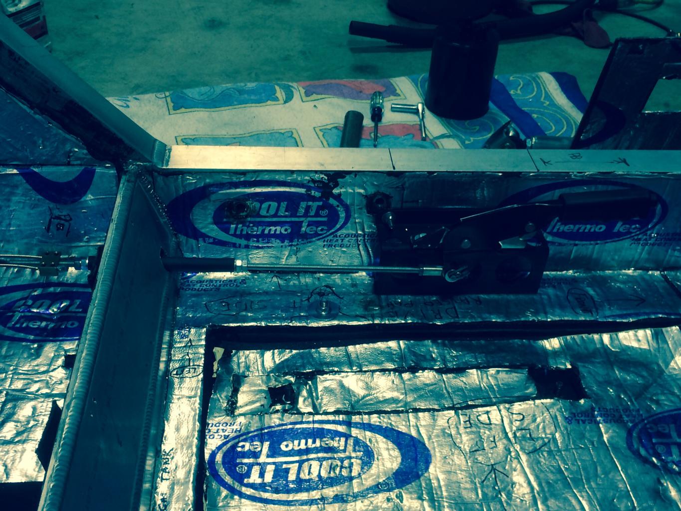

Photo of improved parking brake bracket and cable attachment. I can actually stop the car with this now.. Before I would've been dead.

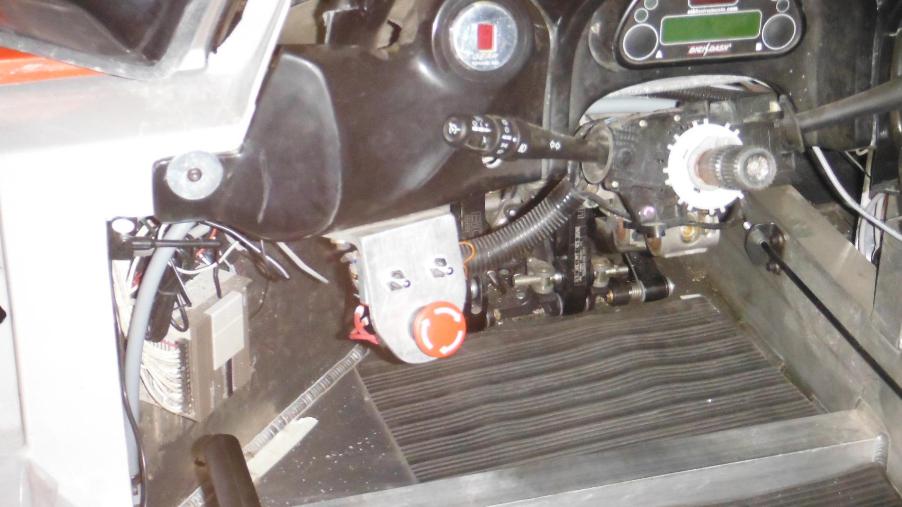

I run 2 plcs on my car, one for motor management the other for lights, horn, blinkers, brake and tail lights etc. There is no draw when the E STOP is on. It has a EPROM so you don't loose memory, I have several options the way I set it up, crank, no spark, fuel pump only, ignition only, crank only any combination you want.

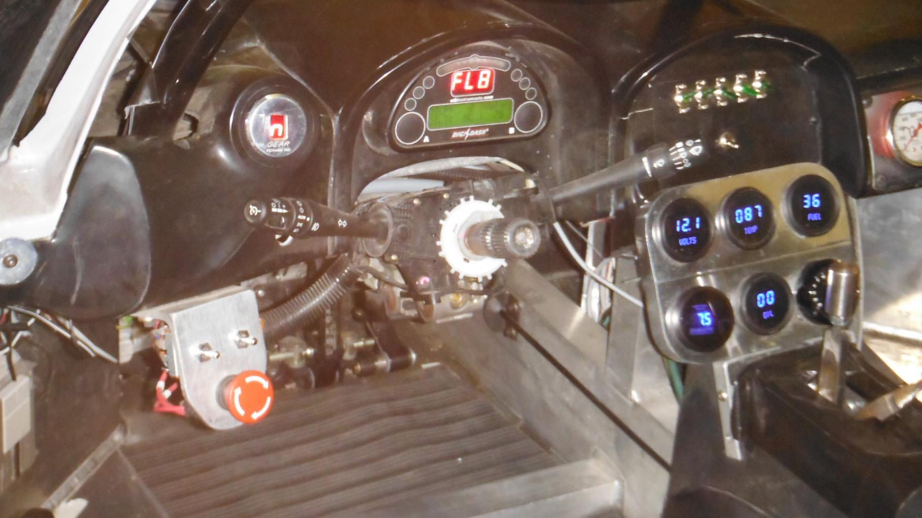

I like simple, E STOP turns power on to PLC''s the switches do the rest. Twist on push off
