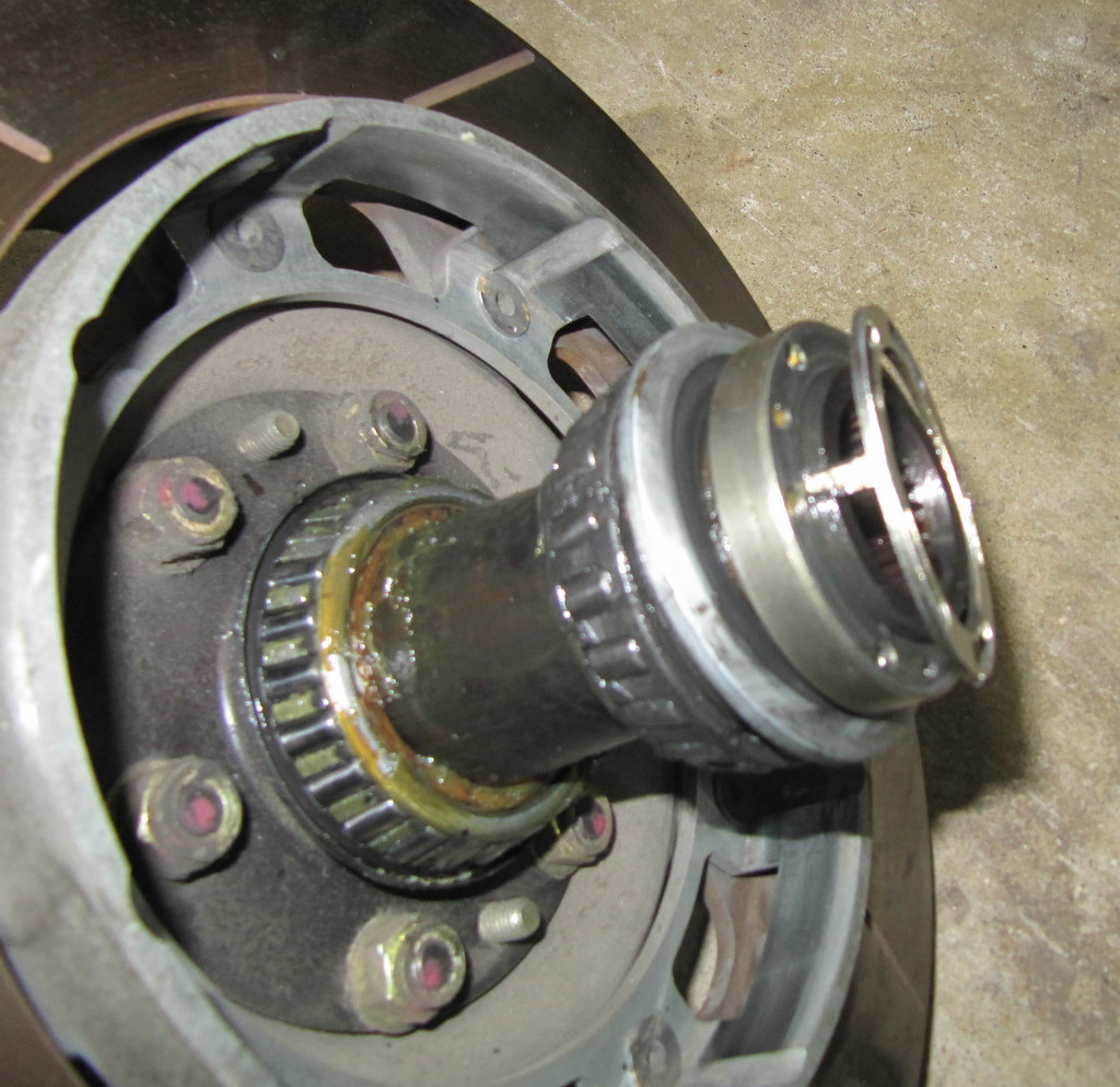

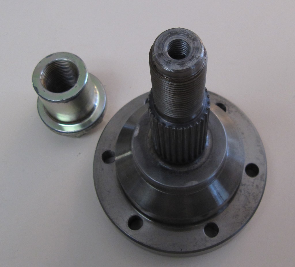

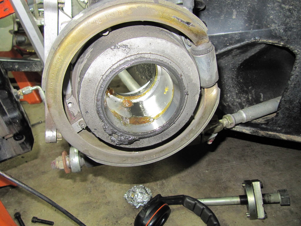

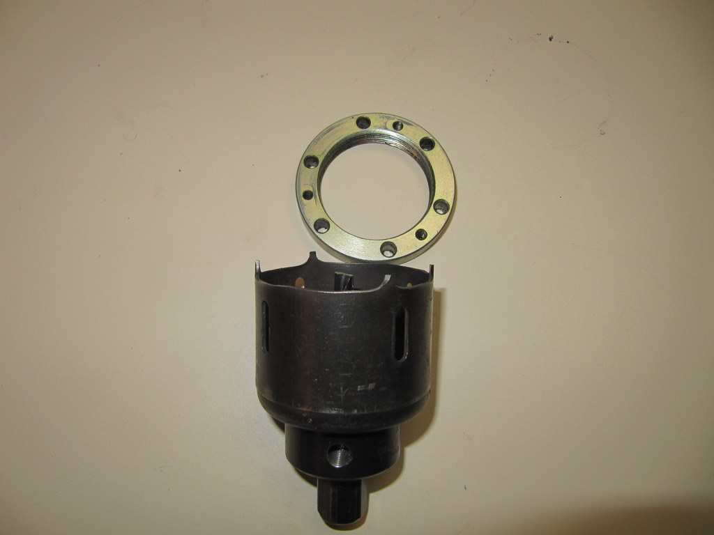

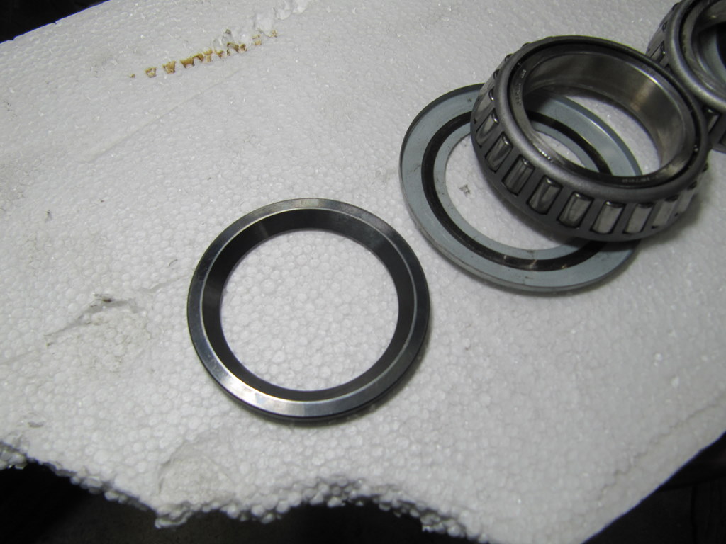

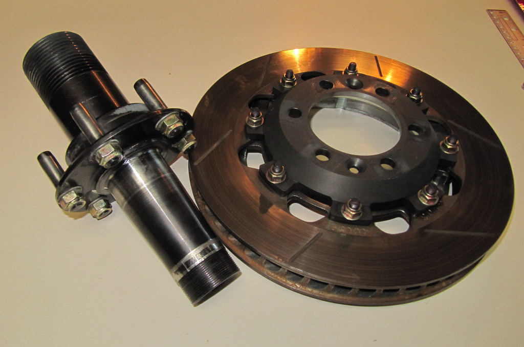

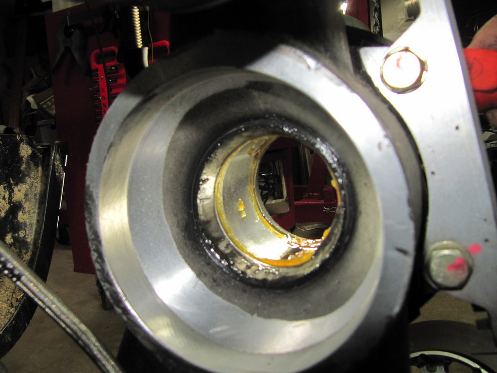

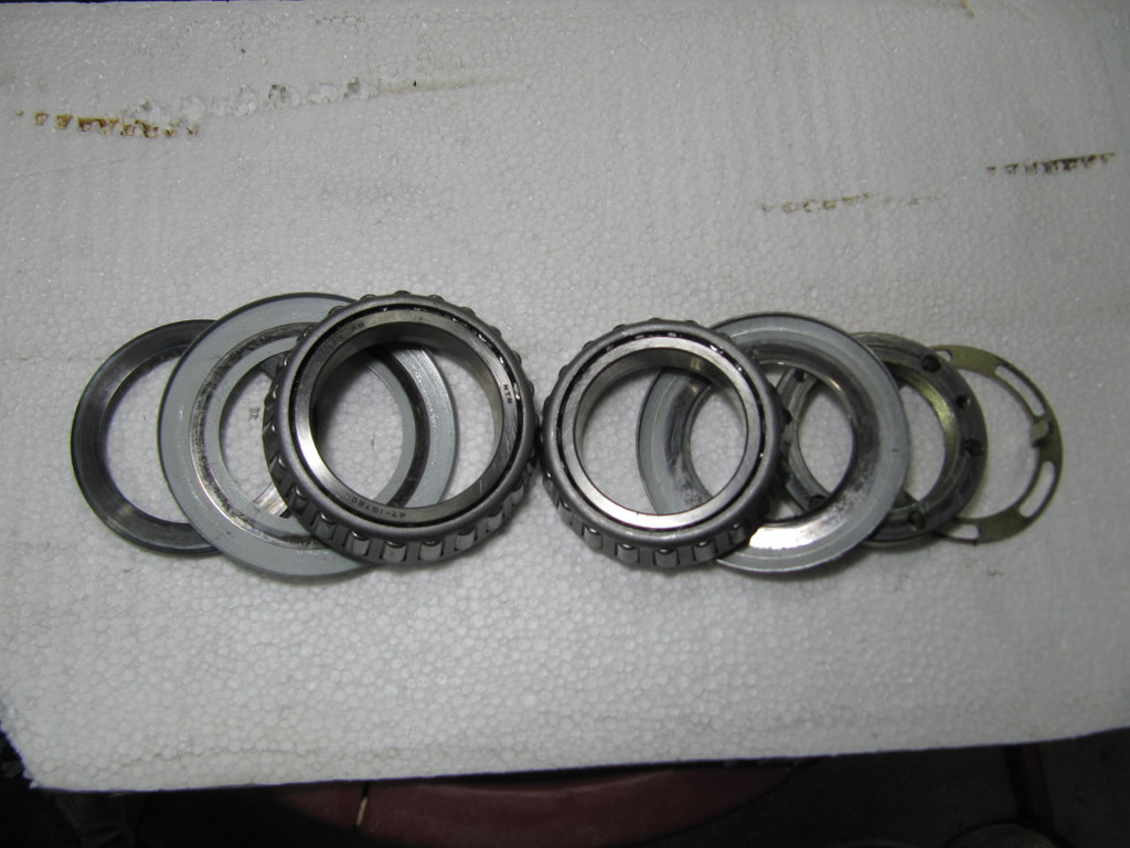

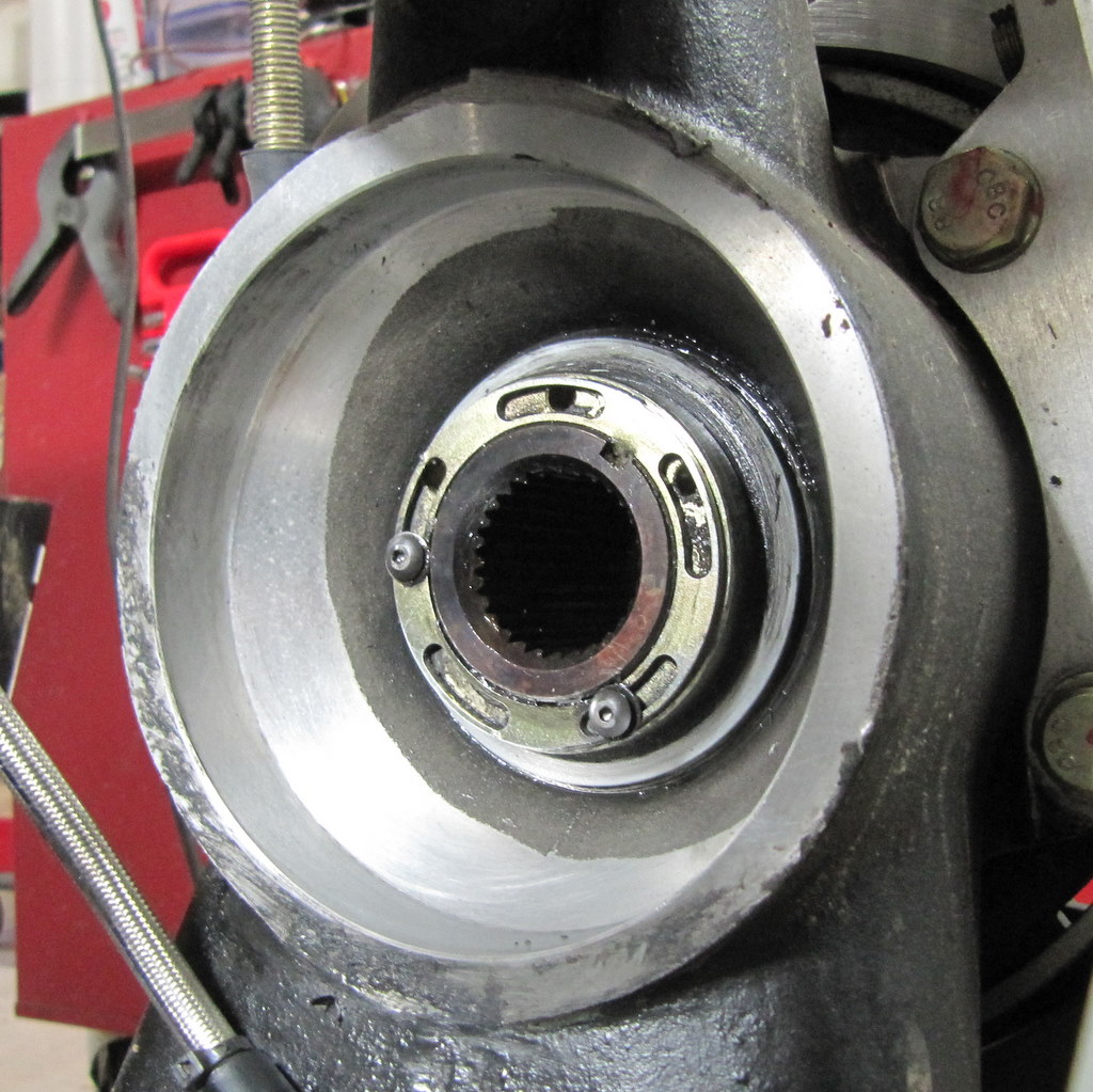

Kelly thanks for your post, considering all the time, effort and money we’ve all put in, it’s disappointing to hear that what I’m doing may not fix the problem. Like you at first the noise didn’t show up until I had driven the car for more than an hour but now it’s all the time.
I was able to get the driver’s side apart without breaking the other tool knowing I had to give it a good whack or two while getting axle movement started. The passenger’s side was so tight that while putting the axle back in I had to use an air hammer to get the axle far enough in to allow the re-insertion tool access to any of the threads so I could pull it back into place.
On both sides the small alan screws were very lose. For those of you that haven't gone through this after removing the stub axle you'll need to remove the two small alan's and the keyed ring they hold in place. Under that you'll find a ring that when rotated add or loosen pre-load on the wheel bearings. All this just to get to those two little bolts.
A little late but while I was ordering a replacement set of tools for Kirby, Dennis told me he is having new stub axles made that just slide into place. I couldn’t bring myself to ask how much $.
I’m using a ZFQ with all the prescribed transaxle lube so I don’t think it’s our transaxles.
At this point if the problem persists my plan would be to remove the rear clip and mount one of the Hero cameras with a good view of the suspension. Between the recorded video and audio I should be able to pinpoint the source of the noise. If the problem isn’t the bearings I suspect a binding somewhere or maybe even the tub flexing at one of the suspension pickup points under load. That would be in the “Book of Bad” on page one. Has anyone tried disconnected the coilovers and manually lifting the suspension through its travel? I may try that before I button things up today.
The pictures are for those of use who haven't had the pleasure of taking all this apart yet.

Richard -- thank you extremely much for posting the pictures. I have a couple questions:
  1. Once the bearings and various collars and retainers are out of the upright, are the bearing outer races right there to see on both sides? If so, and given the suspicion that we are doing multiple cycles of pre-load setting in order to fully seat them, should we consider taking some more direct action to seat them, such as tapping-->pounding on them with a properly sized drift, or squeezing them with a threaded rod throught the upright, or taking the upright to a press and pressing them?
  2. Regarding your difficulty getting the axle started back into the upright: I notice the small threaded hole in the end of the axle. Could that be used to pull the axle into place? Or (in an ideal world) does the insertion tool simply need more range? Regardless, do you have any idea why the small hole is there?
  3. In the picture of the bearings, shields, adjuster, adjustment retainer, etc., what is the object on the far left? Seal? Spacer?

This might be a 'twerp' question from me, but do these cars not run oil/grease seals in the rear hubs as in post#50 above, pic two I only see dust slingers/shields, no seals, plus on pic 5 there appears to be fretting where the outer bearing inner race would butt up against the flange area, have you ever chucked the axles up in a lathe to see if they are even straight, machined correctly
The left most ring is a spacer with a bevel on the backside that fits against radius in the hub, hope that made sense. I was very surprised that there are no seals anywhere but then again this is a race car and seals cause drag. The pictures show where the bearing races are. If the races weren’t seated from the factory driving as many miles as I have should have taken care of that. Spinning the assembly without the caliper does not show any run out.
I did think of using the threads on the inside nose of the stub axle but didn’t have a long enough bolt on hand and the air hammer worked well enough.

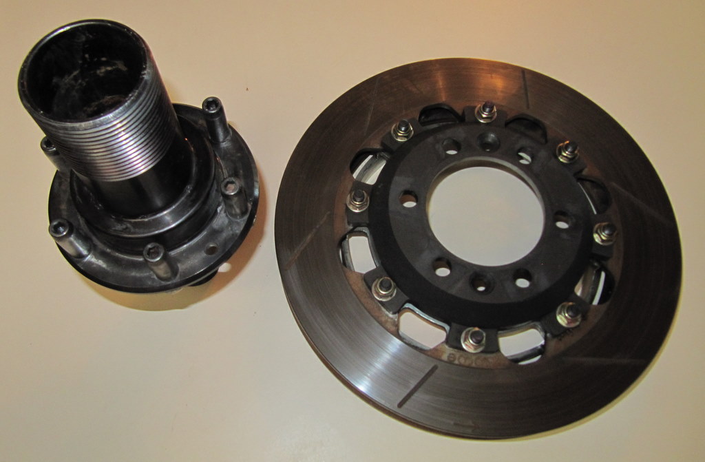

SPF quality control has been an issue for me today. The first side I took apart the bearing were a slip fit. The other side however was a different story. I was only able to remove the hub with a little help with my dead blow hammer. The second bearing took some work to remove which required the removal of the rotor required drilling one of the two bolts to get it apart. I just made a tool to turn the adjustment ring the help push the backside bearing back into place. I hope it works.
This is the fun part, right?

You know, its not often I get lost for words....but , honestly, race car heritage maybe, but given that you have an e-brake & they expect to be able register & or warrant [WOF- a 6 monthly check all cars here in NZ have to pass ] these cars for use on public roads, the grease that obviously can be expelled from the outer bearing & find its way on to the e-brake shoes.... that setup .... look Im not going to type what Im thinking... its got too many four letter words in it... the day you have to worry about seal drag in a situation like that on an item that only spins @~2000rpm tops, yet you guys go on for pages about the rear main seal leaking one drop of oil in your garage overnight........FFS
Sorry, forgot to attach picture of areas that might have brg movement & be source of 'noise'
Jack Houpe
This is a very valid question, it was rolling around in my head too. I have never had an issue with the wheel bearing problem and they are checked before each open road race I have done, which all together is over 350 miles and 300 corners at 100 MPH + so if they were going to loosen up or were loose I would know it by now and I drive it every chance I get. Mike Trusty also has never had an issue with his bearings. My serial number is 2164 and Mikes is 2165 so I wonder if there is a sequence of serial numbers that have this problem or if its random.

Sorry, forgot to attach picture of areas that might have brg movement & be source of 'noise'[/QUOTE]
Good observation JacMac. I've had problems with 2 of my stub axles. Basically SPF doesn't always seem to machine the clearances for bearing races tight enough. Check to see how loose the bearings fit on the stub axles. The outer bearing race should be a press fit and the inner bearing race a slip fit, but not too loose. SPF replaced one of my stub axles (LF) under warranty because I could not get bearing adjustment to last. The outer bearing was a slip fit and the inner a VERY loose slip fit. Another of my axles (LR) had a slip fit for the outer bearing, but I was able to remedy by green loctiting it to the axle. Adjustment has been OK for over a year now. The original design of these parts has its limitations in that the threaded adjustment collar's threads pound out with use and it gets a little sloppy. Also as Richard noted the locking set screws can back out. Blue loctite them or replace with hex head bolts (on front only, they won't clear on rear).
