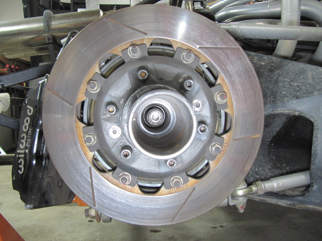

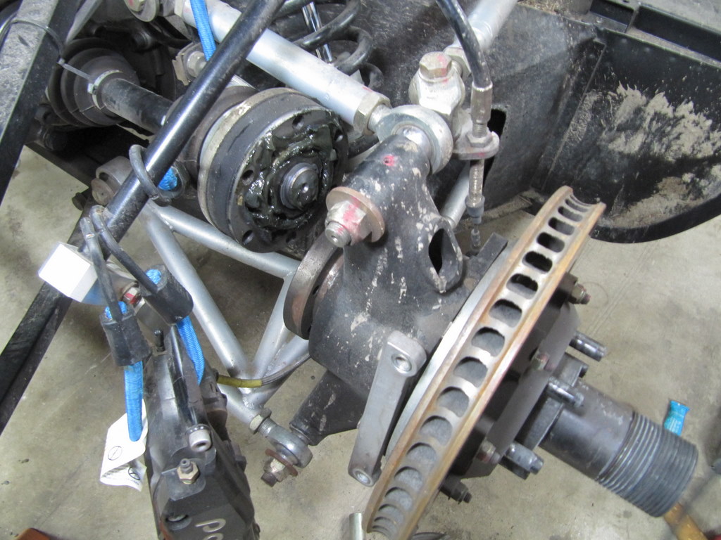

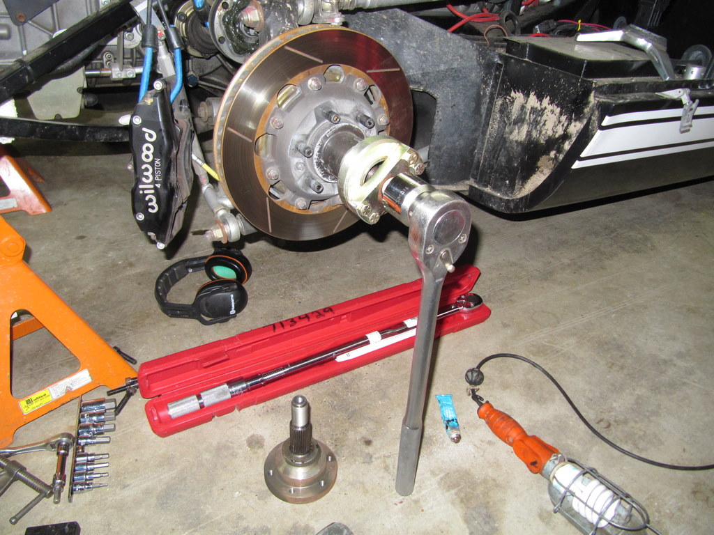

OK guy's I'll admit I'm sometime not the sharpest knife in the drawer but I'm stumped on this one. Kirby was very nice and loan me his set of tools. Well today I broke the right side tool. I started by removing the axel nut with the 36mm socket Kirby supplied. Next I disconnected the CV joint at the wheel end and moved it out of the way. Being the right side it has left hand threads so it was tough keeping the tool from trying to undue itself. Using my ¾” drive ratchet I tightened the big bolt that is supposed to push the axel out. I thought I was in luck when I heard a pop but instead of moving the axle it popped the welds but only after bending the cross piece. :embarassed: Did I miss something, will my name go on the wall of shame and be shunned forever? Sorry Kirby I'll have Olthoff send you a new set.

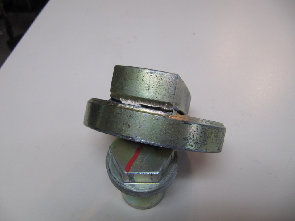

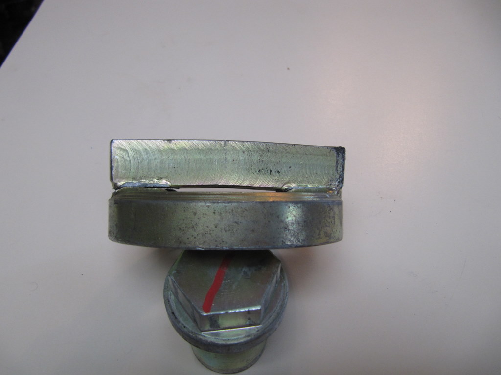

The axle splines are not twisted, they are at zero tolerance fit. I have a similar tool and use it with no problem. Hold the welded cross bar with a wrench while snugging the push bolt against the axle. If the axle does not move with moderate force, about 50 ft./lbs., slap the push bolt with a hammer to break the surface tension of the splines and proceed to push the axle out. Next time don't use a breaker bar and a pipe and crank it until it breaks.
Thanks I'll try that next after I fix the tool. For some reason I don't have a pipe that will fit over my ratchet. Guess I didn't need one.

Might want to try a little heat (map gas) on the assembly allowing it to grow away from the splines. Then a couple persuasive taps with a brass punch. If not remove the hub assembly and have it pressed out. Not that big a deal considering how far you've gone already.

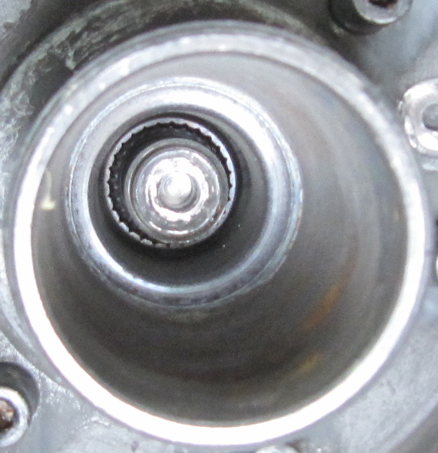

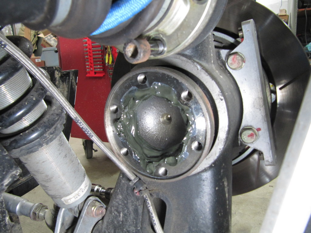

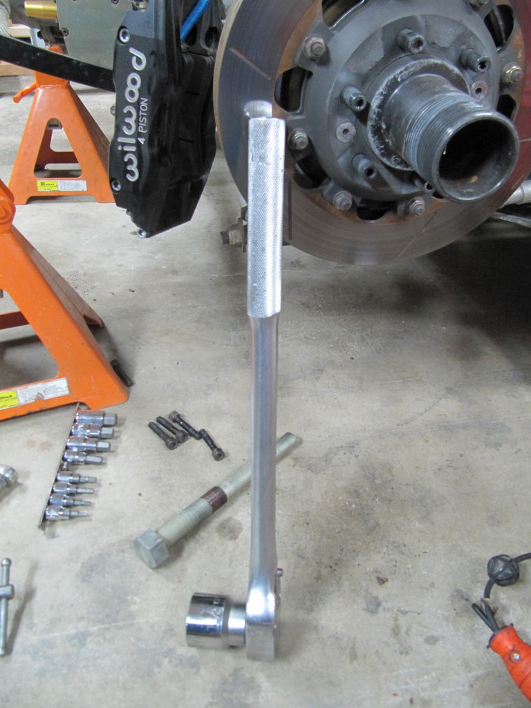

Well I finally got it apart. A little help from a really big hammer. Of course it only moves it the tiny amount of slop there is in the threads. Even after it started to move it took 130 ft/lbs to keep it moving. It looks like there is anti-seize on the splines so you got me why it's so tight.
I also had to fix the tool well enough to get the job done. The tool has beautiful welds but they are small and don't penetrate very deeply, they also didn't weld the area on the thread side of the cross piece the place that would take the most stress.
The tool is either hardened or made out of some tough stuff. If I need to "fix" the other side I'll clearance drill it all the way through and put a nut on the other side. I worried about breaking the tap on every hole.
