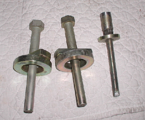

I'm still hoping for a couple of pictures of these tools. I'm about to register the car and pay the sales tax so there will not be any money for new tools. I guess I could figure it out myself but I hate inventing the wheel when it already done. Pretty Please!! Pictures!!!
Kirby Schrader
They're mostly silver
OK, I went outside in dark and stormy night, opened up my trailer (where the tools were still located since coming back from Road America) and took a picture.
The two on the left are the puller tools. One for the left side and one for the right. The one on the right is the 'put back on' tool.
A word of warning... the 'put back on tool' can surprise you if you don't watch it... the collar can stay in the hub and the rest of it comes out! Ask me how I know.... I talked to Dennis about it and he said he'd fix that. Dunno' how he fixed it though... I put some serious wrench on it with loctite to make sure it comes out with everything intact.
