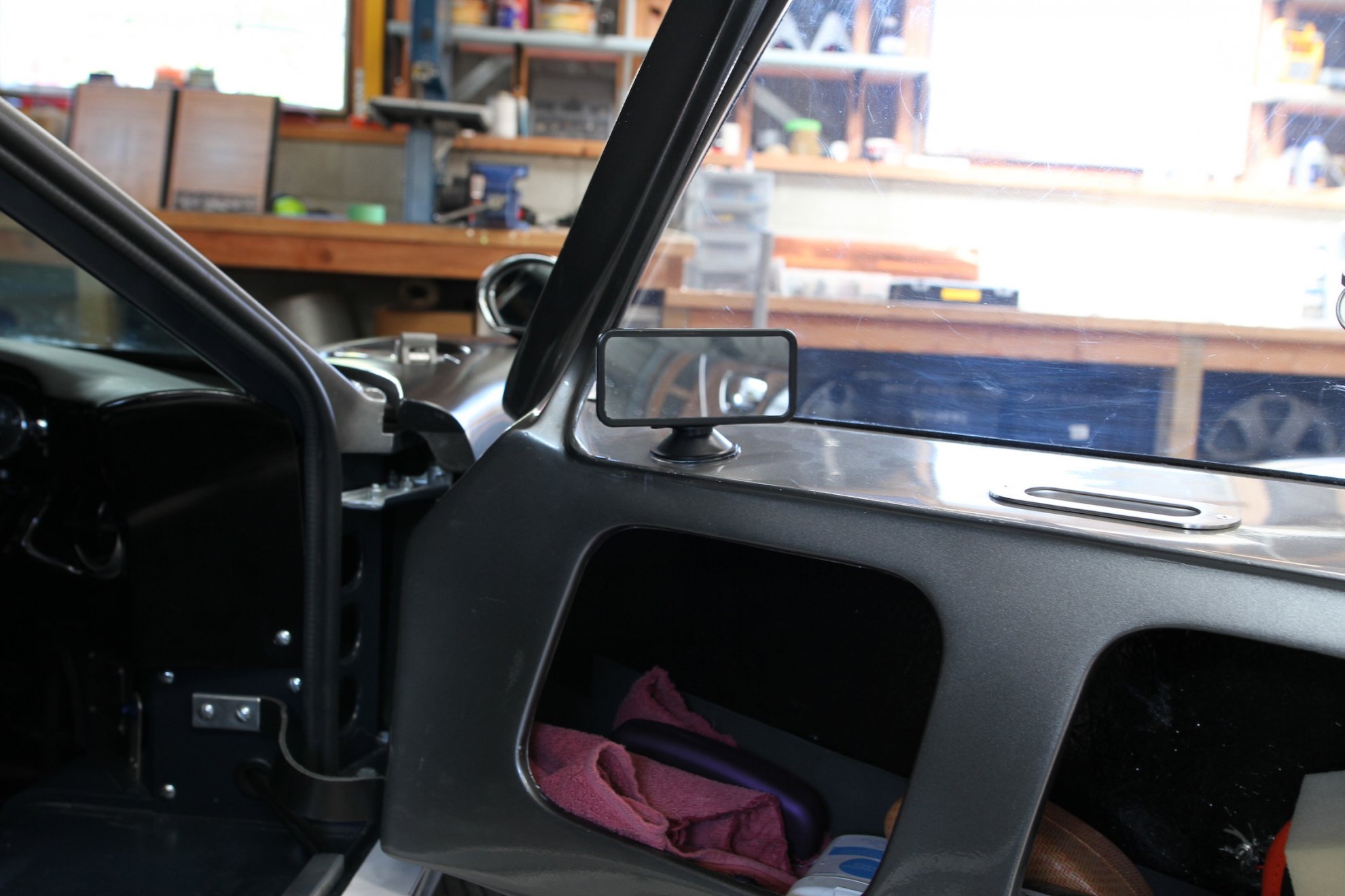

Hi Alan,
I have a little auxiliary mirror mounted on the inner window frame. It helps hugely in the situations you describe above.

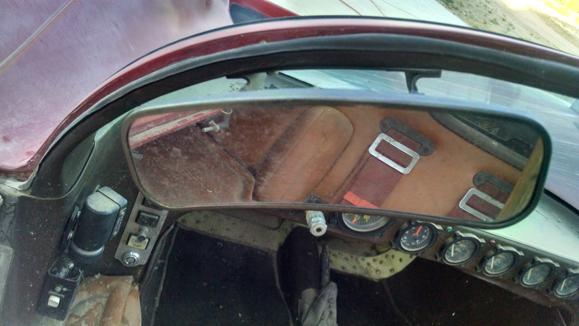

I used a pair of mirrors that I removed from an F-86 Saberjet canopy to get an adequate rear & 3/4 view in my street Manta Mirage. They are curved, slightly convex metal mirrors. I mounted them to the inside of the windshield surround.

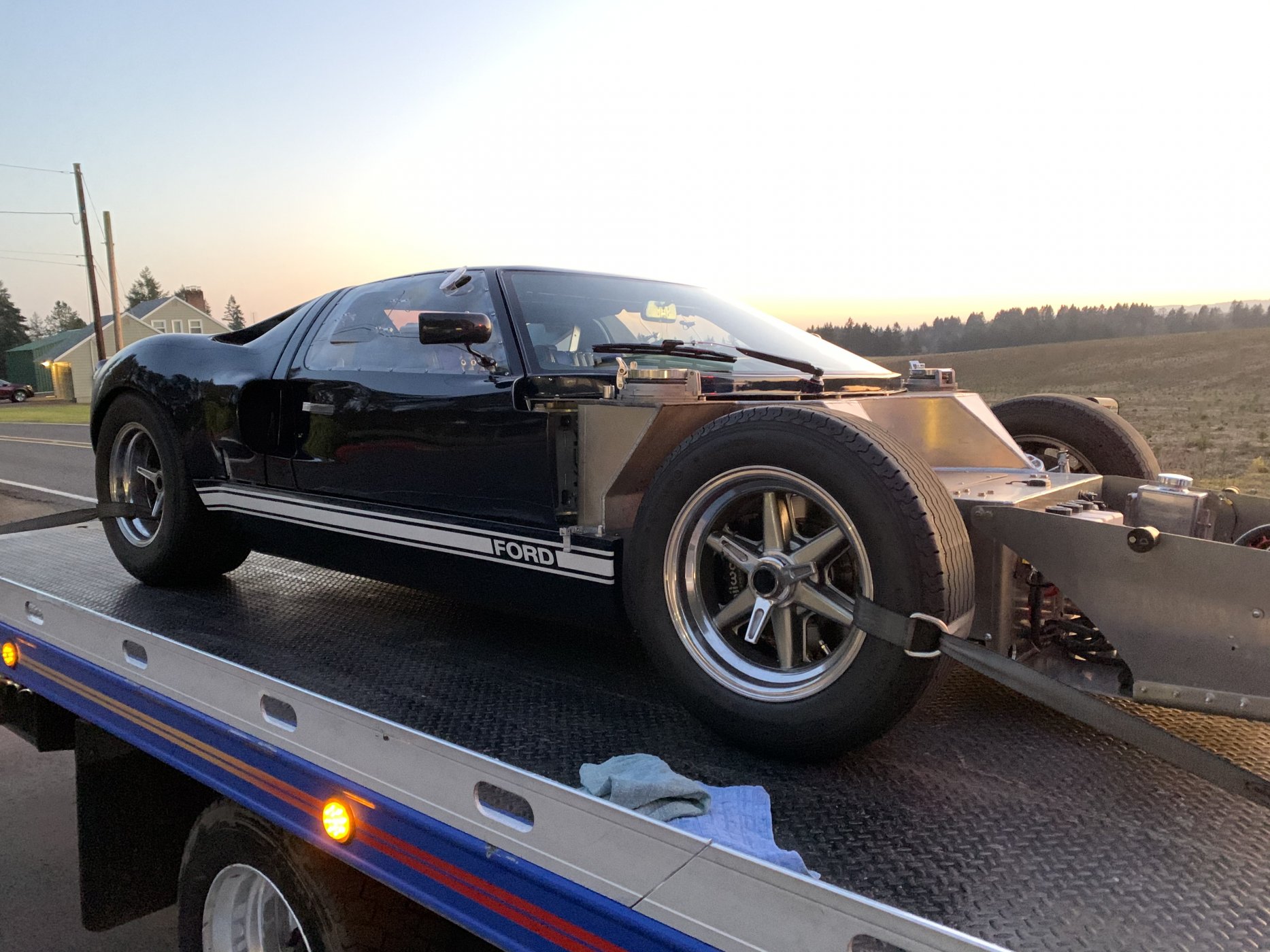

Besides the radiator issue, the car had its first flatbed ride when my coolant down pipe from the thermostat housing to the pipes that run up to the radiator became disconnected at a hose connection. This was my error as I didn’t have the pipes flared when made. I subsequently had the ends of the piped flared and have had no issues. IMG_5563.JPG

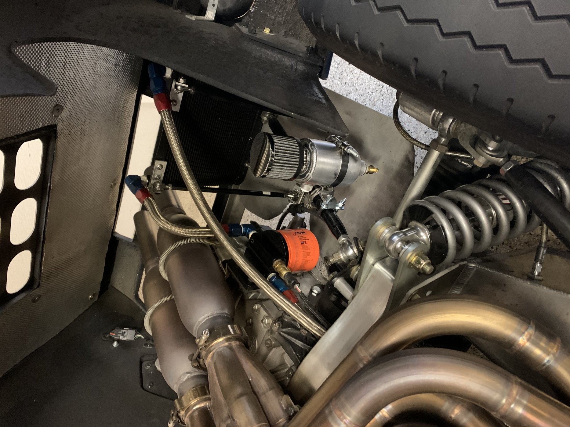

I was getting a smell that I first thought was a slipping clutch under hard acceleration/high revs. I eventually realized that my vented oil fill cap was venting oil onto the headers at high revs. I subsequently (on Keith Crafts advice) eliminated my PCV valve and the vented oil fill cap and vented both valve covers to a remote Canton vented oil catch can that I mounted back by my oil filter and oil cooler. IMG_5963.JPG

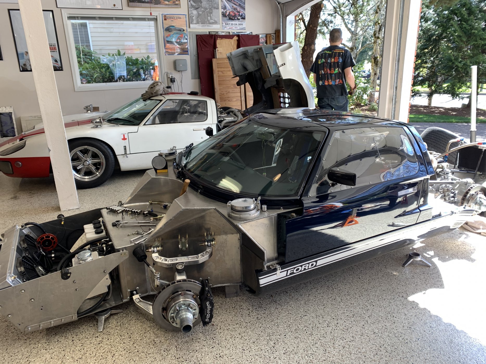

Along the way I needed to adjust my alignment as it was set up with too much negative camber at the front. Chris Kouba (once again) generously donated a bunch of his time to help me re-do the alignment. We had a great couple of days and converted my garage into a GT40 garage as Chris worked on his car at the same time. IMG_5647.JPG

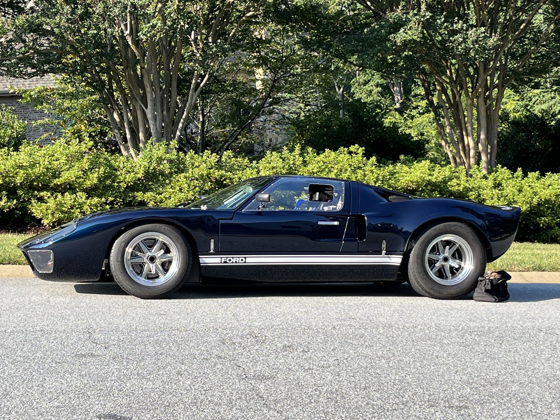

It’s hard to believe it’s been almost three years since I posted updates on my car. In that time I have switched coasts with a move to South Carolina and now have 9,000 miles on the odometer. I had a couple years of perfect reliability and then last spring was chasing fuel pump issues that finally culminated in leaving me stranded on the side of the track at Road Atlanta during parade laps at the Mitty Historics. I solved the pump issues but this February took the car out of commission to solve a water pump leak that has persisted from day one and a misaligned alternator bracket that resulted in a horrible squeal when really getting into the throttle. Anyway, work got in the way and I only just got the car back on the road after six months. And this brings me to the reason for my post… these cars are an absolute thrill! For those I see starting builds - I can tell you that the end result - driving makes it all worth it. Plenty to do still on the car, but my goal is to keep adding miles exploring the SC and NC mountains.
