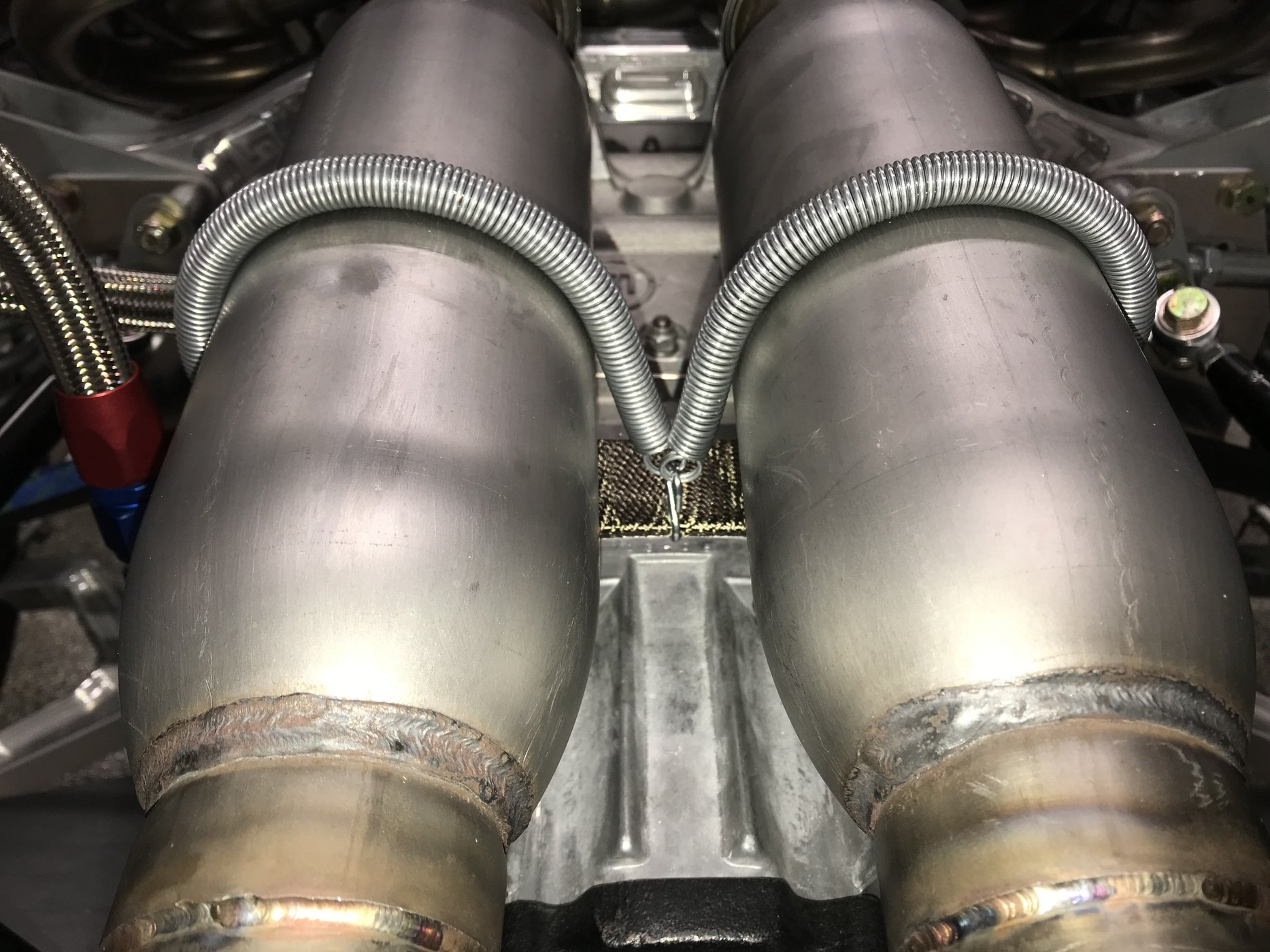

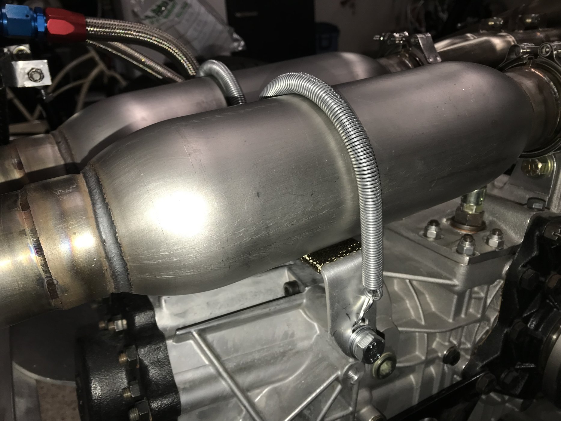

Finally, I didn't like how the mufflers hang in space as it seems the pipes would fatigue and break over time. I built this simple bracket off the gearbox to support them.

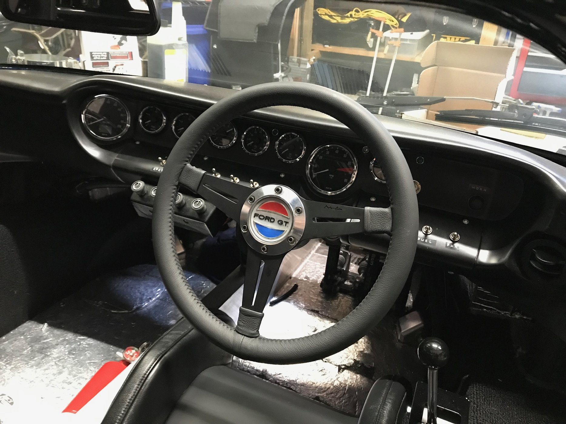

- Moto-Lita wheel installed. (Took some time to machine the right five hole to 6 hole converter hub)

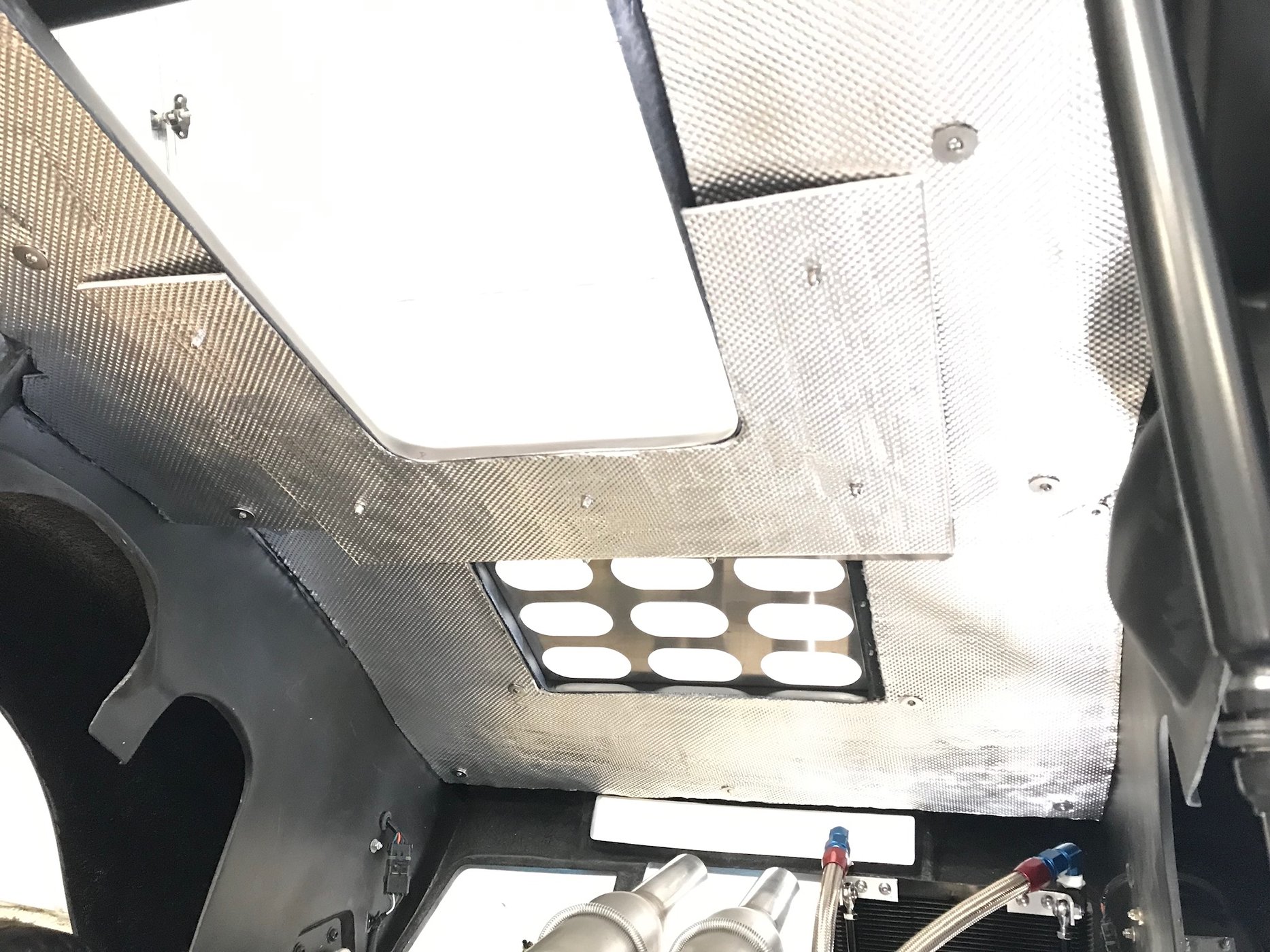

- Heat shield for rear clamshell. This is both material applied directly to the clam as well as a standoff of aluminum and heat shield material directly above the exhaust.

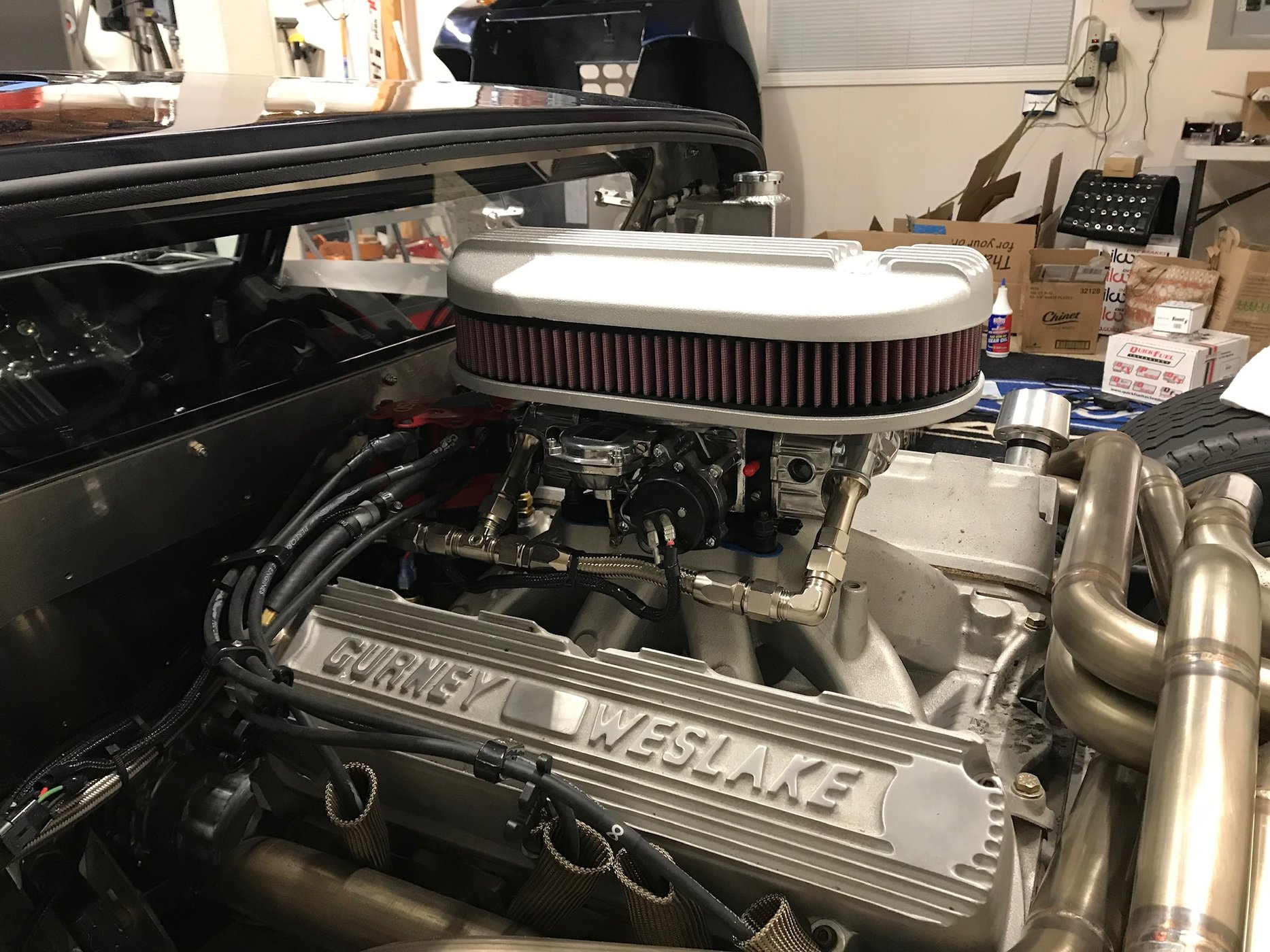

- New air cleaner as the old one interfered with my cockpit rear window

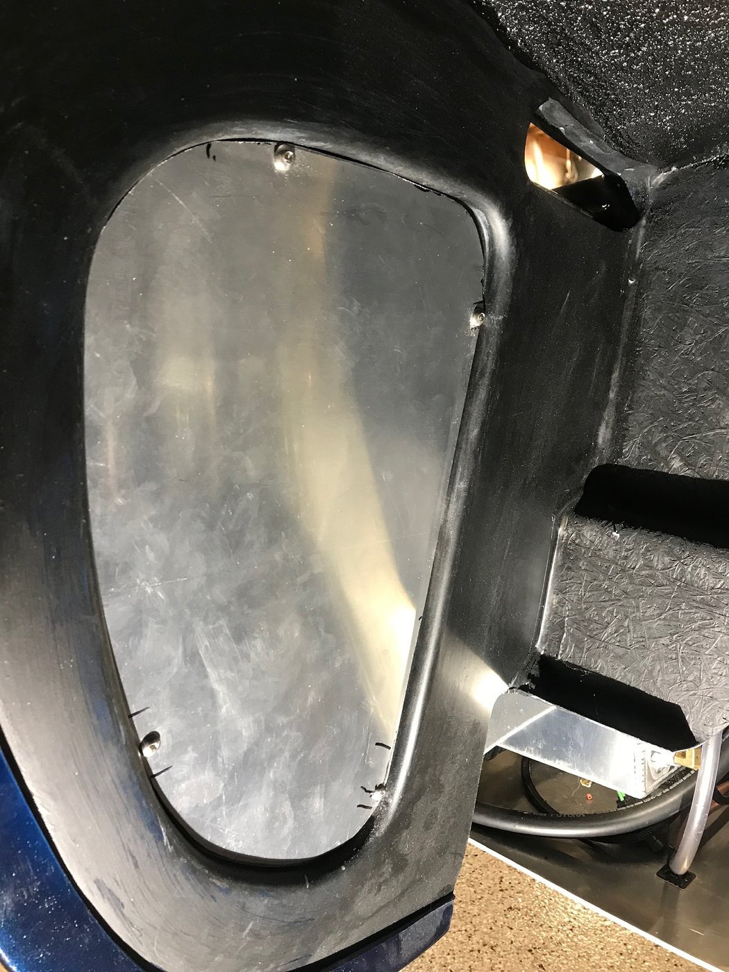

- Made headlight access panels

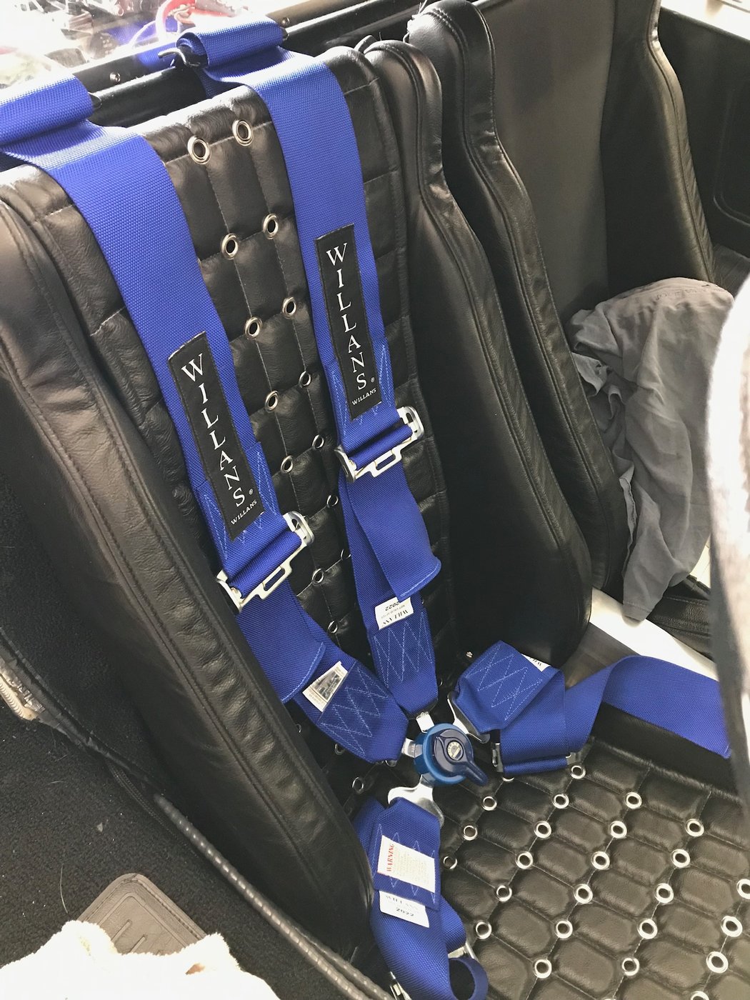

- Seats and belts mounted

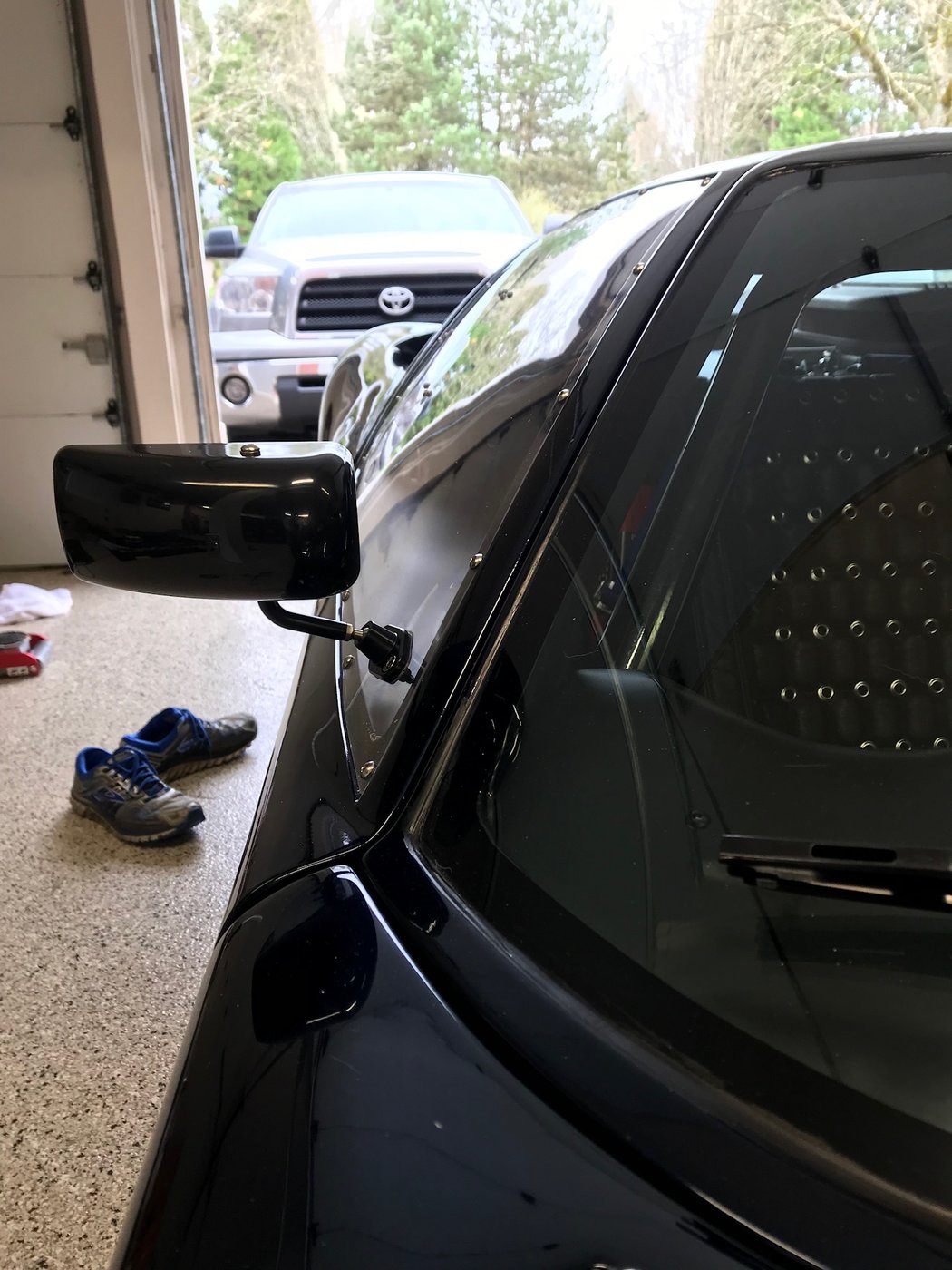

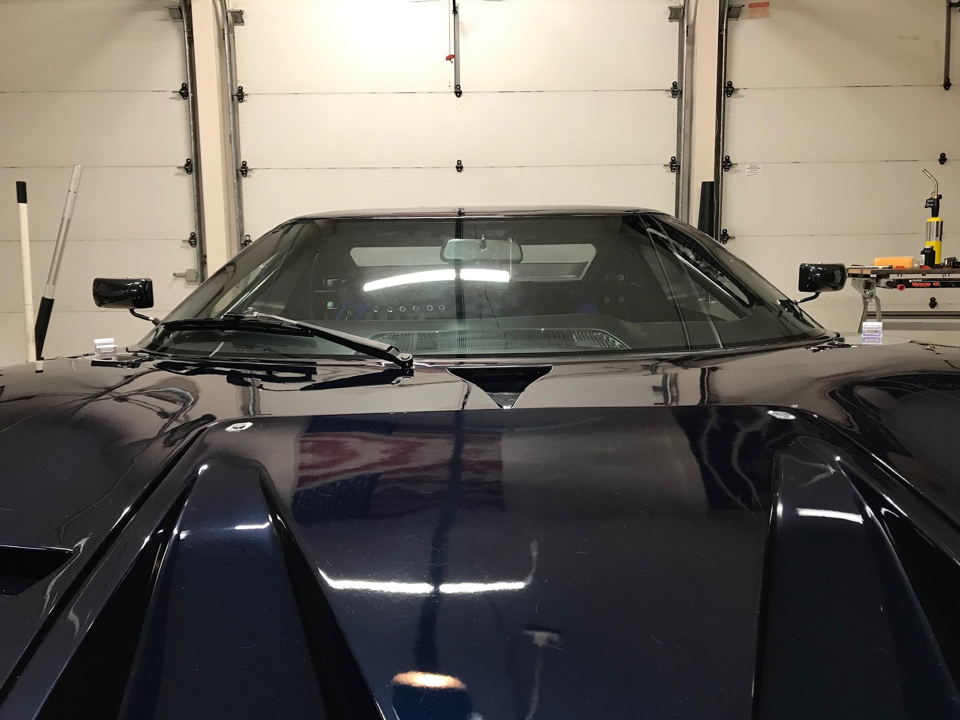

- Mounted side mirrors (these are convex and the widest that I found in the “formula” style and seem to offer very good visibility (relatively speaking)

Alan, quick question: did you bolt the rear mirrors directly into the side screens? Any reinforcement done? Udo
Just aluminum backing plates. I have seen others who build a bracket that also bolts to the door sill. Mine seem fine from a vibration point of view and vibrate less than my center mirror.

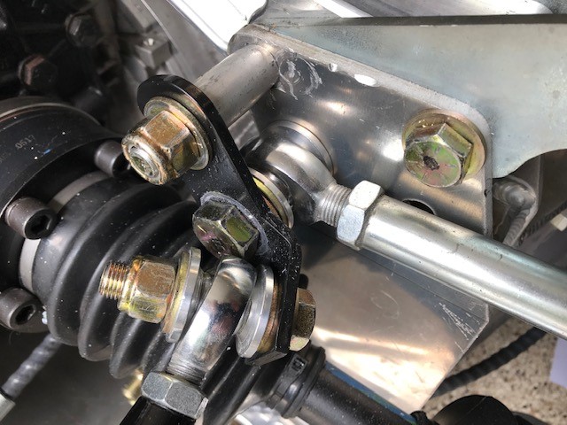

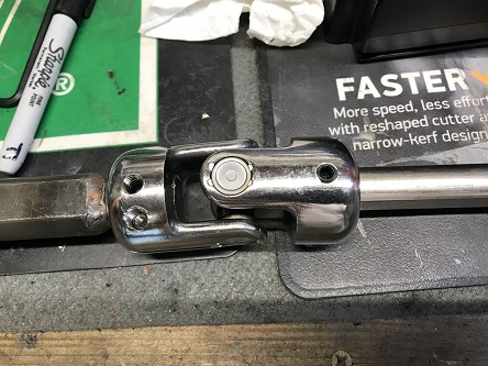

I had a lot of play in my steering and found that at each point that the steering shaft mates to the universal joints that there is play at the milled “valley” that captures the mounting bolt. As there are at least three of these points, the slop stacked up significantly. I added two set screws at each junction, 90 degrees to each other, to clamp against the steering shaft (see pic) and the problem is eliminated.

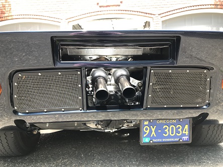

I made a couple additions. I bought wire mesh grilles for the rear clamshell from a member of the forum and I think they look great. (see pic) Although I haven’t seen this on other 40’s, I think I will make a similar mesh frame for the top elongated opening. Also, as I haven’t connected my air conditioning yet, I added helicopter vents to my windows (pic). This turns out to be a very easy and effective mod for increasing airflow to the cockpit.

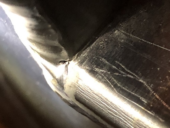

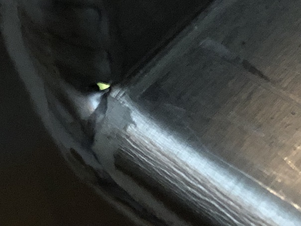

The major issue I found, and one that took a lot of time to diagnose and repair was a leaking left side fuel tank. I always smelled more gasoline than I should. At first I found a leak at one of the filler tubes at a hose clamp junction, but upon fixing this, I still smelled too much fuel. Then one day, after lifting the rear of the car, I smelled fresh fuel and found a puddle on the floor coming from the front of the left sponson. I first found a leak at the AN fuel pickup line at the back of the tank, but this seemed small versus the flow of fuel coming out with the rear end lifted. Finally after pulling the fuel tank, I found the leak by shining a flashlight into the tank and seeing light shining through a hole at the top corner weld of the tank! Essentially whenever the tank was full, or going downhill, fuel was leaking. On a positive note, I had noticed a squeaking when turning my steering coming from the left side of the car. While removing the suspension to remove the fuel tank, I found that my left bottom ball joint was never lubed. Upon lubing, squeaking is gone.

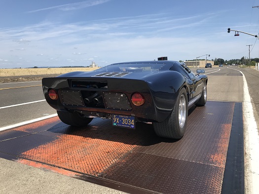

I got this all corrected just before the July 4 holiday and was able to add 100 very enjoyable miles over the weekend. I went to some scales not far from my house and it weighed in at 2,450 pounds with both fuel tanks essentially filled.

Finally, I found another leak in my fuel tank. My left hand fuel pickup tube was leaking at the NPT fitting due to being cross threaded at assembly. I hope to get a new pickup tube welded together and get the tank back in the car in the next two weeks. Driving on one tank at 8-11 MPG is somewhat limiting!
