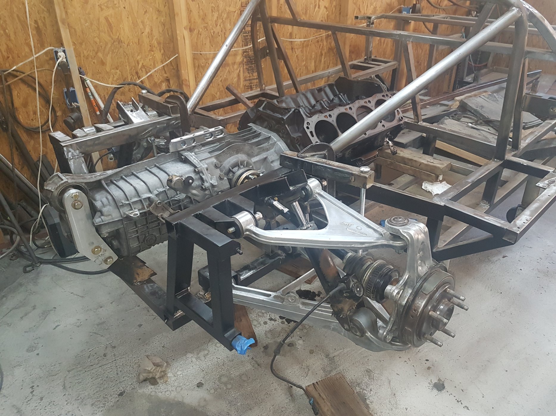

Hi there, Seems weird that the trans is upside down. However that is how it will fit. I think the only mod is to seal the vent and drill a hole in the drain plug.
Neil
What would be even weirder would be if it were not mounted upside down... you would have 6 speeds in reverse! o_O

Hi there, Seems weird that the trans is upside down. However that is how it will fit. I think the only mod is to seal the vent and drill a hole in the drain plug. Here is an upside down 996

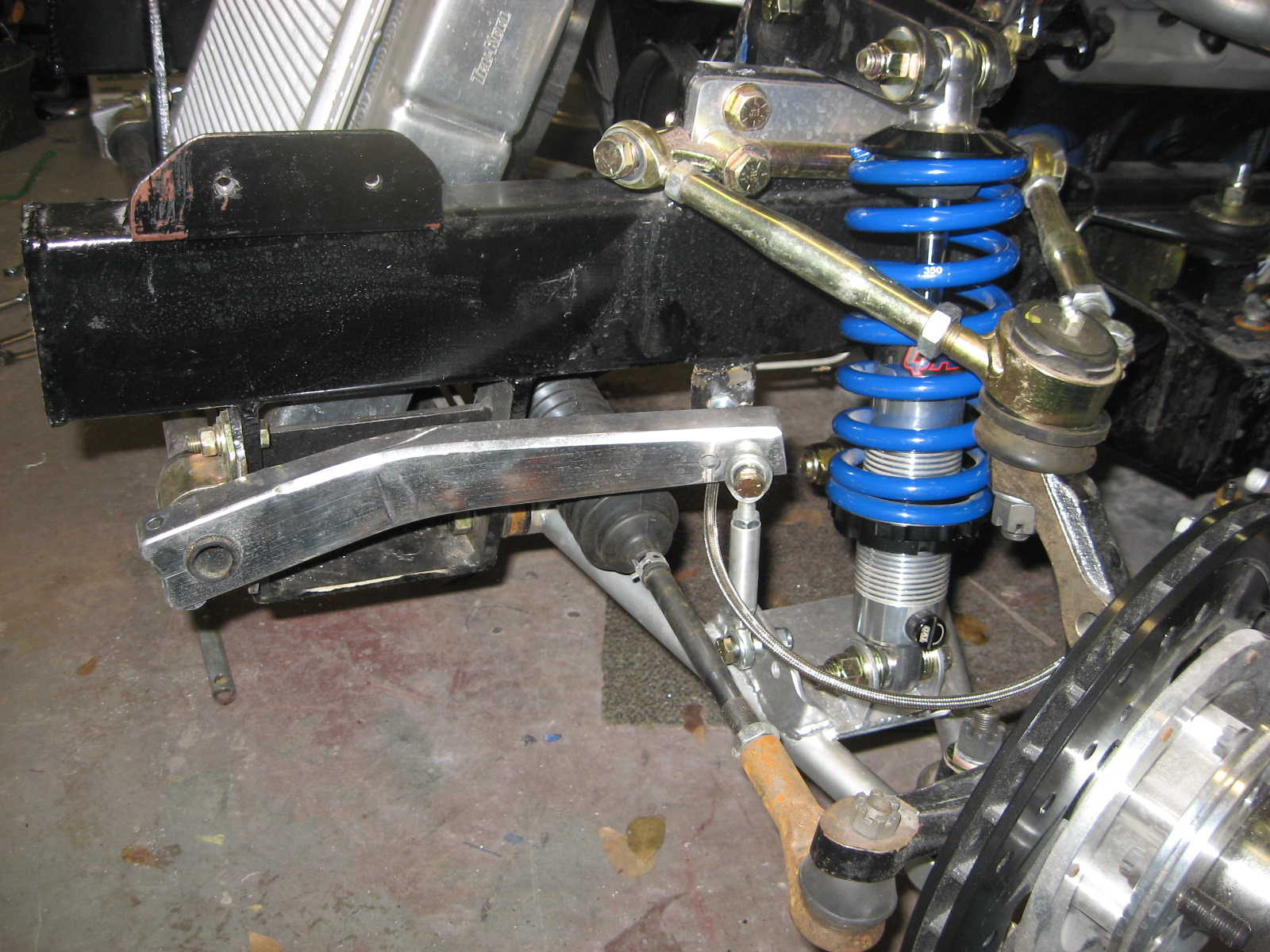

Scoff if you want, but on kit cars and such, I use a Mustang 2 front end strut bushing. It's on the far right of included pic of my Cobra.
Here's the big plus. With a lock nut, you can adjust the firmness by how hard you smush it. I welded the bottom cupped washer to a piece of square tube, and the motor mount has a thickened plate with a hole. It was a far better solution than the Mopar motor mounts Lone Star speced.
Couldn't find a better pic.

Bidenomics has made building the GT painful. However moving forward I am adapting the 996 trans to the 351 roller block, I have to machine the adapter plate. Then build the engine mounts and adapt the 996 CV Joints to the C5 output shafts.​
For now the 427 Stroker is out and the 351 is in

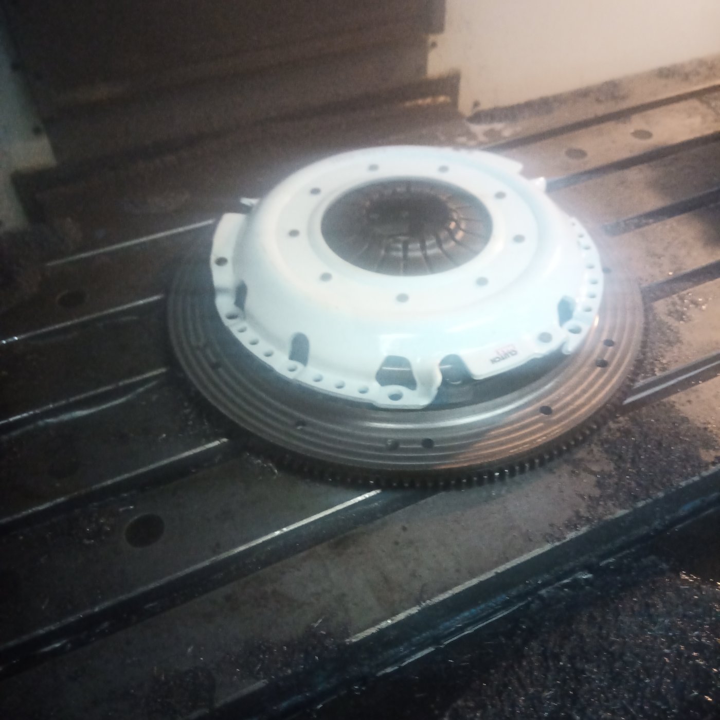

Machined the 351 W flywheel to fit the 996 transmission, Next its the adapter plate, since aluminum is so expensive it will cut from 1.5 thick plywood and if it all fits then get aluminum.
