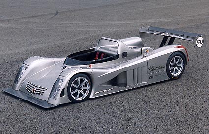

If removal of the sidebars doesnt reduce driver safety below original LMP requirements... a guy could entertain the thought. That is assuming the LMP/safety standards from 11 years ago are still considered safe & adequate today. That I dont know.
Are the NASA/SCCA sidebars truly required to be safe? I dont know enough to make a call on that one either.
So... really... I dont know all that much on this particular topic; therefore, I shall defer to what you think is safe and what you are comfortable putting your name on.

Fran and myself already had an email exchange about the sidebars last week and I was thinking that if the main hoop was made thicker/stronger like the original and the sidebars dropped down like the orginal... that the car would certainly be as safe as the original. I know that's a bit of an assumption... but it was worth investigating, at the time, to see if there were any configuration options available.

The reason I really like a SLC for track day type track work IS the full cover of the roll hoops and side bars. The LMP side bars come as close as possible without a full halo cage. The side bars are a very good idea and when combined with sharing the track with 4000 pound full size cars in is a MUST!!
The main threat is the height of the driver head in relation to the height of the bumpers of the big sedans. Pretty much right between the eyes if you get your prototype stalled right in the middle of the track and facing traffic. In this case the side bars will save your life. The other worry would be going off into a tire wall and eating a stack of tires. Again the side bars will deflect the incoming debre over your head.
Good addition Fran. Thanks for thinking of your customers safety. Don't take them out guys!

I have been a long time lurker here. And i have to make my first post on this thread. This is amazing at what is going on here. It was something I was thinking of doing, but it was hard to find access to a five axis mill to cut the foam. While I am an artist and all, sculpting is not my specialty. I have been studying the pics for a long time. Havent got any sleep cause of it either. and the pics dont show much detail, but from what i can see, it is the car.
Now here is my questions! As far as inside goes what seat options are there? All people are different and i am of the wider type more in the hip section. Yeah, i am fat but while i have been working out to get back down to where i should be, it has presented its self problems in a lot of seats.
The panel you have where you made the "enclosure" for the cockpit seems a bit snug compared to most lmp cars. Where it looks like a two seater, and some like radical sr9, down to the older ones like tampoli and pilbeams could fit a second driver. It is paneled over. I assume for a gas tank, but seems kinda big? will it be the same? or are you going on a one off style inside like a formula 1 enclosure? Not sure I see room for a shifter? Unless you are going to go paddle shift. which will add some cost.For me this may sound weird, but its a big deal for me as I like my space haha. I would like to have the room for the electronics, radio, telemetry gadgets, and non claustrophobia haha
third question! The forward bars, I understand a lot of people dont like for aesthetic reasons, which i can partially agree on, but i know why they are there. but since it goes to such a small hoop. I am assuming it might cause problems for getting in and out of, and helmet room. I have cracked a helmet before on a cage that was too low. And while it could have had padding, it caused a visibility issue. This I can see a peripheral danger. Maybe why they do not have them and drivers sit a lot lower down.

what may not be obvious is that the side bars have quite an agressive curve to actually be as wide/wider than the cockpit opening...our seat space in the tub is much larger than the original car....it is designed to easily house a larger guy...that was part of my design brief as I know there are far too many big guys that are not catered for with track/race cars...our opening in the body/cowl is exactly the same as the original...because the bodies are the same....we have deleted the center spar giving even more cockpit space.
I appreciate your feedback....but we will not be changing the way its built, we have a lot of FEA time into the chassis...once in your garage you can do anything you want obviously...
front and rear suspension are both pushrod /bellcrank
hubs are 5 lug standard....
center lock will be based on our replica car pin drive set up...so no off the shelf wheels will work...I think I mentioned that previously somewhere on here....many pages back though
Brakes are the same as we supply on the SLC ...14 inch rotors and 4 piston calipers
