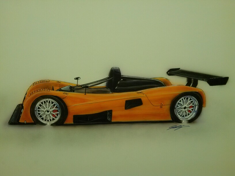

Our chosen colour for the shop LMP

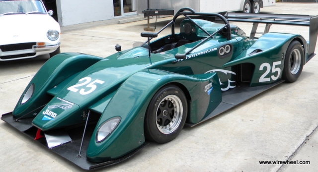

Fran has been holding out on us again, see spy shot of preseason testing.....

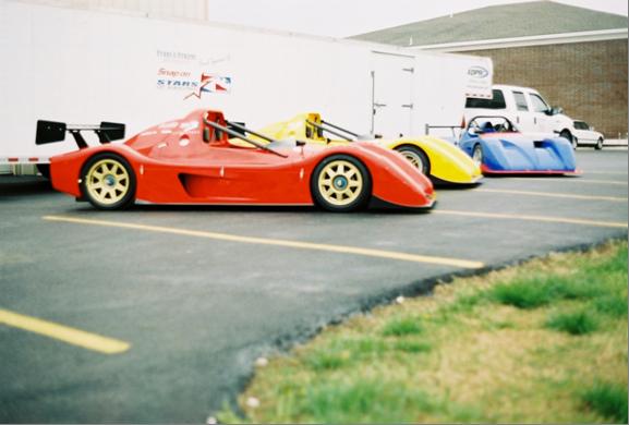

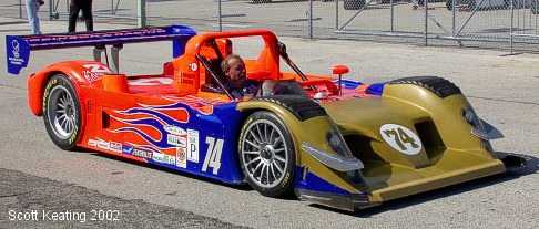

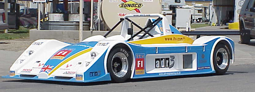

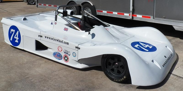

different rules...the current NASA/SCCA rules requires that the roll hoop support be no lower than 6 inches from the top of the roll hoop structure...forward or rearward legs are permitted...there is no way to package rearward legs and to be honest the forward legs offer much more safety to the driver in the event of a rollover for a frontal/side impact.
A current LMP1 open top car would not meet NASA/SCCA rules if the letter of the rules were followed....believe it or not.
As we are bringing a new product out to play we have to make sure that we meet/excede all rule requirements for the market in which we want to race and eventually sell into..
Interestingly Jim Downard, inventor of the Hans device added forward bars to one of his race cars last year and promptly crashed at high speed and the only thing that saved him from fatal harm were the recently added forward hoop supports...lucky Jim..
