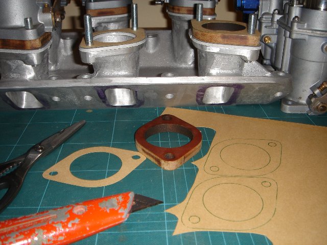

The intent was two-fold. First, to shield against engine heat, and second, to get cold air from the inlets.
It should also be noted that the originals used phenolic spacers on the Webers to further insulate from engine heat.
