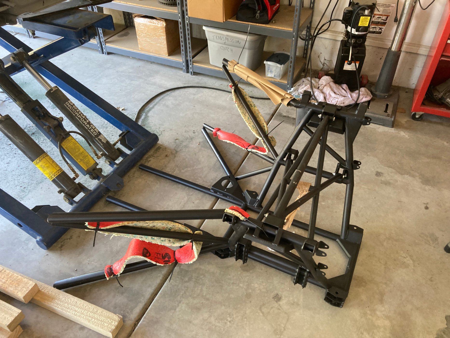

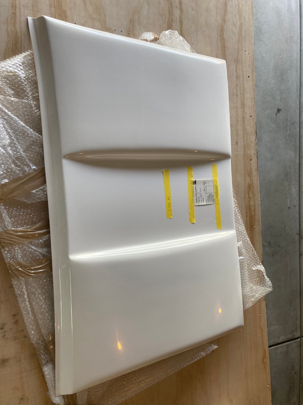

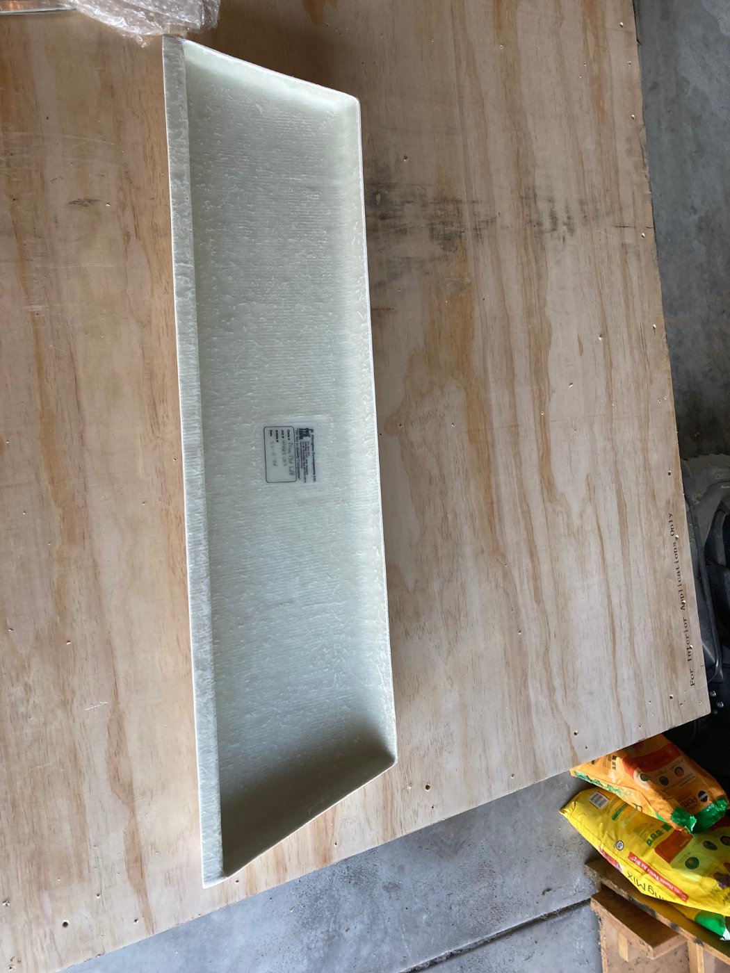

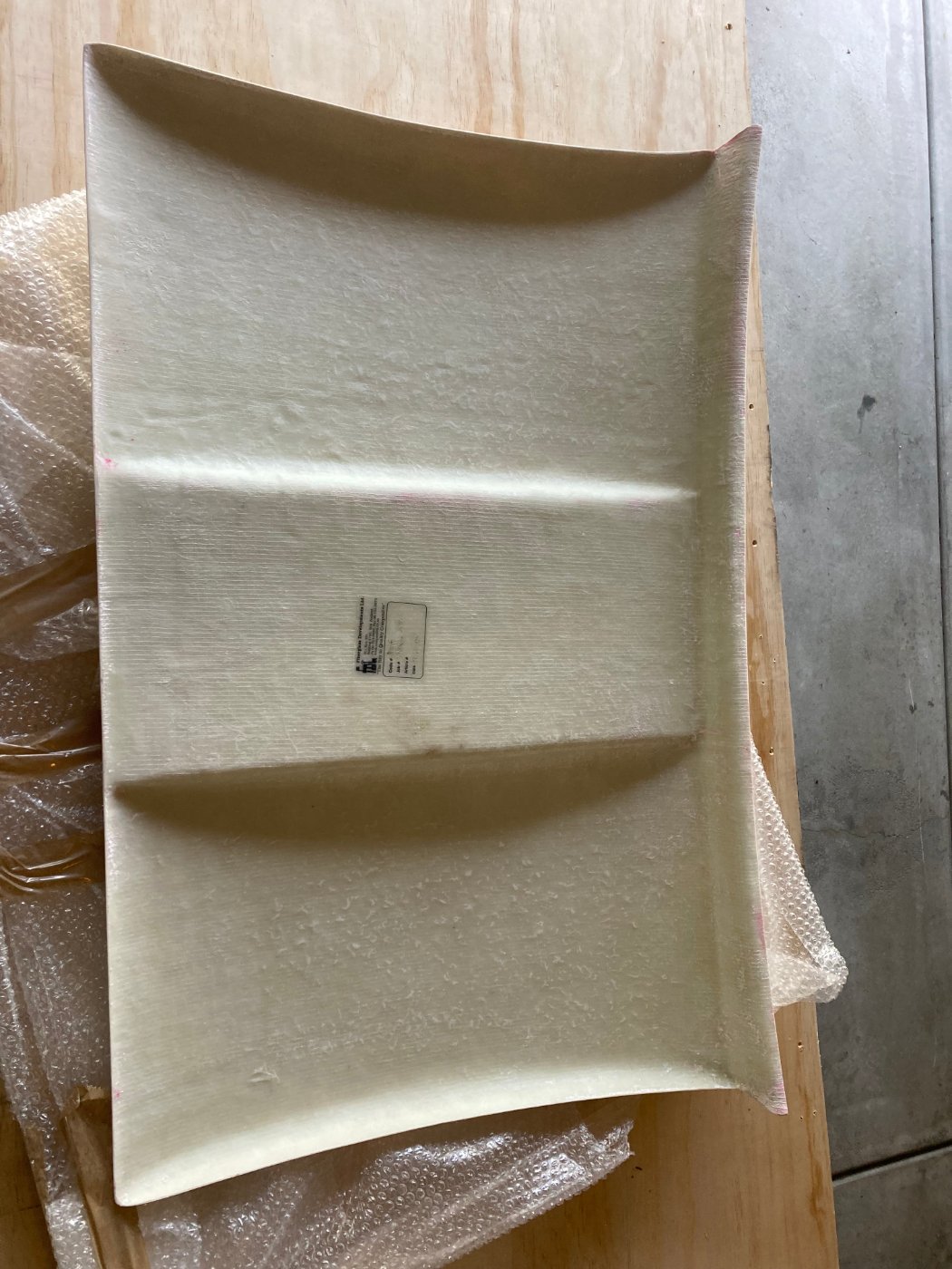

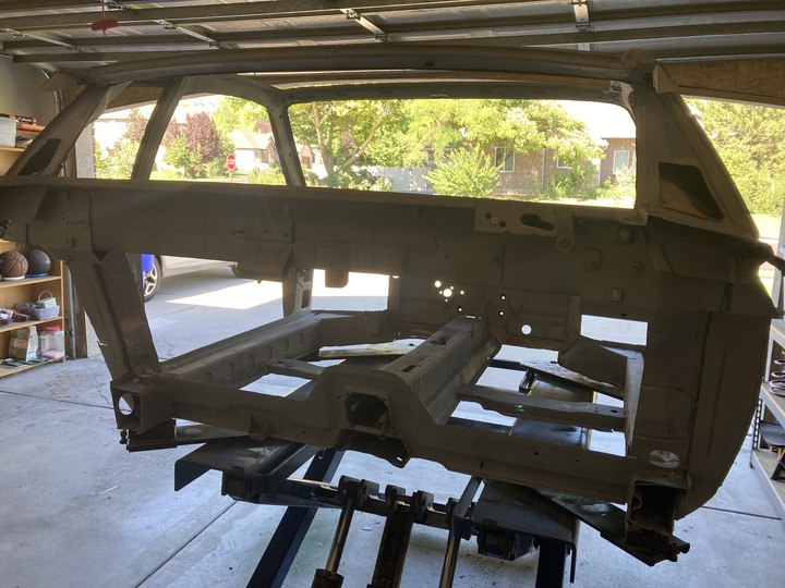

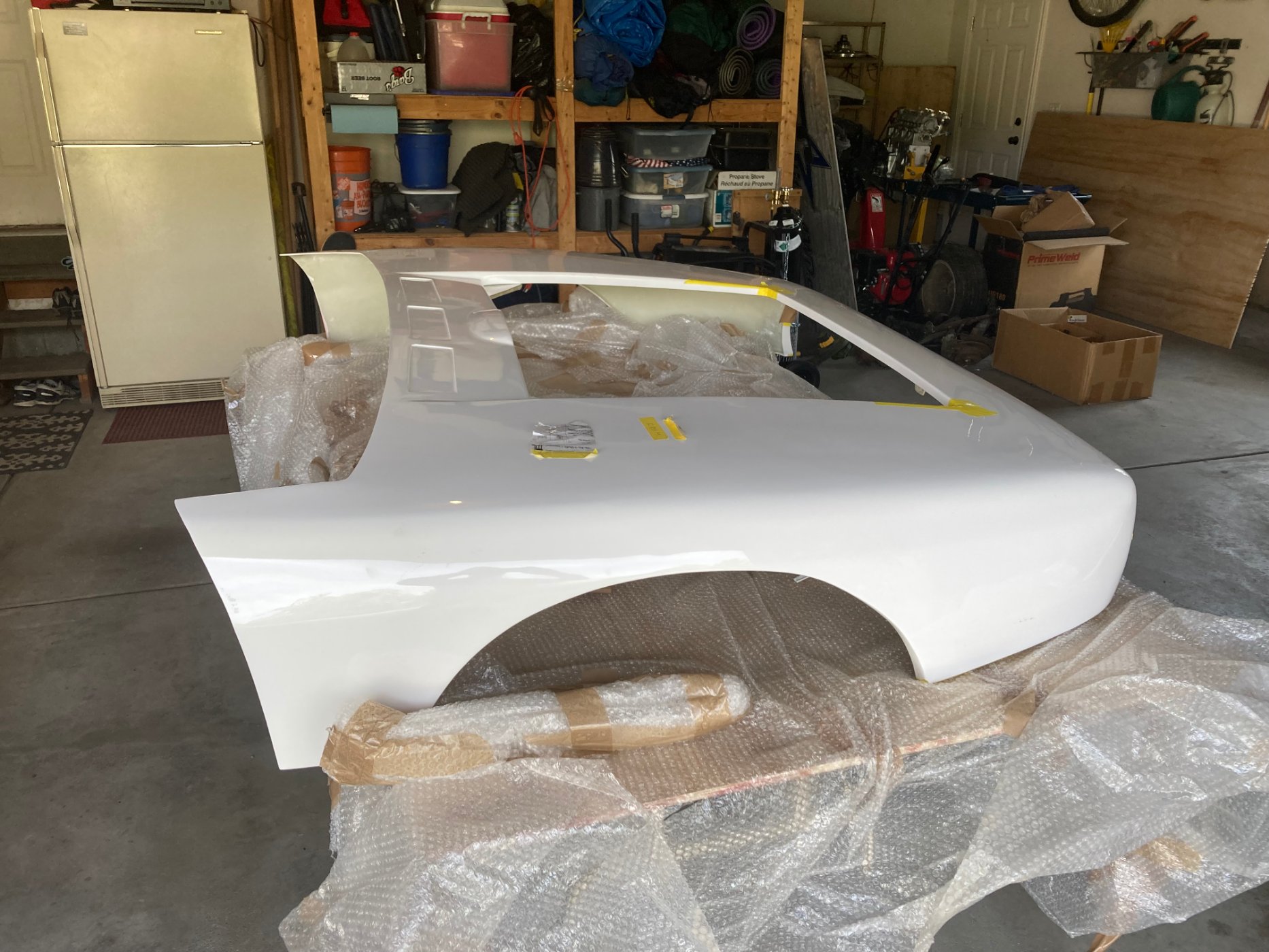

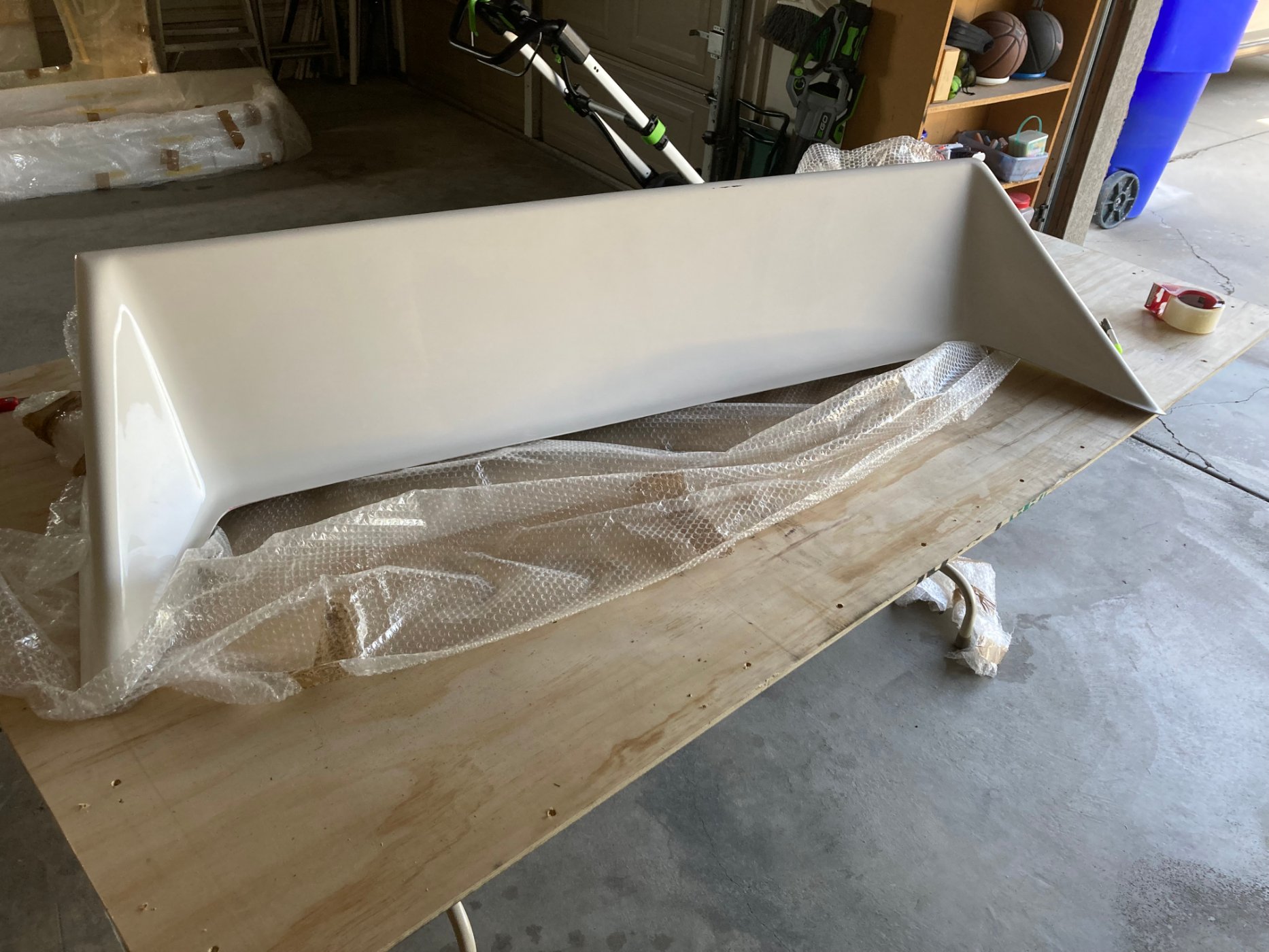

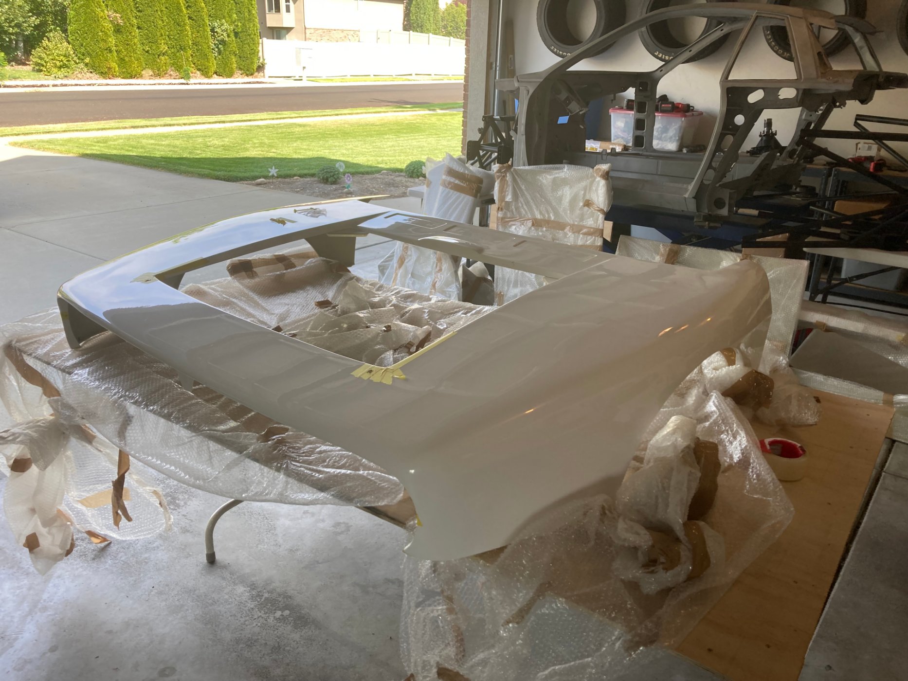

Starting on the rear bulkhead, cutting, cutting and more cutting
John

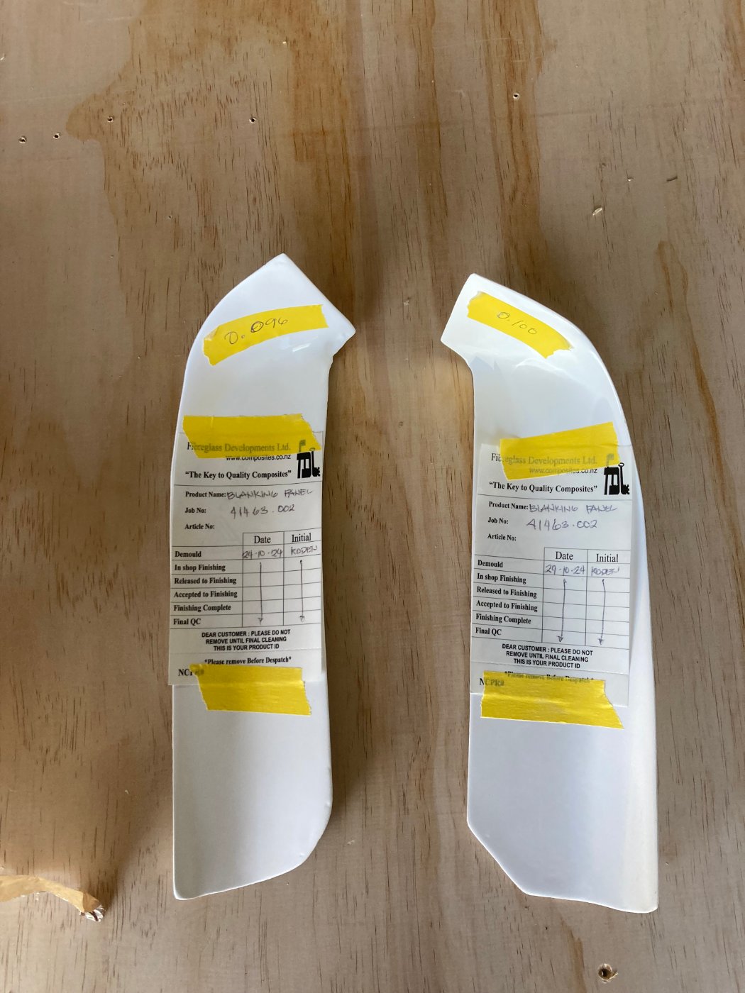

Christmas in July!

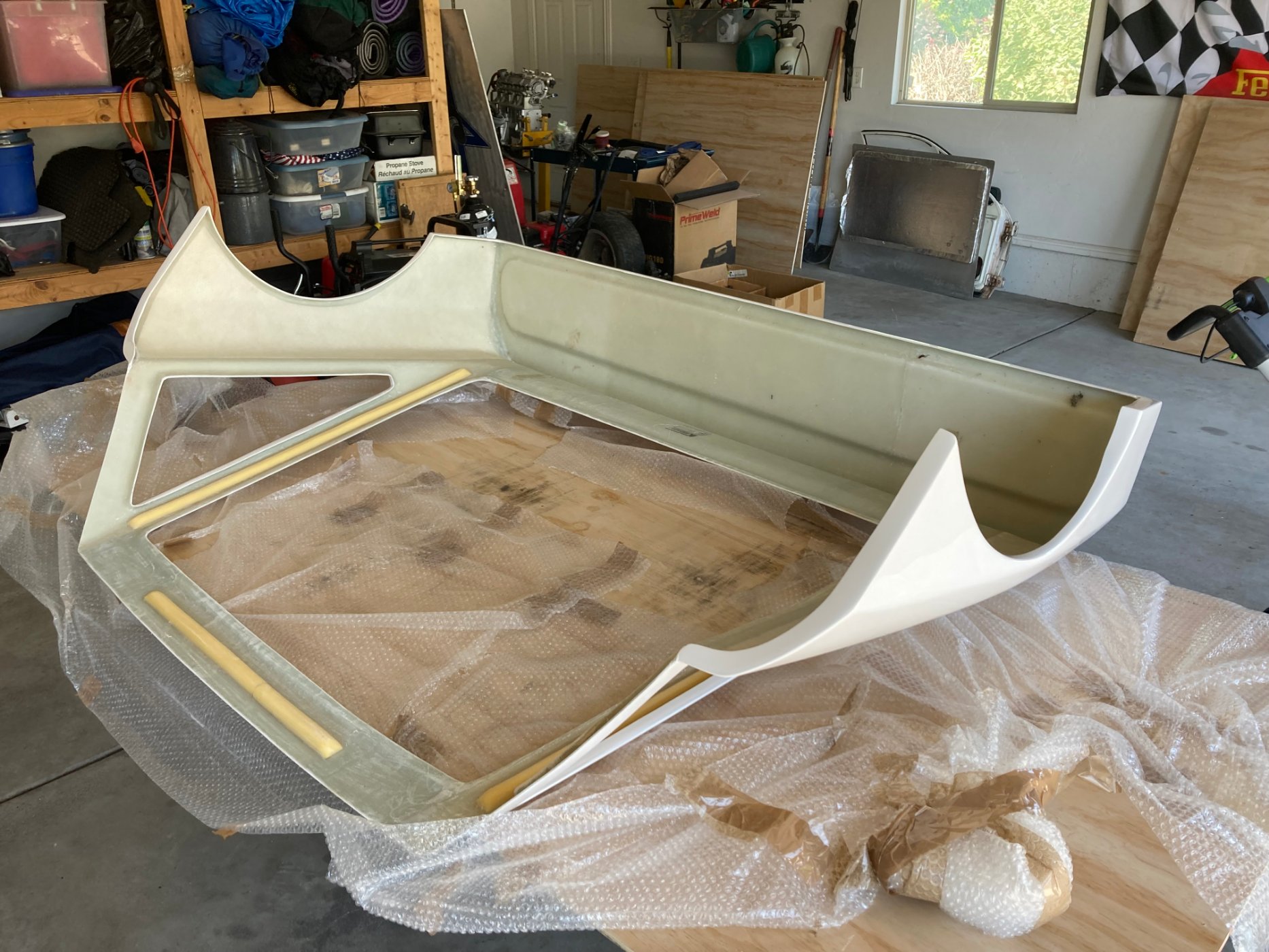

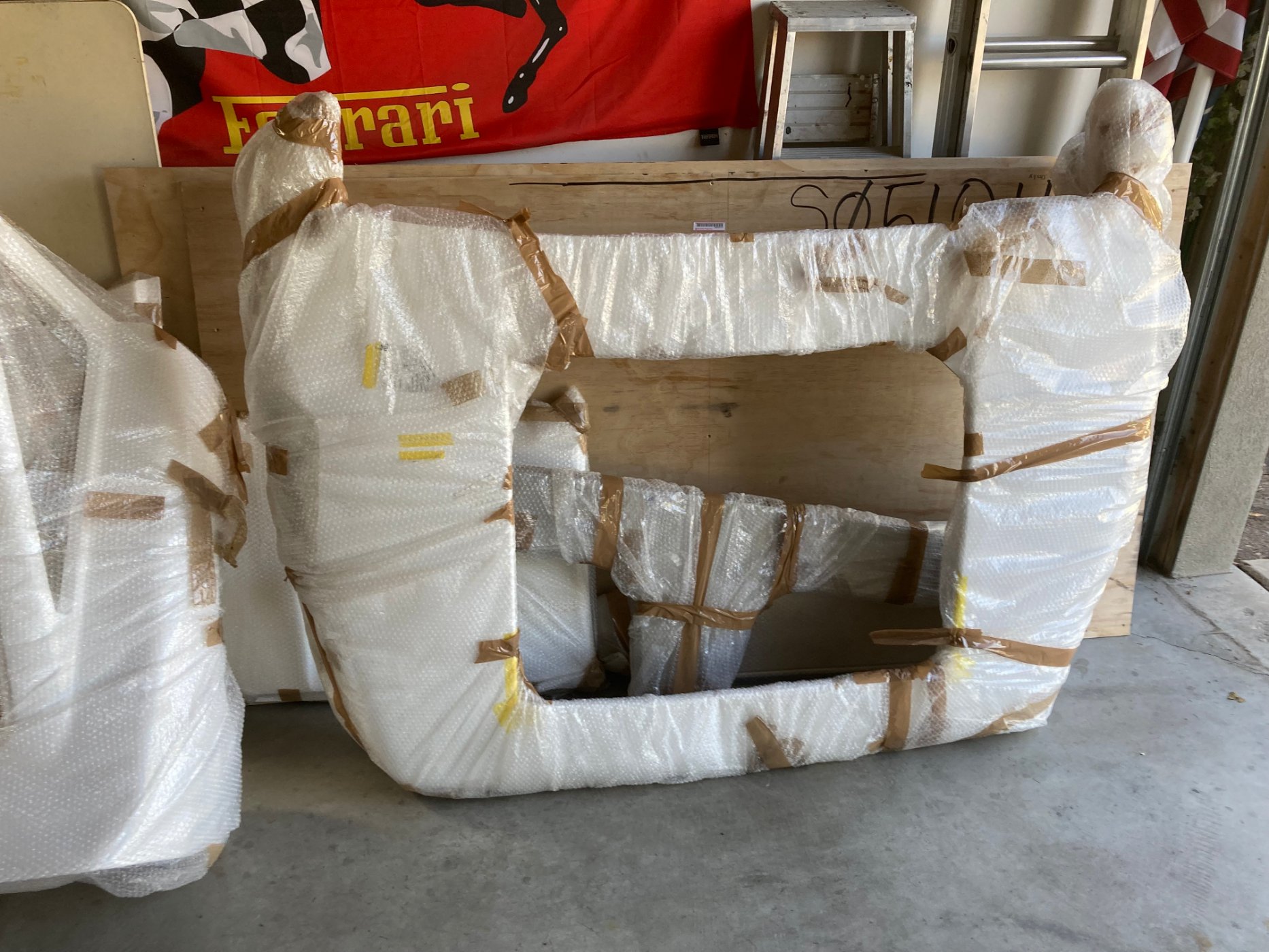

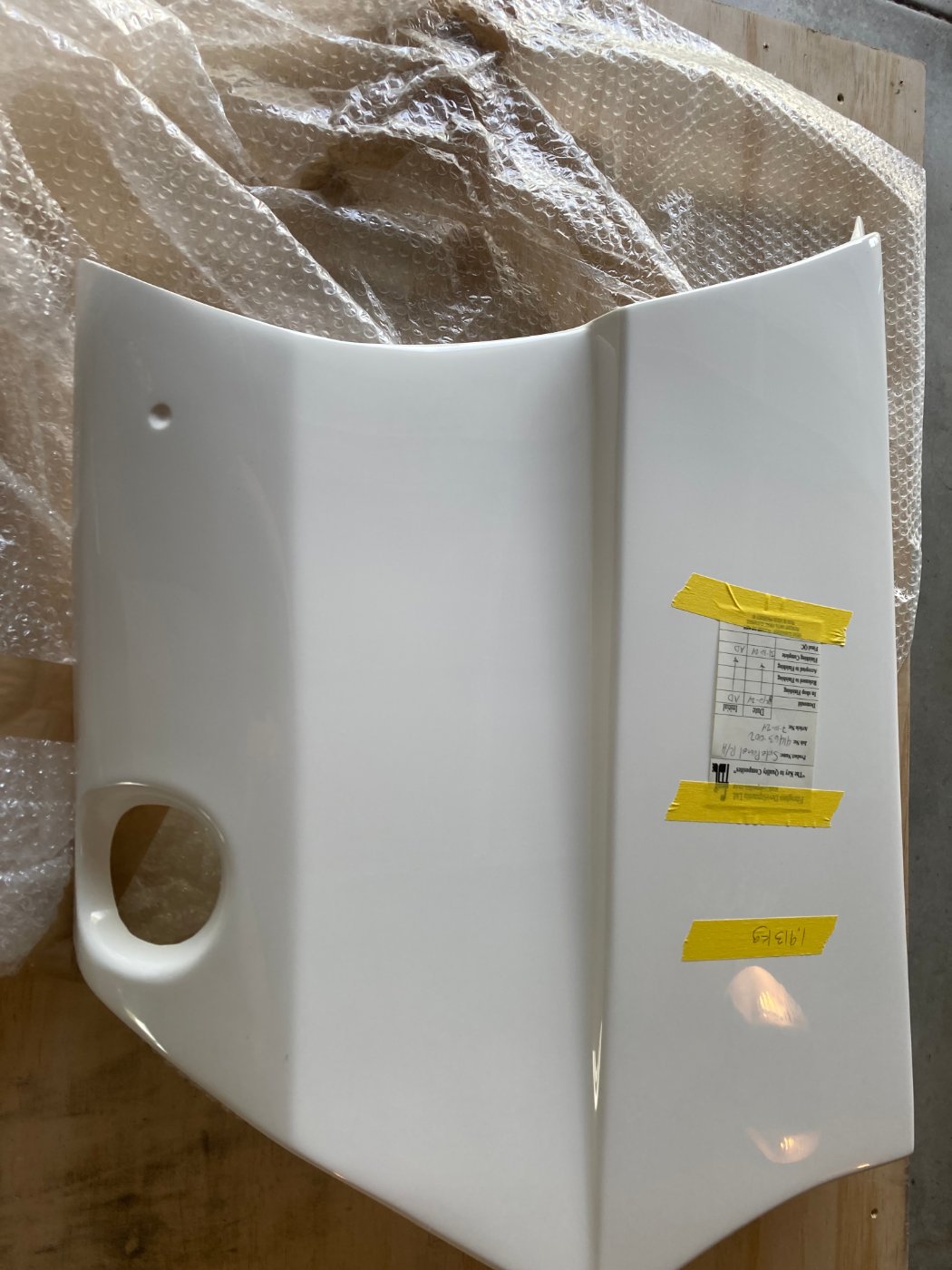

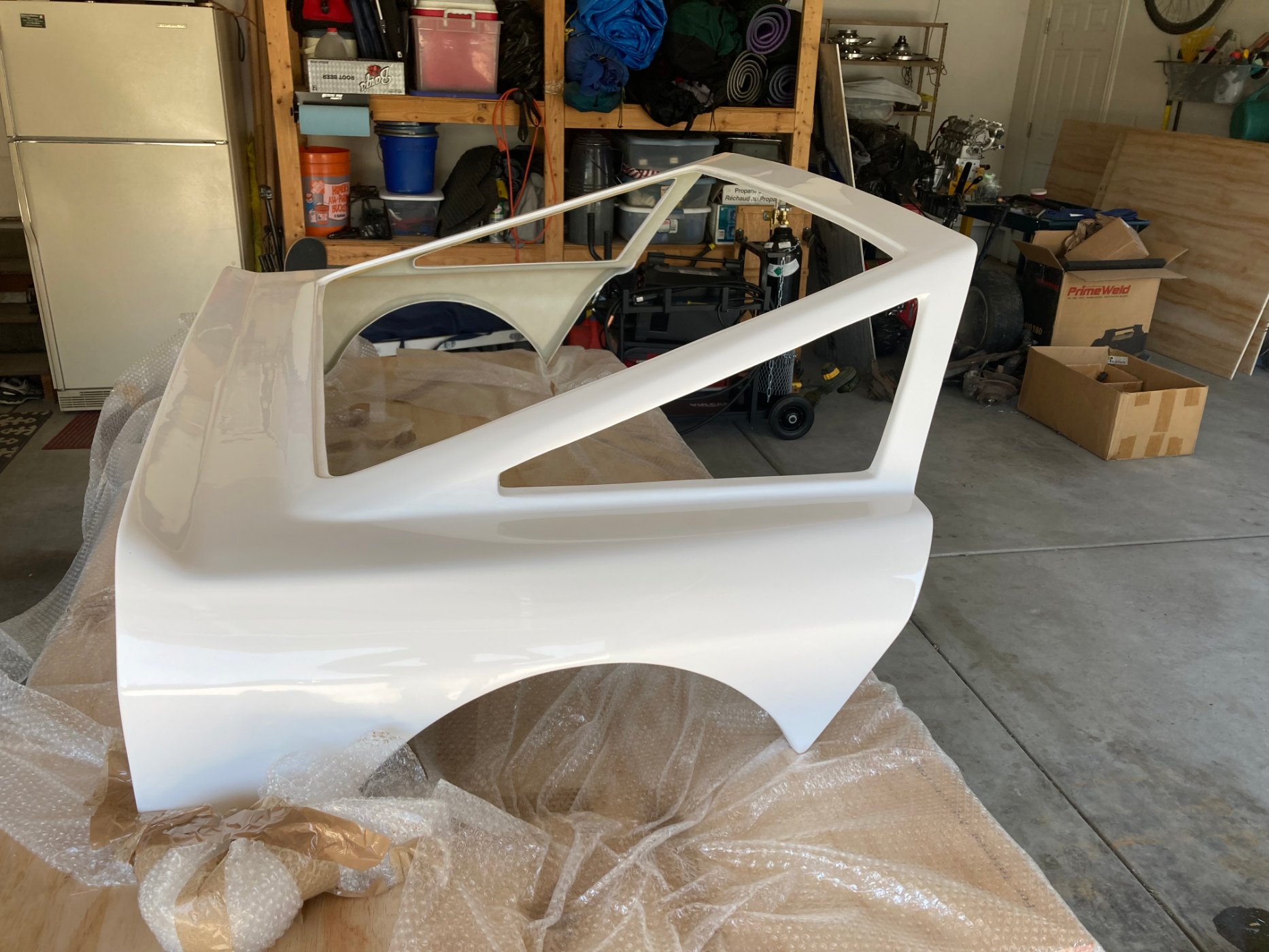

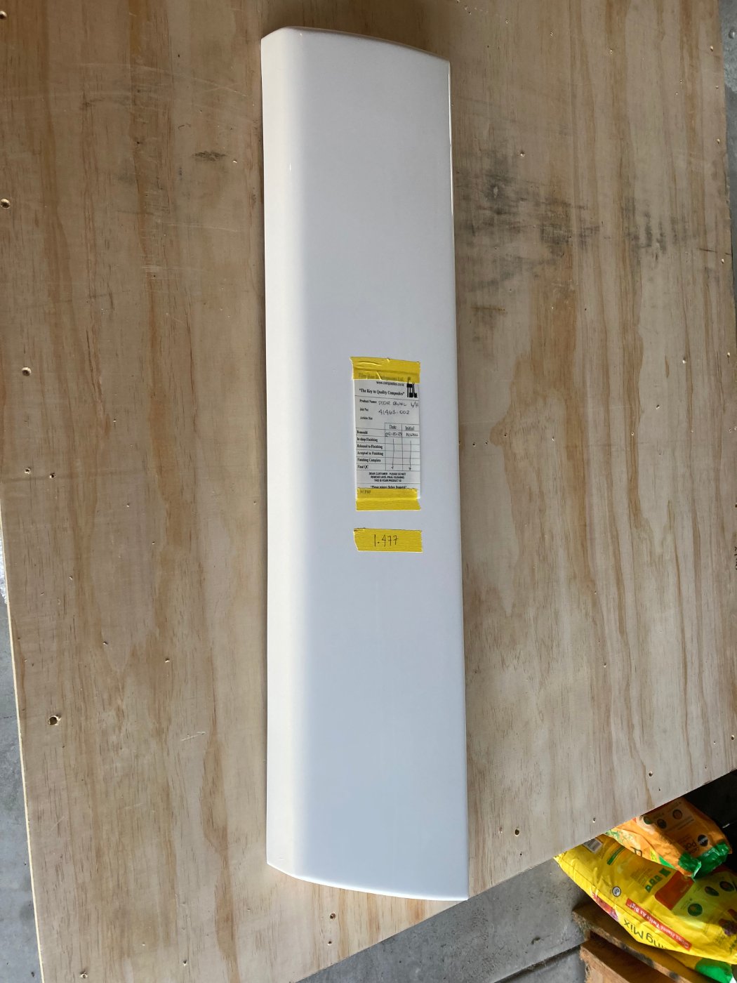

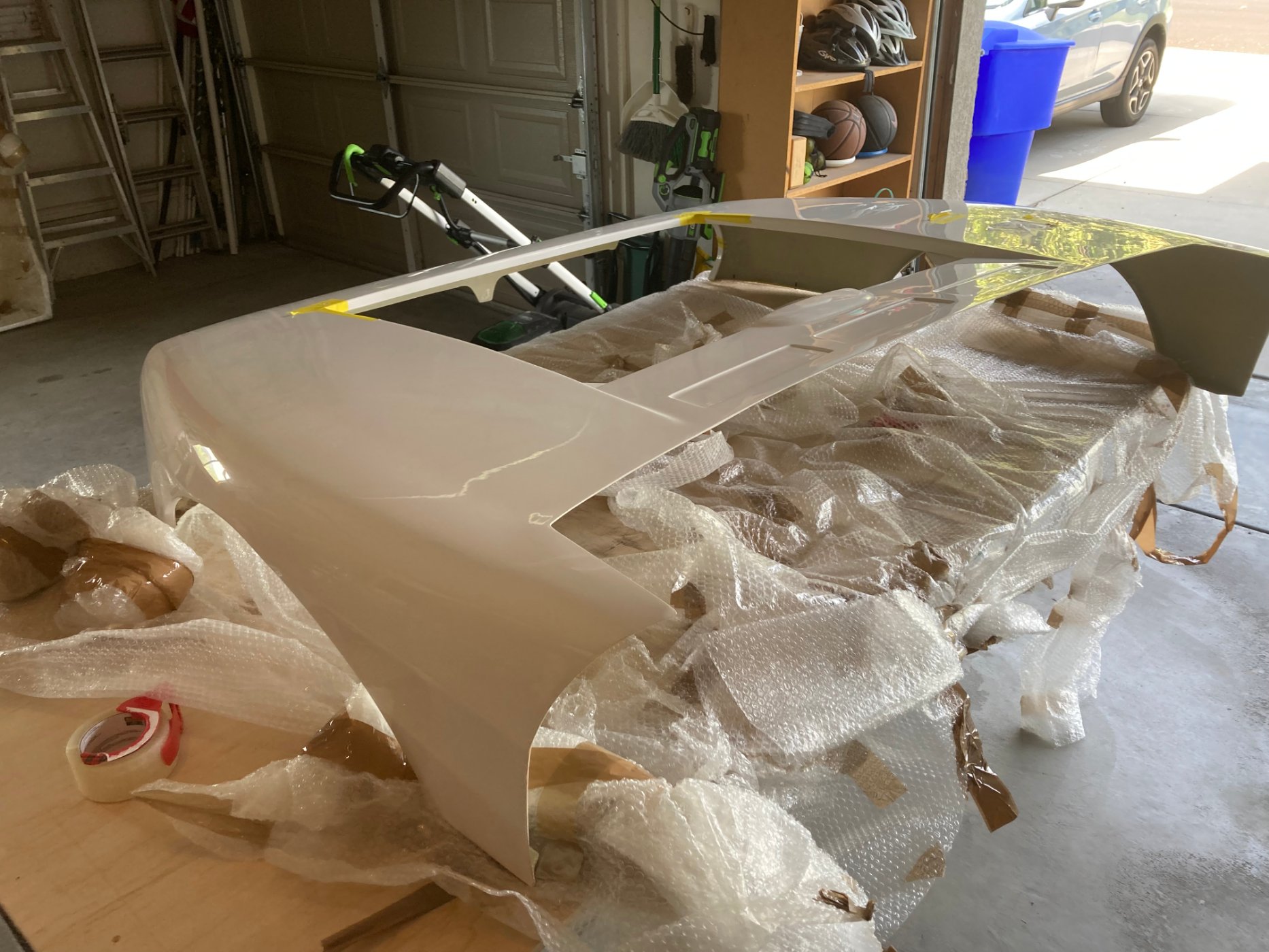

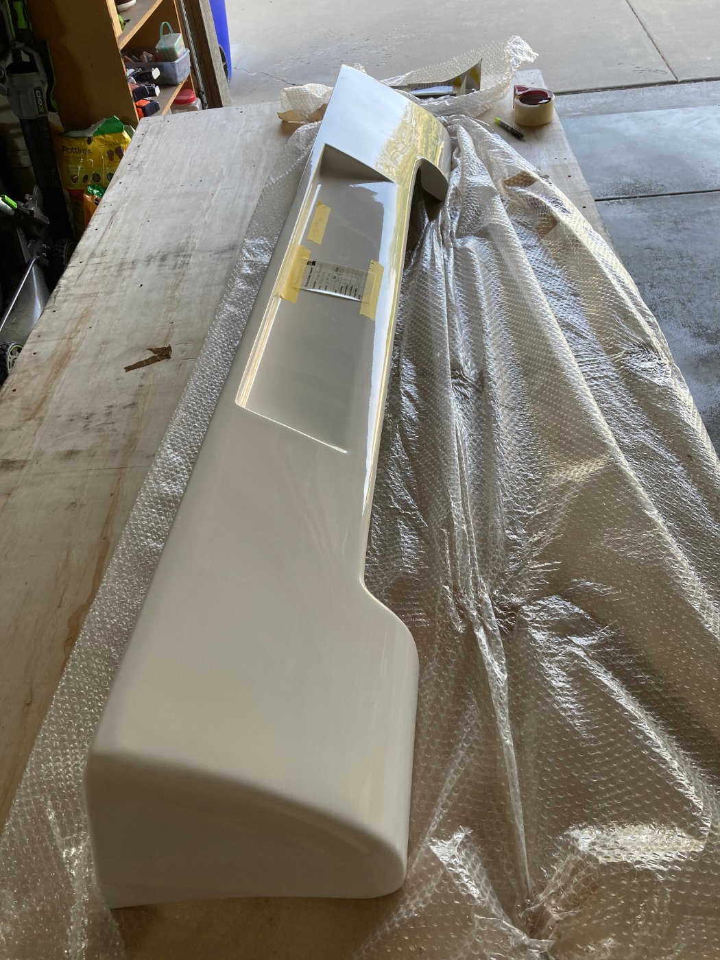

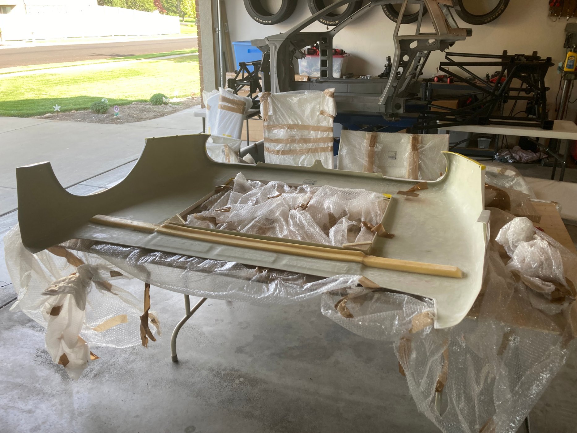

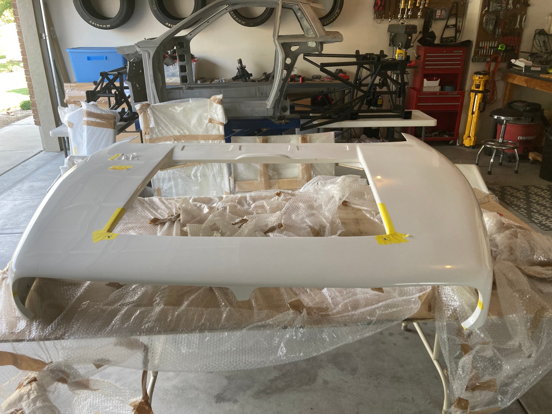

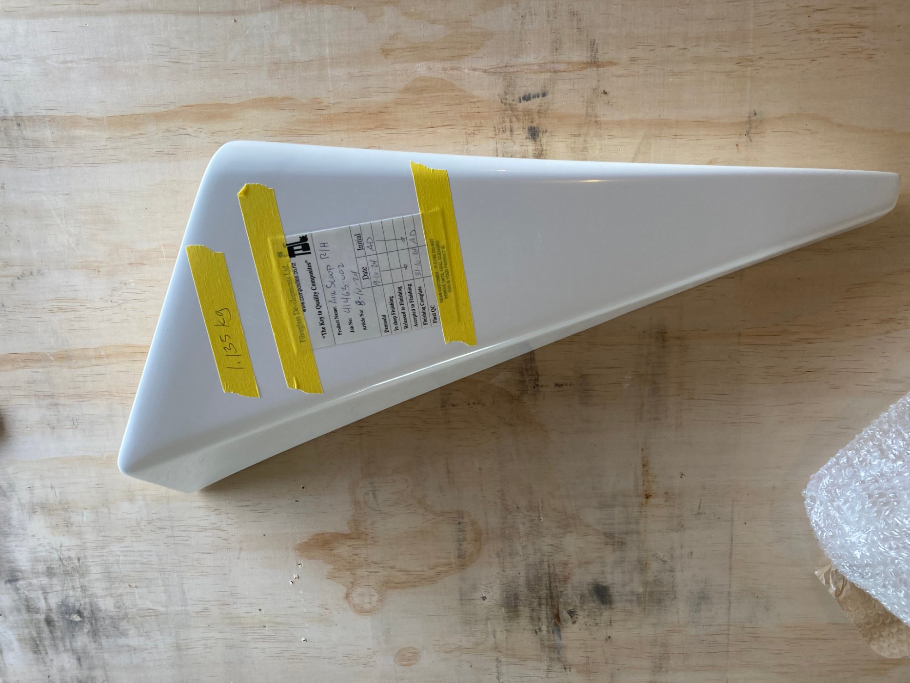

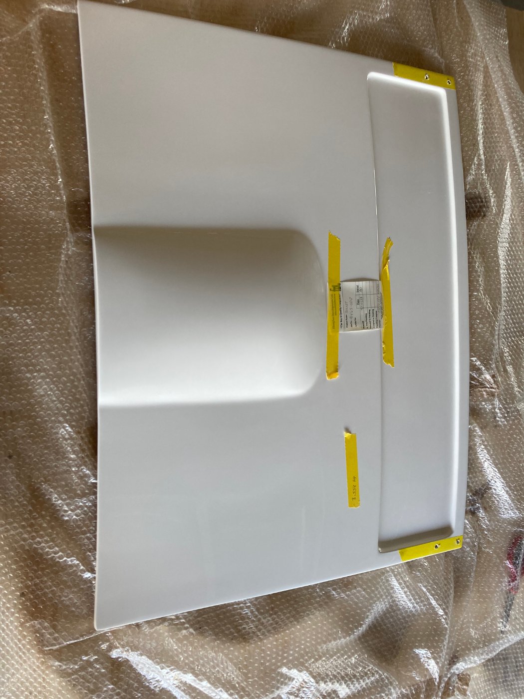

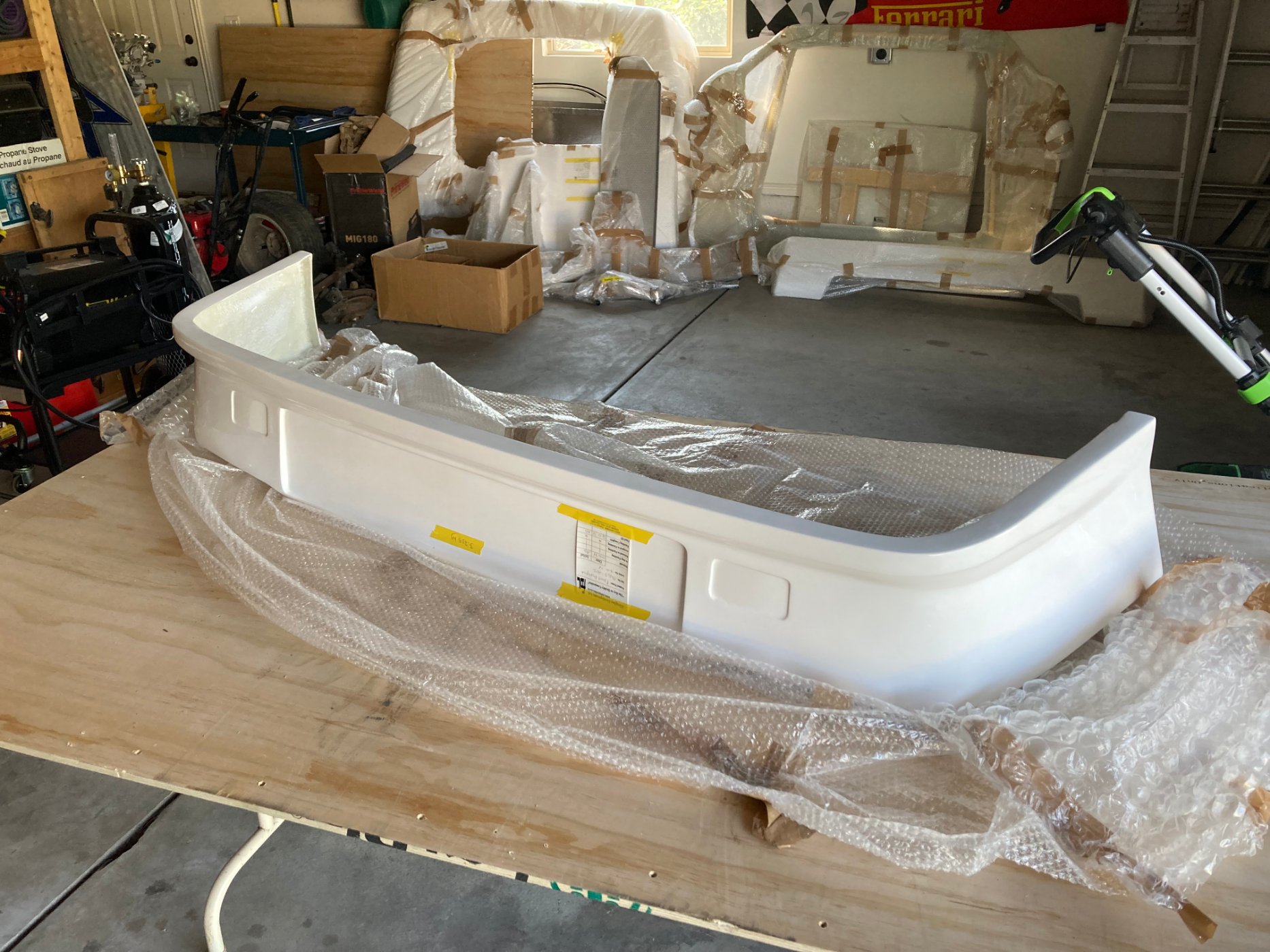

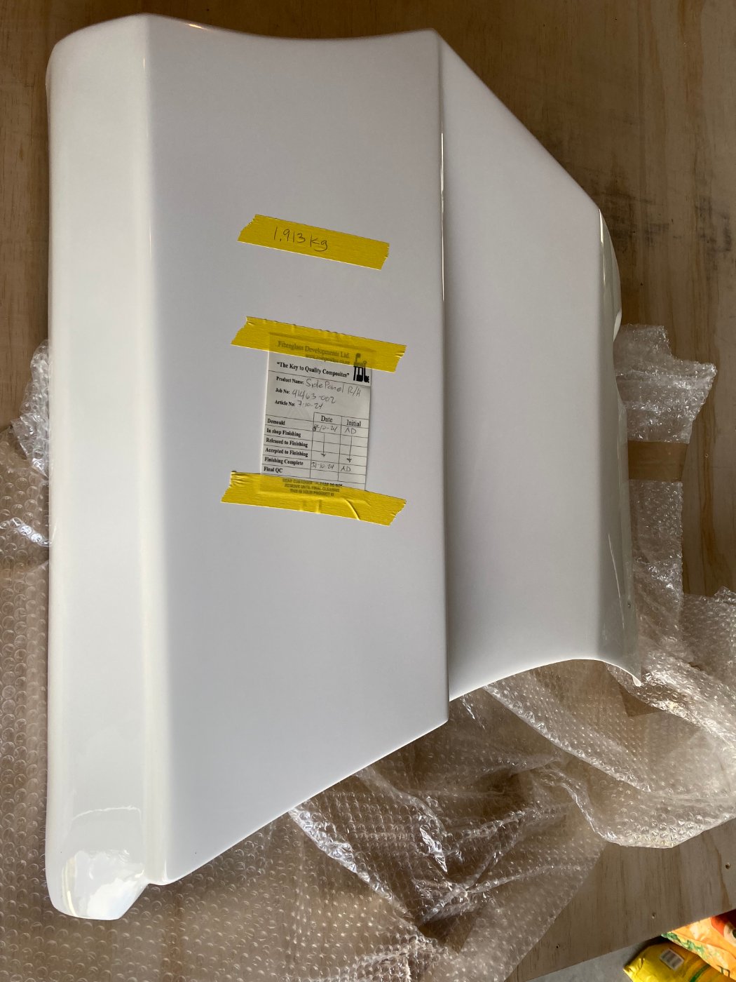

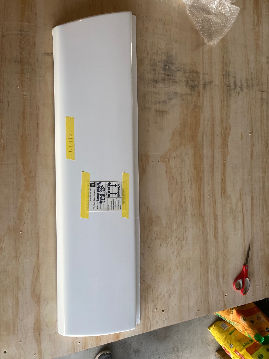

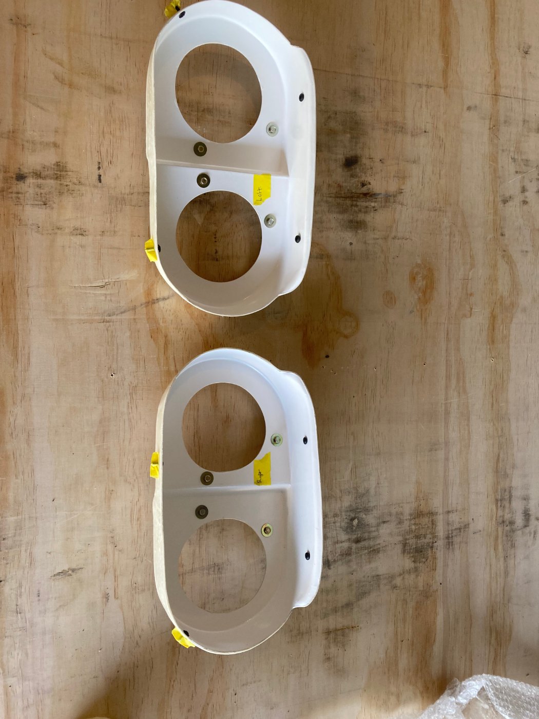

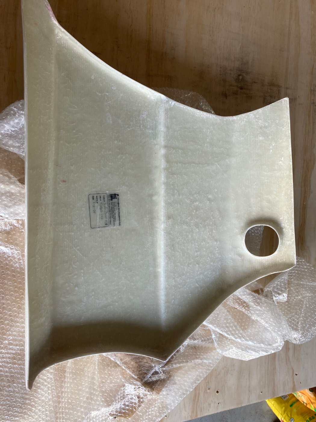

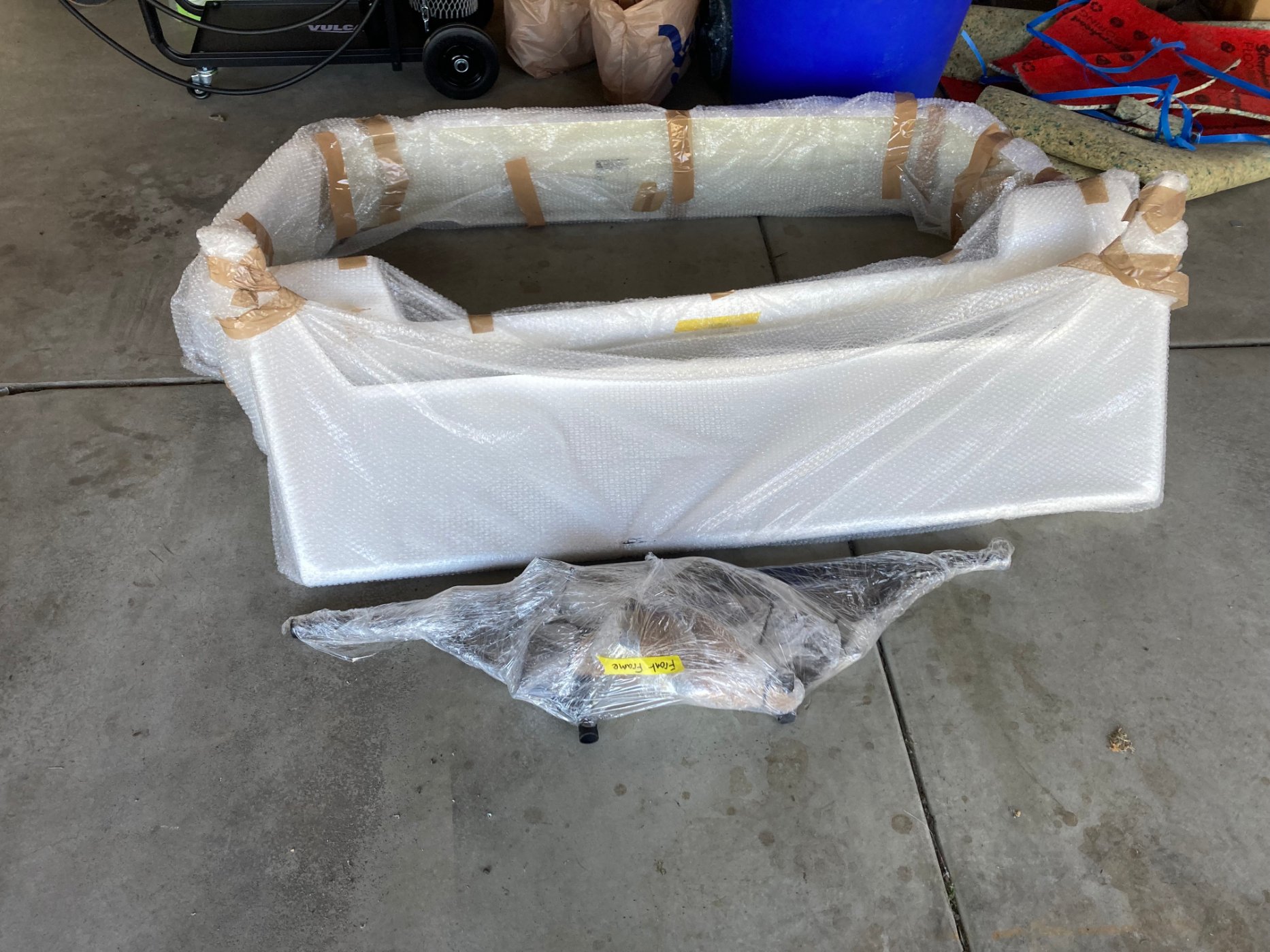

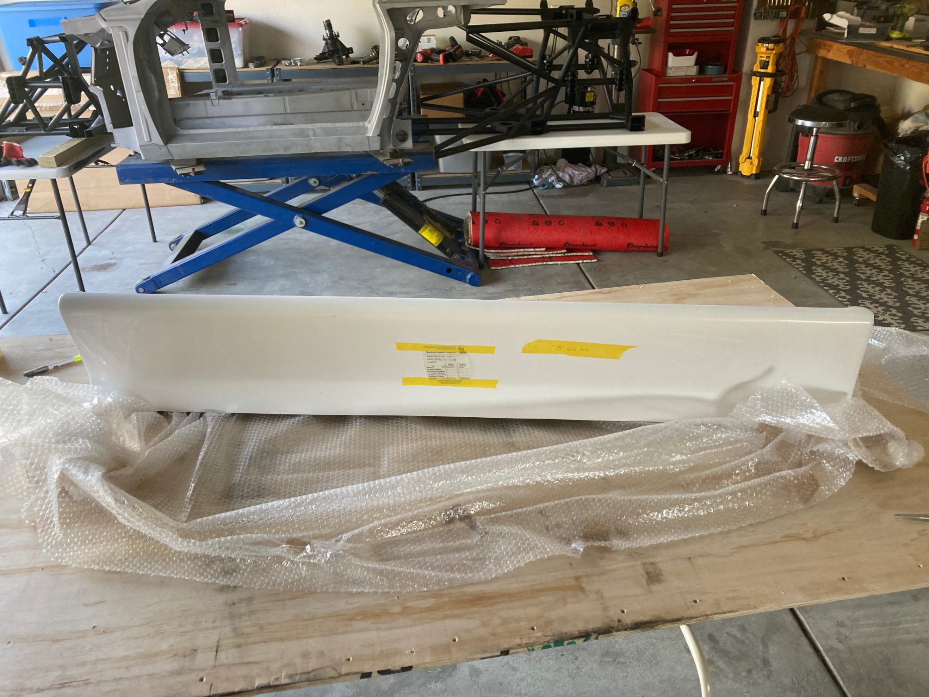

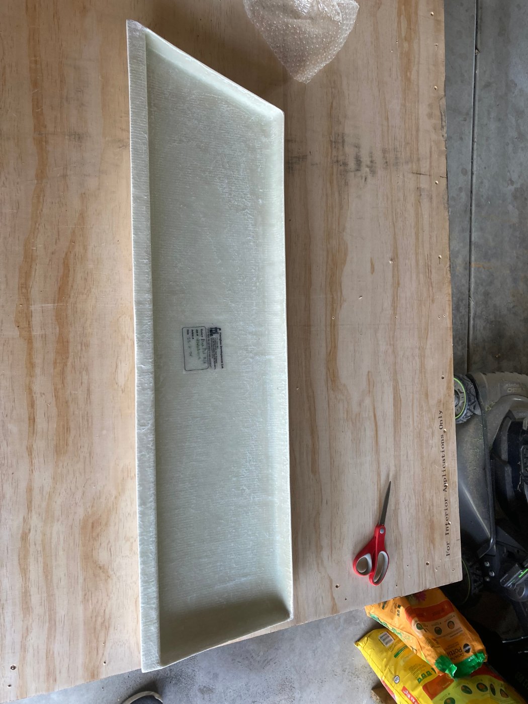

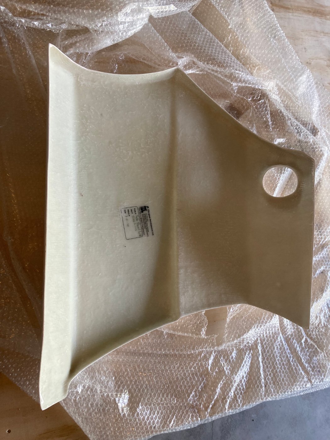

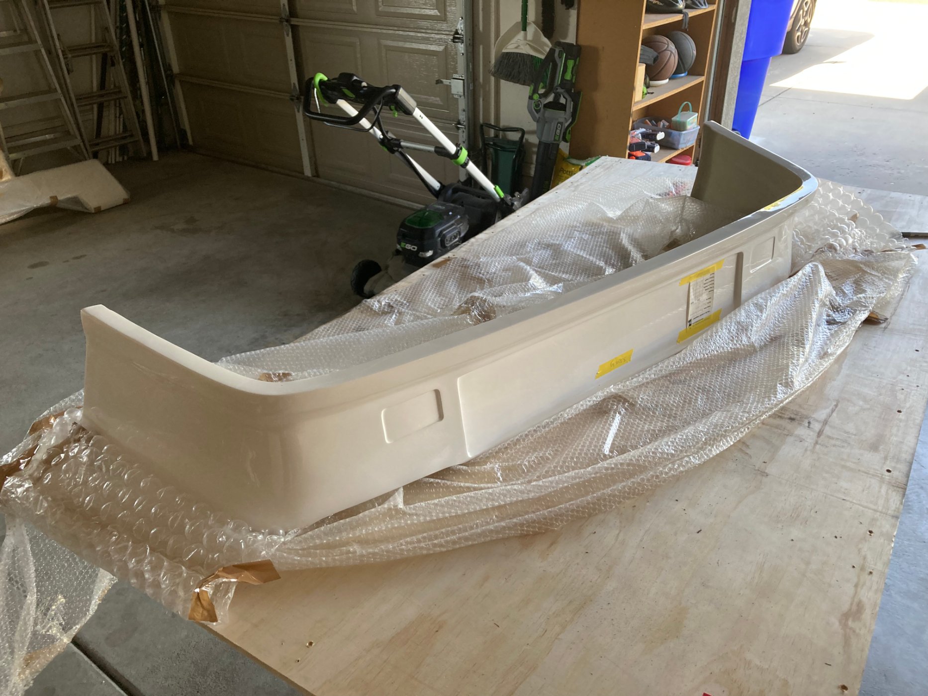

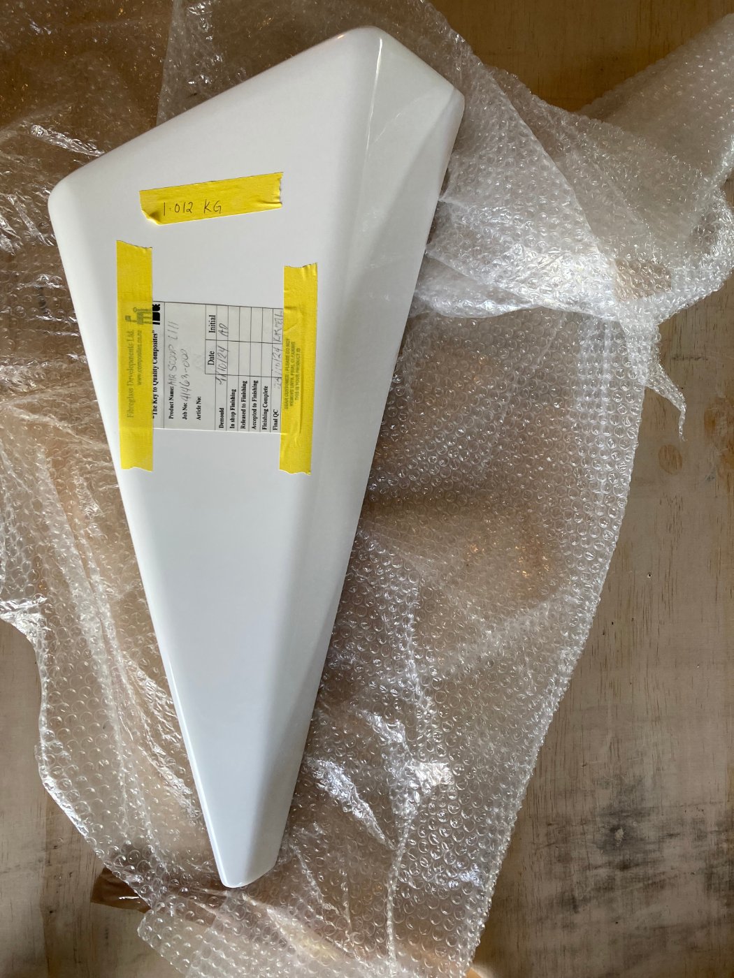

John
Inspecting all of the fiberglass

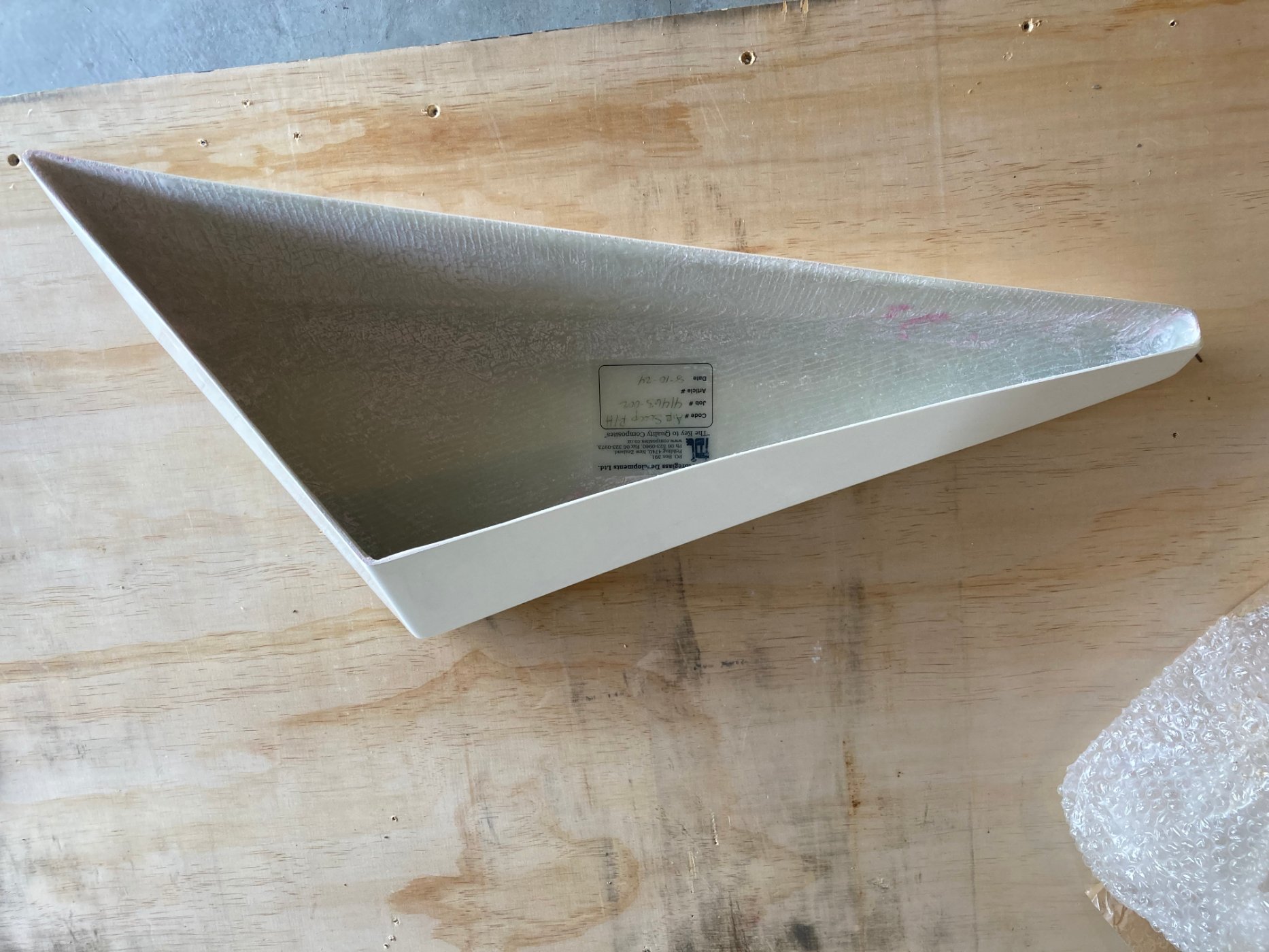

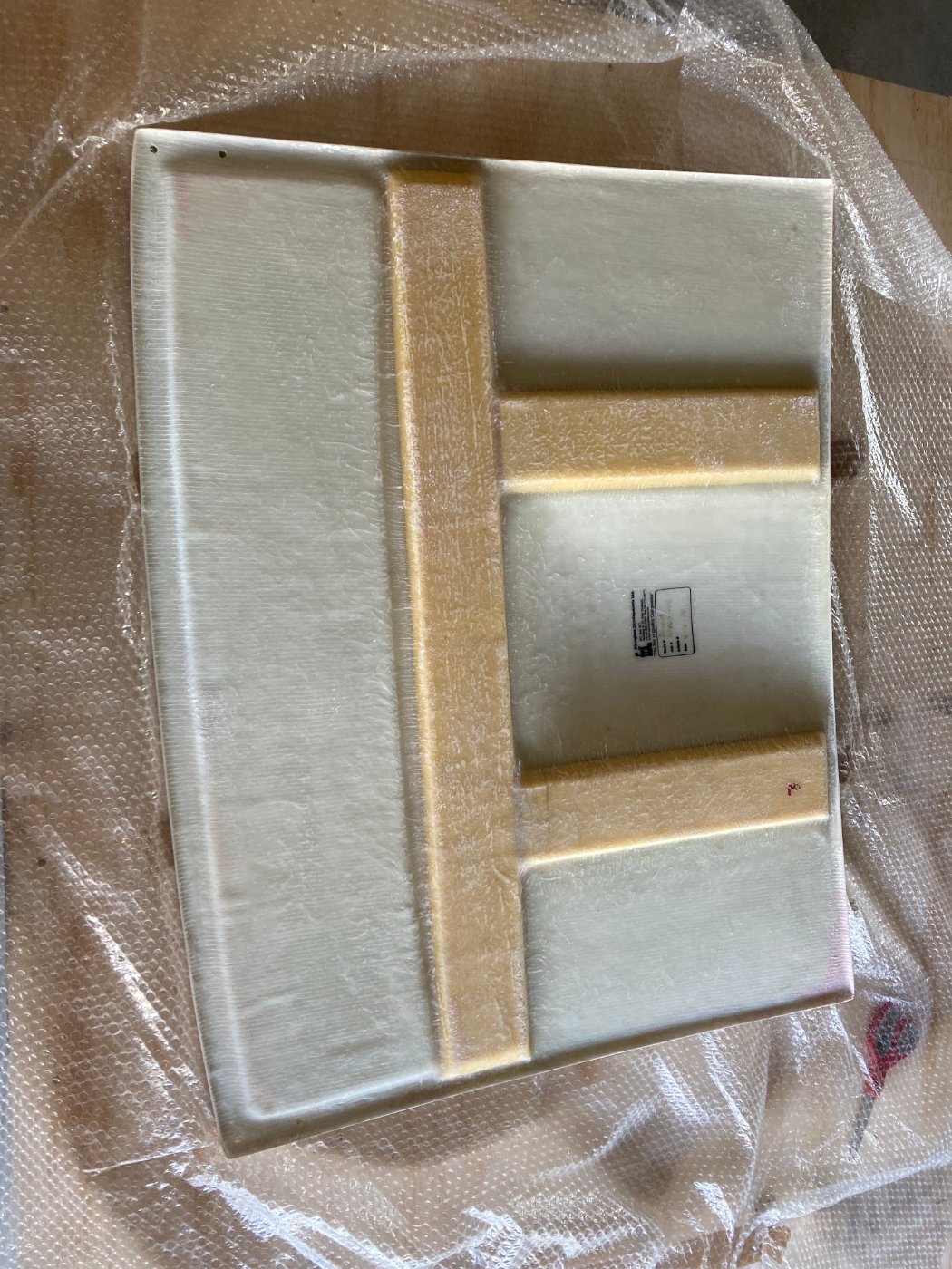

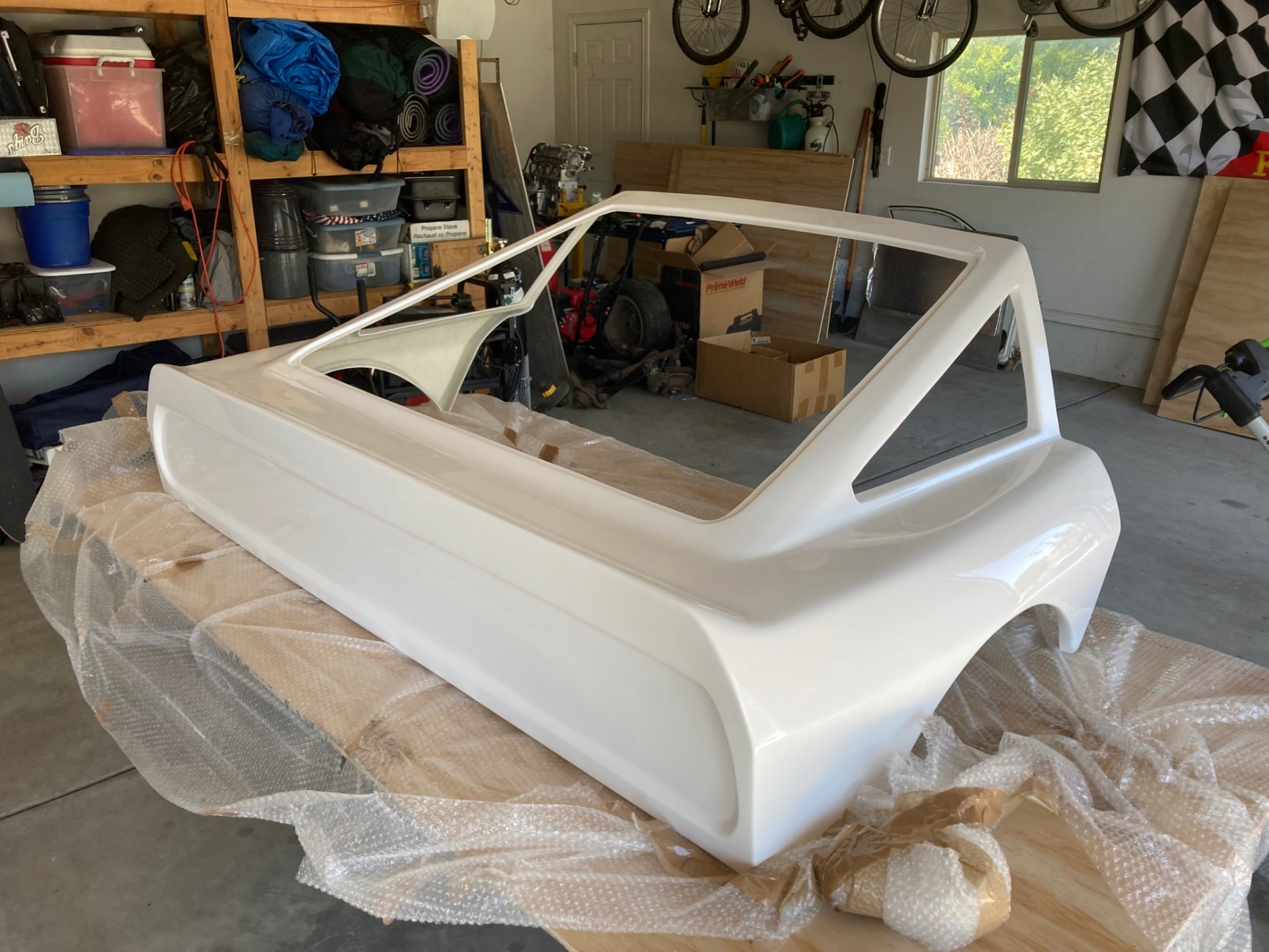

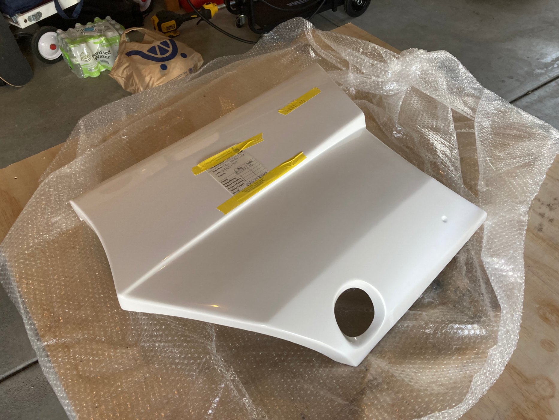

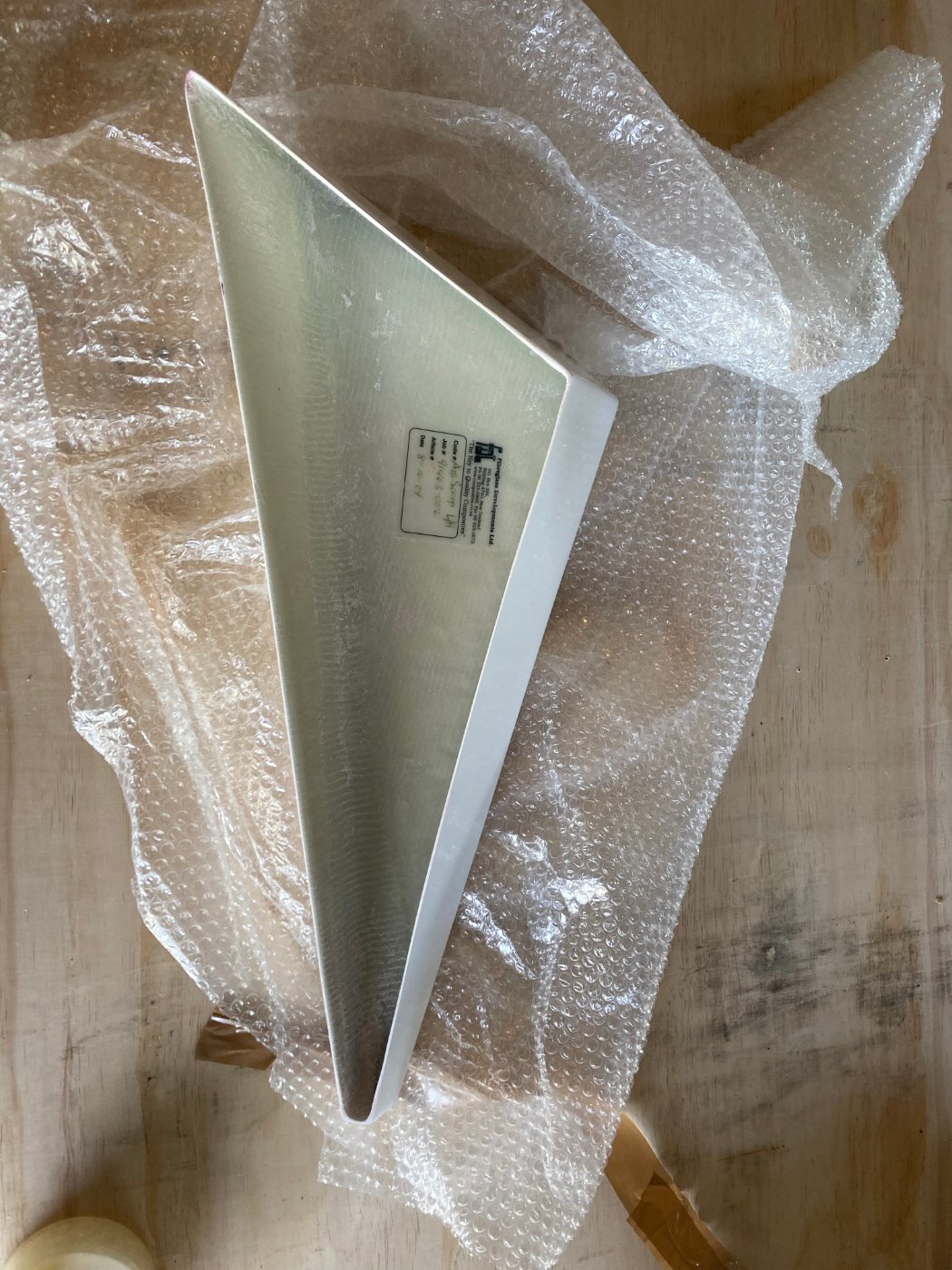

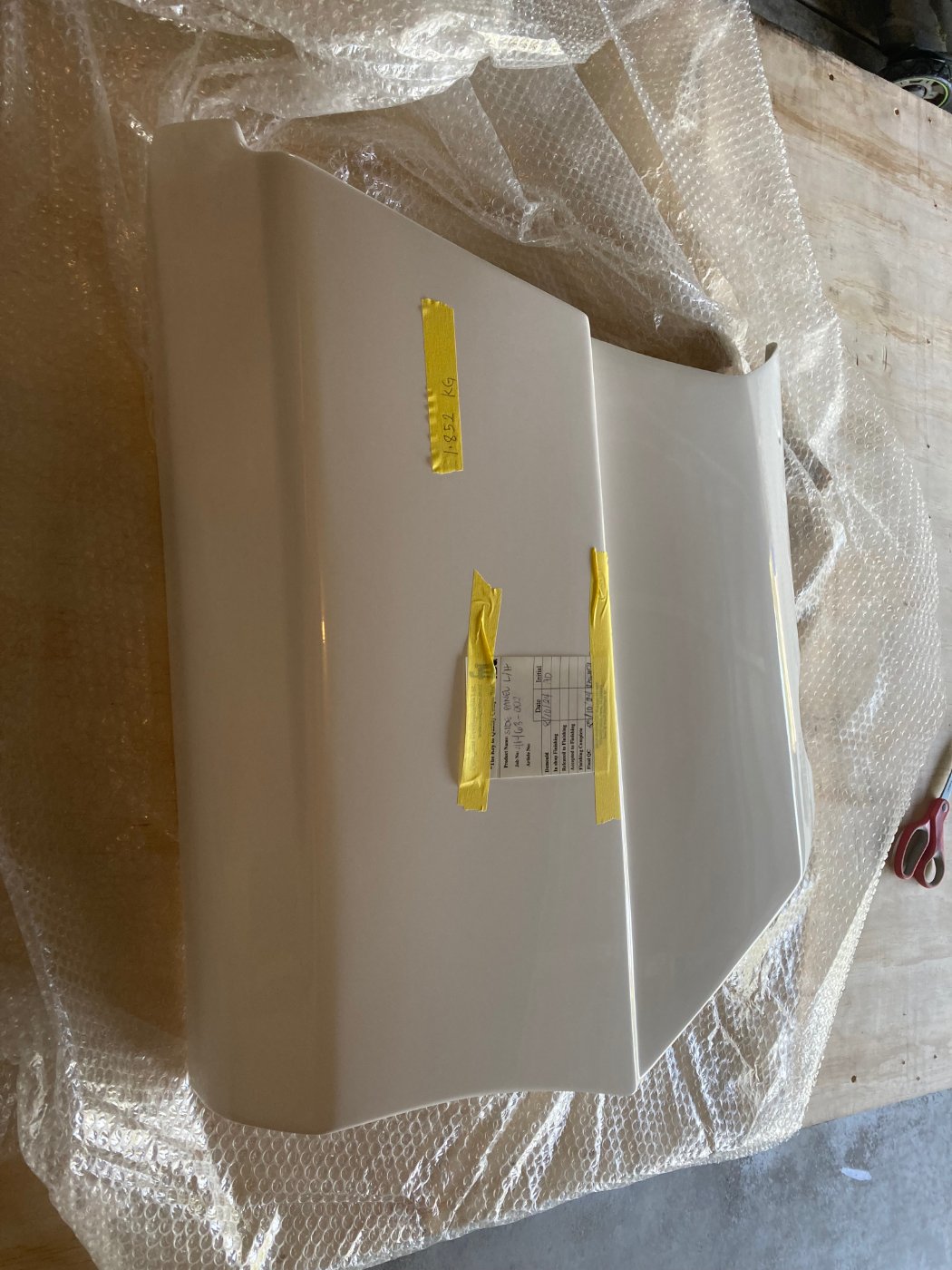

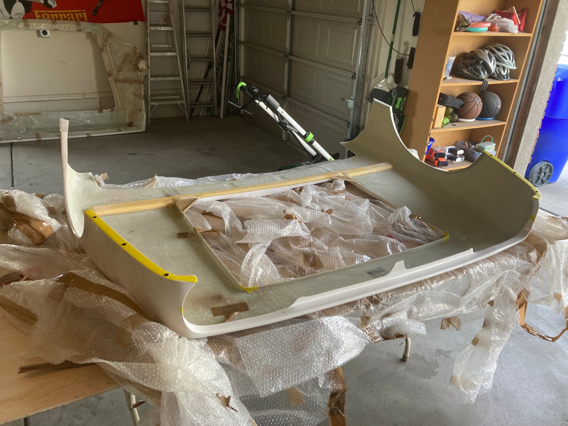

John
inspection continued...

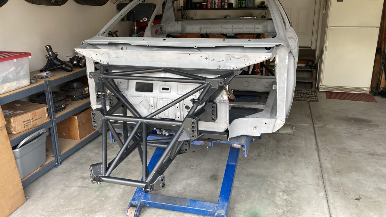

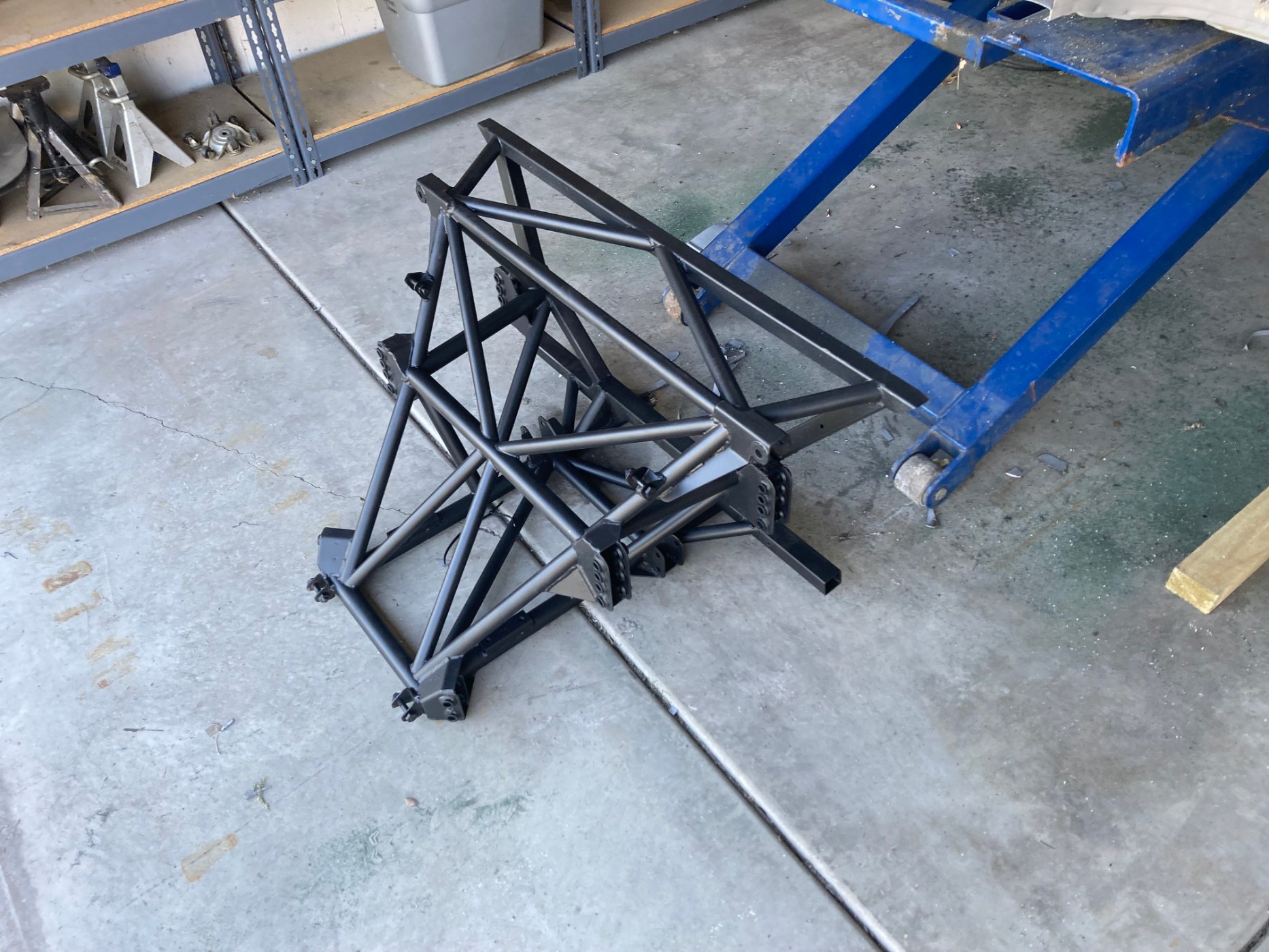

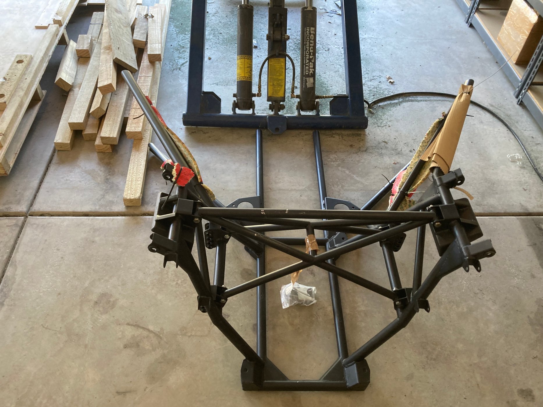

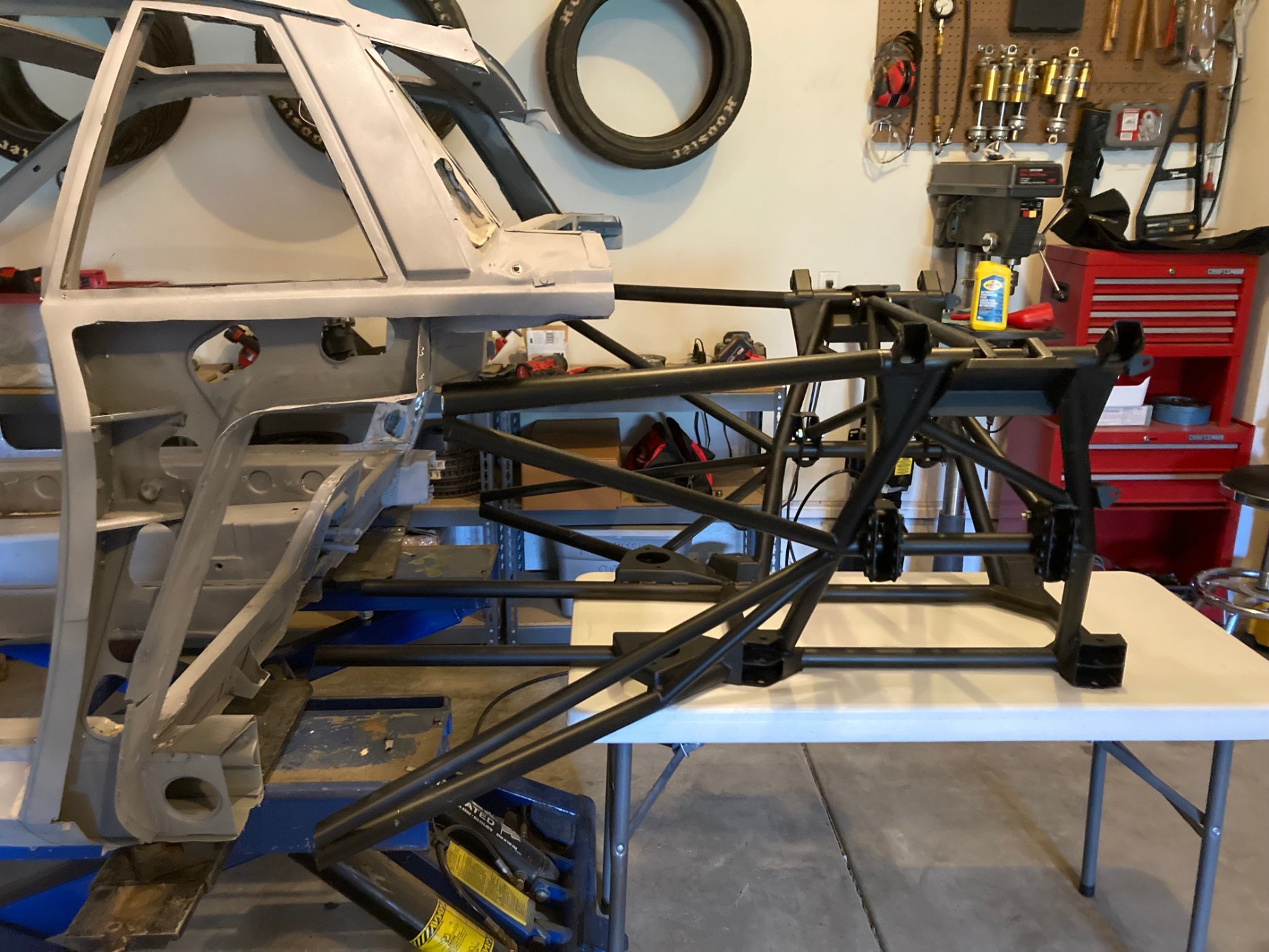

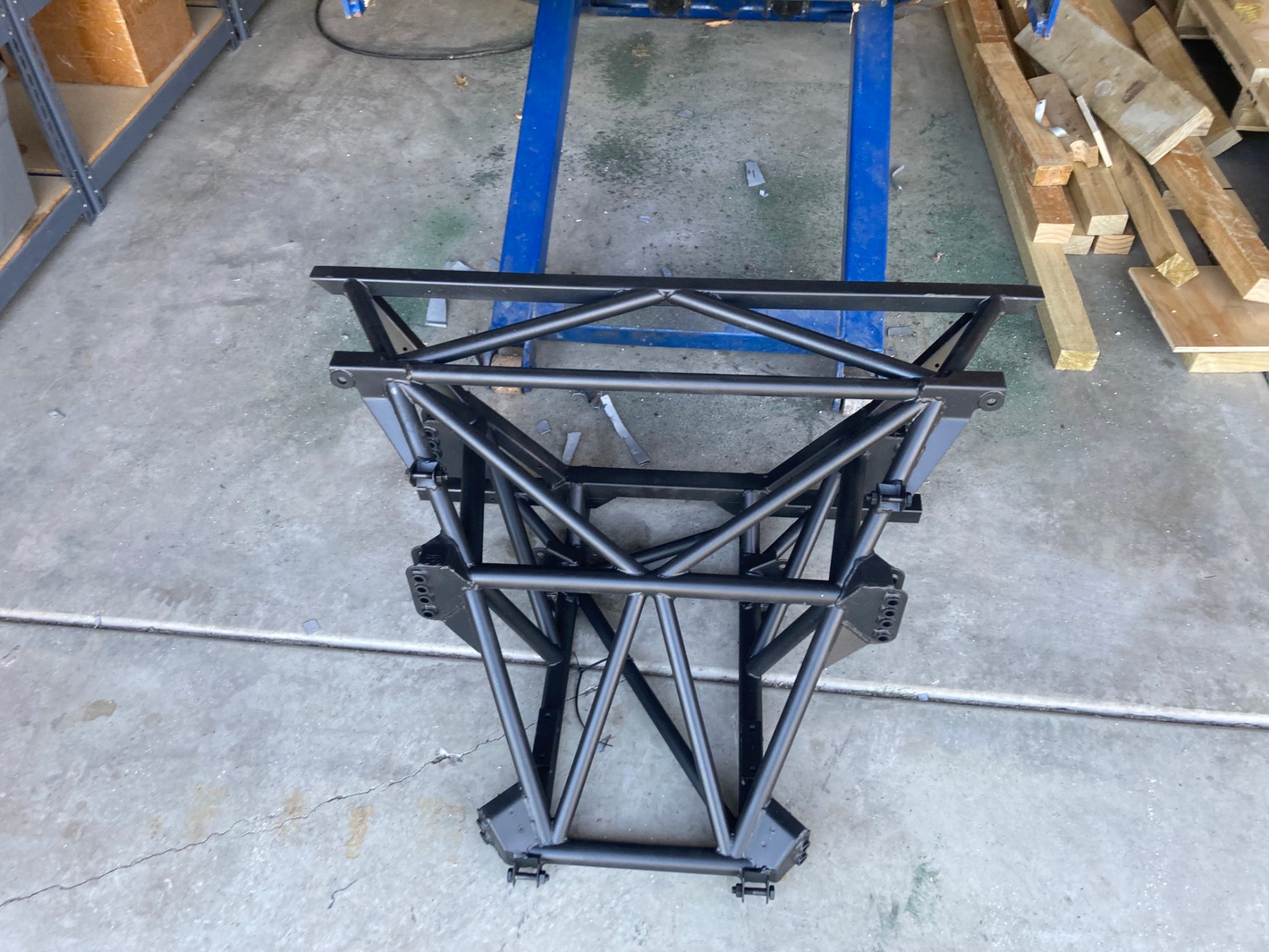

John
Almost ready to weld the front sub-frame on.
John

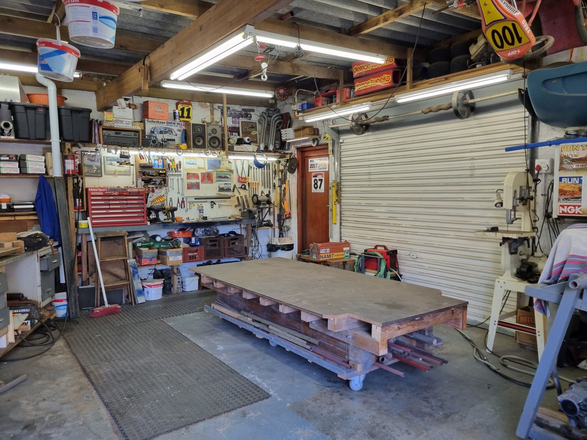

Looking good. How are you going to align the front and rear subframe's with each other, and square to the shell?
Laser beams! I am working on figuring that out. Just sent a message off to Carteroni for their recommendations. I have some time as I am going to put in the rear main hoop of the roll cage first.
Are you talking about something like a torsion table?
Just a big enough flat surface with straight edges you can reference to. First prize is if you can clamp or tack to it to hold pieces in place. I made one out of wood with an MDF top. About knee high. Not perfect, but good enough if you support it from the floor and level it with a long straight edge / spirit level. It's on casters here so i could move it around after i had built my chassis
John
Thanks, that looks good!
