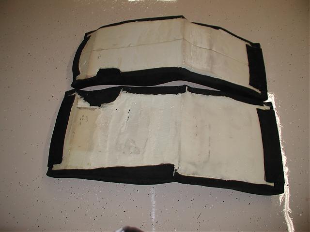

A lot of foam has been removed from the driver's seat; both on the back and the bottom.

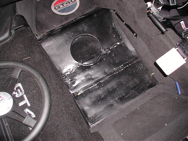

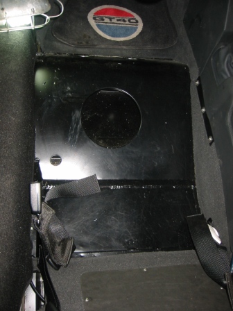

The plate underneath the driver's seat (the one with the hole in it) has been beat down (literally) to get more head room. I plan to cut this and re-weld it at a steeper angle to make it look better, but it's low on my priority list at the moment.
Recommendation? Take the seat out and sit in the car. If you are OK with leg room, head room and steering wheel placement, then get a seat made which is thinner and still gives some cushion.

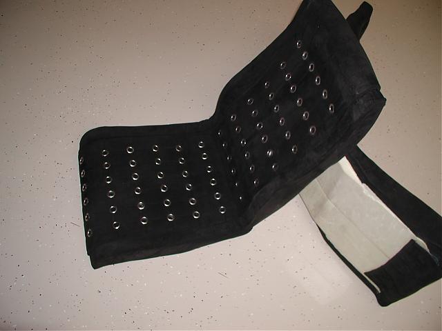

The 'seats' are merely a molded piece of foam with covering glued to them.
Dennis Olthoff used an air sander to grind off some of the driver's seat. I used a box cutter to trim off more once I got the car home.
Taking the seat out is simply moving the seat belts to the side and lifting it out. There are no screws, no latches, no fittings of any kind.
It's a piece of foam sitting on the floor.
I'll take some pictures tonight, if I remember to... and show you what I mean.

Here's three pics. One shows the 'beaten down' piece on the floor.
The other two show the 'seats'. The driver's side has had quite a bit of foam removed from the bottom and the back.

Kirby - Great pics, thanks! NOW I understand.... I'm still going to go and have another sit... this time on bare metal!

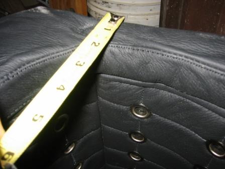

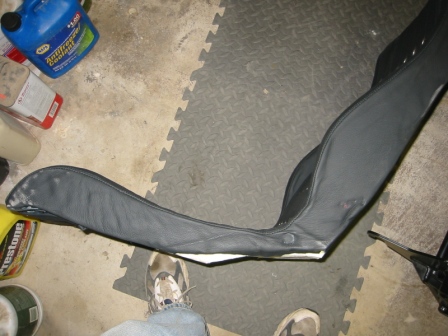

Good idea about sitting in the car without the seat in place. These pictures are of my stock seats. As you can see the seat has less than 1" of foam under the butt. I'm 5'9" so I have the opposite problem as I will be adding foam for a proper view of the road which will also help on long rides. I think the flat metal under the seat is the bottom of the car so there isn’t any room to go in that direction. Good luck.
