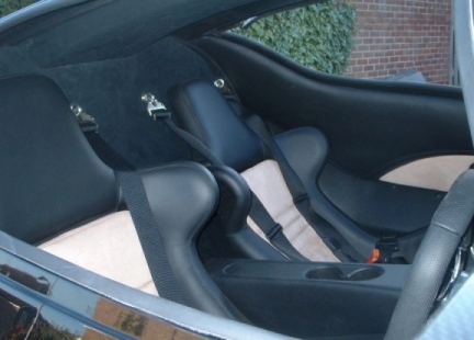

for added safety you can always add a few black plastic countersunk screws that fit flush to the lexan which blend into a black paint border. Theres enough meat in the panel to drill and tap as the GRP is pretty think there.
A rubber weather seal can be snapped around also before lexan fitting which neatens up this edge from the inside view. As its thicker than the panel when the lexan is put on it squeezes the rubber to a seal.
my rear lexan was border painted and not prepd properly which caused another headache as it peeled imediately in certain areas. It got worse in the sun. Be very careful on fitting the rear lexan.

Craig - Nice looking interior. Thanks for the tip on the windows. Roughly how many countersunk screws did you add per side window / rear window? Did that weatherstripping in the picture come withthe SLC? How's you SVA inspection going? Can't you just bribe them, like here in Texas?!:thumbsup:
