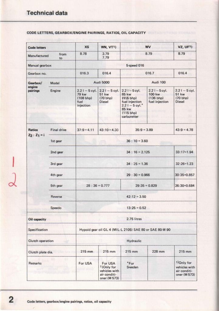

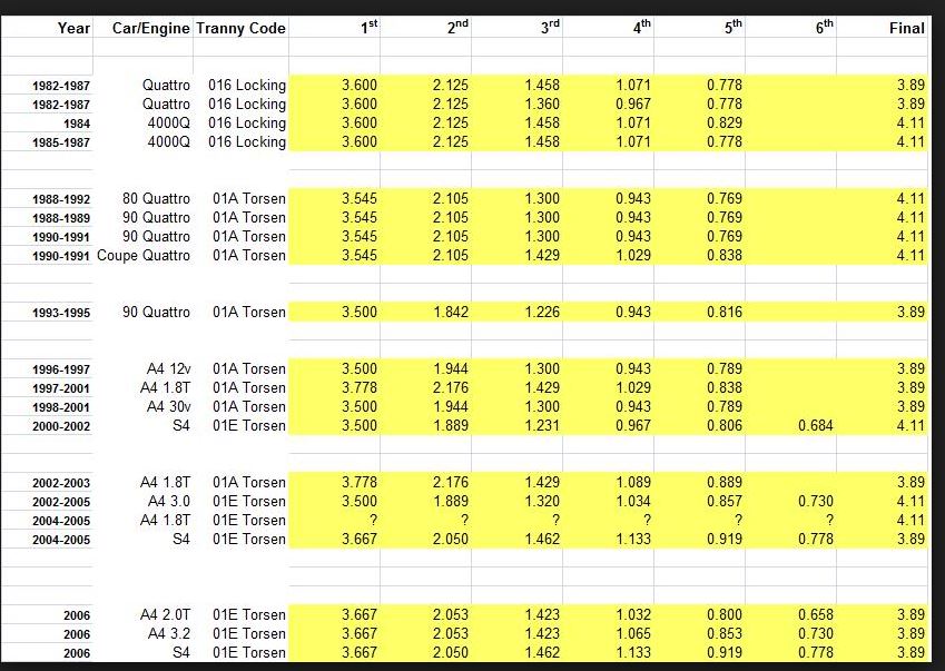

Hoping this could help
Paul
  • Copy of Audi Transaxle Ratios V6.xls

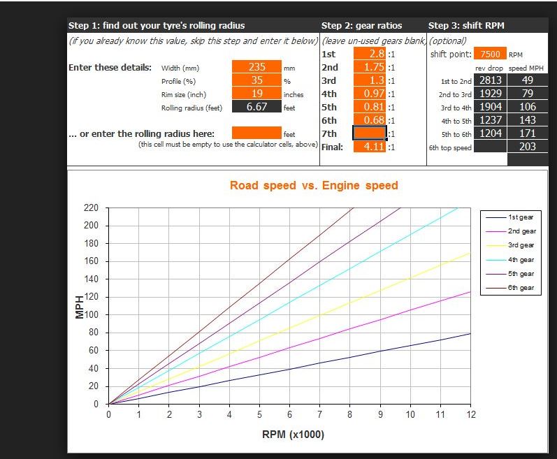

other info
6speed this time, pic you're choise
Paul
Thanks Paul I'll look them over & have a friend of mine look at them (he knows much more than me about gear ratios). A little confusing though. It looks like the codes are the same for different years etc but are different ratios?
