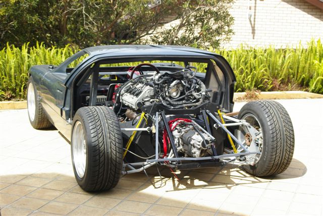

Peter Delaney
This one is in Oz - more than a year ago. No idea of whose it is, or any progress - it is a BIG engine !
Kind Regards,
Peter D.

i'm well aware of how big both engines are. i planned for them both to be able to fit the chassis. all i want to know is can the w12 hit 7200? i've seen both the audi a8l and the bentley continental gt that it is in show the rpm up to 8000, but i haven't seen either hit that due to the transmission timing.
I'm sure both motors will physically turn 8000 RPM+ and live. But if there are limiters in the software for the transmission or engine, then of course they will need to be removed.
