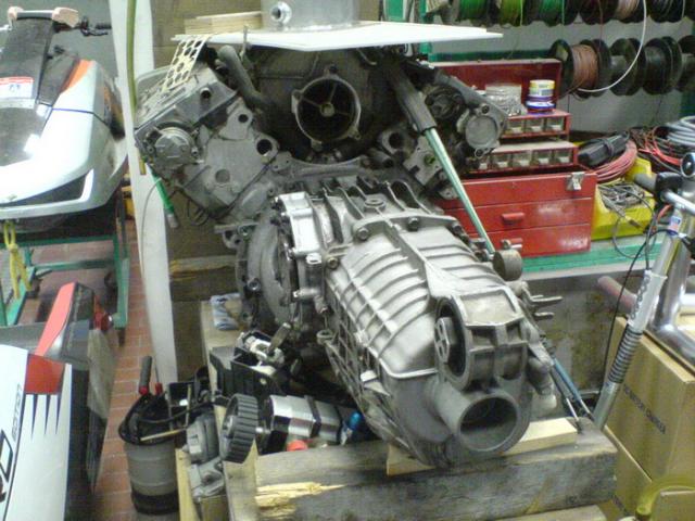

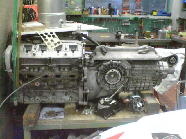

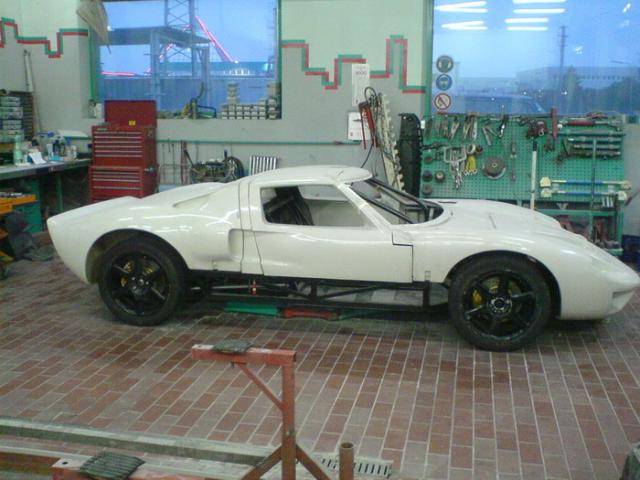

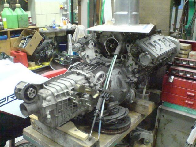

hi, this is exactly what i plan to do, to build a car, a ts40, with an audi v8 engine, a lot of work, need´s drysump, and more space around, this engine is bigger than an us-v8,......

hi andy,.....thanks, in moment we made an adaptor-plate to build on the gearbox to the engine, after we look if we had enough space into the frame to build all inside, needs some weeks to do that, if im am ready i send pics, if we must change something, i send you the infos about,.......
motor is from audi A8 with 300hp, gearbox is from porsche 996,.......

Why didnt you use the audi gearbox?
this is a switched porsche gearbox, so the shafts are in the right position, not to low, i think, and with the audibox i cannot switch the box and the shafts are to low in position,........and it is not easy to get a shiftbox from an audi, the most are automatik,........and for the porsche box we get all parts we need from an friendship racing team,......
could be a fail, but i think it is okay for me

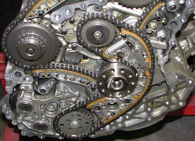

Interesting pic of an rs4 engine with front cover off.....blimey!
is this an new FSI-Engine ?????
the whole motor is an part of art,.........i wonder what technikal is in this engines for a only-street engine,.....and there are much engines to buy around from wrecked cars for less a money,.....they sell complete engine-packs,......but it is not the right engine for a gt-40,.....i know it,.....i know it,......but it is much easyer for me to get parts, tuneup, and infos about,.........
and in moment i can not say if it is possible to build this engine into a gt40,.......i am at the beginning,.....hahahah,........will see,......
