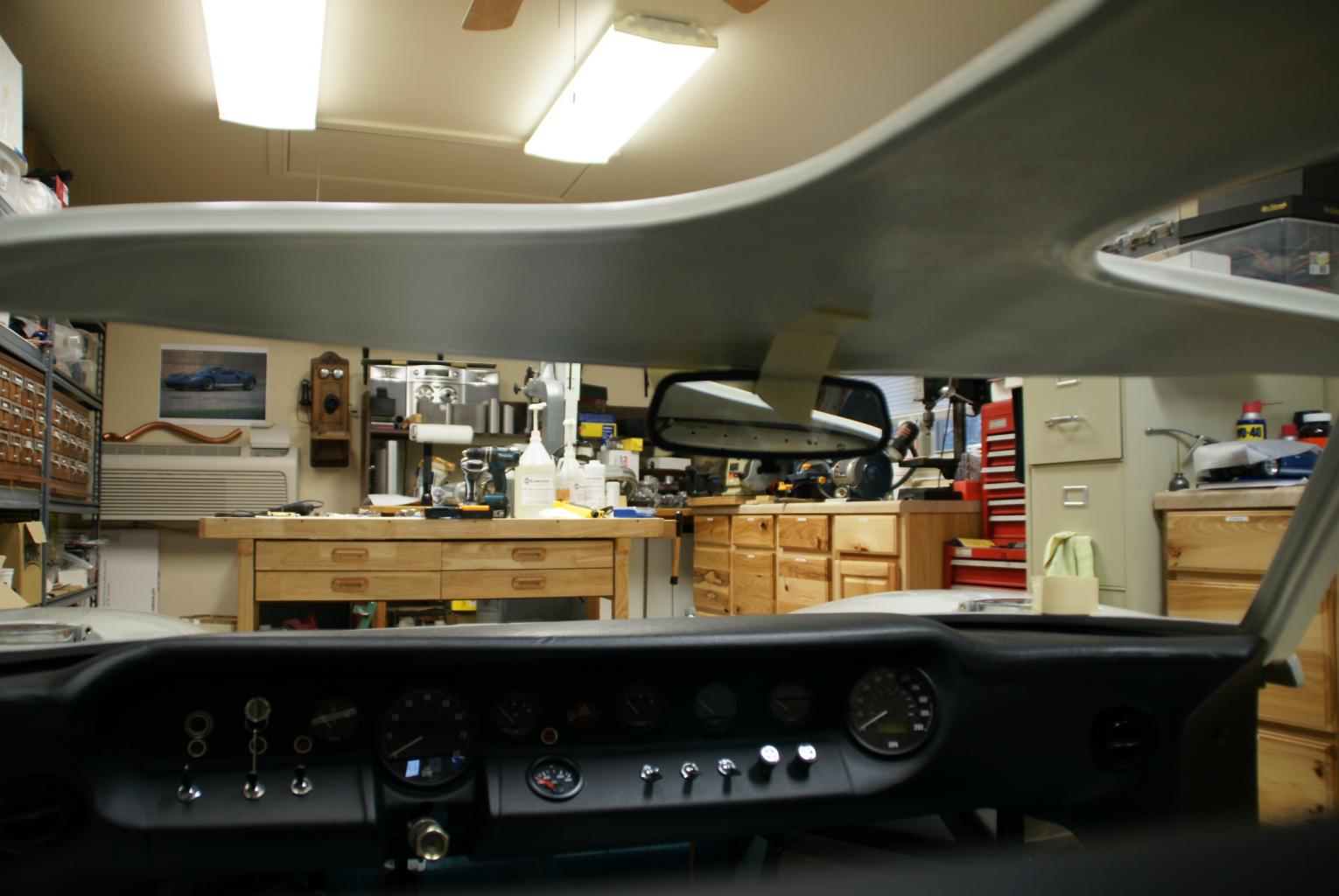

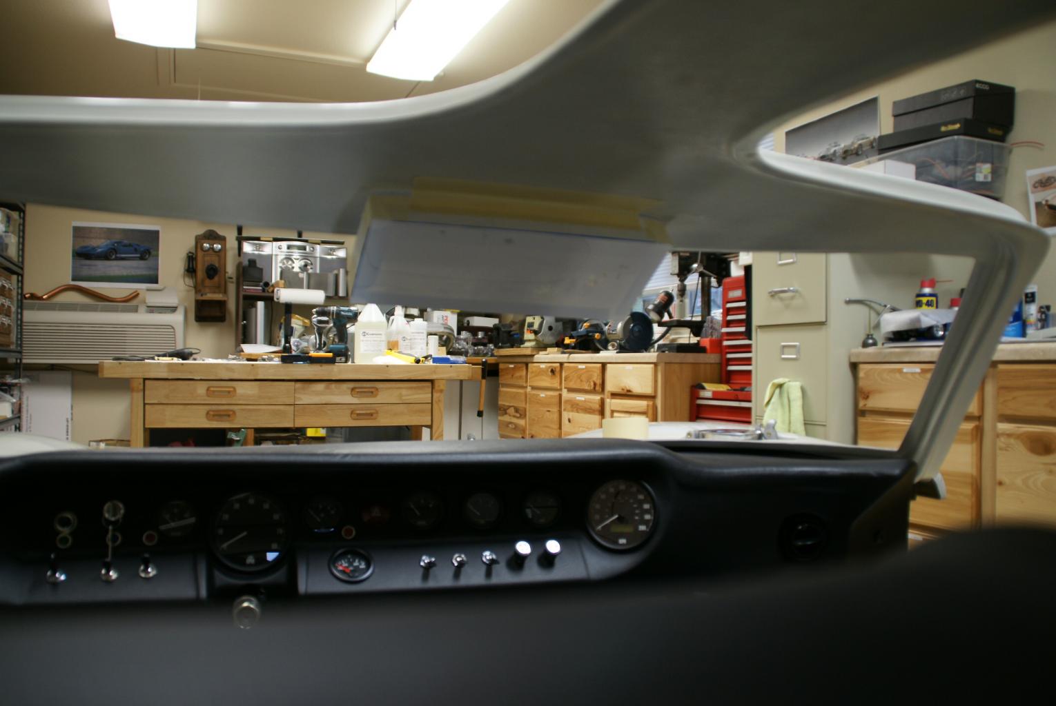

I'm so glad you started this thread. I too have spent the last week searching for a rear view camera and display. I guess you saw the CCC Manhattan video that illustrated that there is basically no rear view from the rear view mirror. People that are already driving know this, but I don't have my car complete yet and wanted to do something before it is finished.
https://www.youtube.com/watch?v=c3Wbgl_ZP_A&feature=youtu.be
Nissan and Cadillac are coming out with a good rear view camera and display; however, to date I can't find exactly what I want.
What I would like to have is a display that is about 7" wide including case and a 25:8 aspect ratio. There are several on the market with a 16:9 ratio but only have a width of 4.3" and therefore only use half of the mirror for the display. The 25:8 is wide and narrow and thus doesn't come down too much from the roof to intrude into the forward visibility (compared to a 8.8" 16x9 format).
The closest thing that I have found is the Tview RV808C. It has the 25:8 aspect ratio but is 8.8" viewing area which makes the overall width 10.7". This is too wide, but is the only thing on the market that I can find. I suspect that there will be numerous options within the next year, but for now this is it.
Tview RV808C 8.8 inch LCD rear view mirror monitor with License plate camera kit
Mounting the display on the roof and tilting it does not take away any more intrusion below the windshield that the normal mirror does and does allow a very wide view behind the car. My roof is double skinned and I think that it is hollow in the center so I can run the wires from the front to the rear of the roof so they won't be seen.
The camera that comes with that package is evidently not very high resolution. I will get another camera with better resolution. Also, that camera has a 120 degree field of view which might be good for backup, but I will probably get a 90 degree camera to use as a rear view.

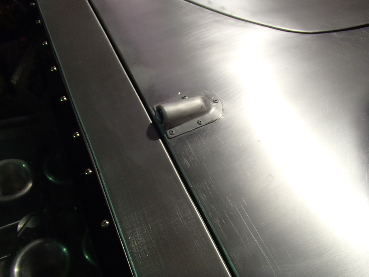

Not a GT40, but my SLC is using a 7" tablet mounted in the roof panel for my rear view camera. The camera is mounted in a shark-fin case on the roof, and is connected via a wifi connection to the tablet. I used a wifi connection since it was easy and inexpensive to send video to a really good quality but inexpensive video screen. I'm using a Nexus 7.
There is a bit of lag due to propagation delay and video processing, but I think I will like it.
No pics to show- I've just had it working in test mode to prove the concept. Visibility is good, and cars in what used to be a blind spot are visible. There isn't a lot of detail far away, but how fast could anything close on me anyway?? :)

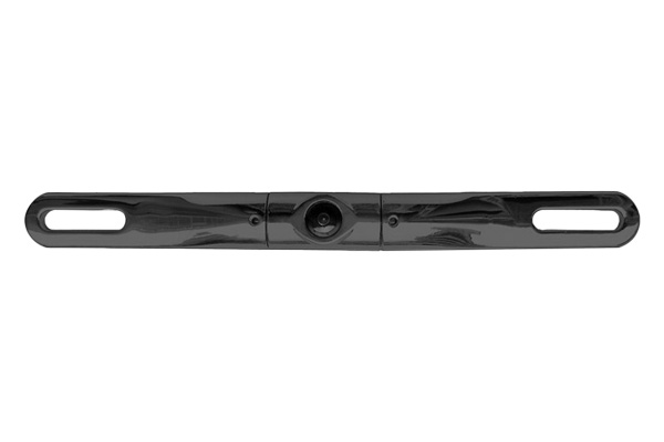

Back to cameras I tried 2.
One was a rear vision style it was useless, it is to close to you and it made it hard to focus on what was in the view.
I went to a small eye type camera with about 120deg angle, the screen I have mounted on a small post on the skirt of the dash,it would be about a 3" screen.
In traffic it is perfect, a lot of cars hang out of the side in your blind spot checking you out.
If you wear sunglasses you need to buy the lightest you can as it can make the screen dark to see.
I have it on all the time but it is wired through a switch.
I find it is good for reversing.
The mount does not have to look like a wart if you dont have a huge camera.
I did not try to hide it but instead made it a visual thing and it looks ok in my mind.

This is for you. I have 3 cameras that I use. As Jim mentioned there are definite blind spots on these cars. I set mine up so as to cover those. In the past I destroyed the front end on a Lotus Turbo Esprit because I couldn't see overtaking cars well when I wanted to change lanes. The fish eye cameras at 120 and above will not tell you well what is coming up on you or judge distance at all. If you can find 90 degree FOV then you will see as you do in an ordinary mirror, but setup correctly the 120s will do the job. When I first got my cameras there were no 90 degree units. Hind sight I should have gotten 3 side mount cameras
as they look a lot like Jim's and will probably be the one that replaces the original central rear view setup. I had one of the box cameras and it did look bulky.
My other two cameras are mounted in the side mirrors(RX-7). I got those mirrors because they were electric, but later found out they didn't work. The mounting for the motors worked fine as a base for the cameras
My first iteration utilized the side mount camera in it body, but it proved too large for the space in the mirror. When I disassembled the cameras I discovered they were just small balls and some finagling got them mounted. The mounts are just plexiglass and they are bonded to the mirrors that I had made up at a glass and mirror shop. Several sessions on mounting and aiming them. This is what I finally came up with. They are mounted on plexiglass so they can be mounted with or without the side windows. Didn't like the body mount. Was too low and visibility wasn't the greatest.
The screen that they are displayed on is a 4 camera setup(7"). It allows you to see all at once or you can scroll through them separately.
And the central one.
I moved the screen location to beneath the dash, as I kept hitting the screen with my knee.
