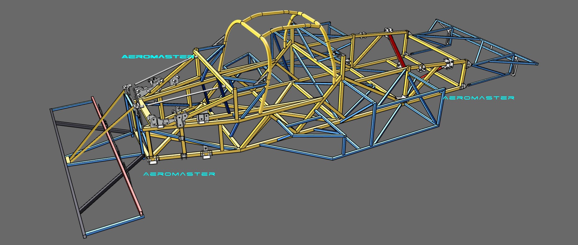

Looks really nice Trev, body looks grand, nice job. Am I not alone in thinking the chassis rear end looks like it lacks a little in the torsional rigidity stakes or am I looking at it like a piece of farm machinery??
Would fly with a decent engine in it
I agree, that chassis looks like it couldn't hold more than 200hp. Nice looking body... the chassis? Not so much...

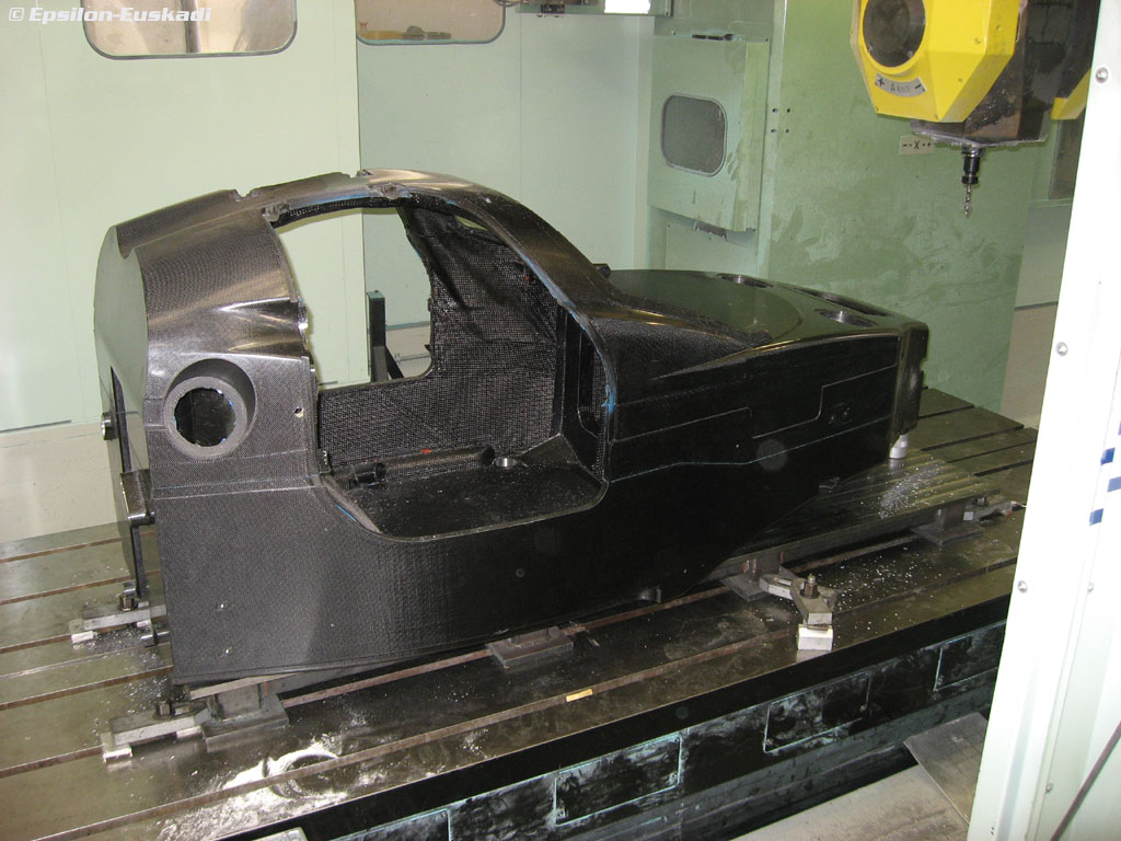

As most of the suggestion here is the intensity of the chassis, I have attached a chassis design pic, you can see it clearly, all comments are welcome. I know the carbon monocoque is the best choice, but first is out of our budget, second I can not buy it just from Ebay...LOL.

Did you followed any rule ( ACO or ELMS or whatever) in drawing your chassis ; means dimension of inside cokpit , doors , front crash box or is it complete self determined choice of feet position,rear diffusor etc etc
Thank you for your word, just for information:
Using the 3d wheels and the reference photos, we were able to shape the 3d car body in a very accurate tolerance. Of course, it's not possible to create 100% same shape as the original 3d CAD model made by Bentley, but I can say that the proportions and shape of our CAD model are 95% accurrate. But on our website we claim just about 80% accuracy to the original car, because we also made some minor changes in the design, such like: few removed wings, air intakes, a fuel cap hidden under the engine cover, side mirrors moved closer to the driver, etc...,
By different with the body work, the chassis is totally designed by us, no official FIA rules followed
we designed the chassis to fit the body work.
Ok
what I did some years ago in a Gt prototype ; chassis was done with very fiew square tube like yours but I covered both sides of tubes with Carbon fiber panels and a core of light honeycomb in beetween and all this stuff bonded with 3M structural bond ;
from outside the tub looked like a carbon one and stiffness increased 30 /100 more
My 2 cts
