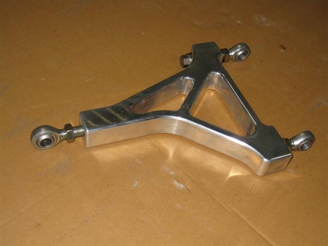

The only criteria is that it be infinitely adjustable without dismantling it from its clevis
Thanks Chris,
No problem, I can make you a set, in fact is there anyone else out there that would be interested in some? While I am at it, the price would be very reasonable.
Let me know if I can help anyone out with some manufacturing.
Bob
You can imrove greatly the way to screw spherical bearings in drawing aspecial parts that allow to set the suspension whitout pulling out any bolt on chassis or uprights !!!!!!!!!!!!!!!!!!!!!!!!Hé hé hé
