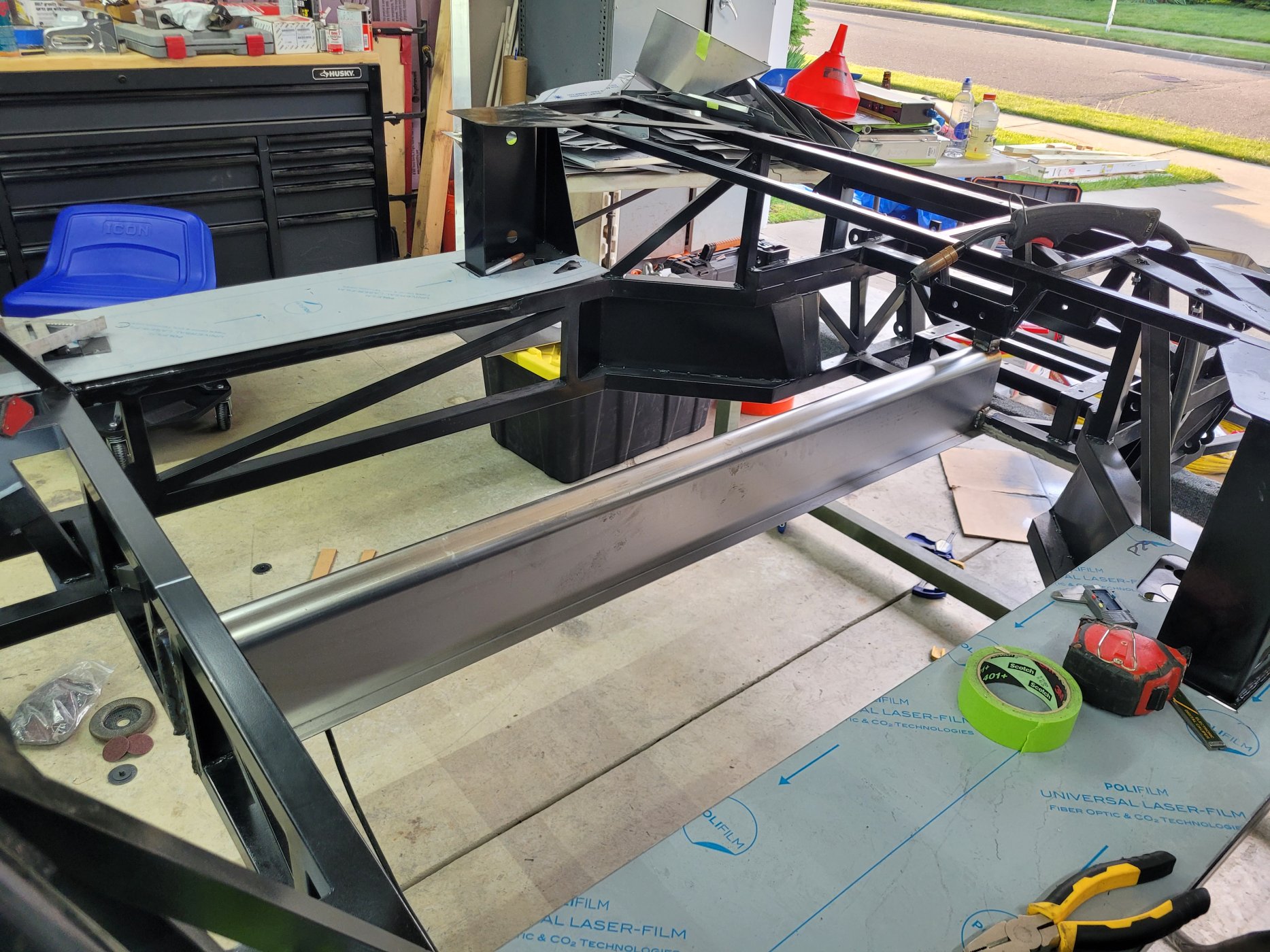

Thought I had more roloc sanding discs than I did. Had to stop here for the day. Need to order more.
Fits the clam and door perfectly.

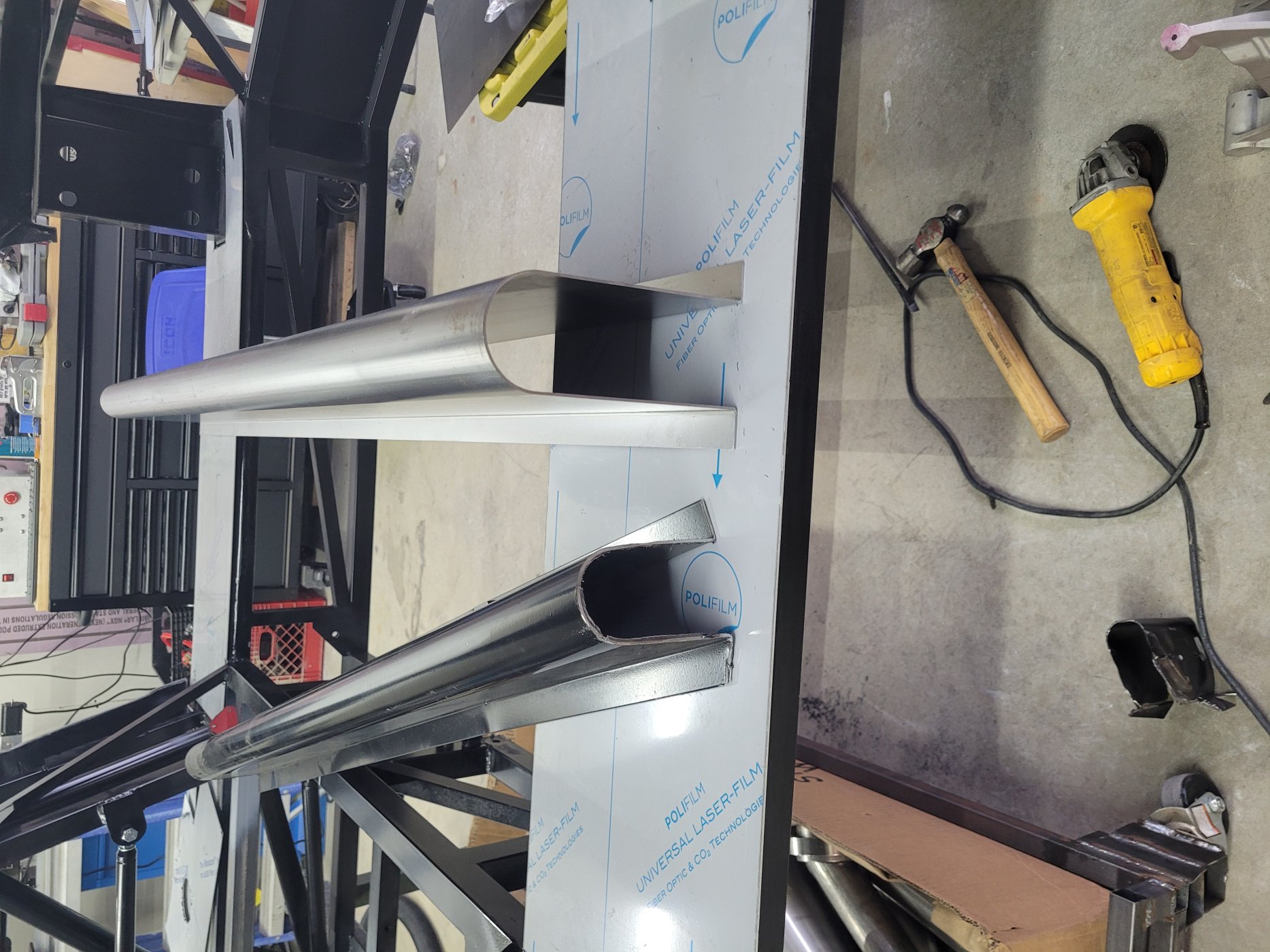

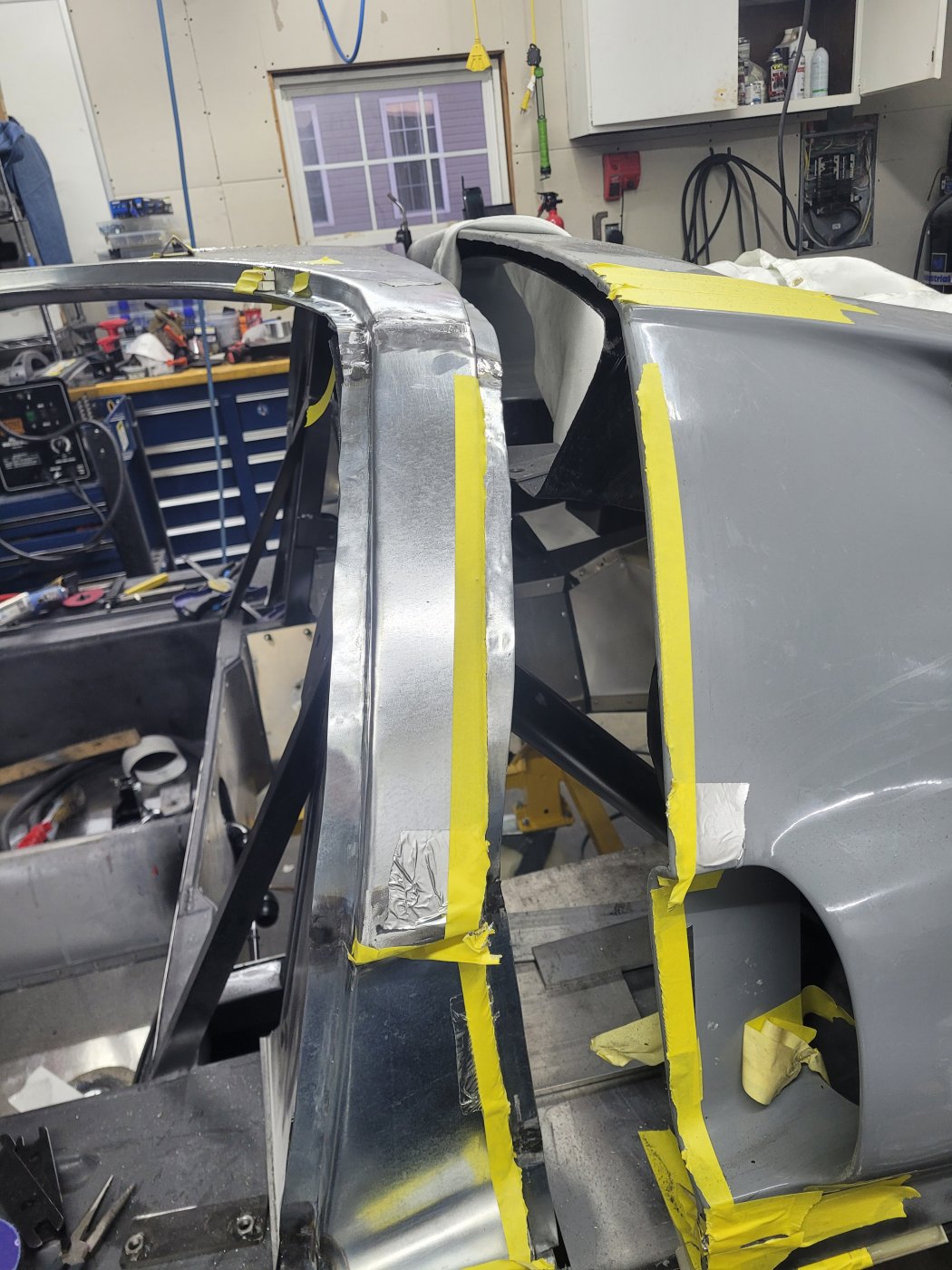

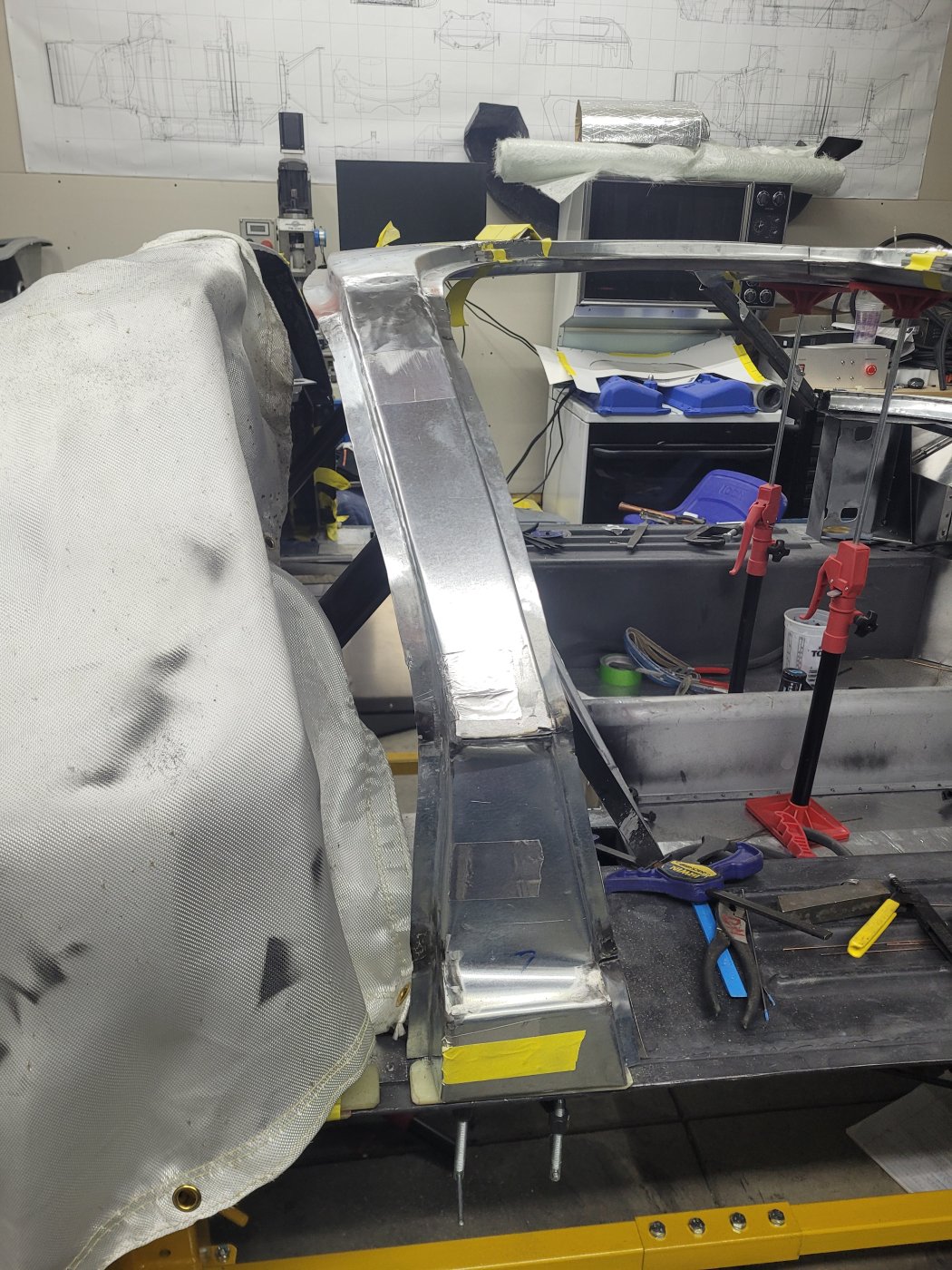

Been a while once again, the last two days I was able to work a bit on the B pillars in between customer calls. Not the prettiest welds I have done, but I gave up on trying to make them perfect since they were just going to be blended away anyhow. More blending to do, but I am calling it for today.

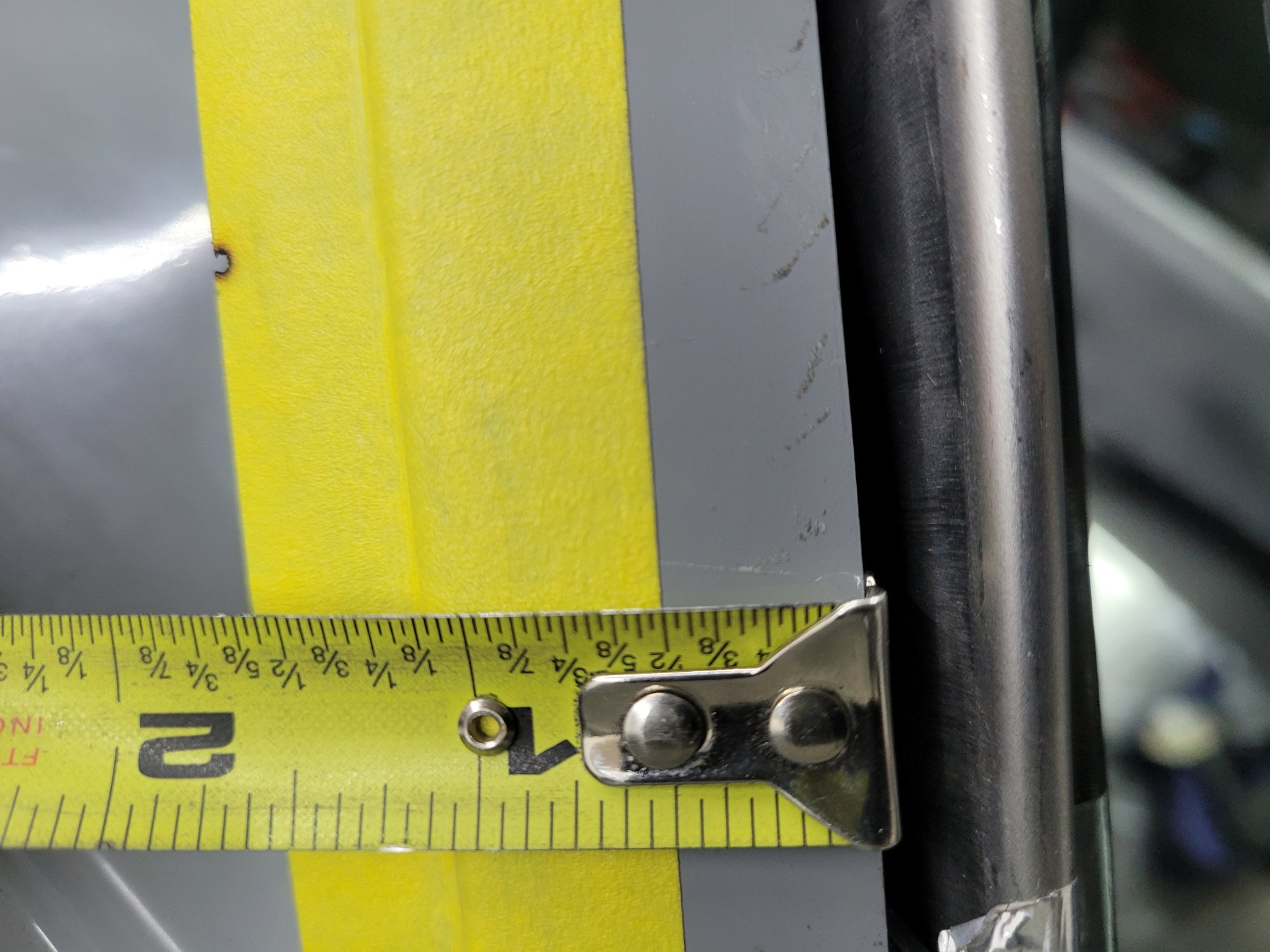

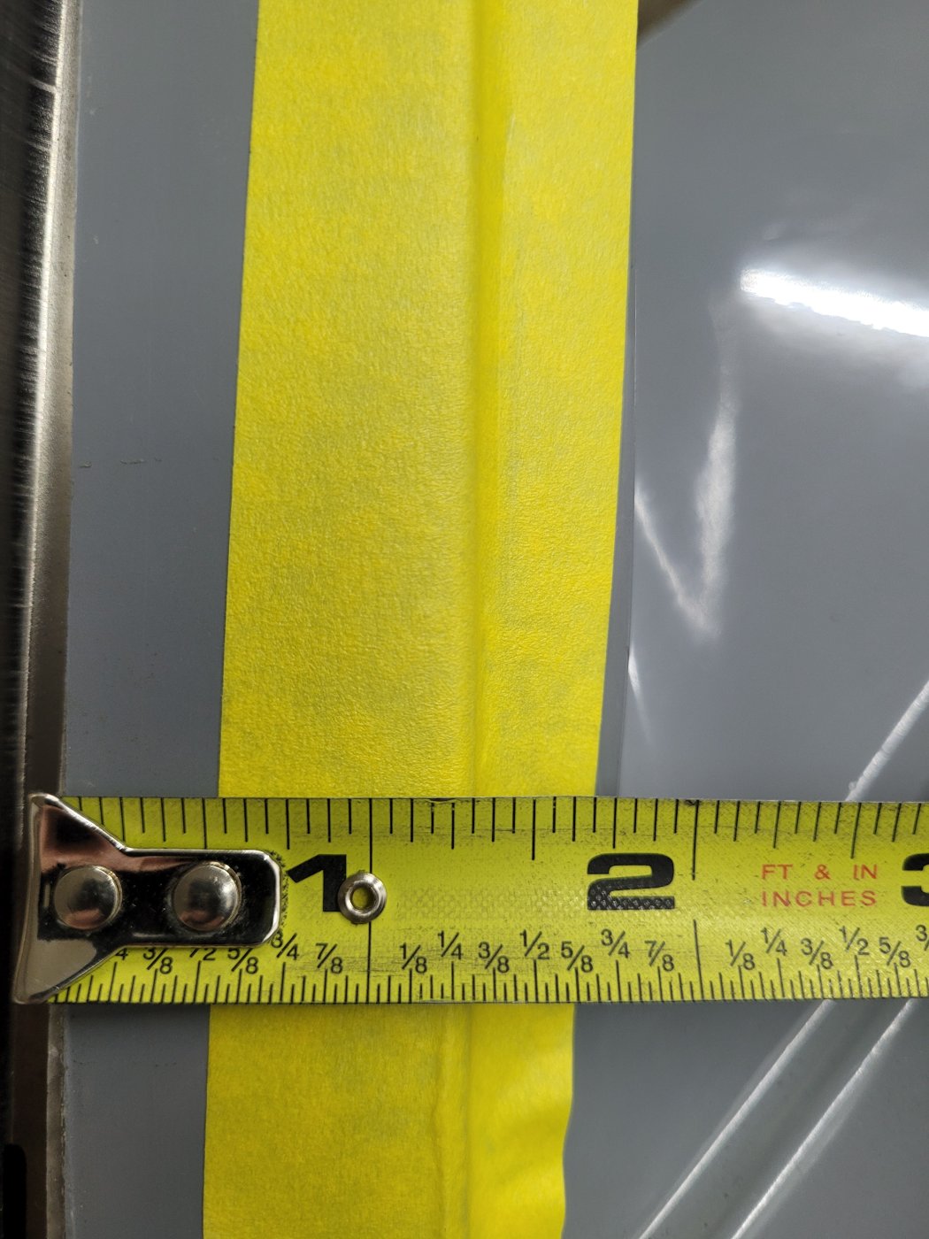

The width of the door infront of the side plexiglass that ajoins the A-pillars. Would anyone be willing to measure theirs? Mine are both different measurements and taper to again both vary different measurements to the too of the door, my my adjustments of the doors to make them settle correctly it appears I will need to add about 5/8 of an inch of material to the tops to make it good. I have not removed any material yet, this is how AK set them.
Mine at the bottoms.

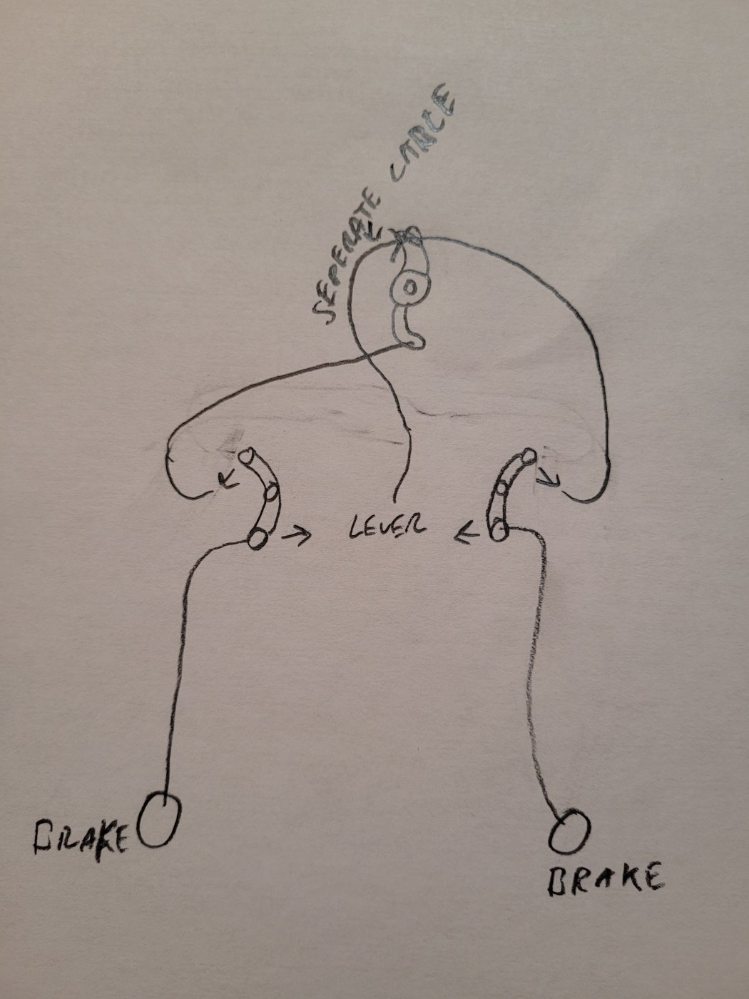

As of right now, I plan on routing the two park brake cables along the side tubs next to the fuel tanks, have 2 excentric pulleys for each cable, that goes to a single that will go to another pulley to attach to the park brake handle.
Crude drawing below.

Is there a reason why you do not run a single cable to the rear of the car before splitting for left and right?
View attachment 150767View attachment 150768
cant make out which bit your mraasuring.
can you do some pictures with the measure but from further away so can see where you are actually measuring ?

I cannot run one straight down the middle.
Way to many things coming out of the center tunnel area and lots of accessories drive pulley things and drysump pulleys in the way. I can't use the bar type thing that AK/SGT used, engine is too low.
I could run one to the rear only on one side, still would have to come up with a method of pulling two balanced from that side. But as with all the non standard changes I have and are doing. Everything is a balance of compromise of design and fitment.
I have a set of cables I got from summit for really cheap and if i can run them all the way to the lever I will have the balance bar there and only an extension cable to the lever. Everything is an idea until completed but will be adjusted and made to work correctly as needed.

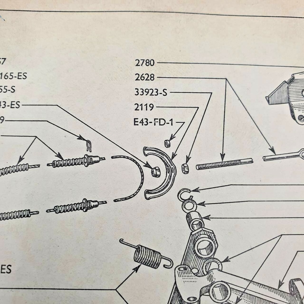

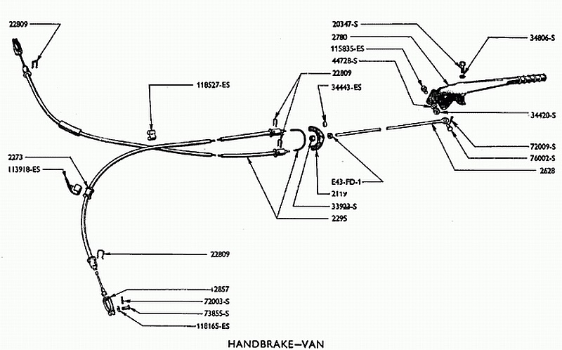

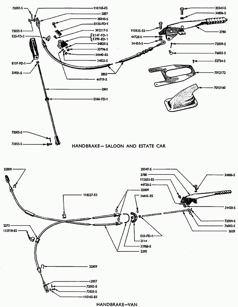

Hi Douglas

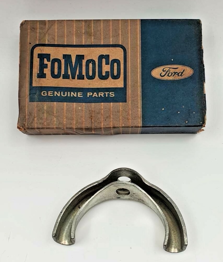

Perhaps think about the original Ford Anglia 307e van rear brake arrangement ?.
This involves two cables via one equaliser to a single rod pull up your hand brake lever.
The Equaliser shoe is part number 100E-2119-B

Douglas
Hi Douglas
View attachment 150788View attachment 150789View attachment 150790
This is kinda what I was also thinking of that in one of the two methods I mentioned. I do also have a standard park brake handle. Leaving options open for when I get to that point, Im sure the air conditioning will put curve balls everywhere under the dash.

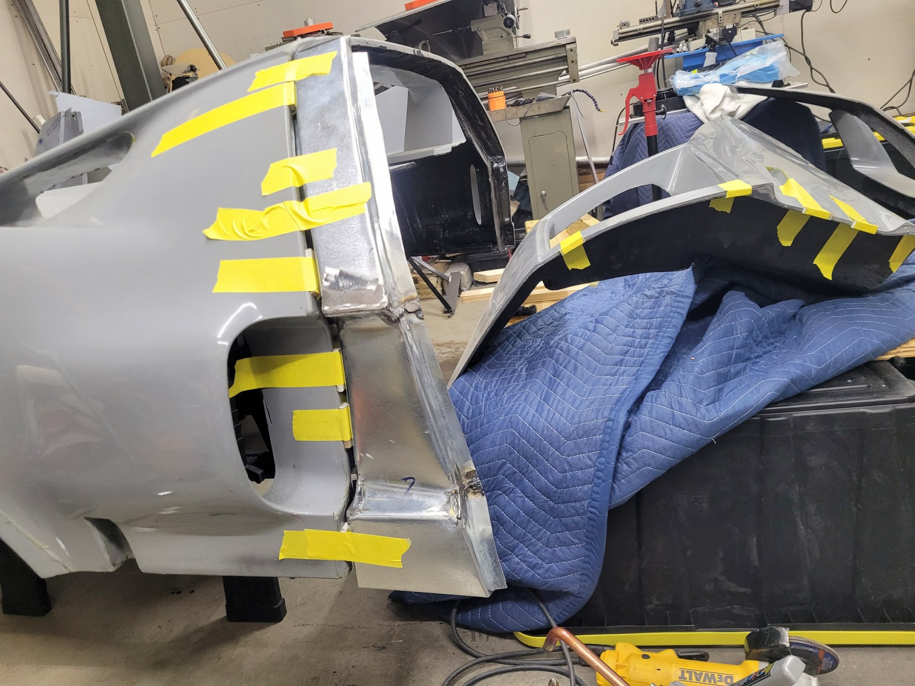

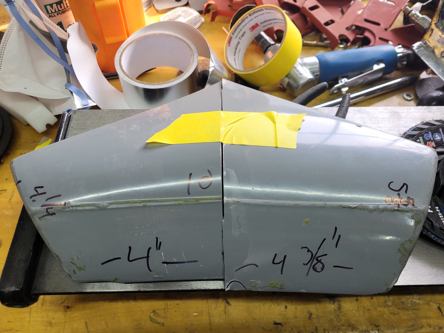

While doing the good fun adjustments and alignments to continue to weld up the roof I was having issues with the door area under the front clip behind the fuel filler area. So I ended up cutting them off the same distance using vertical line at the end of the front clip and a reference. I made a paper template of that area and so far it seems to be the only thing some what symmetrical. Everything else has huge 3/4 inch to 1 inch differences in thickness, bends, angles, etc.
Check out this difference. Not as big as the others but it was stopping me from being able to even alignish the outter skins.
